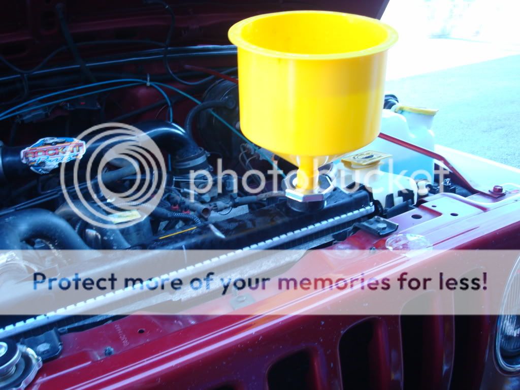

Yesterday I replaced my leaky radiator and lower hose, the only pic I got is from when I was bleeding the system.

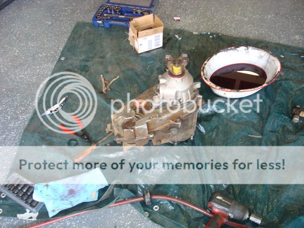

I Did my t-case fluid today, my guess is its never been changed caused the fill plug was stripped out, when I pulled the plug pepto-bismol came out of the t-case, now I know why my t-case whines and screams when it's in 4wd.
Crappy cell pic
Now I'm in the market for a new t-case, I was thinking about getting JB Conversions 231HD with a SSYE, I'm open to other suggestions

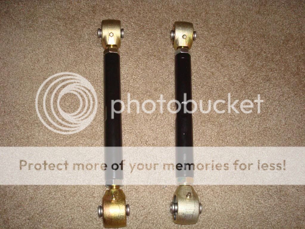

Just ordered Adjustable upper control arms and a CV trackbar bracket.

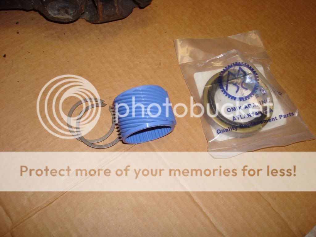

Picked these up from the local off-road shop because the PO removed the speedo drive gear from the tailshaft.

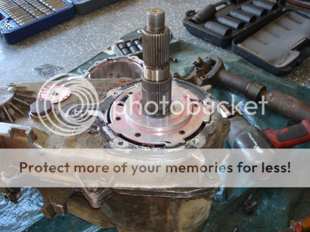

Worked on the new t-case, ready to be installed.
Gear installed
All back together

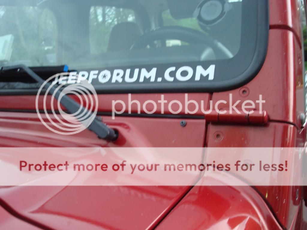

Put my JF sticker on

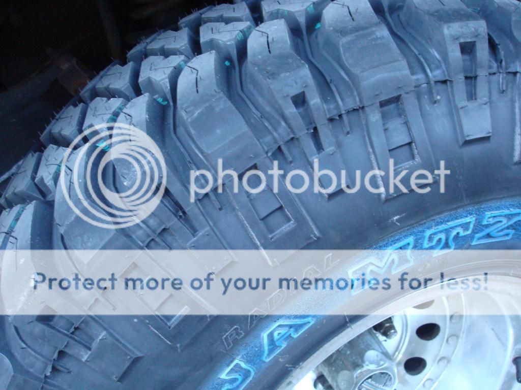

Ordered some new meats today, should be at the shop tomorrow morning.
-Joey

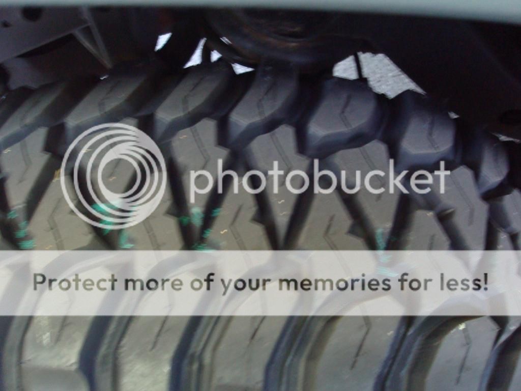

New MEATS! And in other news I'm moving back to IL end of this month.

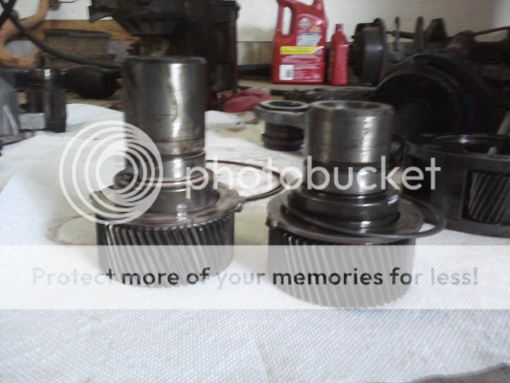

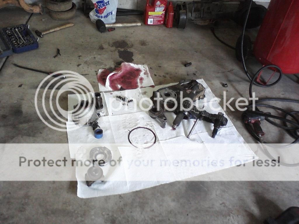

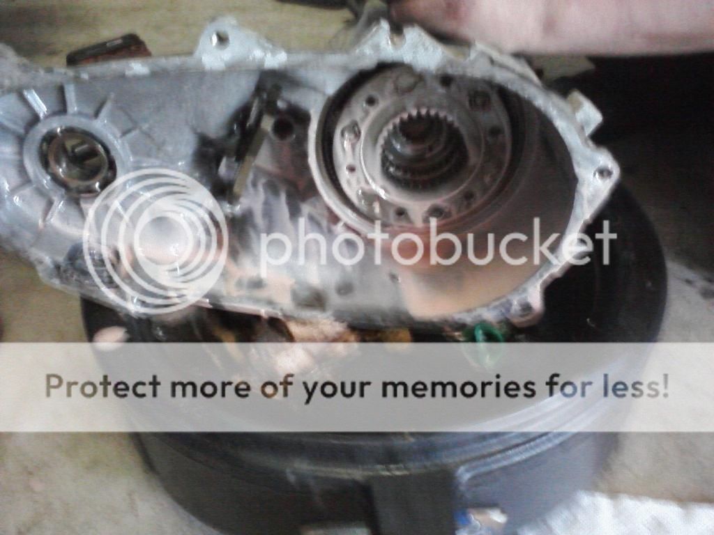

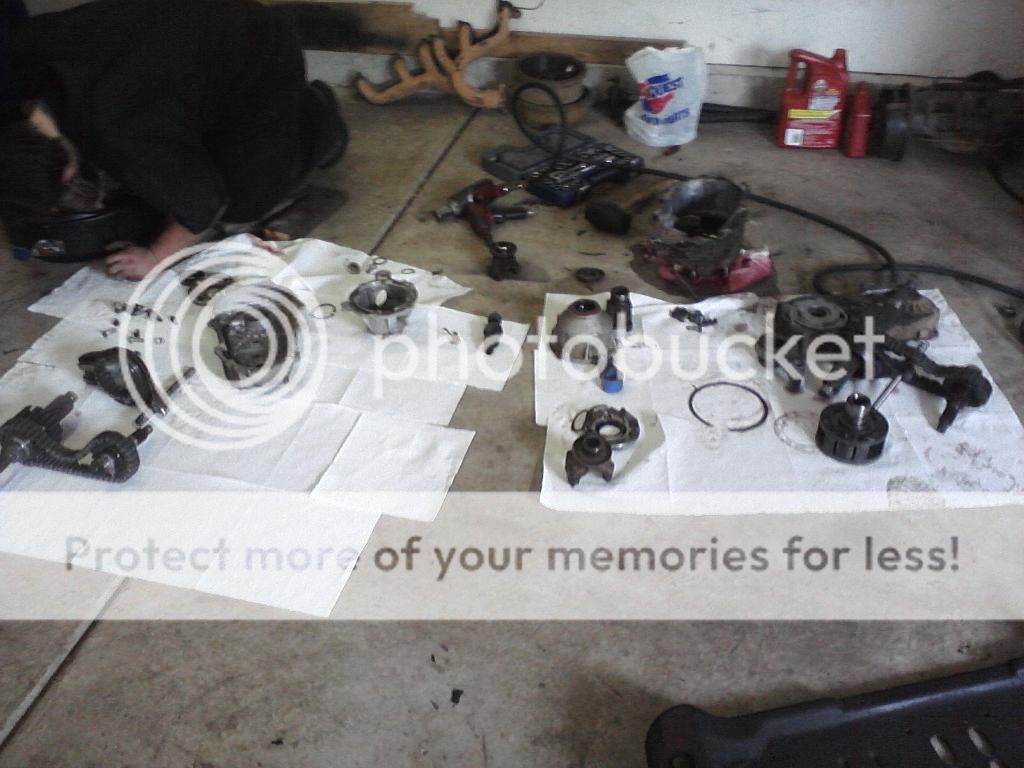

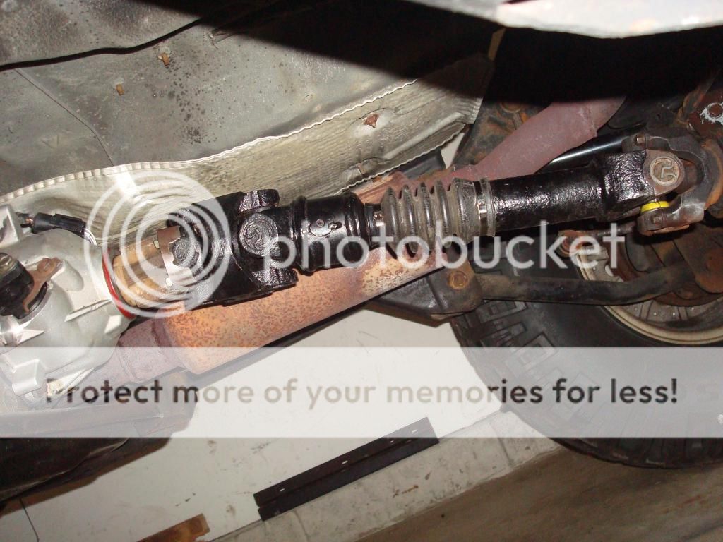

Did a ton last week(including moving back to IL), I've been waiting for my buddy to send me pics. My plan was a simple tcase swap, that did not go as planned, each tcase had different input shaft length so I had to swap them here are a few pics my buddy took, also had to swap the front the output yokes. sorry for crappy cell pics
Pic of me starting to work on the TJ case
After 30min or so I had this (TJ case on left,YJ on right)
Input shafts next to eachother(TJ on left, YJ on right)
just some random pics
Yuck

Which eventually turned into this
I had to drive to Wheeling, IL in FWD to get the shaft that came with the tcase shortened.
Heres the shortened shaft

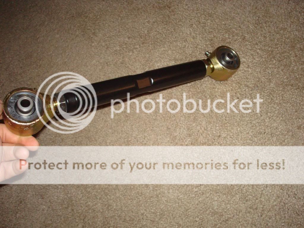

Rokmen uppers

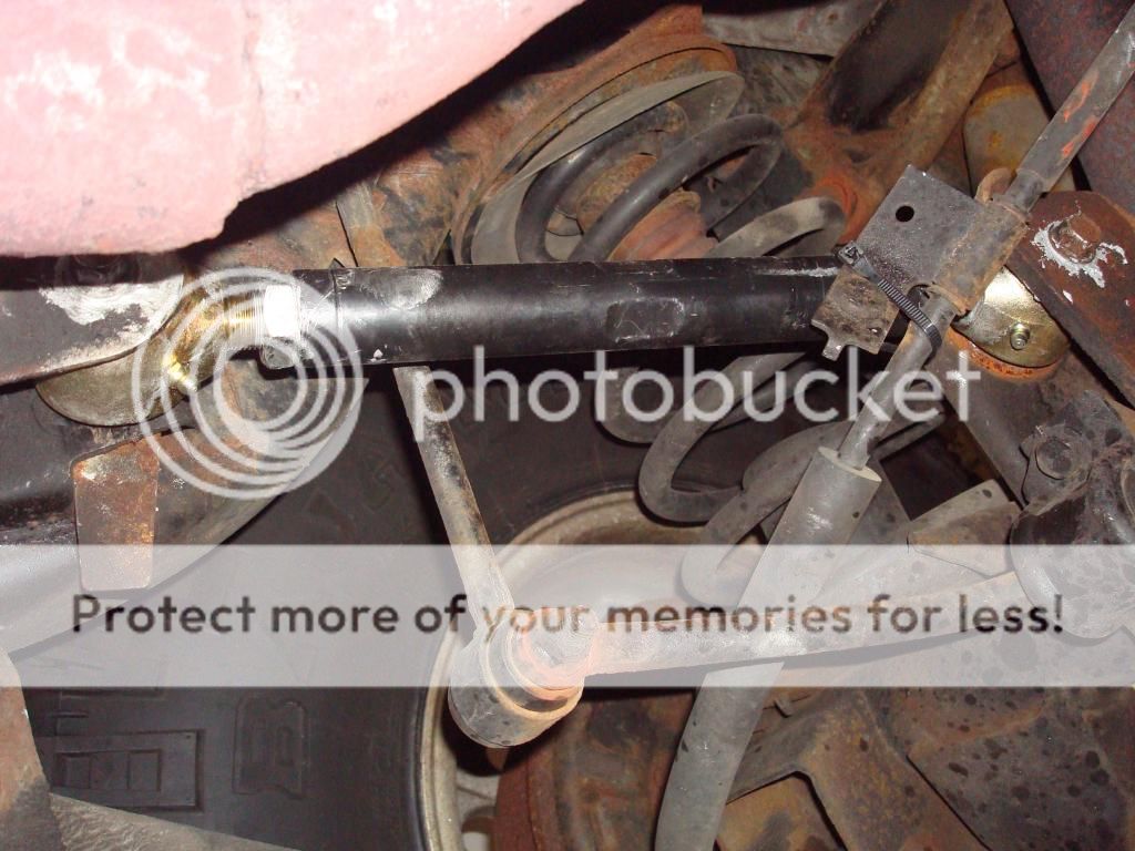

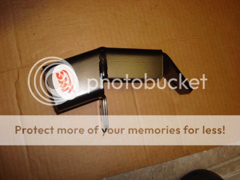

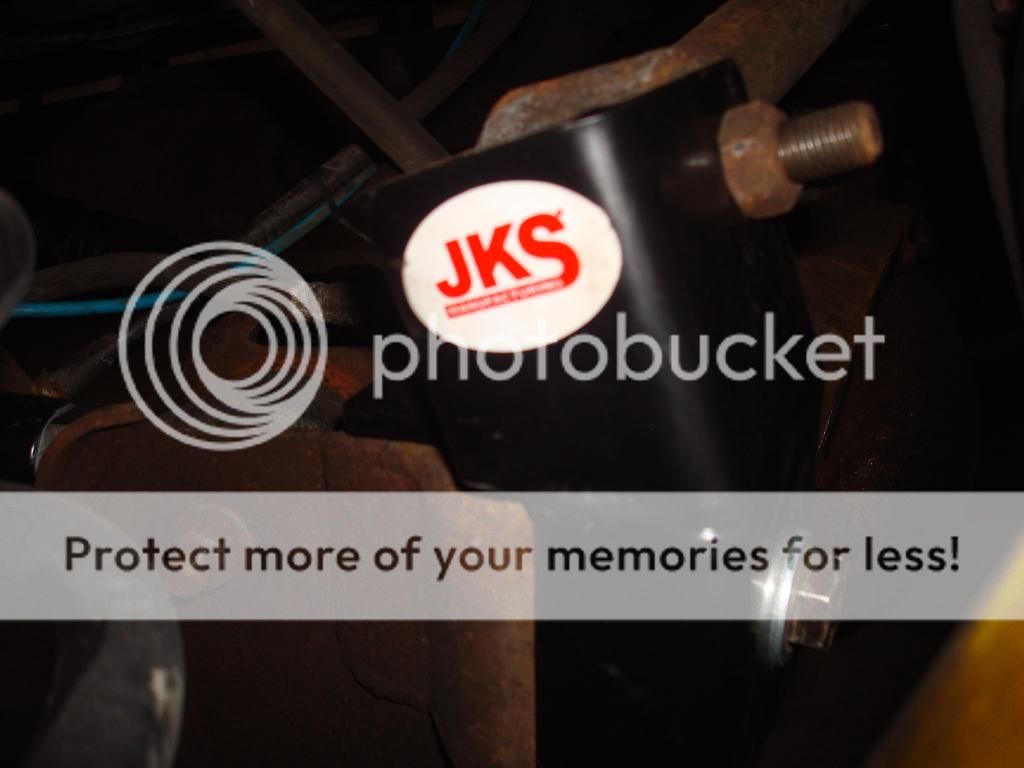

JKS cv bracket

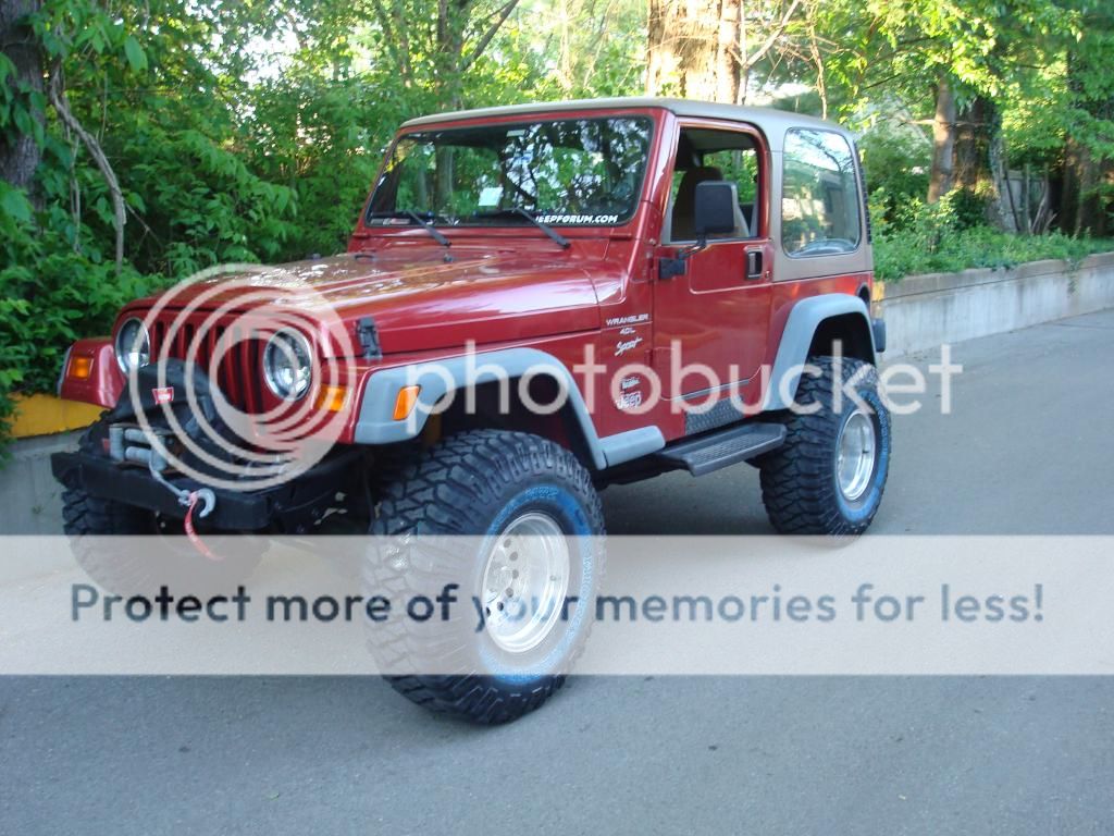

I also installed my new soft top
The finished product

I still need to play with the pinion angle, still getting vibes above 70mph, I assume some are coming from the front shaft, so I'll rebuild it and the DC joint in the rear shaft when I get a chance, also paint the fender flares, sand and paint the rest of the frame.
More importantly the rear track bar is shot and the front is not much better, so 2 new trackbars are on the quick list, and a Currie steering set-up, then it should be ready for its maiden voyage.
