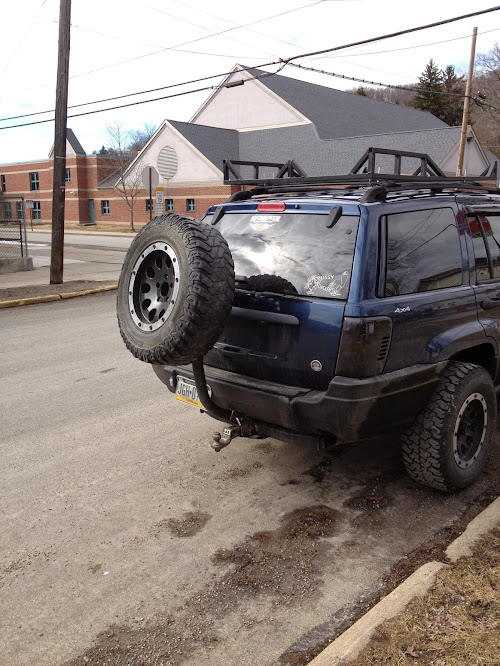

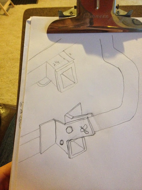

i really wanted to find a way to make my WJ more unique. so i looked around and found that not many WJ's had rear spare tire carriers. so i started my search for one. i quickly founf that buying a new carrier was not gonna be an option with my budget. i though about it for a couple weeks and came to the realization that building one would be my only option. I decided that somehow tying it into the hitch would be the only wat i could make it work. so i drew something up and thought about it for a little while.
i came up with the idea to make a bracket on both sides of the hitch receiver and put the tube between them. the tube would attach to a grade A bolt. also have a pin further up that i could pull out so it would pivate on the bold and fold down to open my hatch. next step was to make a cardboard version so i could better visualize it.
1999 grand cherokee on a teenage budget

i thought my idea would work so i took some steel plate into my high school shop and cut out the brackets. i then drilled the holes for the hitch pin and the holes that i would use to hold the pipe and then welded it into place. i took tubing to a buddies place and used a cheap pipe bender to bend the pipe that would pivate and hold the tire. after the pipe was bent i drilled the holes that the bolt and pin would slide through. i could now out it on the jeep for the first time.

the next step was too cut it to the proper height and weld on the plate that bolts on the tire. i painted it with bedliner and this project was finished. oh and i also moved the liscense plate down onto the bumper and wired up a small light on it
It ended up a tiny bit crooked, but i was still happy with it. i expected that there would be a few errors due to the fact that i was no professional.

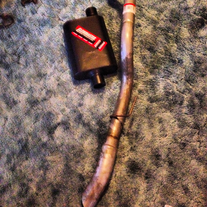

my next big project was a new exhaust system. im not a big fan of nice looking vehicles that dont have the exhaust tone to back it up. i tried a cheap thrush welded exhaust first. it sounded great on my previous jeep that had the 5.2L V8. but with the 4.0 it sounded more like a civic with an exhaust leak. i was not pleased at all. so i headed to amazon and searched for an exhaust that i could afford. i found a flowmaster super44 muffler and 3inch tail pipe for about $150. after shipping and handling i had $180 into it. It also got delivered on time and i was pleased with the quality.
i welded on the exhaust and also made a DIY 4" exhaust tip to help deepen the tone, it actually made a big difference.

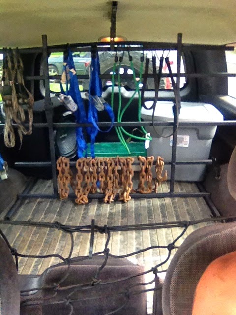

Once again the jeep stayed like this for a few weeks while i thought of my next project. Me and my girl freind spent a lof of time driving on dirt roads with my dogs trying to find new places to walk them. i found it very annoying having them always messing with the stuff in the back of my jeep. so this brought me my next idea. I needed a barrier behind the rear seats so the the dogs could not get to the very back, they would be forced to stay on the folded down back seats. so fabrication began. i took some measurements and bought the metal i would need. i decided to build it all "Bolt-On" so it could be very easily taken apart if needed. i would try to explain the build but there is no way i could make it make sence. so ill just let the picture explain it.
I also layed down a truck bed liner that i had out in the garage so the dogs wouldnt soak my jeep after they swam. the barrier turned out to work great for holding all my straps and chains that i keep in my jeep.
