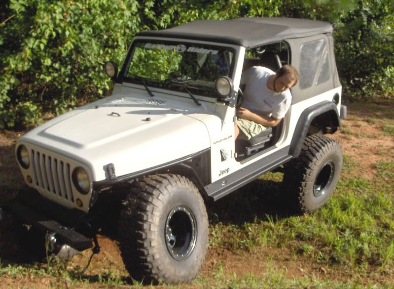

So I sold it and started searching for a TJ. Of course I wanted a 4.0, D44 rear, Automatic, Full Doors, Hard Top, etc. Well I ended up with this, my cheap side got the best of me....
This was taken a couple days after I brought it home.
1999 Wrangler SE, 2.5L, D35 rear, Manual Trans, Half Doors, and a crappy soft top. (Ugly wheels, Worn 32s, 3" Body Lift, step bars)

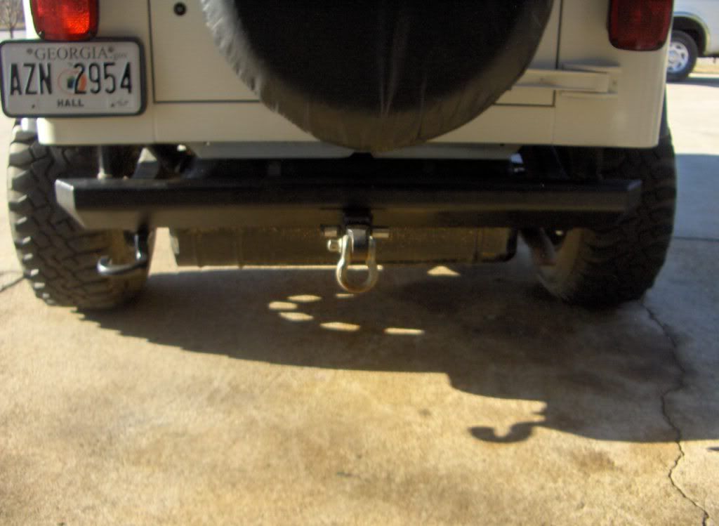

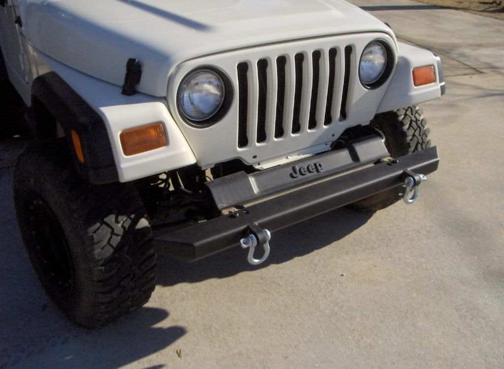

Ordered a Procomp Rear bumper, Smittybuilt front bumper, and some sliders.
Also found a deal on some 15x10 street locks, rubi fog lights and some pillar mounts.

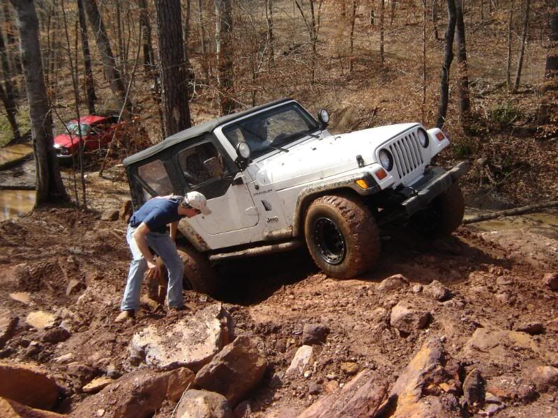

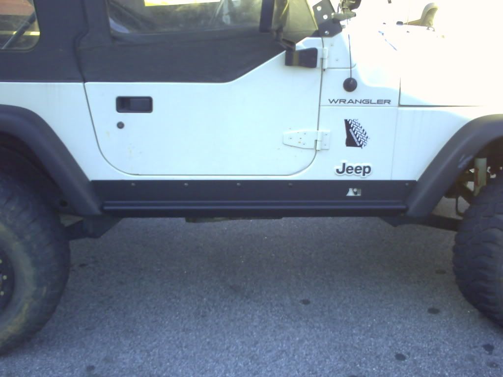

I Did alot of wheeling between mods. I quickly added some homemade discos, 2" Budget Boost, lockright locker for the D30, and some longer Rancho shocks. Also changed out my smittybuilt rocker guards for a test set of Rugged Ridge sliders. Keep in mind I sold the parts that came off my jeep to buy what I had up to this point or made them. No extra money to spend on goodies. Most parts I found used via the world wide web.
Freebie (Thanks Omix Ada)

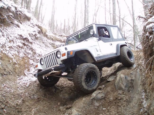

Some wheeling pictures so far.

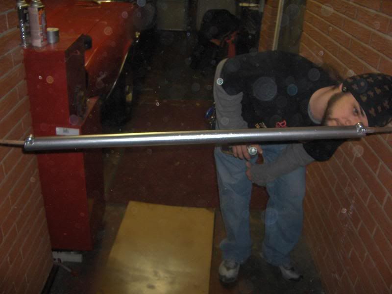

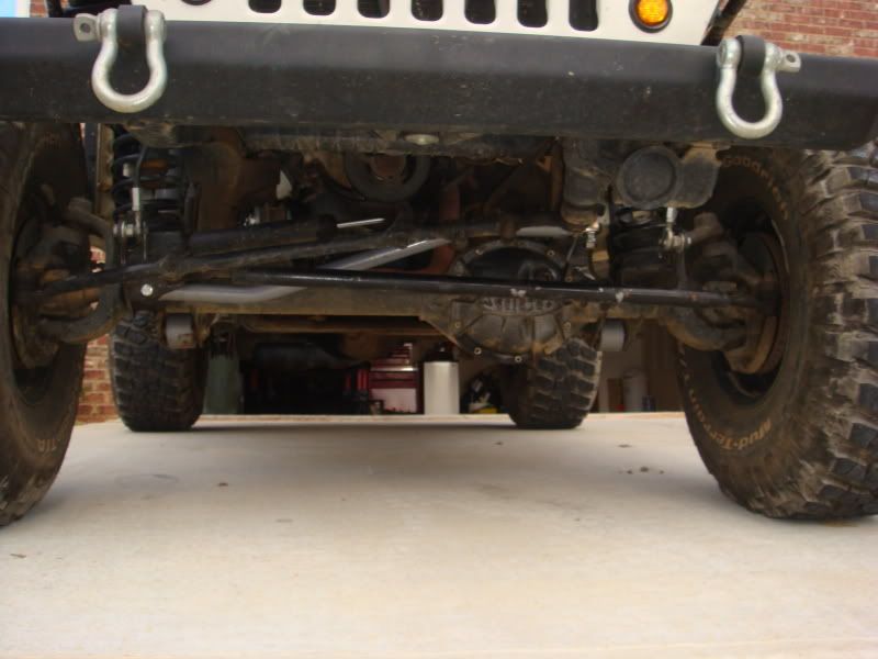

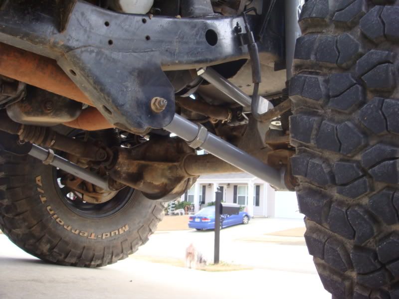

Built a HD 1-1/4" tie rod.
My buddy Daniel, adding some paint.
Testing it with some offroad abuse

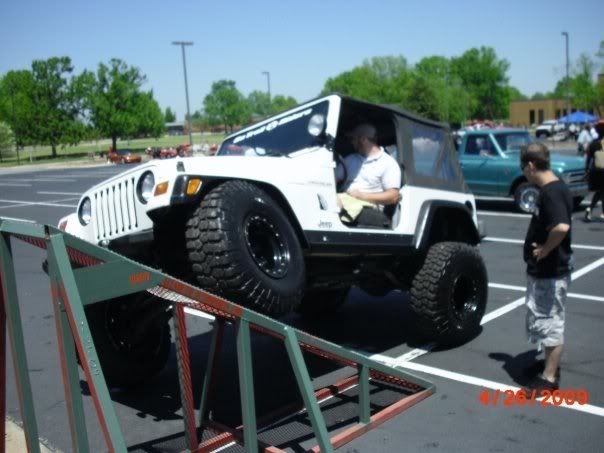

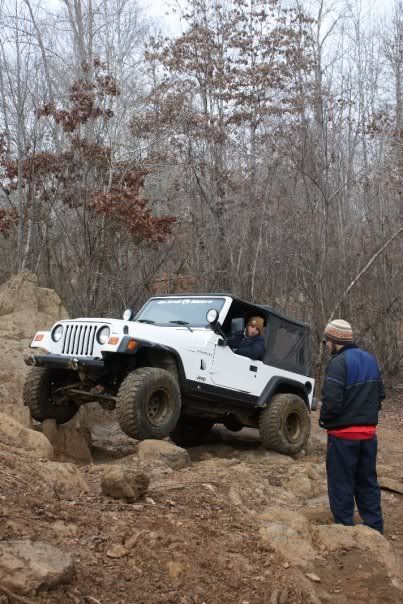

I quickly grew tired of hanging up on everything!!! It was also time to buy some tires, so I was not going to buy another set of small tires, if eventually I planned to run a 35. So i purchased a new set of KM2s. Of course everyone was asking, how will those fit with a 2" budget boost? What about your D35? "I dont know I will figure it out later...."
Tires on with 2" of lift.

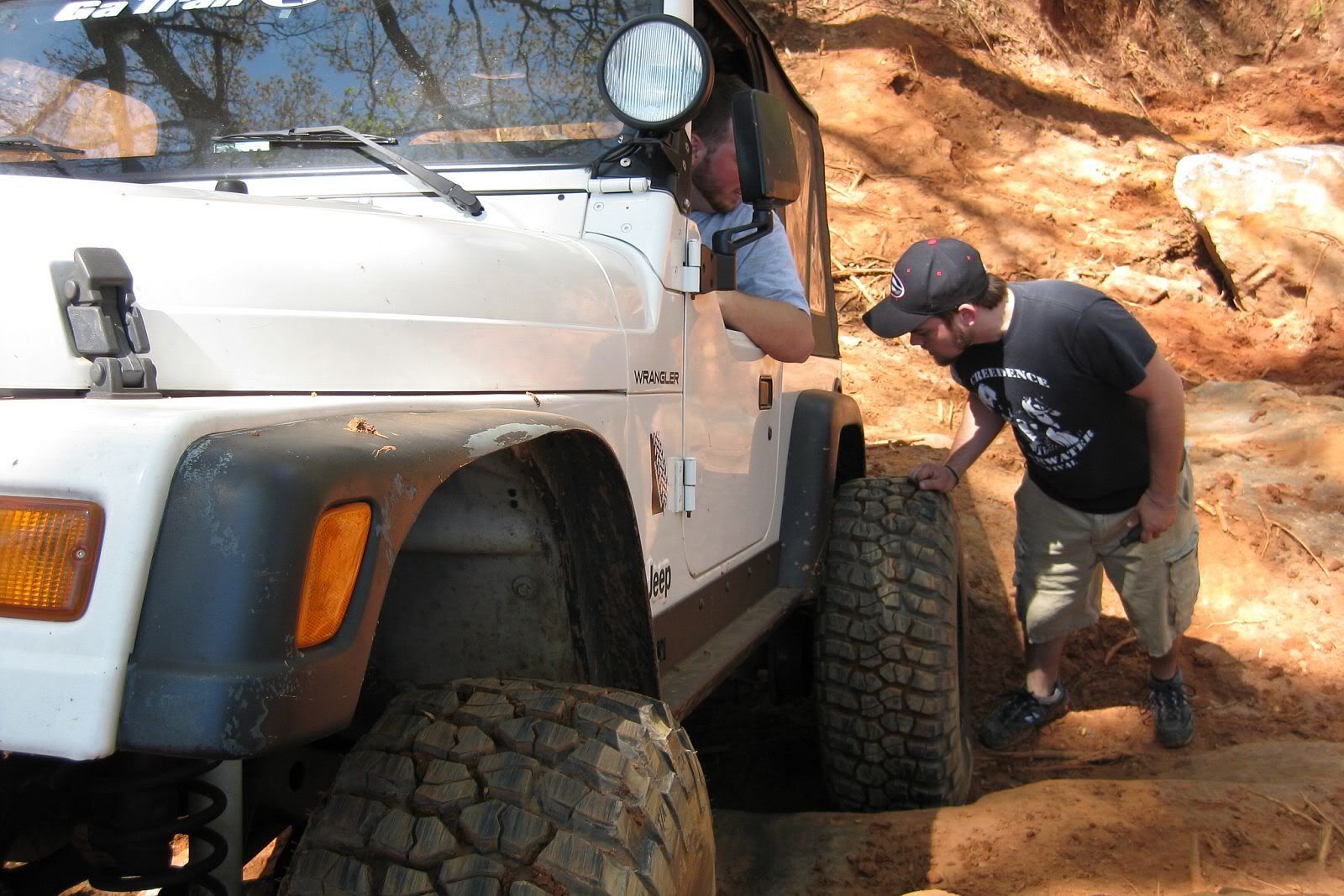

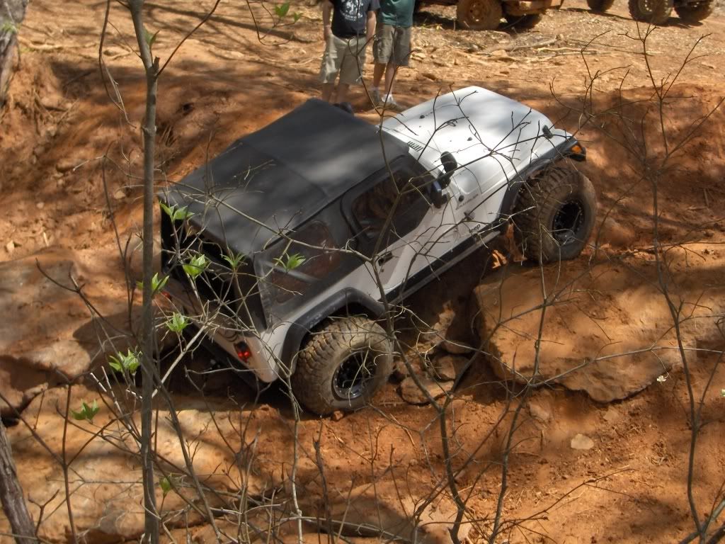

This was also the point of not wanting to take the jeep any higher. It was already becoming very annoying stepping up into it. And I just found out that my wife was pregnant. ooops....

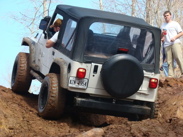

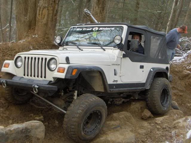

So to make the next wheeling trip I had to figure something out fast, so I added some hockey puck bump stops and a 1" Body Lift. Then trimmed the front fenders.
Everything seemed to work well with the 35s.
I made it to the ride....
Then this happened....
Which led to this...
So from that point it has been light wheeling only. Until I could figure out what to do out back.

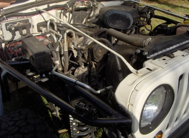

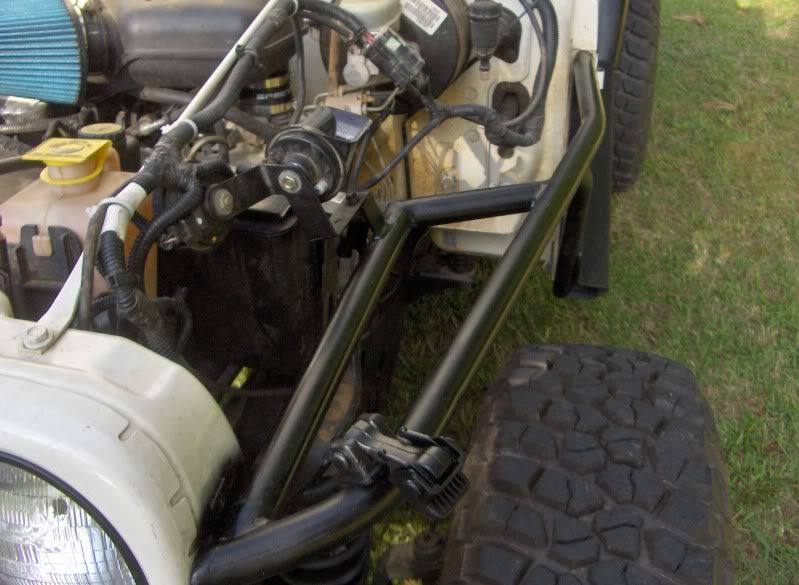

Now time to make a little more room for the 35s. Picked up some tube for the front fenders.
I kept my bends tight to the hood. In GA we do not have any enforced coverage laws so why not. I also took them back about 3" farther than most of the aftermarket ones. This was where I had the most clearance issues.
As you can see I also added some LEDs for the turn signals up front. I need to add some sheet metal to the outsides of the fenders, but just havent gotten around to it yet.

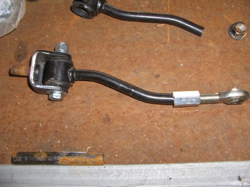

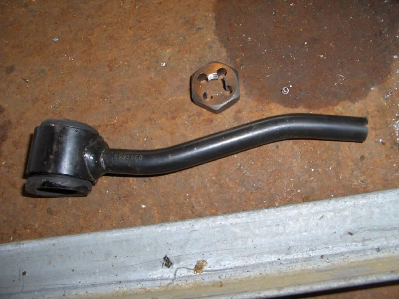

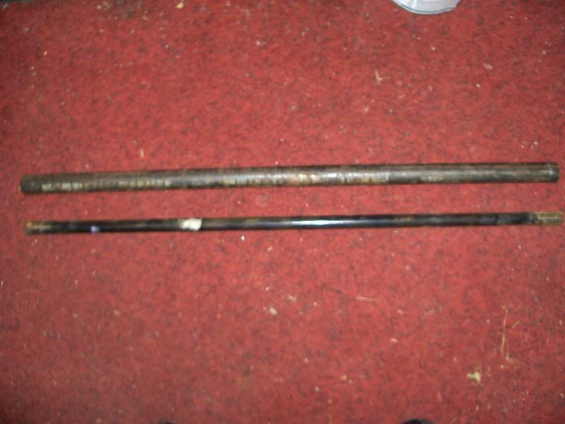

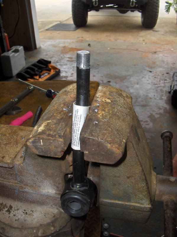

Better disconnects. These are much better than the cheap clevis pins. Plus they are longer, adjustable, and quite. Much better design. It took me a while to configure this. But when I realized that the shaft of the stock length was 1/2" and I had 1/2"-20 heims, why not just thread the end of the link, add a coupler and jam nut for adjustability. move the stock rubber bushing to the top, add a bracket and walla! $15

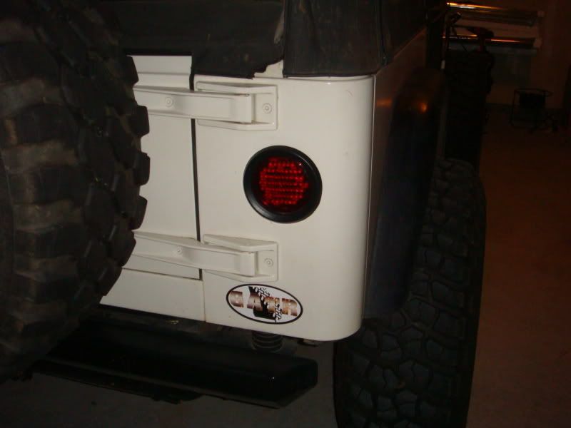

I added some LED taillights a few weeks back.

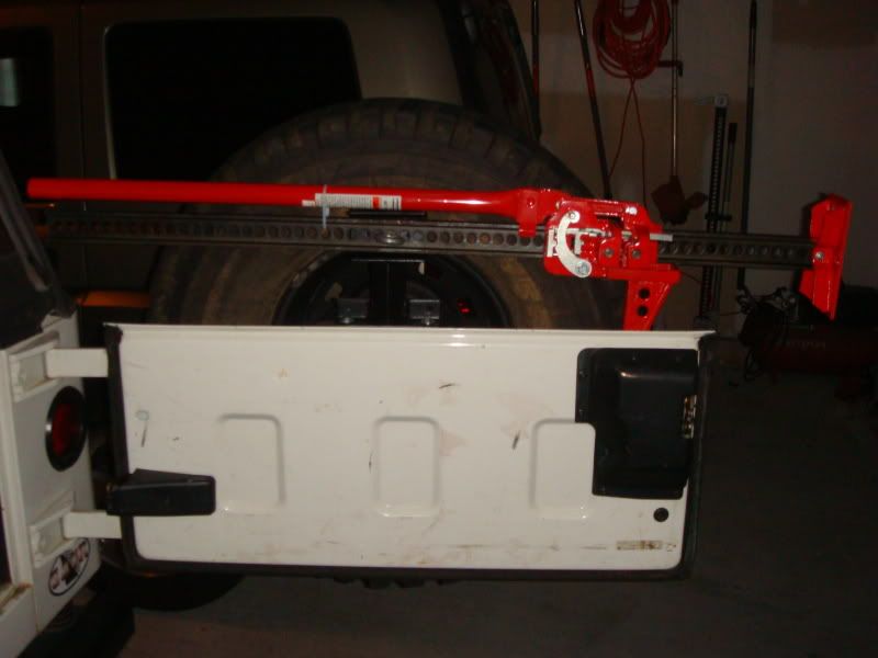

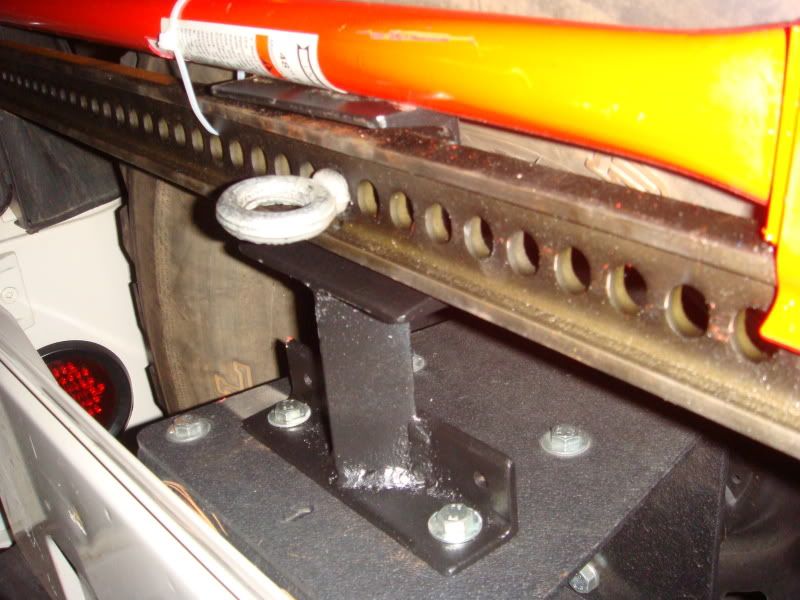

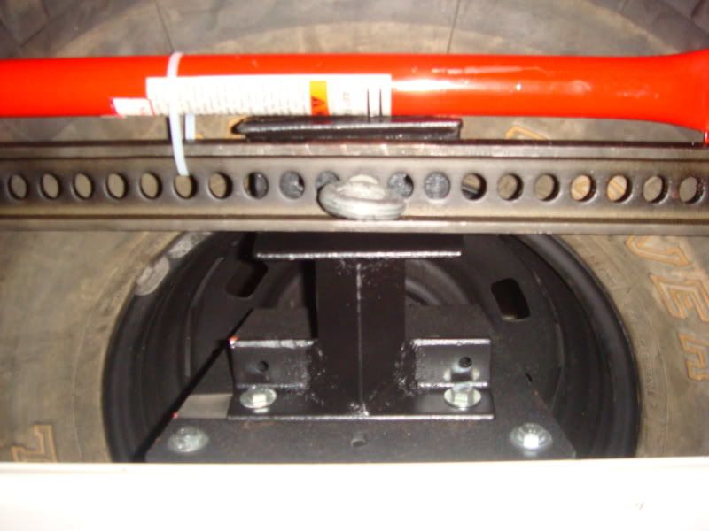

Also made a mount for the high lift jack out of some scrap.

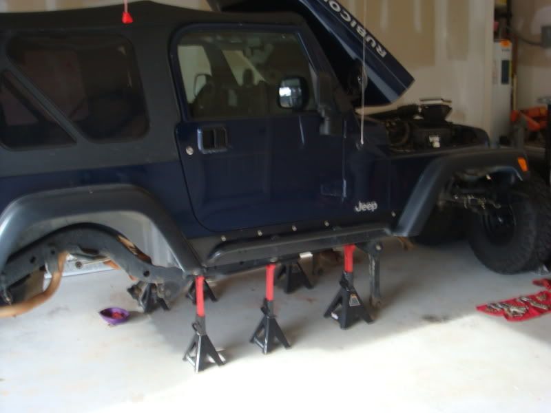

Finally got my own garage, attached to a house.

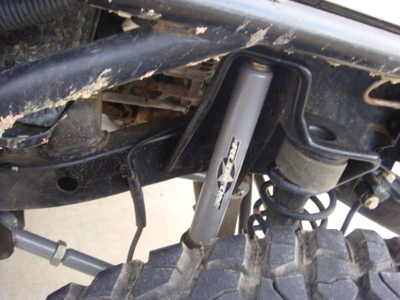

So first project in the new garage was installing Rubicon Express adjustable control arms, track bars and even longer shocks.
Also picked up a rear D44 that will go in maybe next weekend.
