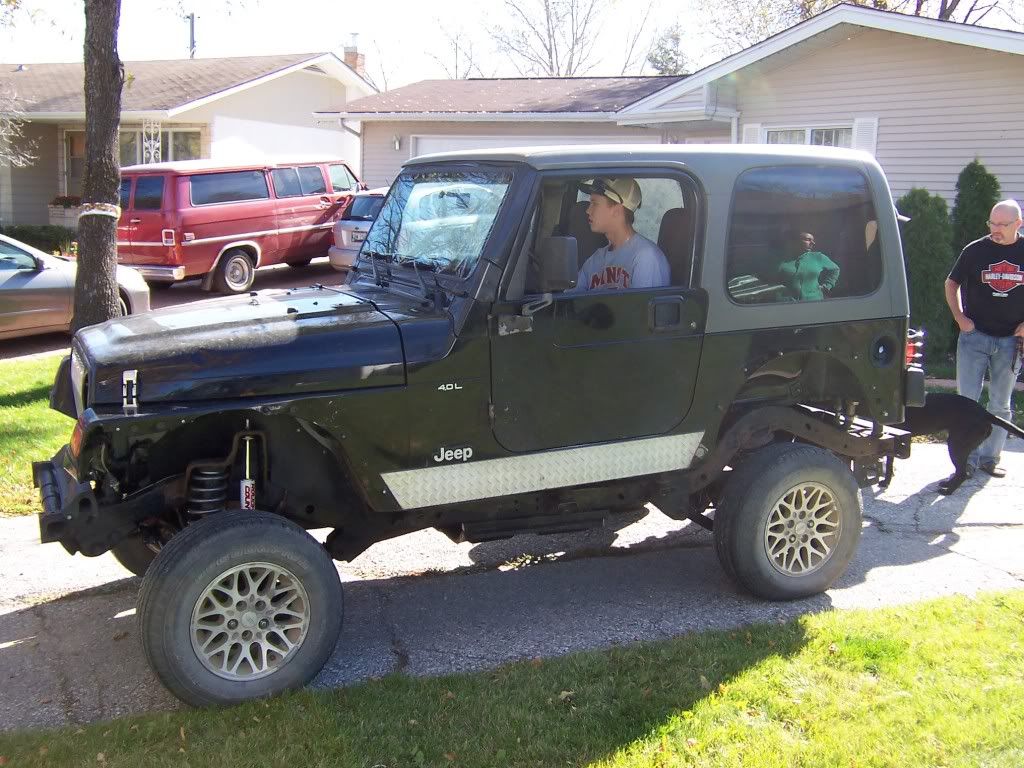

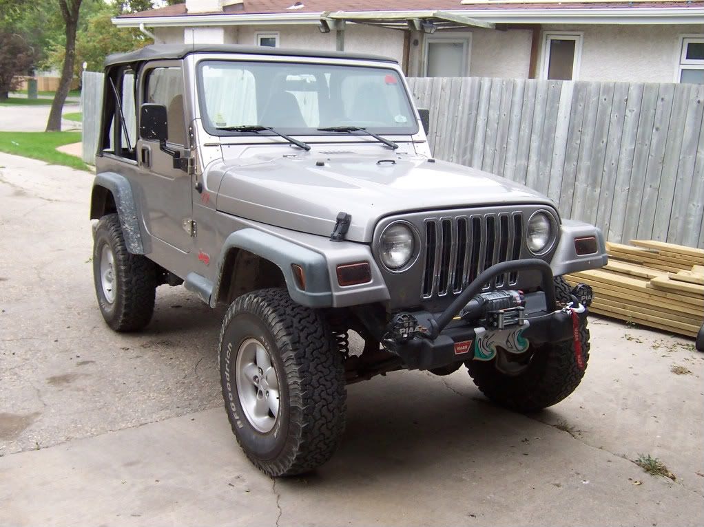

Here are a few pics from last fall when the PO dropped the Jeep off, and I forgot to mention before, the Heep had a 3" BL man with ~7" lift those stock size tires look tiny..
The nice thing about this purchase was I was able to drive the Jeep and confirm the function of everything. Man that motor purrred

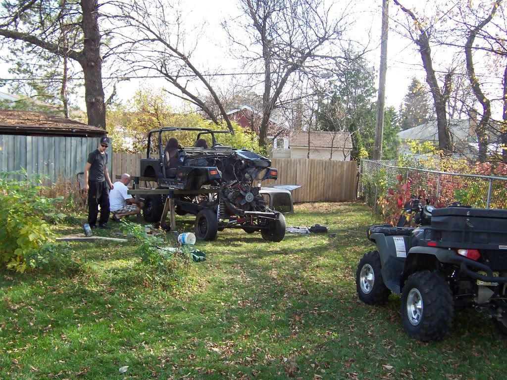

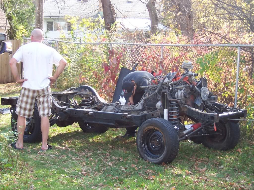

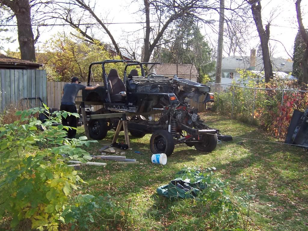

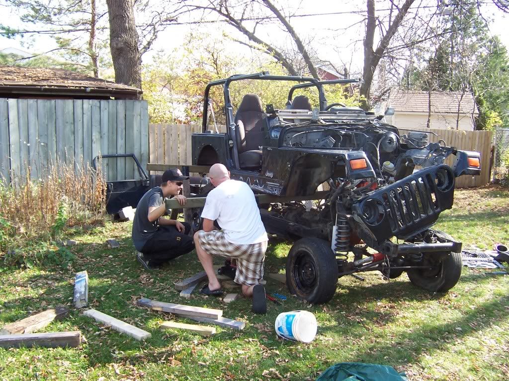

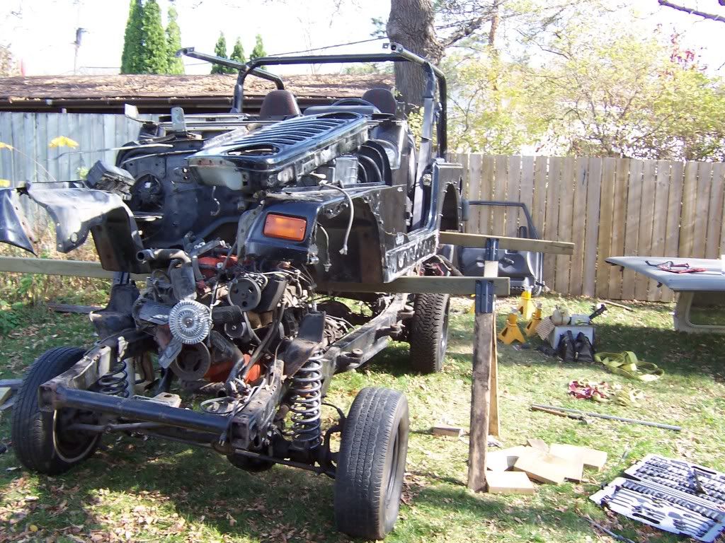

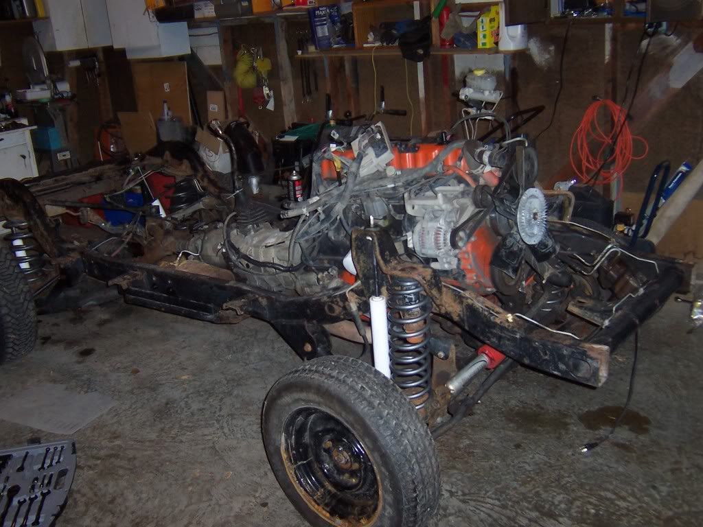

I started out by lifting the body off of the frame, I originally thought I was going to be swapping the bodies/frames but either way I'm happy to be doing a frame-off so I can clean everything up underneath. Considering what it was used for (trail rig) there was minimal rust and damage.
I started by removing:
-wiring harness connecting motor to bulkhead harness
-steering linkage
-coolant lines, radiator, etc
-emergency brake cable
-all the emissions stuff
-removed hood and grill
May have been a few more things but thats what I can think of off the top of my head. Here are a few pics of actually raising the body, we jacked up the front and rear separately and places horses underneath to support the body when it was high enough off the frame:
pulling the frame out from underneath..
I'm very lucky to have my dad help me out with this project, he's been wrenchin' cars since he was 15, and still has his first car he ever owned, a '66 Mustang Coupe which has recently been restored (will post some pics of it later)

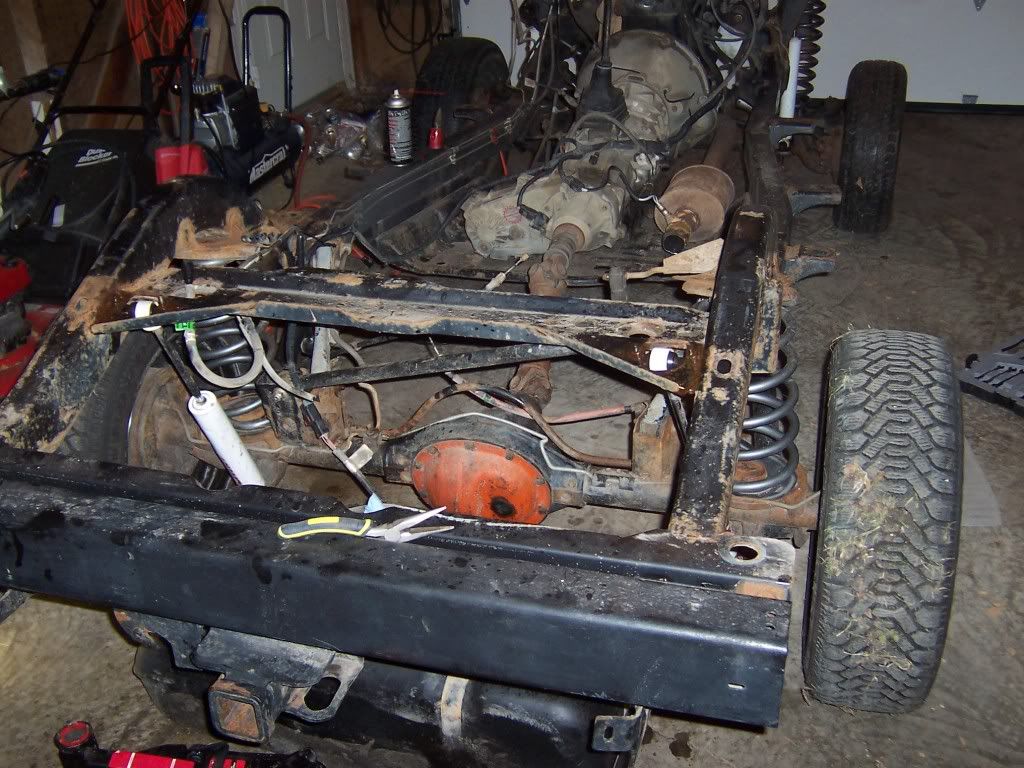

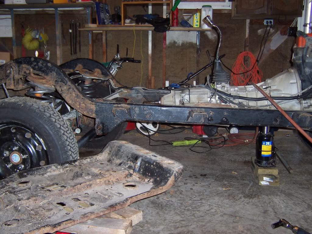

We got the frame in the garage for the winter so I was able to do a little work while it was cold out. I will be wire wheeling/sanding the frame down and coating the whole thing in Chassis Saver. Everything appears to be perfectly straight so it shouldn't be a problem to get it inspected and insured.

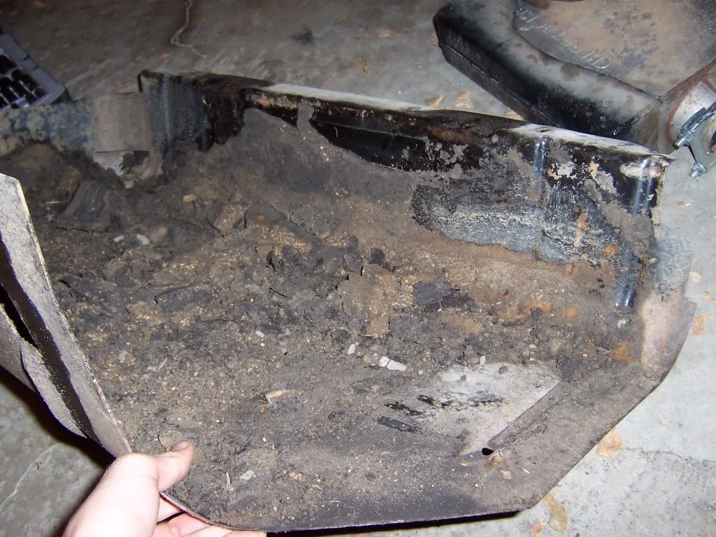

Started off by removing the gas tank and transfer case skids, my plan is to mod the gas tank skid while I have it out (according to this thread http://www.jeepforum.com/forum/f9/st...arance-736901/).
Gas tank dropped:
T-case skid dropped:

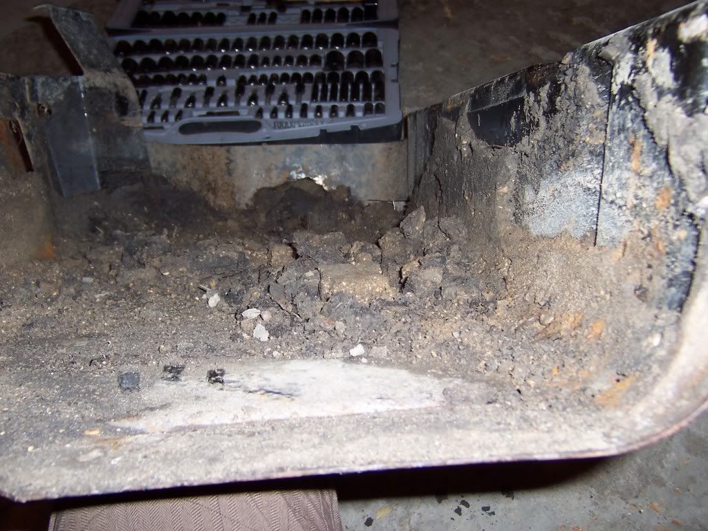

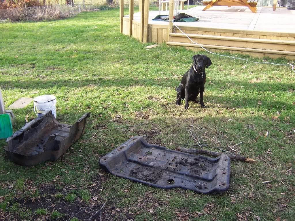

There was TONS of dirt in the gas tank skid. Apparently the jeep had been sitting in a mud hole for a while..hence the reason for the rebuilt motor and axles:
Had a little helper while I was washing the skids out..

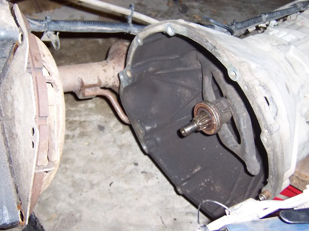

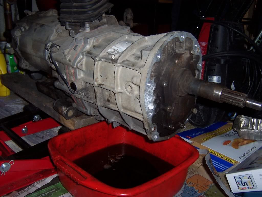

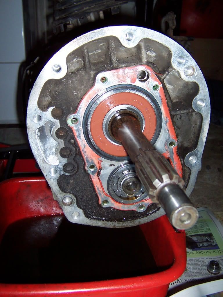

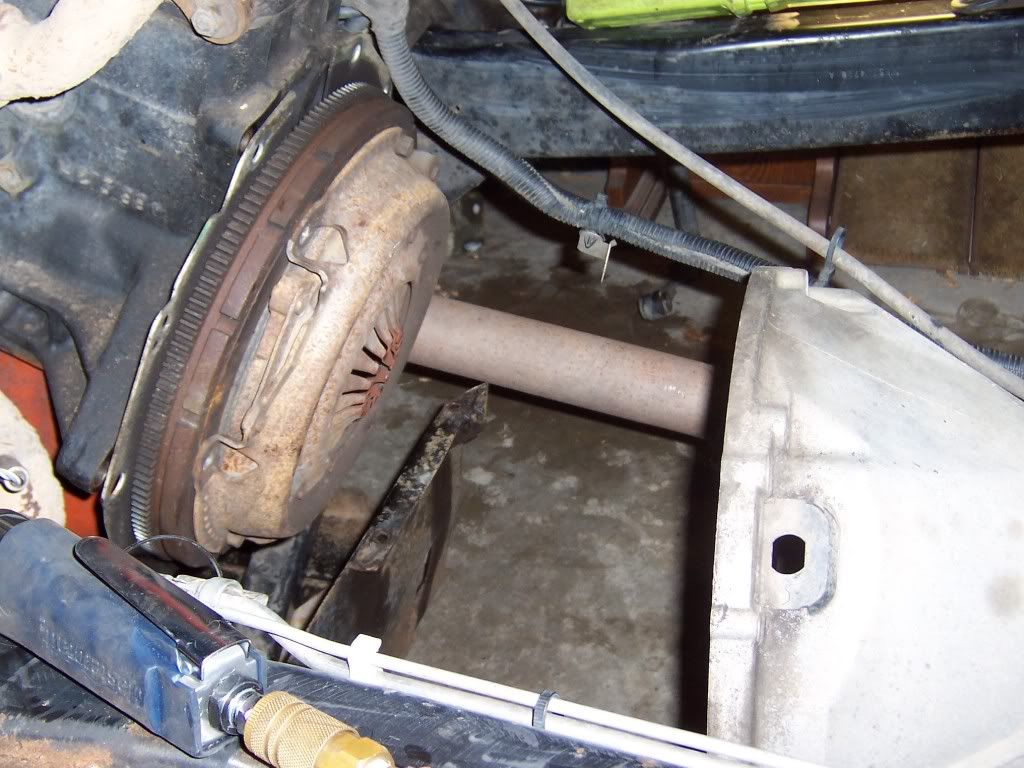

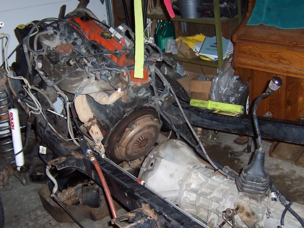

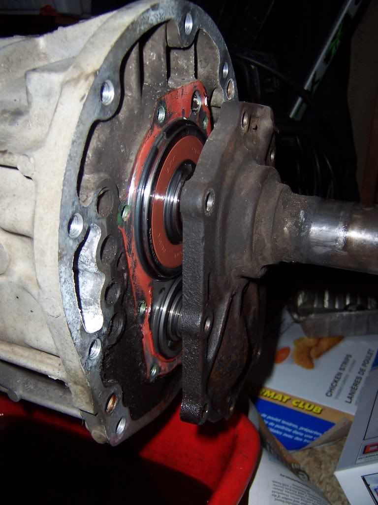

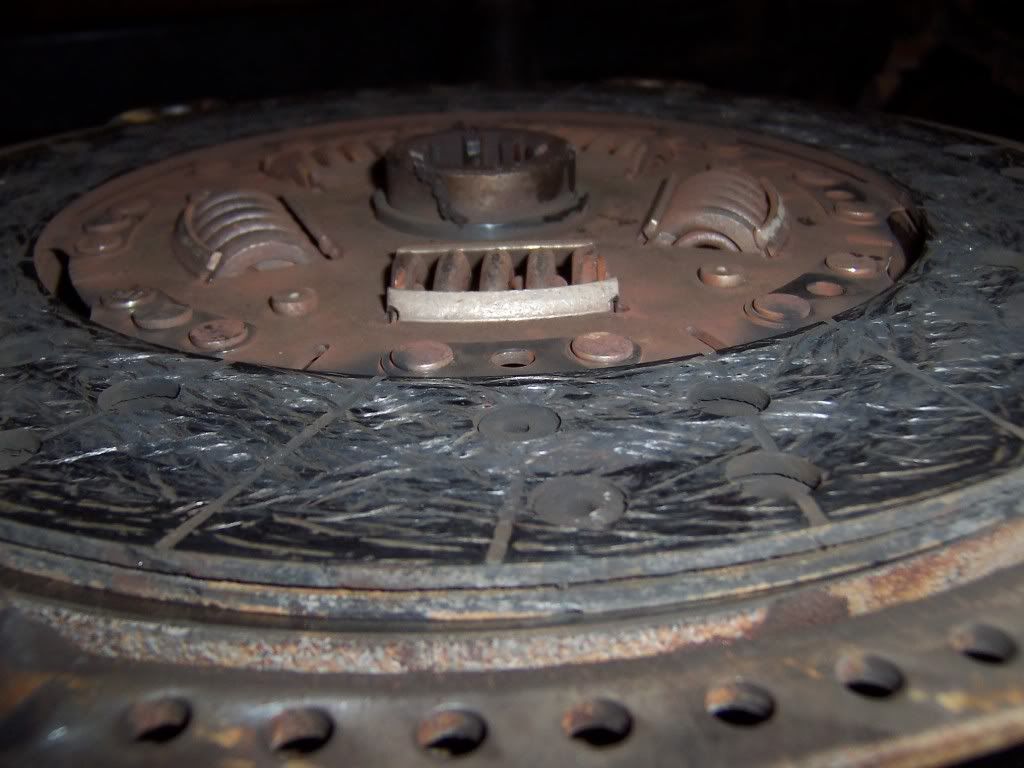

Last Fall we pulled the tranny/transer case and split the bellhousing
The clutch appeared to be in decent shape

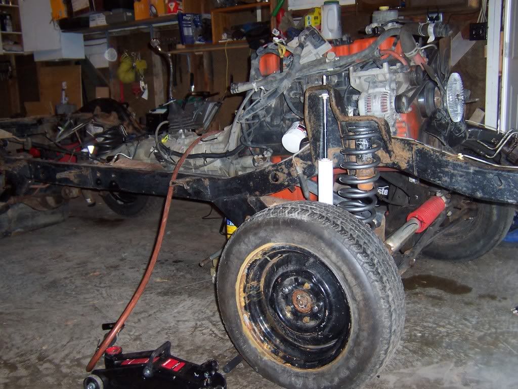

Removed the old RC Hydros today, just recently I purchased a set of 3 Bilstein 5100 shocks. The 4th one leaks so I have to buy another one. I got the 3 for $60 and they came off a show truck. Basically they are meant for a TJ 4" lift but they were put on a SEMA JK and eventually parted out. 3 out of the 4 are fine, so for ~$150 bucks I'm getting a nice set of new shocks to go with my RC lift.
Today I also replaced the clutch and re-installed the transmission/xfer case. I am hoping to get this frame painted asap so I can put the body back on
