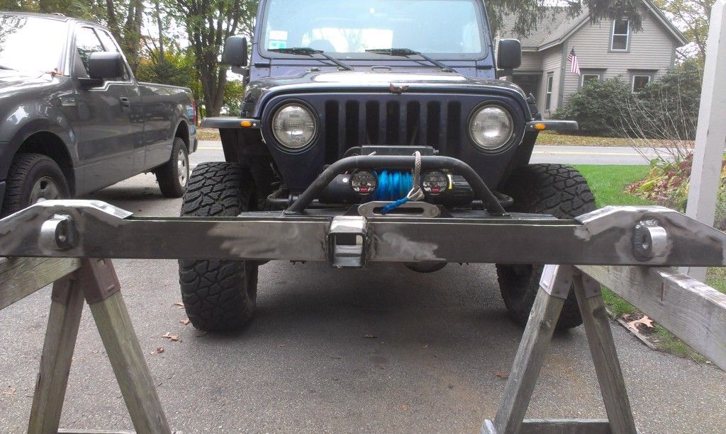

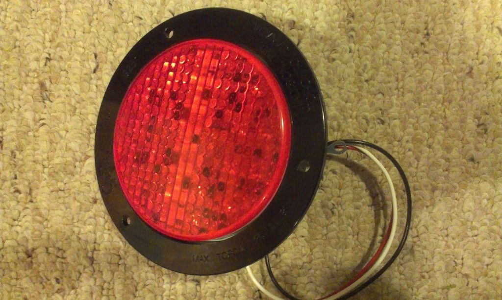

New lights. Gonna delete the license plate bracket thing as well and just secure it to the tub with some stainless steel button head fasteners and some bolts lights.

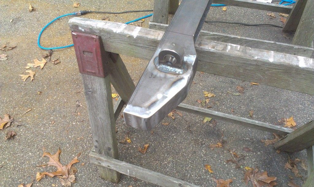

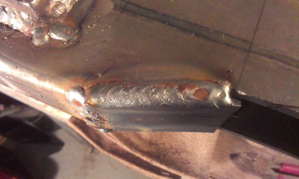

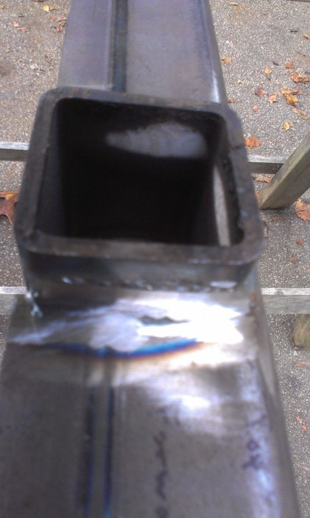

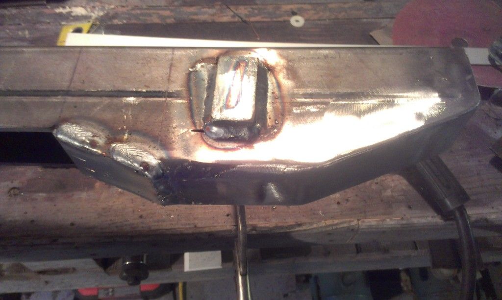

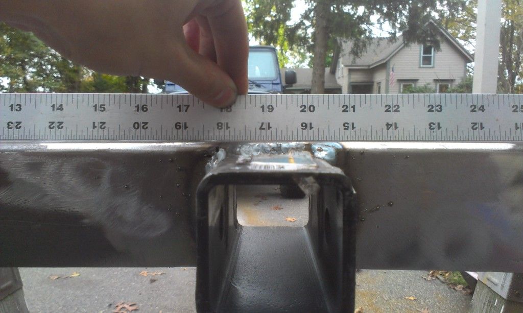

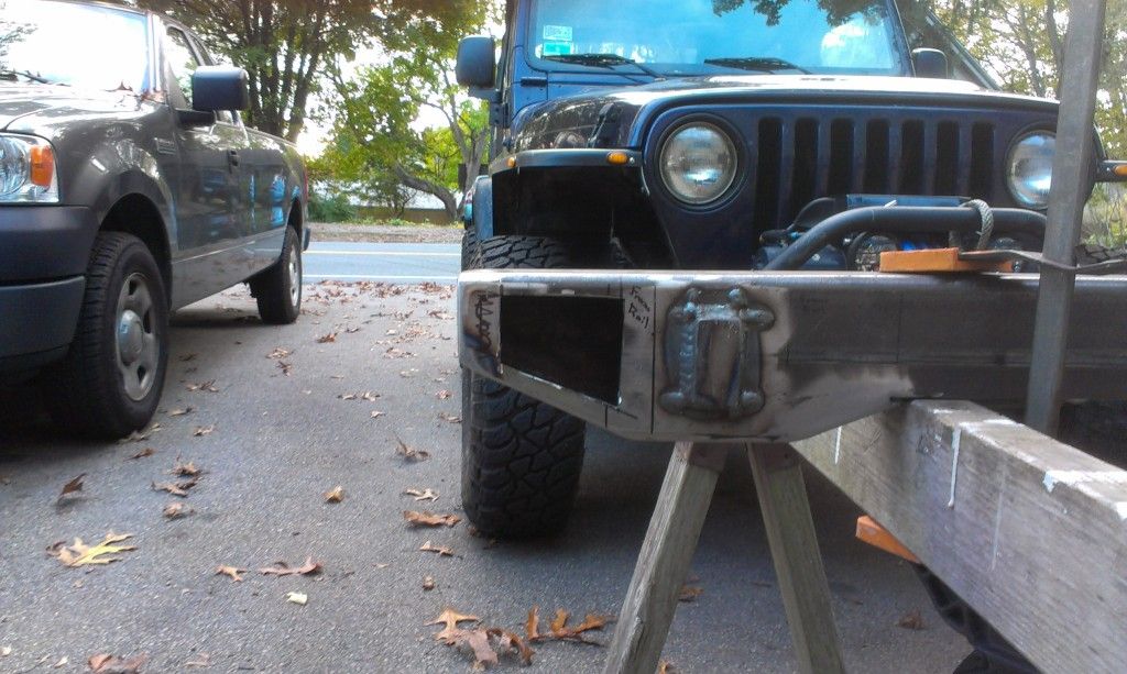

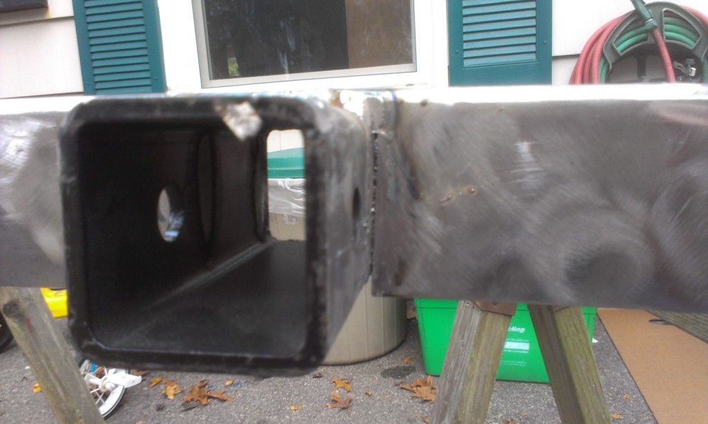

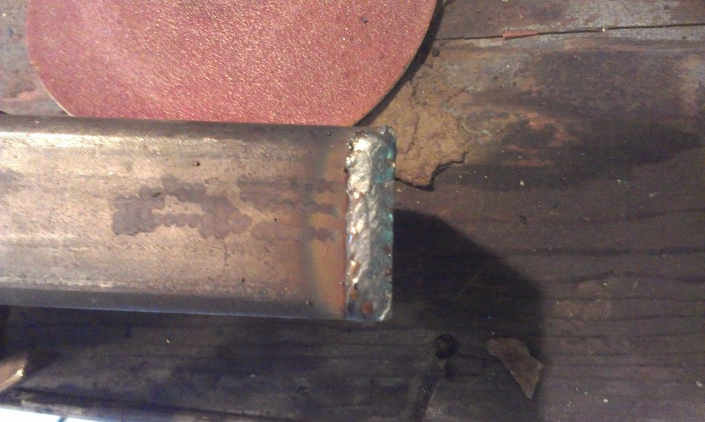

Alright some progress, albeit not very much:
Kept working on boxing it in:
I didn't get any feedback on how to fix this issue,
So, I took a guess at the correct solution and did this
Cut along the hitch tube with my handy craftsman battery powered sawzall:
Hit it with a hammer till I was satisfied and JUST tacked it in this time
And back to boxing it in:

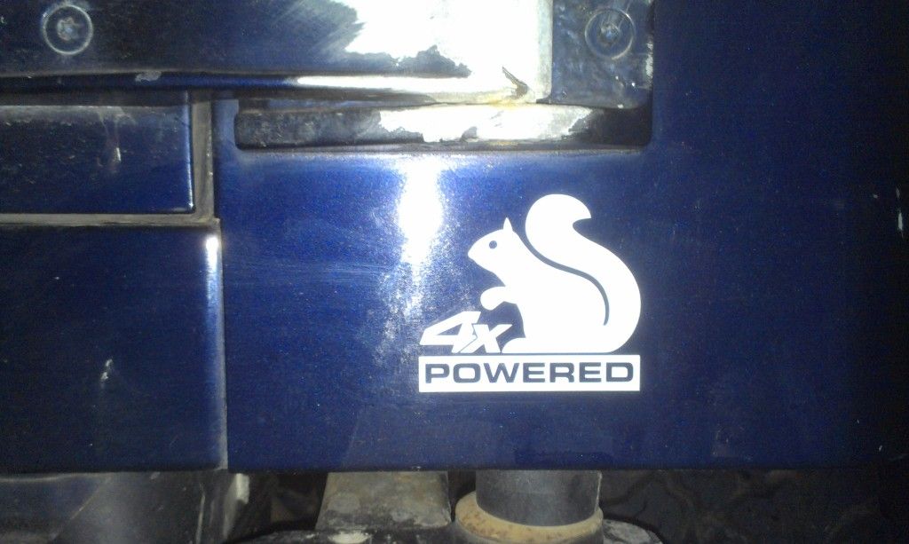

I forgot my favorite mod of the day:

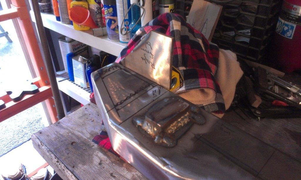

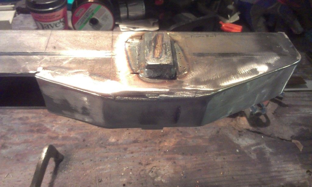

Did a lot more thinking than fabbing today. Getting to the stage where screwing up could be very aggravating.
But, finished boxing it in minus the bottom, because that has to be very accurately drilled for studs or welded nuts.
Mocked up "wings"
Body bolt access:

You have done a nice job teaching yourself to weld and fabricate . I have ran straight CO2 before , but I prefer a 75/25 mix. The weld still burns in and there is a lot less spatter . Might be something to consider next time you get a bottle filled . I feel bad for you guys up north and the rust , thats some aggravating stuff to deal with . Keep up the good work .
G Beasley is offline
post #74 of 147 Old 10-28-2012, 10:17 AM Thread Starter
sailsurf7713
Location: Rhode Island
Posts: 1,117
I've welded with 75/25 and 90/10. I always go back to straight CO2 and my machine is small, just 180 so I like the extra penetration. Thank you for the recommendation though. Maybe when I go to a bigger machine I'll switch because I won't be as concerned about getting adaquete penetration.
Also, thank you for the compliment, I'm getting there and I'm having a really good time along the way.
I'll keep some pictures of that sahara with the hole in the side of it coming so this thread doesn't die down. Its getting some cool stuff. Gonna have a Safari sort of look to it when finished.

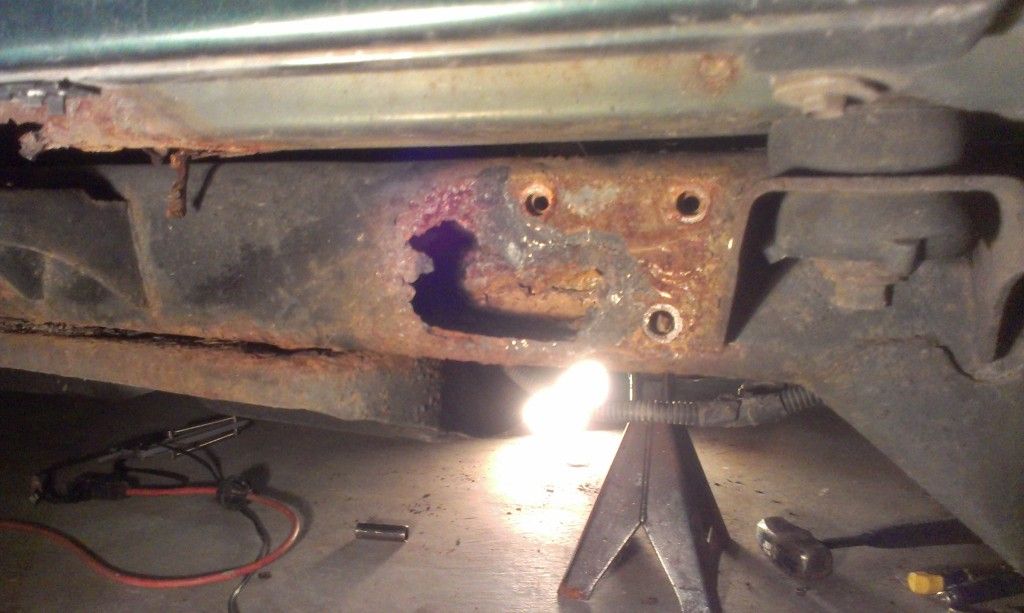

whats your plan for the middle body mount? I need to fix that too. My frame is ok because of my insane cleaning but I missed the torque box.
