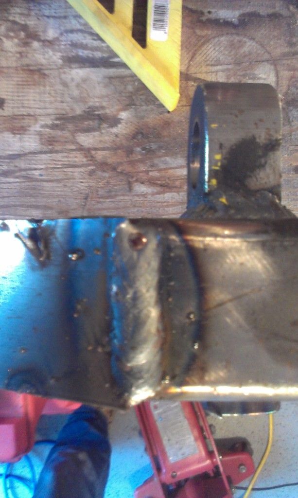

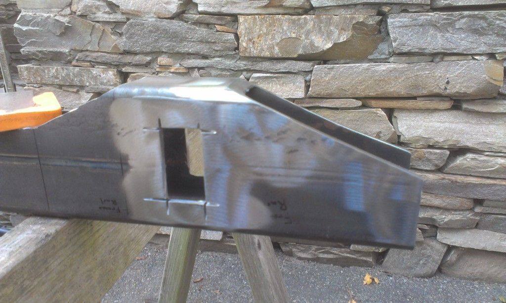

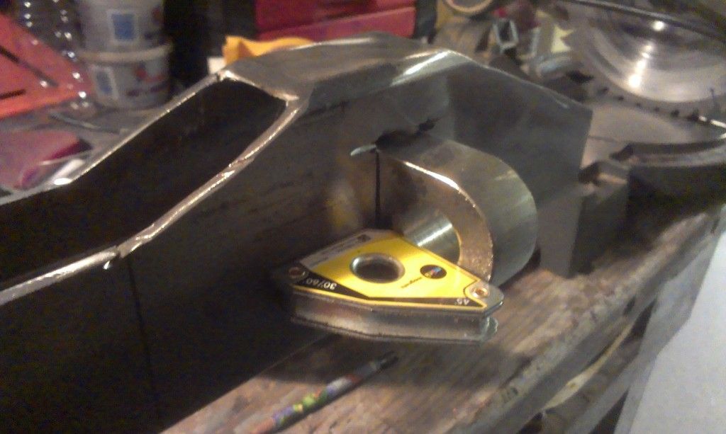

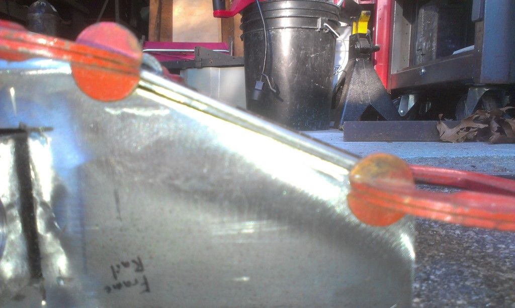

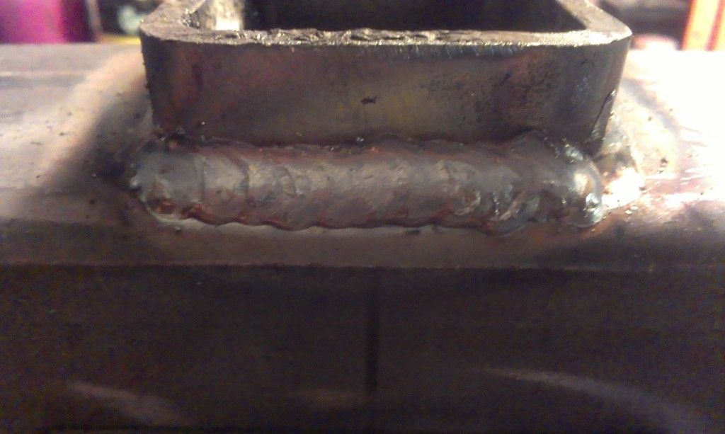

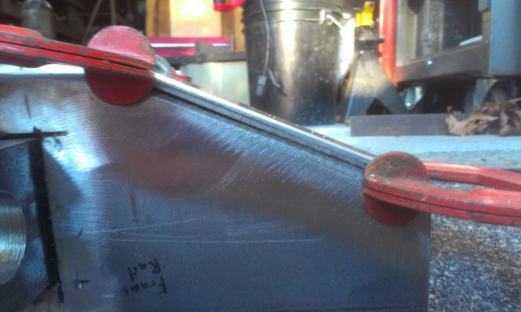

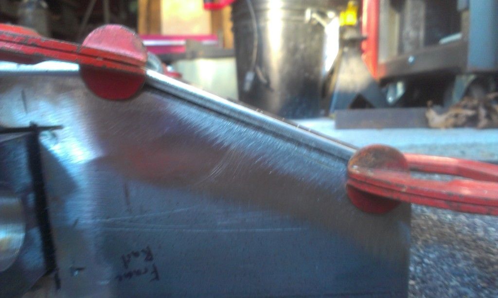

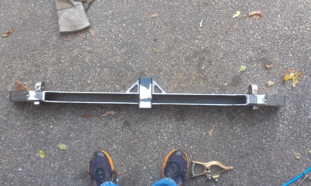

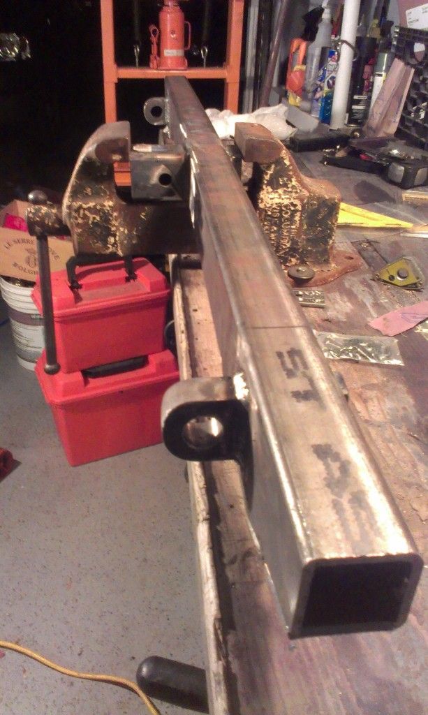

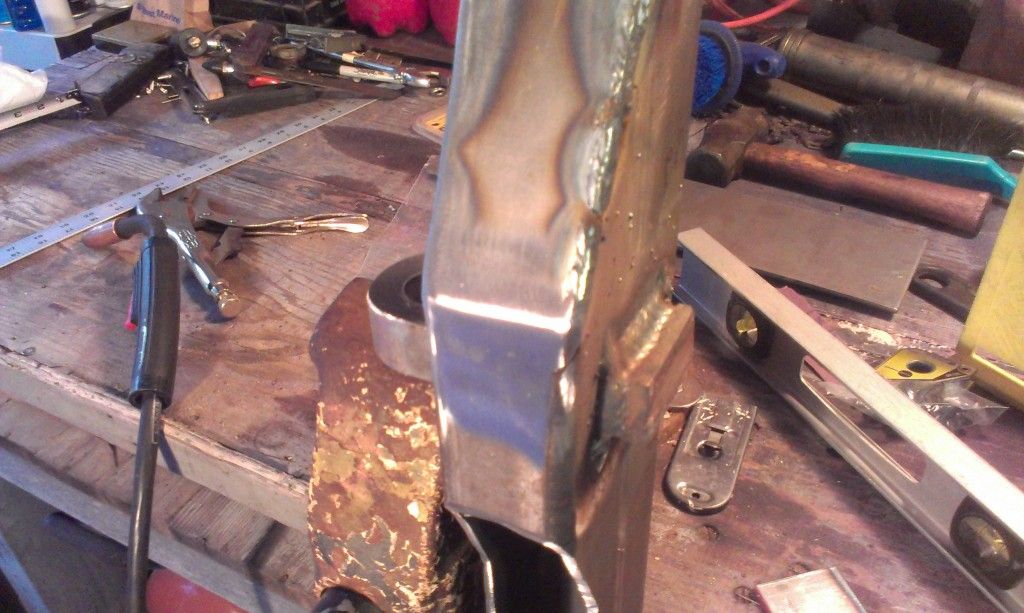

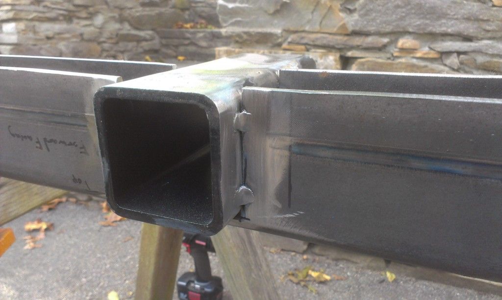

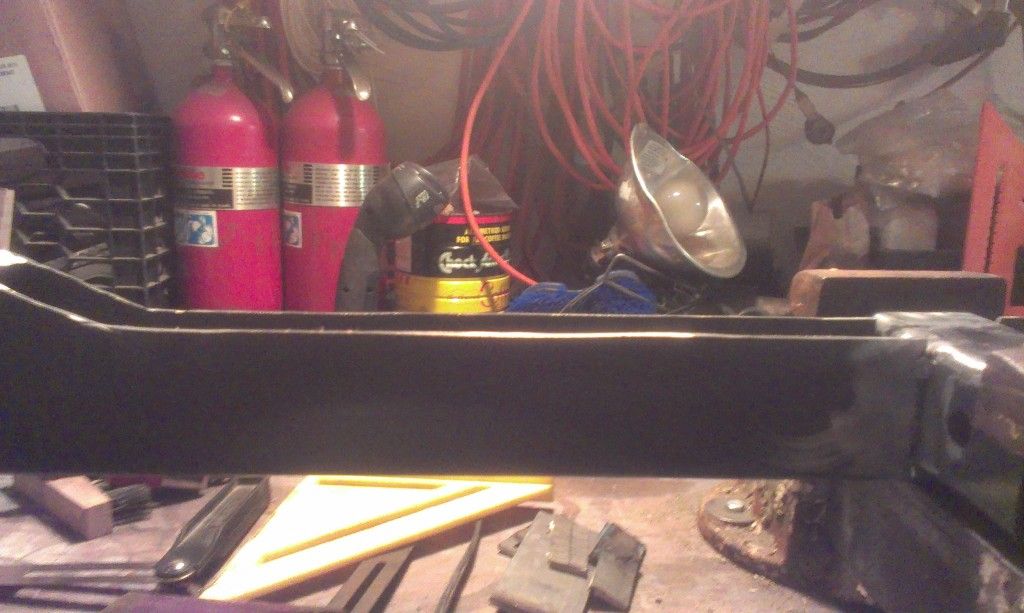

Crossmember done. Not the best I can do, so planning on building another, but it'll get the job done for the moment.
I'll try to get the front done first.
Also planning on actually getting around to the front control arms. I'll be doing them in pairs, bottoms first, and uppers last. Torn on joints though. Johnny Joints or take a chance on the Metalcloaks?

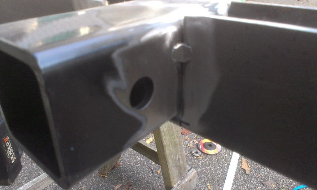

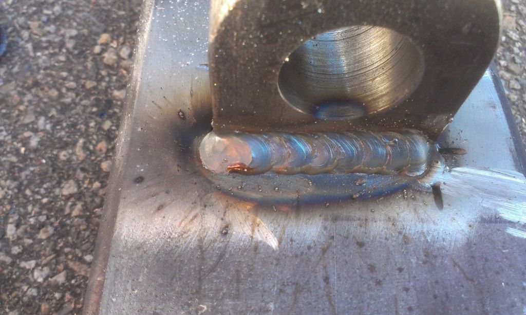

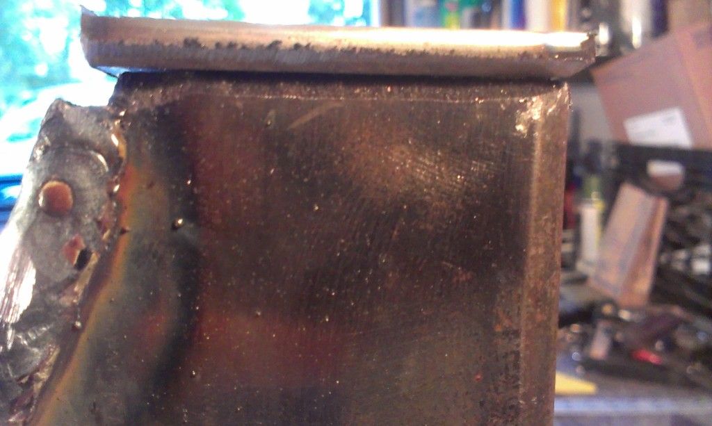

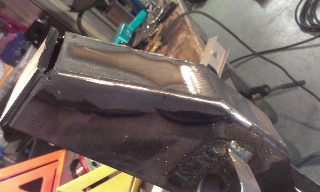

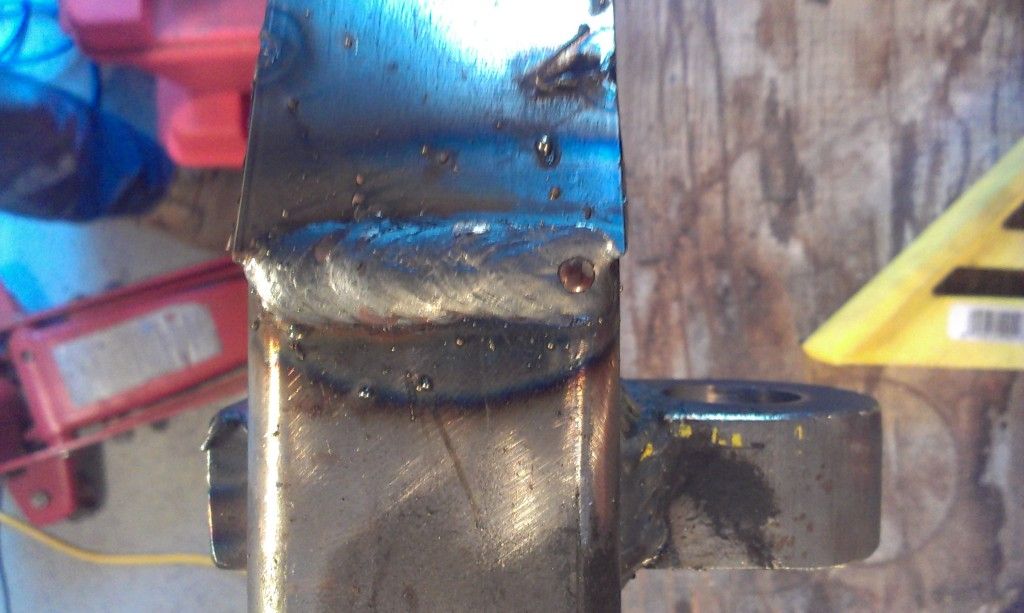

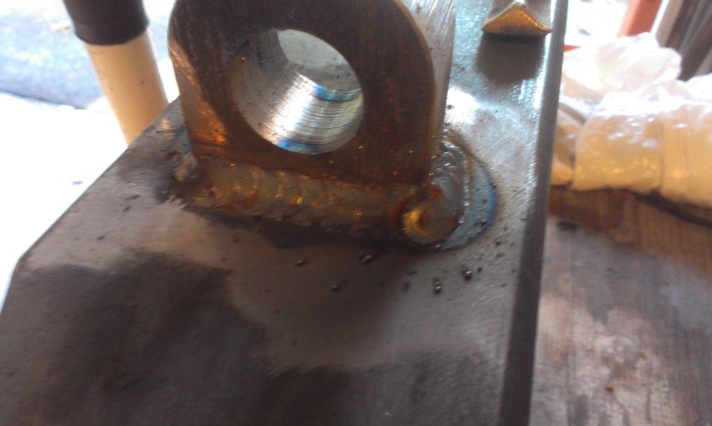

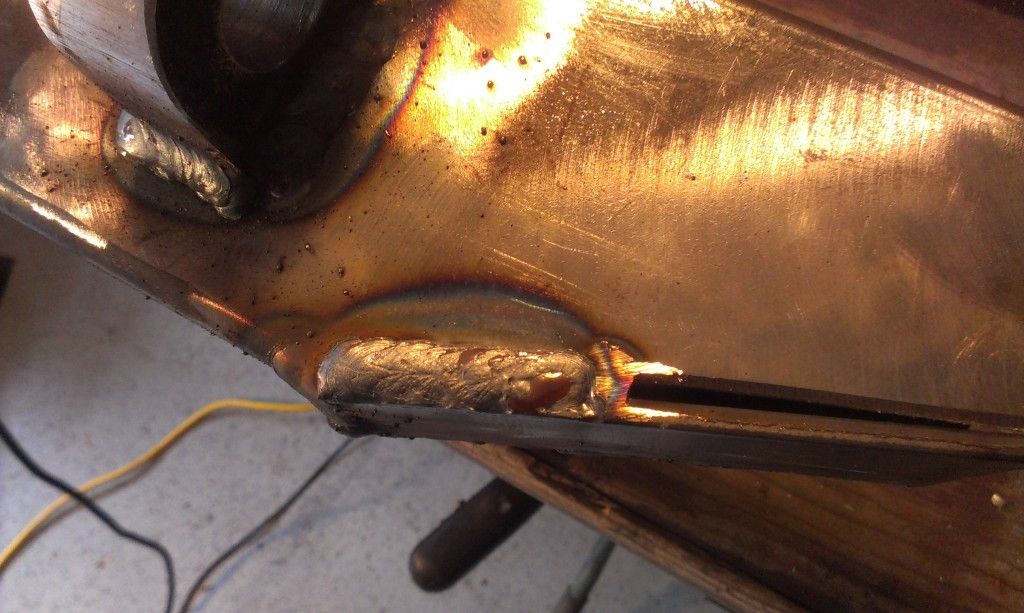

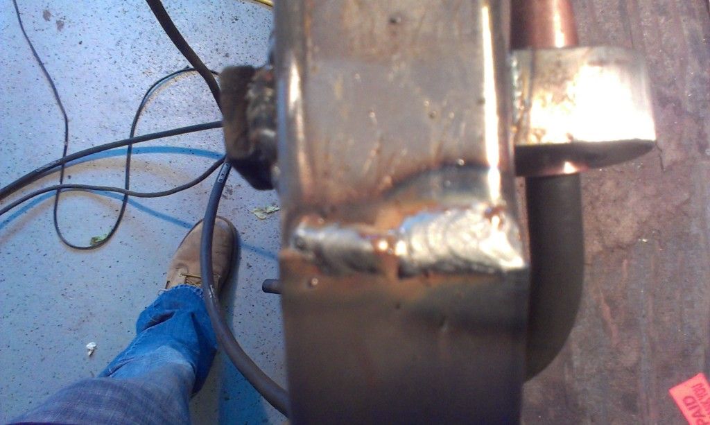

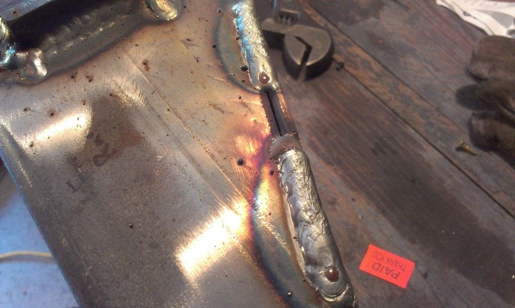

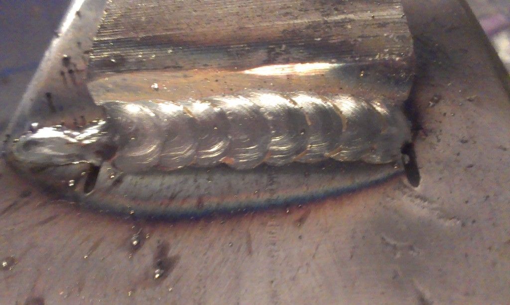

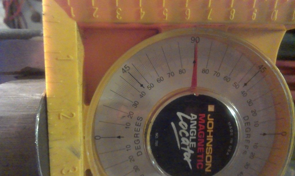

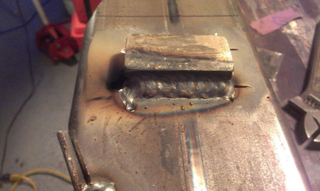

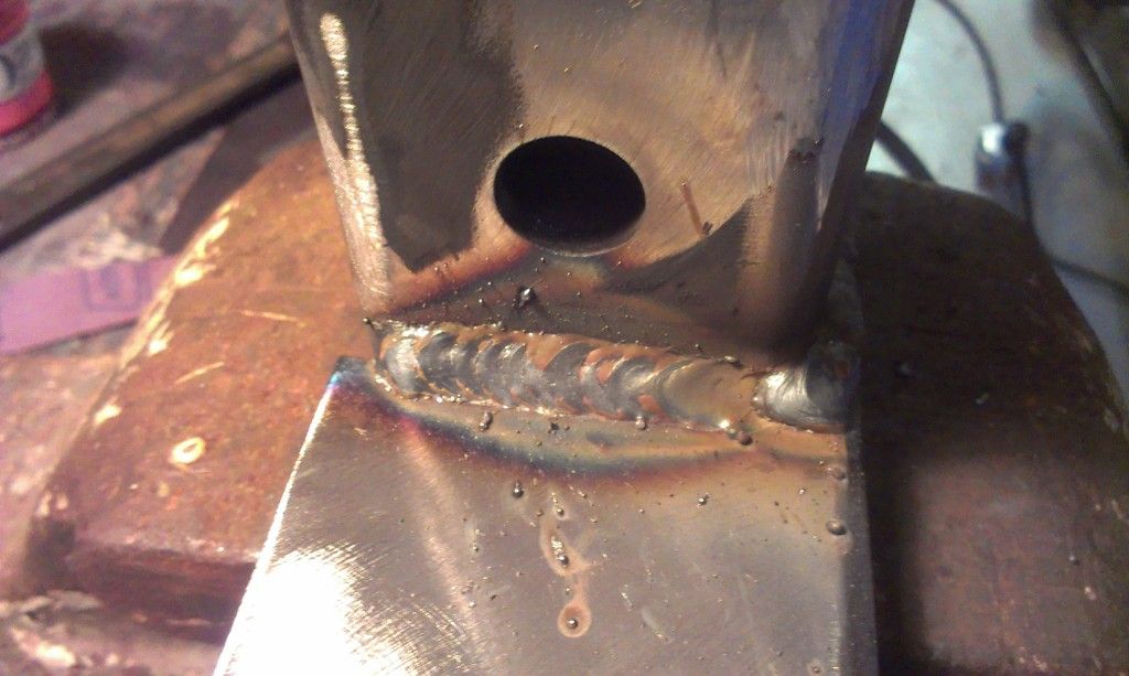

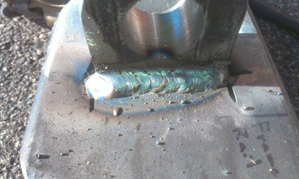

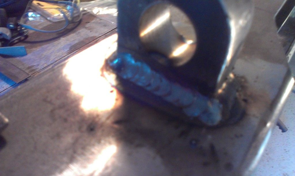

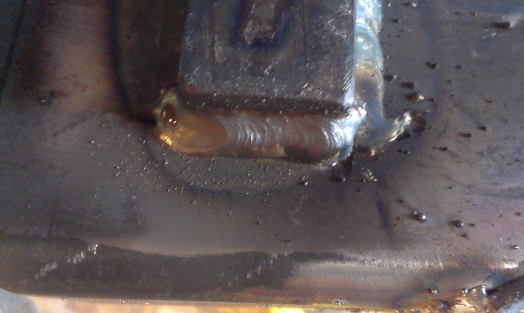

I warped it. So I cut reliefs in it and butt welded it. The welder I was using when I did the final welding had a leaky gas line that I didn't notice at first, I got frustrated and warped it a bit the other way :laugh:. Also the D rings don't sit quite square, about 3 degrees off. I'm not concerned about strength due to the butt welds, because only trailering will put stress on them and my heaviest boat is in the 600 lb range. It will work for now, but I'm a bit of a perfectionist, so I'll try again. It was my first attempt at fabrication, so I can't be too disappointed I suppose.

Great build! I think a bumper was the first mods I did when I had my CJ and I did the exact same thing regarding warping:laugh: I had to notch and redo mine as well.
