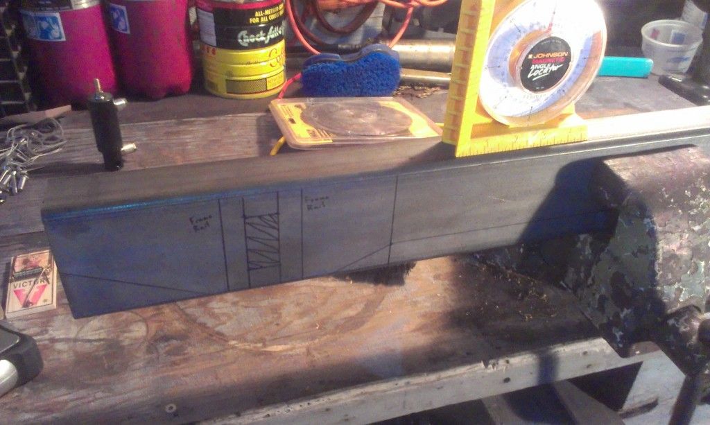

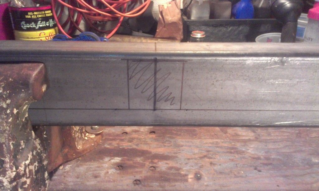

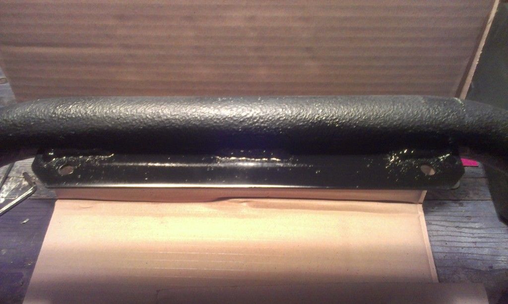

Well. My inexperience has once again gotten the better of me. The piece isn't quite square and I made the mistake of burning in the hitch tube. So should I grind the side welds down (on the hitch), cut them, square it again and weld again? I think that is ideal, but I could also cut down just outside those welds, square, bevel and weld together again. Ideas? I need to buy a welding table. Working on a vice attached to a warped wooden work bench is far from ideal.

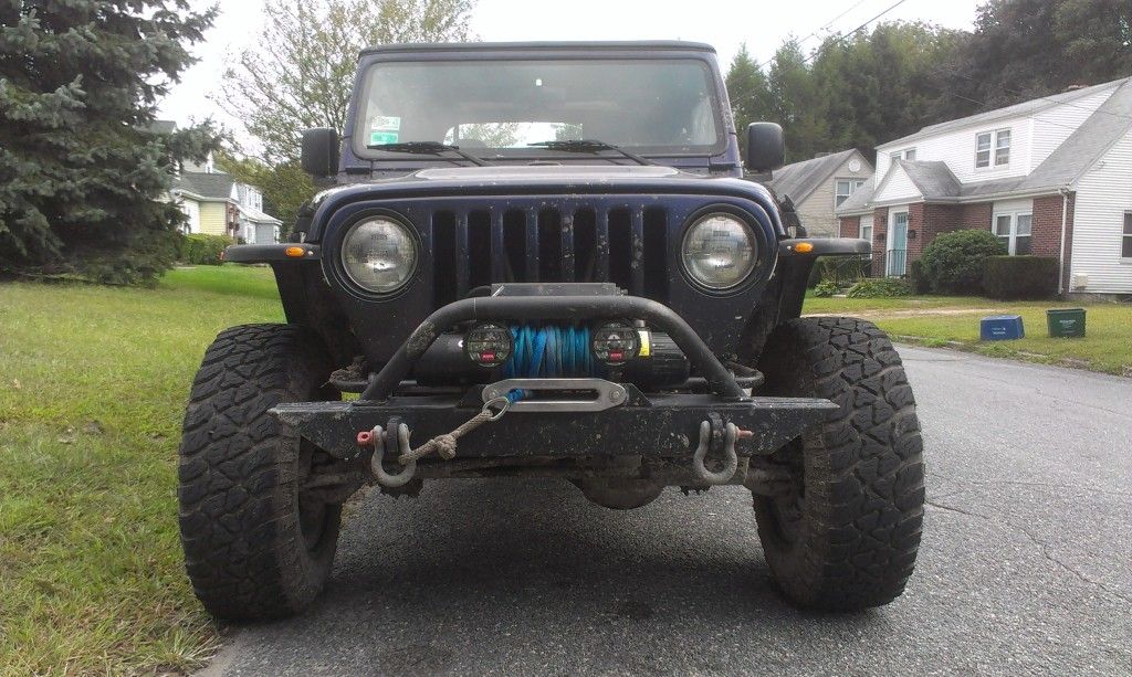

Got the Warn fogs wired up. The whole wireless control is a bit odd, but it saved me some time during installation. Gotta make it look up to my standards so no pictures of the wiring

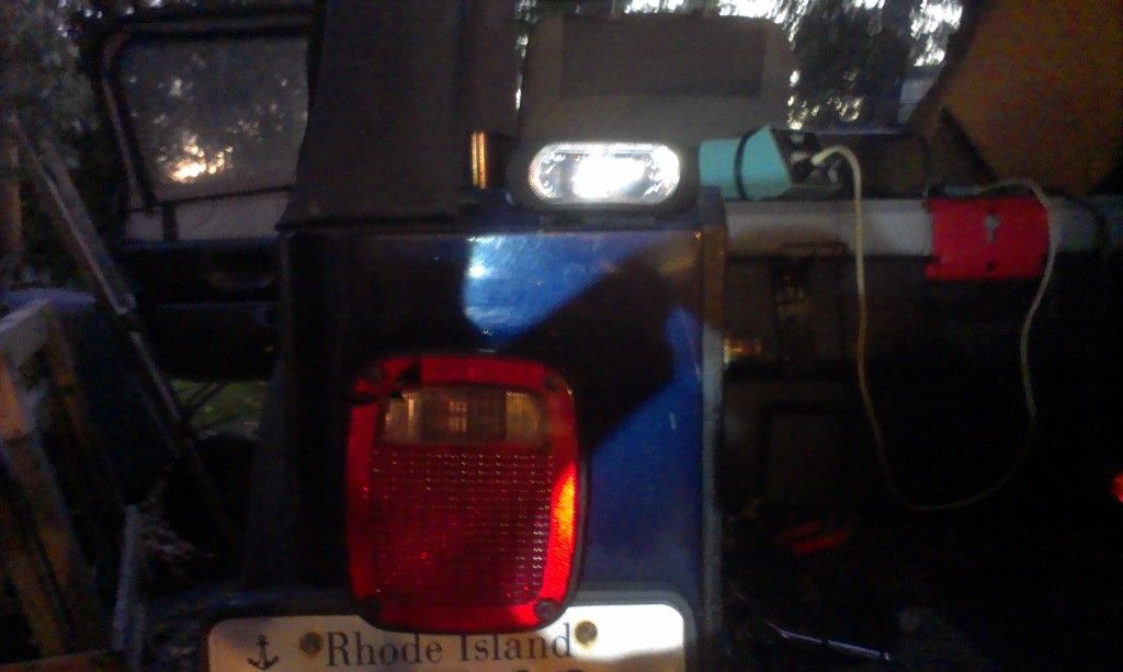

Then moved to the back of the jeep to get the smashed tail lights removed and the license plate bracket deleted. All it took was a jig saw, a little liquid courage and some masking tape.
Big improvement in visibility over stock. Nice clean look and hopefully less likelihood of smashing them up on trees. Very happy with it.
