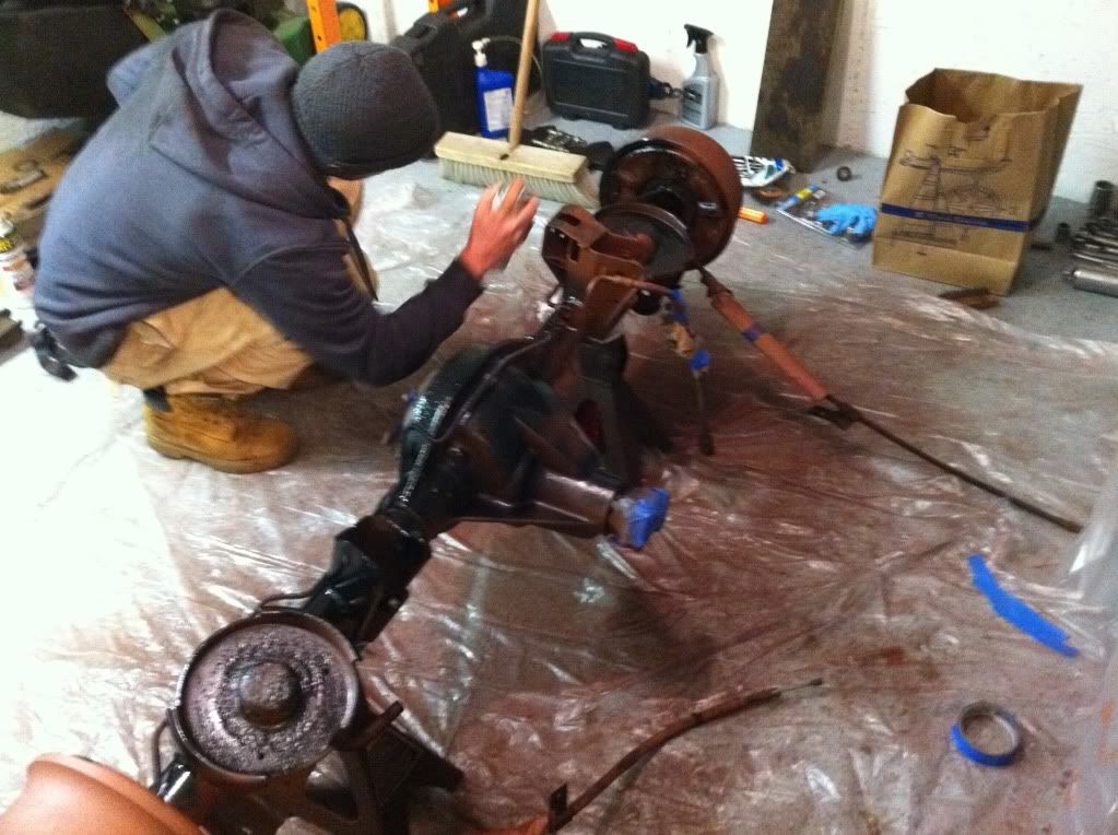

The rear pinion bearings in my turdy five were over torqued by my last ever mechanic and about a month later sounded apocolyptic. Out came the axles and in a desperate act of complete stupidity and ignorance I rebuilt the Dana 35....myself.
It got TrueTrac LSD, 4.56 Superior Gearing, and Superior Discovery Chromolly Axle Shafts.
Prettiest this turd will ever look.
The 30 got matching gear set and a full diff rebuild, and my Jeep was back on the road. Took it out the night we finished up with no top or doors in 18 degree weather.
