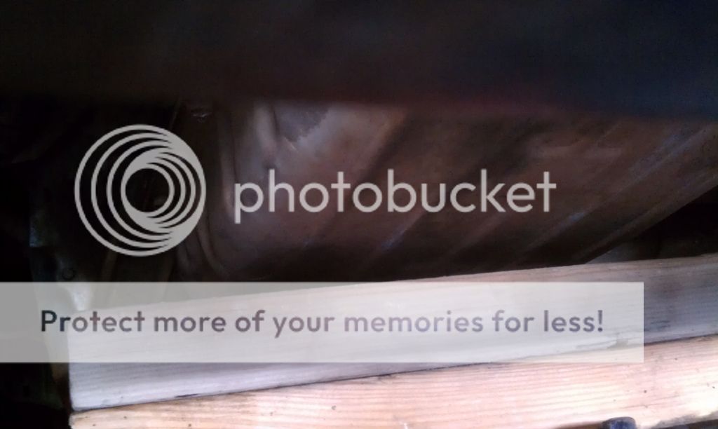

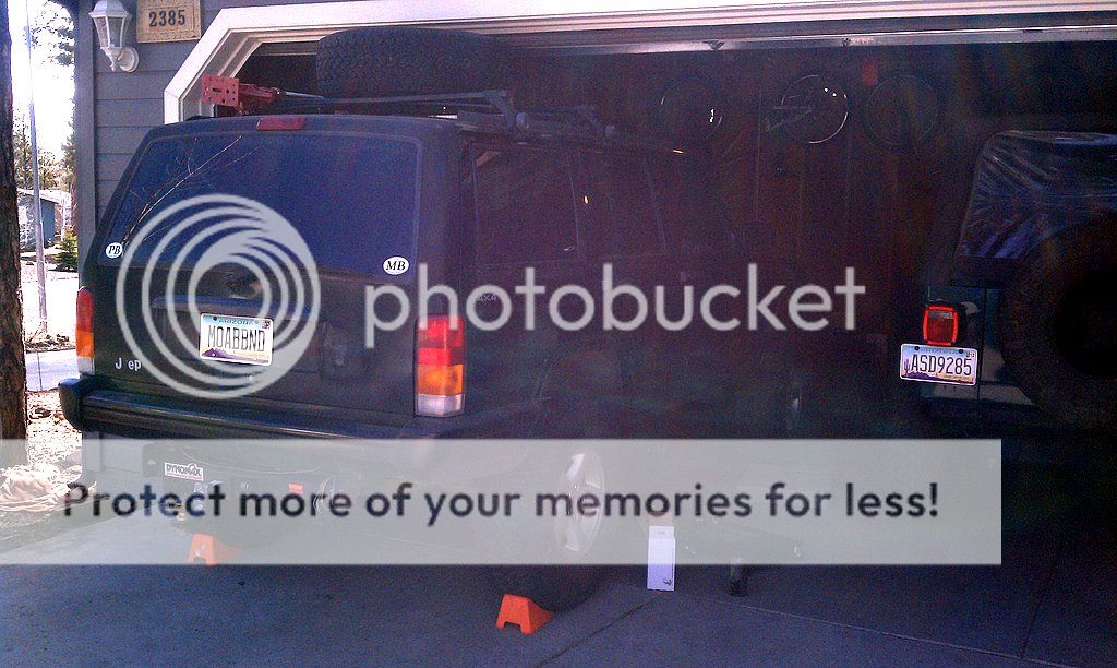

New Transmission mount today. Its a pretty simple task. I took pics just in case anyone needed to find out how to replace one

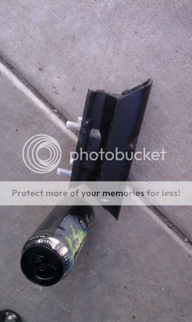

The mount was ordered from RockAuto and the brand was Anchor. I wasn't expecting quality but this one seemed nice when I opened it up
But first, Secure your XJ in a good location to work on it. Mine was in the garage, but I couldn't fit all the way
Here is the new mount

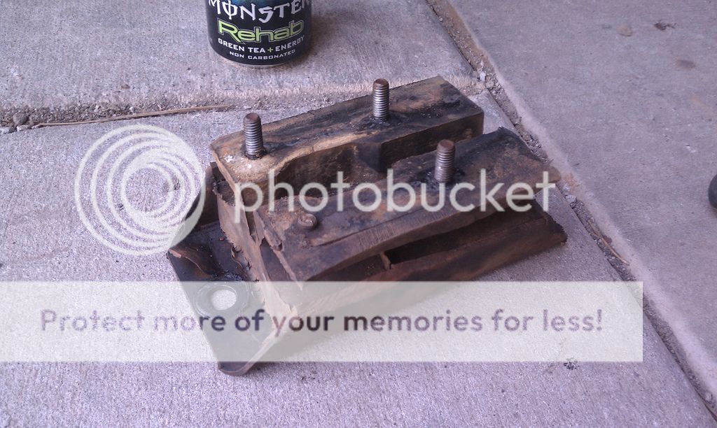

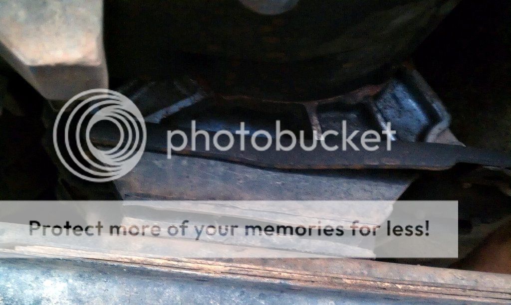

The old mount, still mounted

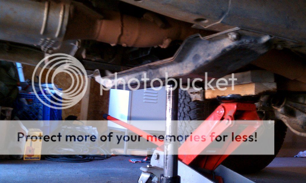

Lift the jack up to the transmission with a piece of wood to keep the transmission and tcase from crushing you
Unbolt the 4 bolts at the transmission mount and the 4 bolts that hold the crossmember up. Its not that heavy, use your arms and a knee to catch it
Remove that. The bolt sizes should be 13mm for the mount and 15mm for the crossmember bolts

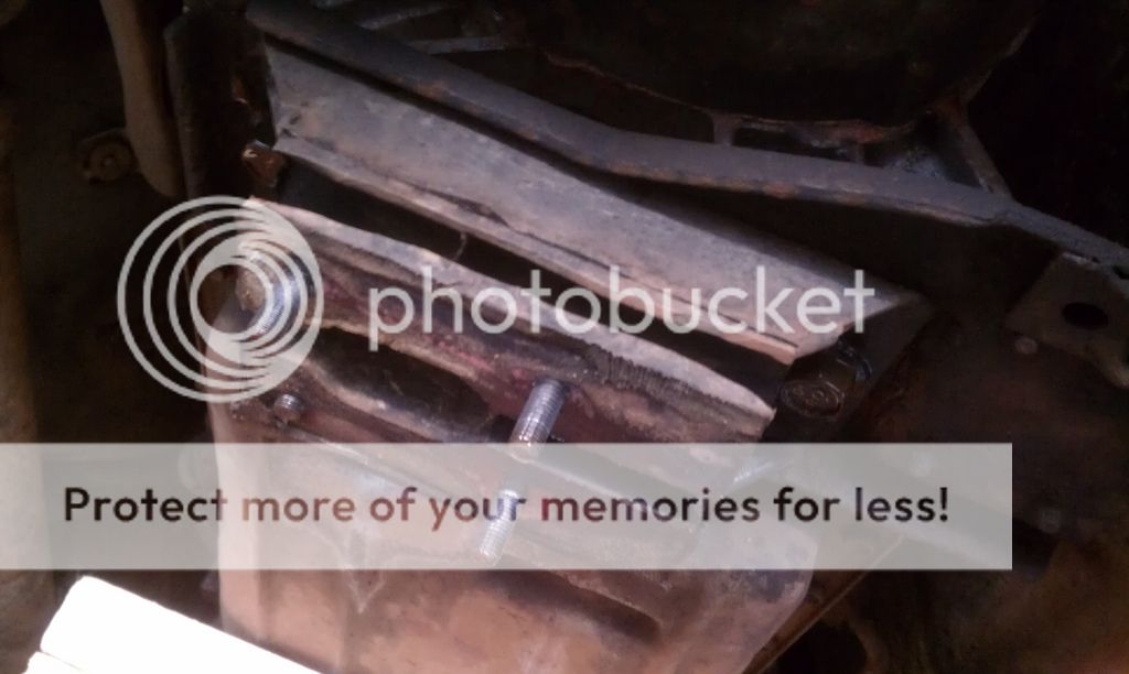

Now you've got the mount still mounted to the transmission by 2 18mm bolts
Remove that and put the new mount in the same way you took the old one out. The mount is side specific, so make sure you remember how the old one was mounted.

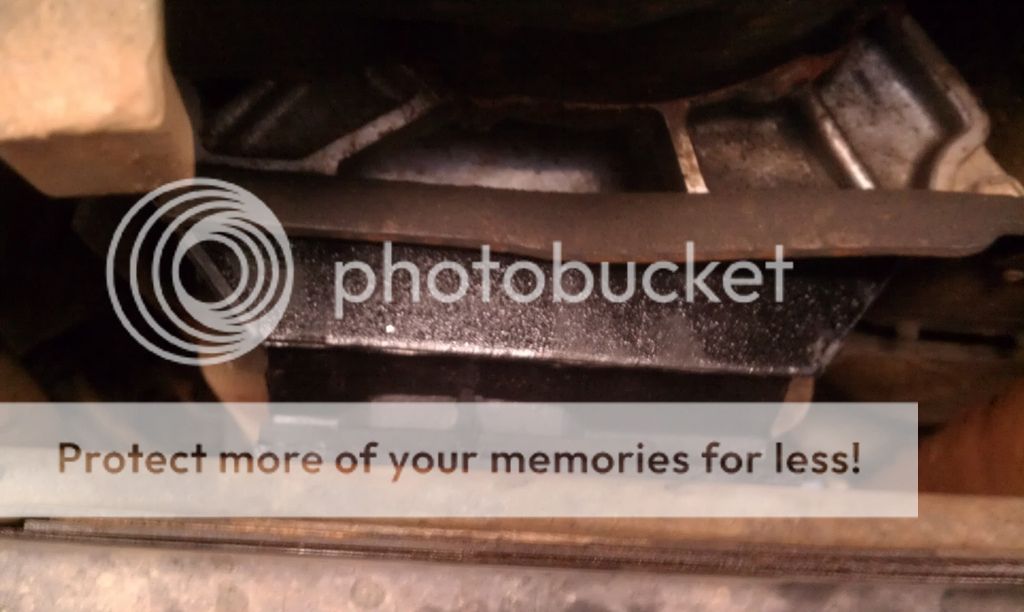

Bolt up the new mount
It's good to use 2 jacks for this. One where you are keeping the drivetrain up, but the other to push the crossmember up so you can bolt it all together. The stock jack that came with the XJ works just fine for this job if youve got a 3.5" lift like I do
All done once it's all bolted up. I noticed that my mount was old enough that it was sagging the drivetrain. With the new mount on there, It looks like I brought it up an inch or so
The old mount was long gone. only 3 studs were actually in place when it was mounted
And there you go. New trans mount all finished up. Hopefully this helped someone

Very nice. I put the same mount in my XJ. Install went well and it fits...so I guess that's good??
That missing stud looks sketchy.

That black one holding up the crossmember was the jack. It was located underneath the back seat on the passenger side
