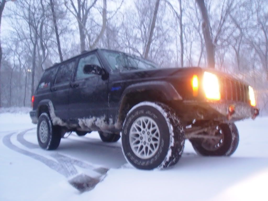

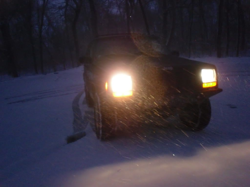

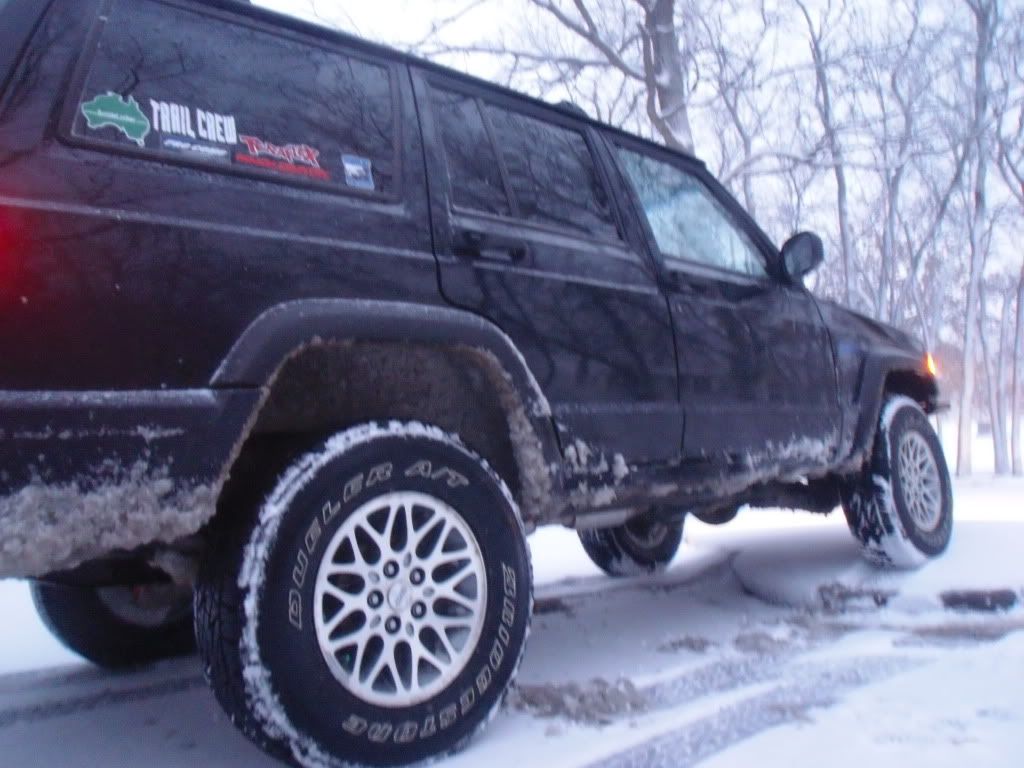

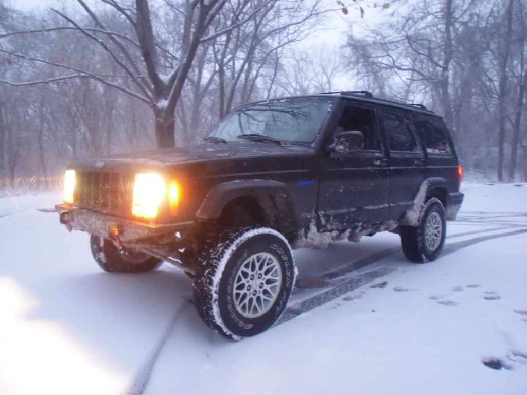

Took the Jeep in the snow for the first time today.
