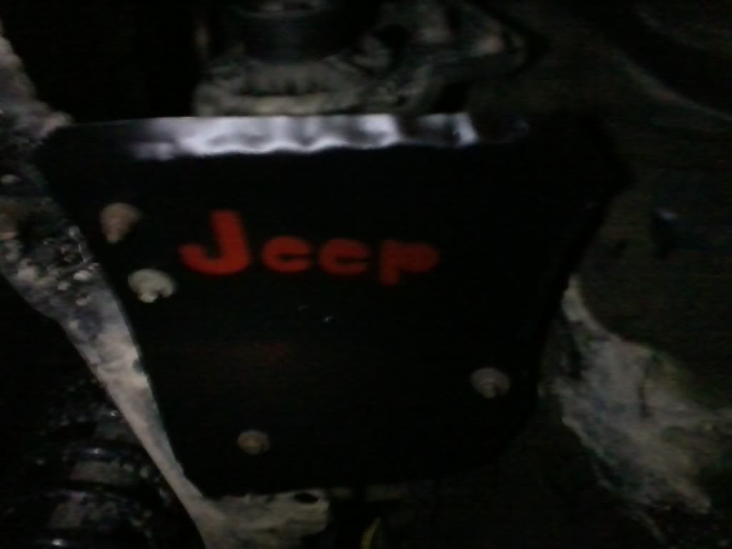

Had some spare sheet metal so I decided to make an alternator mud/rock shield. Its mostly to keep mud and water out, also reaches back far enough to prevent anything from flying up near the coil or distributor.

Looks good from what I can see,

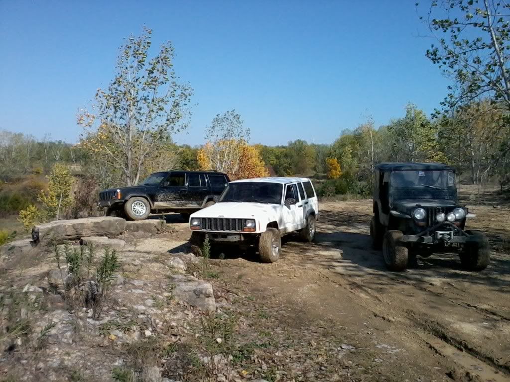

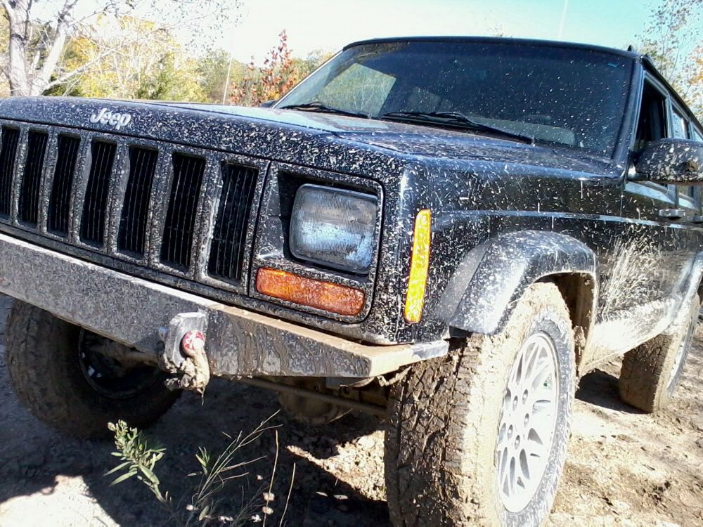

Put a big dent in my muffler, snapped an exhaust clamp off, and put a slice in the gas tank. It was fun though!

Where are the wheelin pics from? Local? Winnebago? Raytown Road? Top secret?
