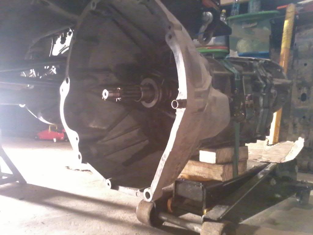

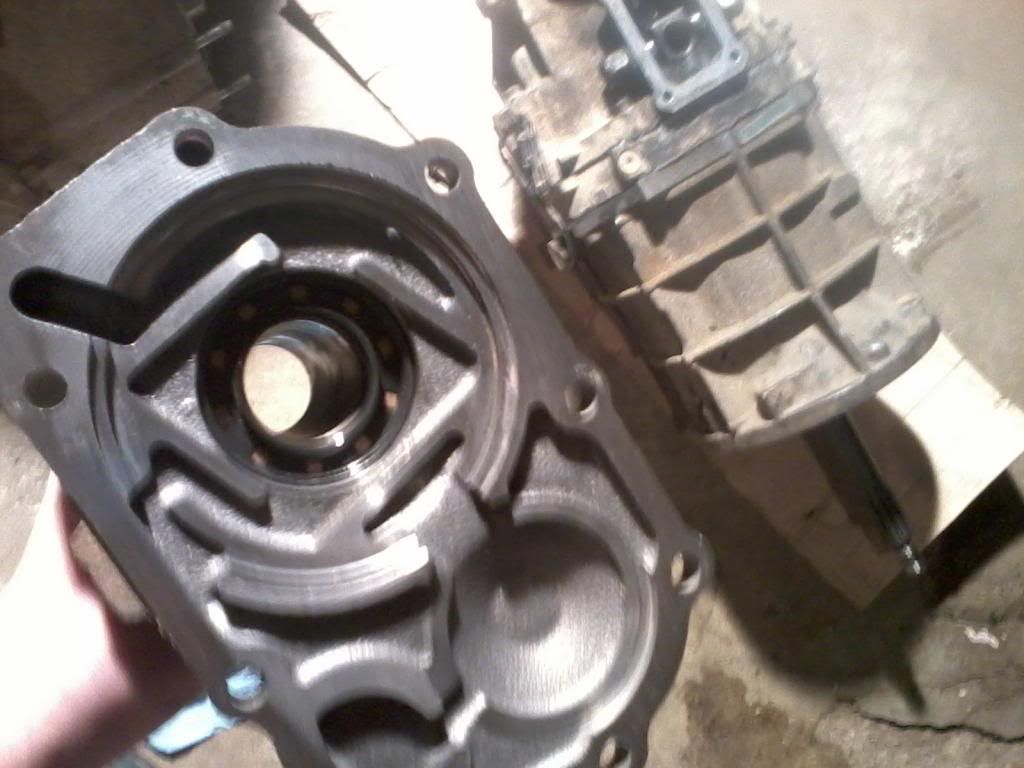

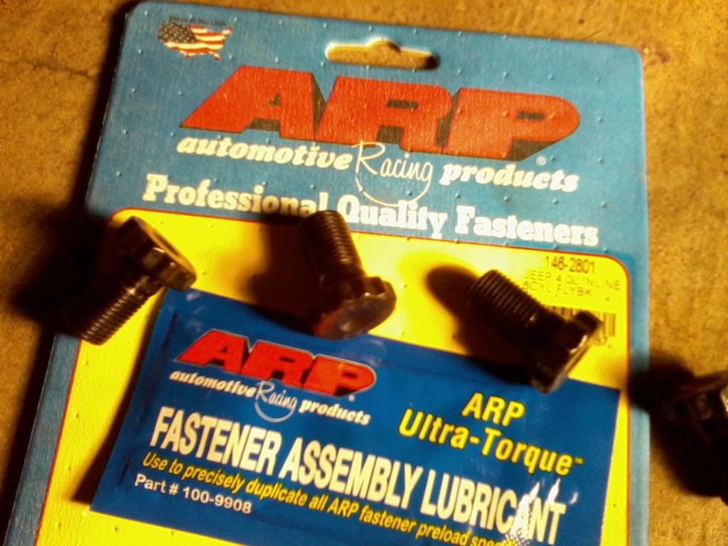

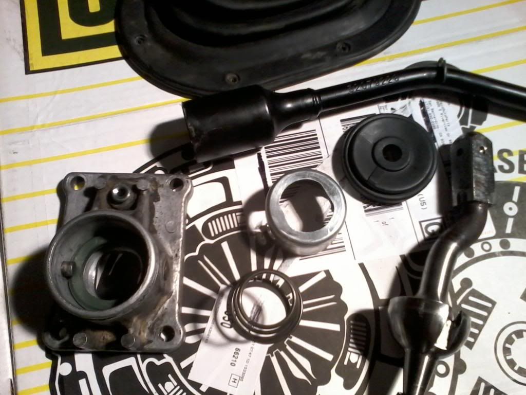

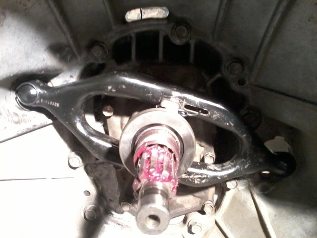

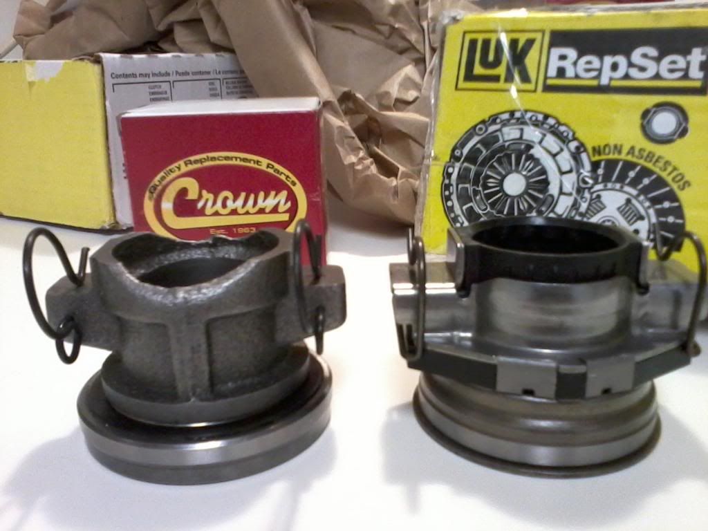

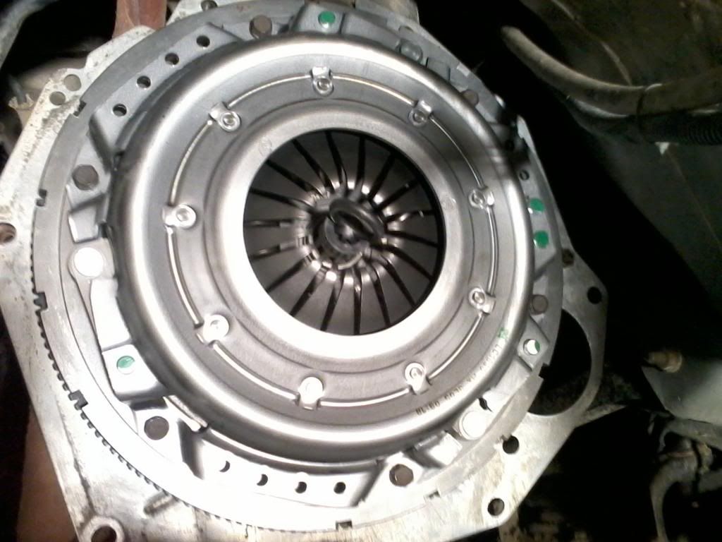

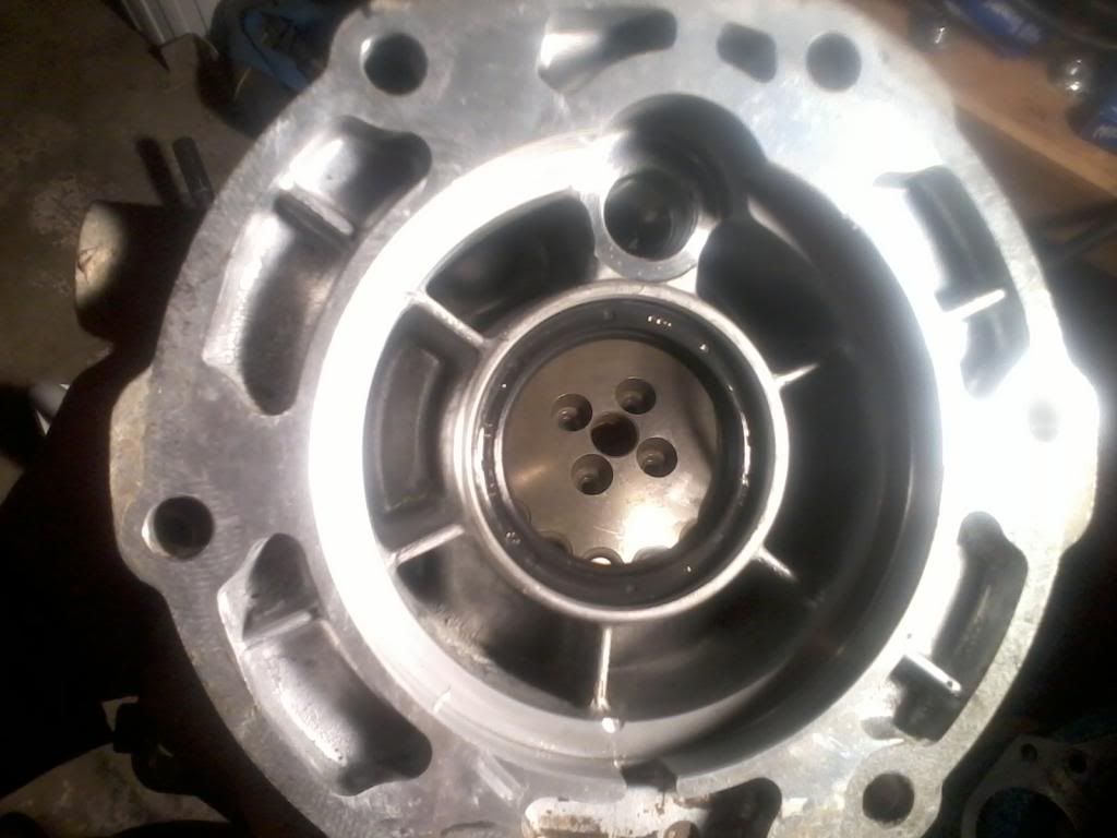

Tinkered some more...
New input seal-
New output seal-
Opted for a fully metal Crown TO bearing over the partially plastic Luk TO bearing-
New shift tower gasket and dust boot-
Shift lever installed with new pivot ball and retaining clip-
ARP flywheel bolts-
High dollar transmission jack-
Luk clutch and flywheel installed-
I hope I have good luk with this luk clutch So far so good, no leaks and smooth shifting. Time to hit the trails.
