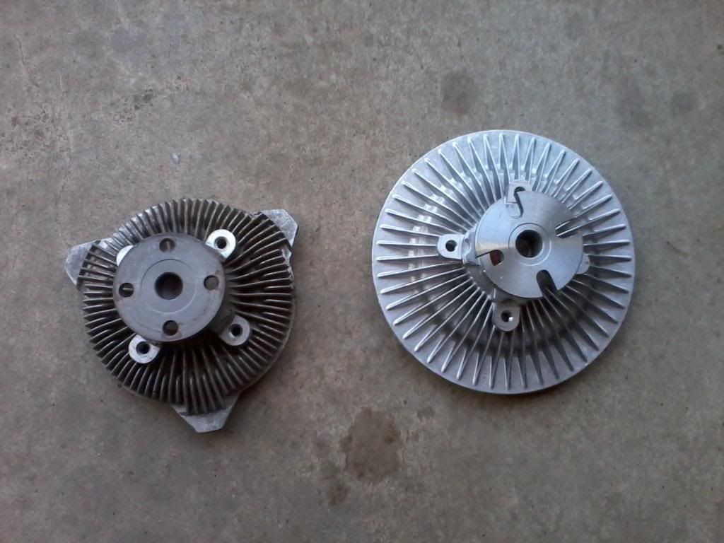

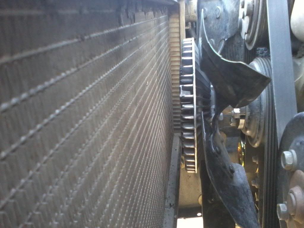

Since sinking the front of the Jeep in that mud pit the e-fan has been kicking on a lot more often. The mechanical fan seems to be freewheeling more than normal, perhaps running the fan under mud put an extra strain on it
Whats that mean? Upgrade time...
ZJ Fan clutch-

Thanks for the tips once again! I was thinking about going with a true mechanical fan or swap another electrical xj fan over when I was first messing with the fan clutch. The ZJ clutch turns at a much higher shaft speed percentage and seems to have the engine running right at 210 again. That is on road, I have yet to wheel with the new fan clutch, I will give your idea a shot if need be.

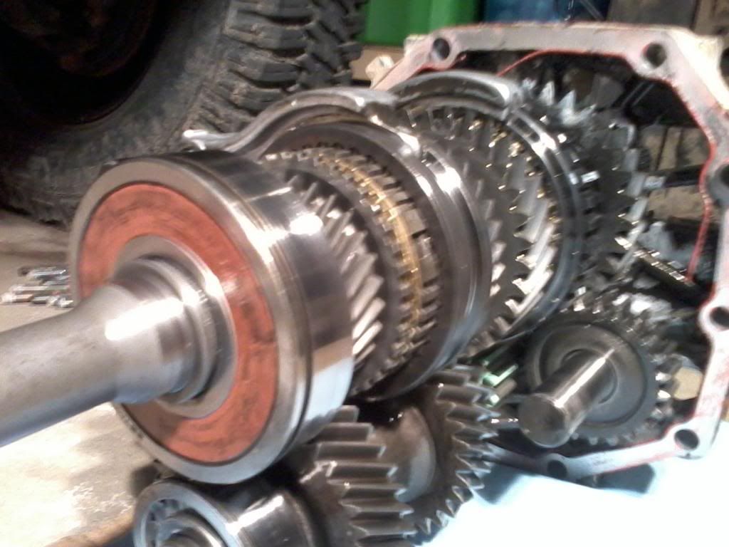

As for the ax15, I replaced the clutch 5k miles ago with a advance auto perfection kit. It started off pretty good but has become harder and harder to shift and it has a nasty shudder on takeoff. Right off the bat when I pulled the trans one of the mounts for the throwout bearing was broken off hanging there. I'm going back out there to pull the clutch and inspect the friction material and flywheel.

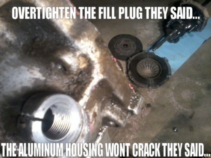

Oh and lastly, I over-tightened the fill plug last month and the housing cracked! I have a new housing, luk clutch, luk flywheel, full metal crown throwout bearing, and arp flywheel bolts to install. Might of ordered HD xj frame stiffeners too, which Id like to weld 2x6 sliders to here shortly

you didn't read the "fine print"...it said use 1/4" ratchet with 1/4-3/8" adaptor to overtighten ...not the 3/4" breaker bar....doh...

Now you tell me
