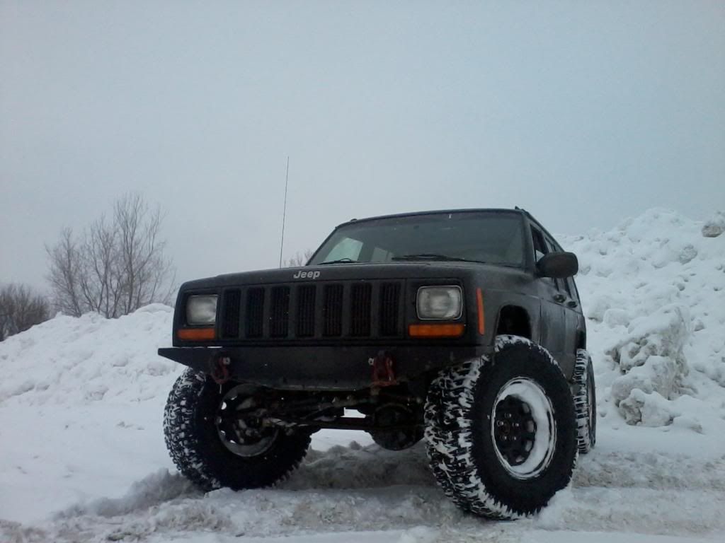

Tinkered some more-
http://www.jeepforum.com/forum/f22/98-xj-gettin-her-trail-ready-1417602/
