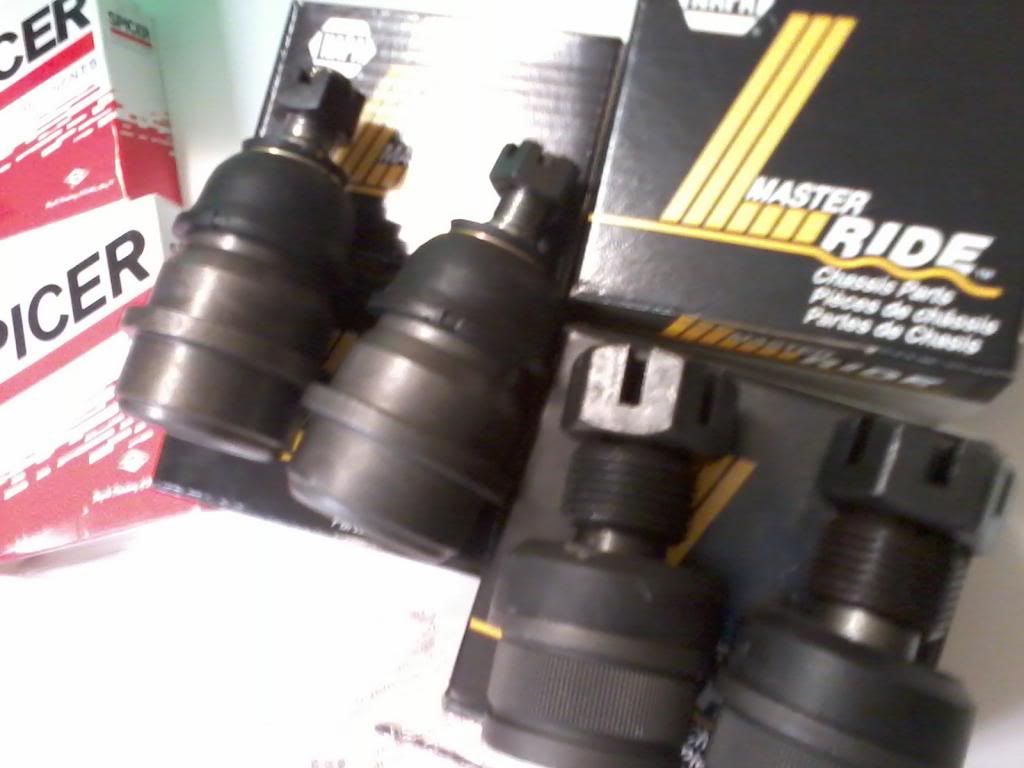

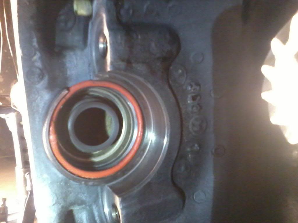

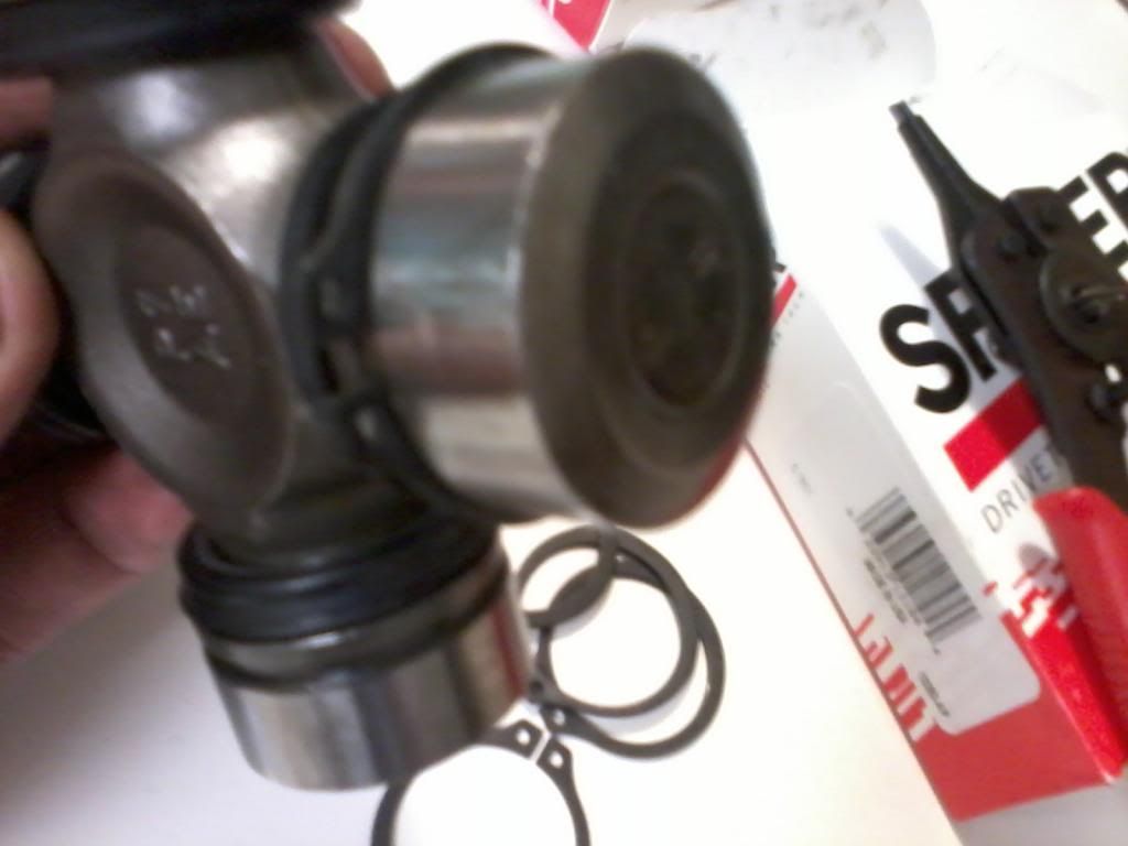

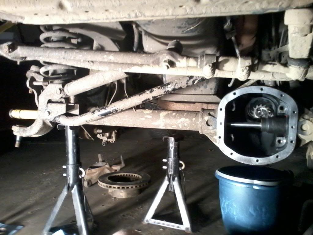

The Jeep is back on the road after breaking the drivers front inner and outer axle shaft a week ago. I went ahead and replaced the upper and lower ball joints along with the inner axle seals. The driver side inner seal needed replaced anyhow after driving it home with the broken driver side inner axle shaft. Found a replacement Dana 30 axle shaft out of a 96' XJ at the junk yard. It appears that all 95' up Dana 30's have the 297x axle shafts, unlike early 260x shafts. Always opt for the 95'+ shafts because the 297x u-joints can be replaced with Spicer 5-760x's which are cold forged and ten times more durable.
Napa master ride ball joints-
Overpriced Mopar inner axle seals-
Replaced both front axle shaft u-joints with Spicer 5-760x's. Also ground the inner and outer shafts down to accept 1 3/16 full circle clips-

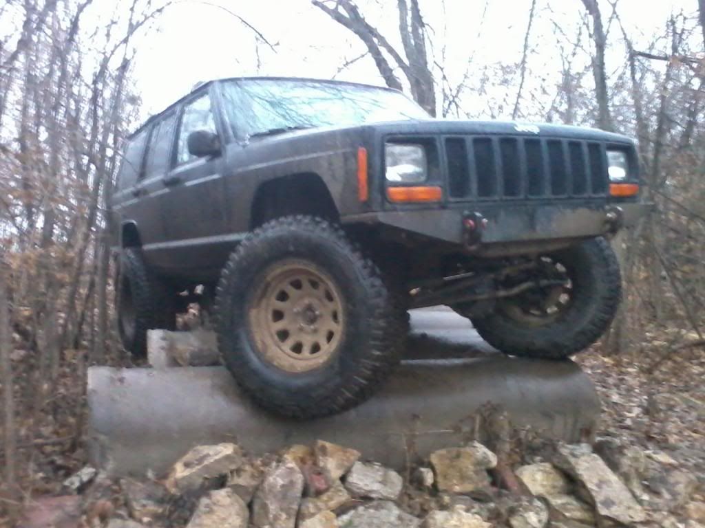

Managed to get it all put back together and went wheeling to test out the new parts-

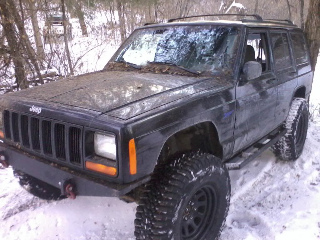

It's only supposed to be 7*, right? Snowing pretty good right now!
Heading back to work on the Jeep-

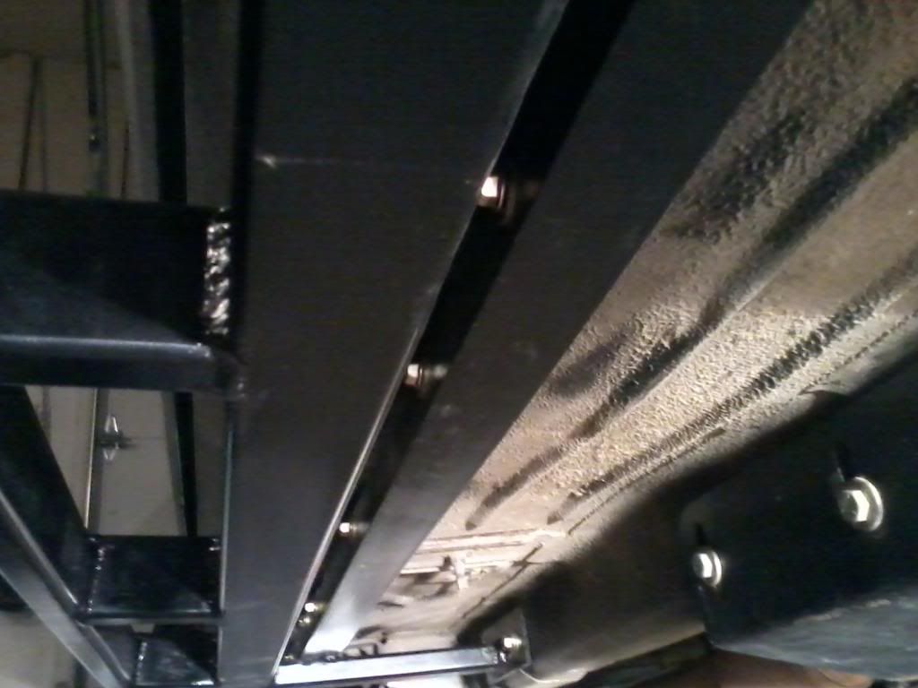

Seven 1/4" bolts through the pinch seam with locking nuts, four 3/8" bolts through the unibody with locking nuts on the inside of the unirail. All grade 8 hardware (2 washers for every bolt), these rails seem pretty firm.

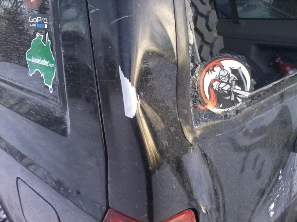

The window frame is tweaked big time, the corner is nearly touching the spare tire! I see a few cherokees on craigslist being parted, I will have to make some calls tomorrow. If I can't locate a clean hatch by this weekend I will bolt in a piece of plexiglass for the time being.
