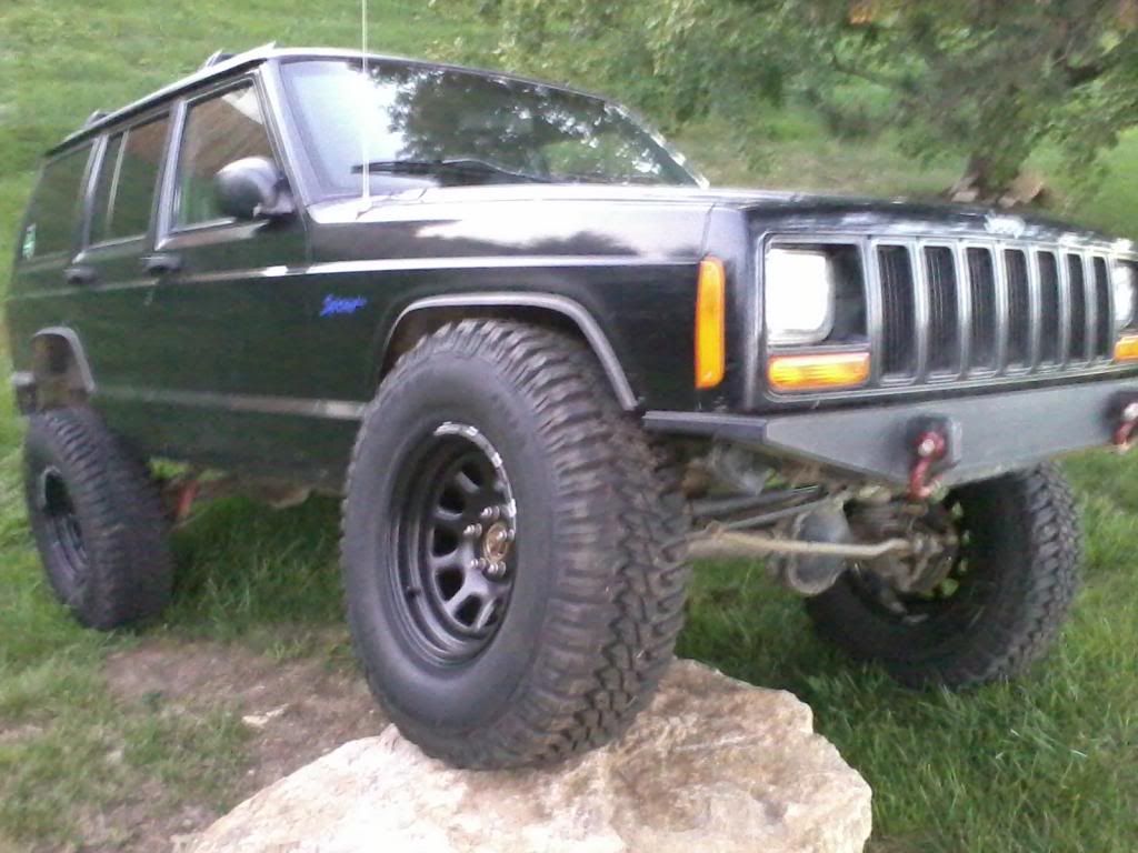

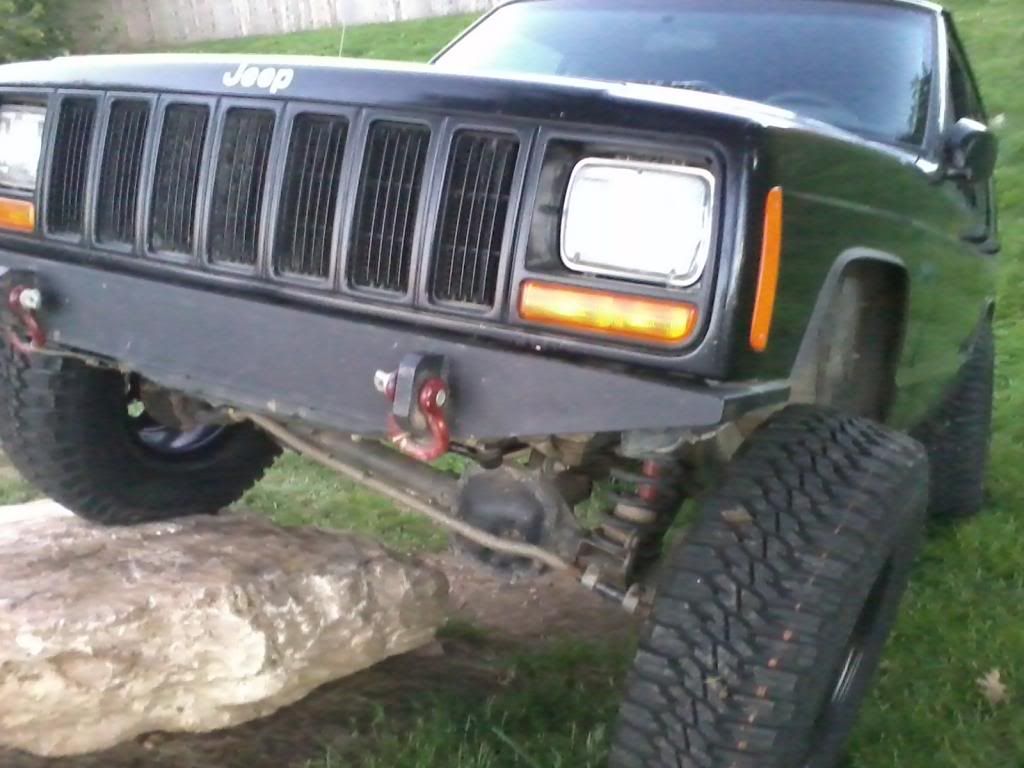

New shoes fit good.

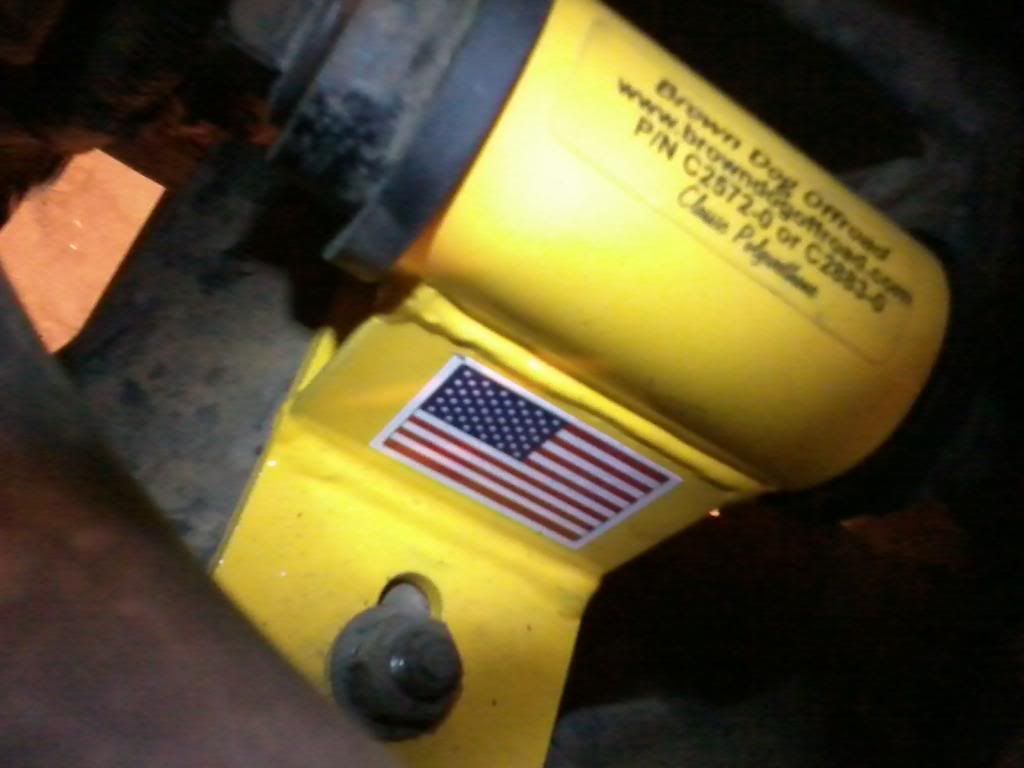

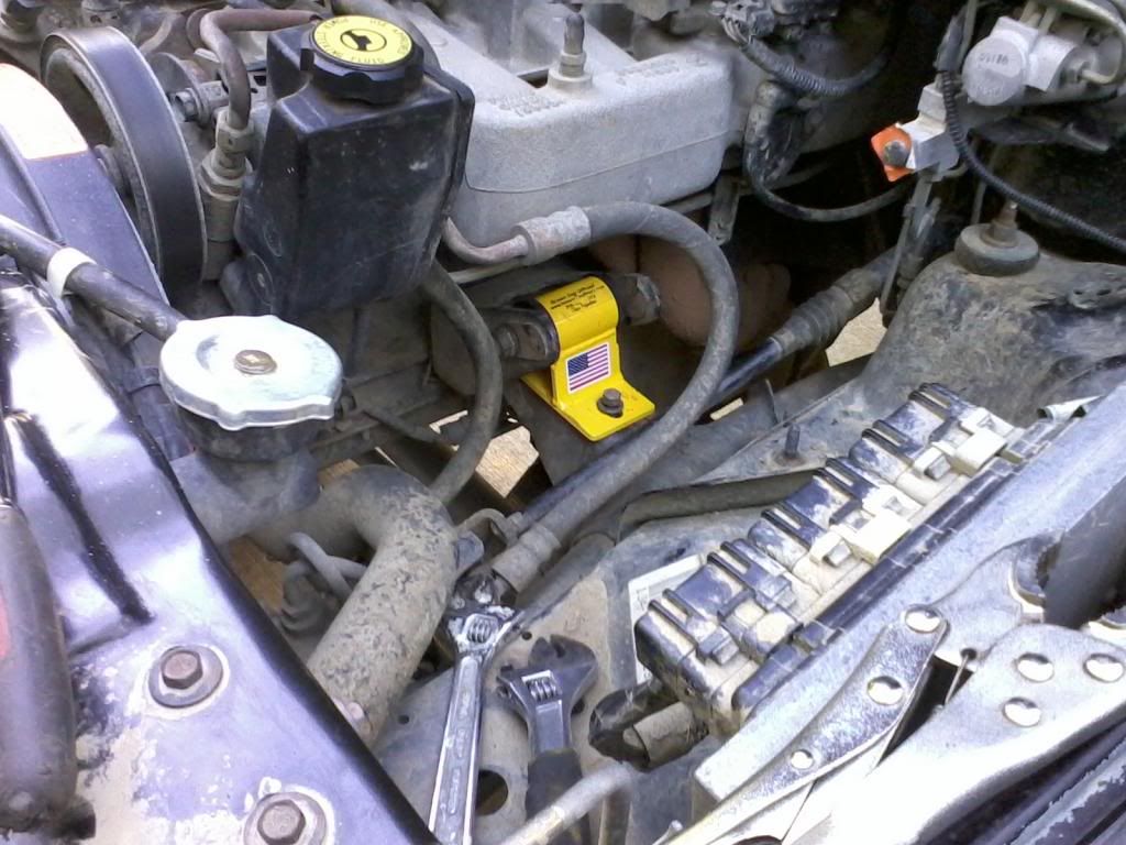

First the guard dogs now the brown dogs-
http://www.jeepforum.com/forum/f22/98-xj-gettin-her-trail-ready-1417602/

Ha your previous auto must have been a vw...lol all I see is cresent wrenches and vice grips..yo where the sockets at...Lmfao...ok that was my rant for the day...lol..

For the engine mount through bolt I use 1/2" drive ratchet and 18mm socket on the bolt head then an adjustable wrench on the nut. The vice grips are for a small scissor jack I have which I used to move the engine up a hair to get the through bolt in. That would be funny if I changed my engine mounts with nothing but an adjustable wrench and a pair of vice grips.
