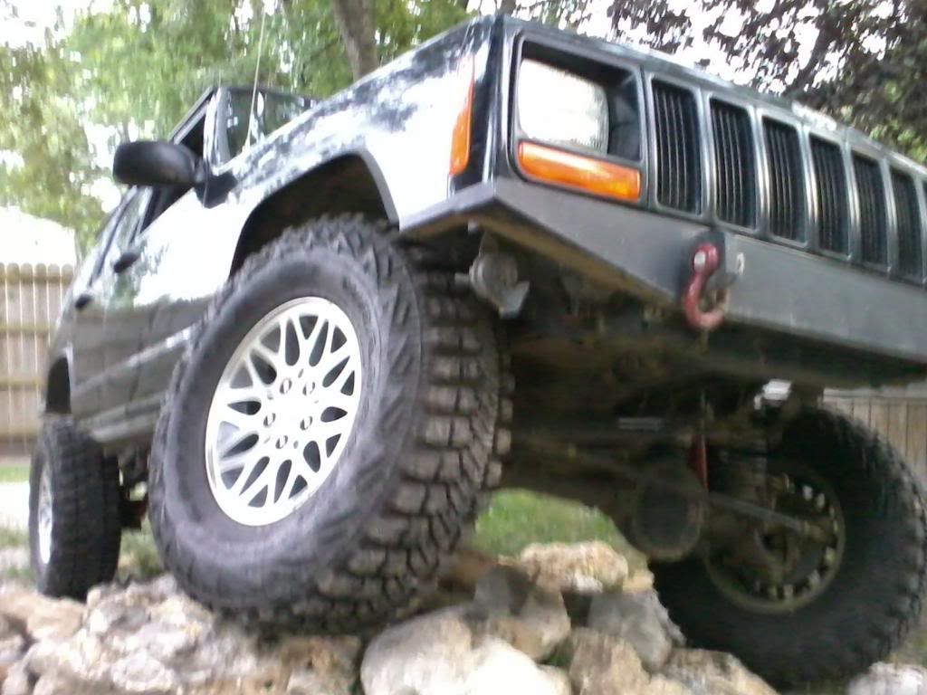

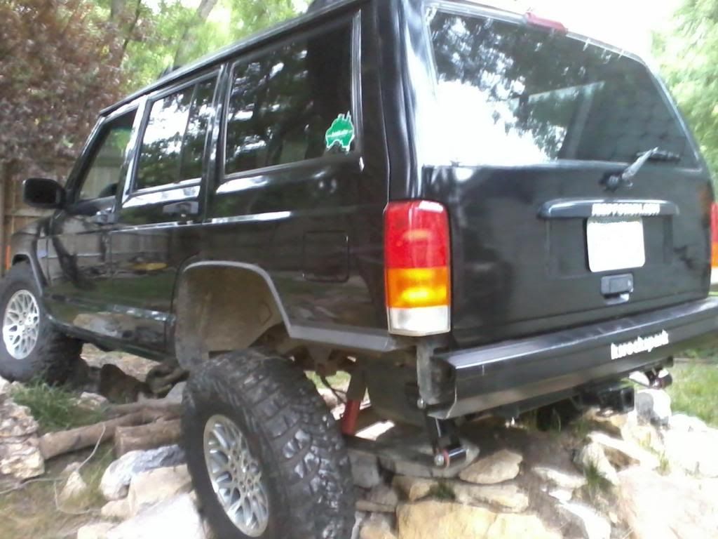

I moved the shackle one hole back on the relocation brackets and the angle is perfect. I am very happy with the smooth ride and way better articulation. Using the brackets and extended shackles allowed me to remove the add a leaf.

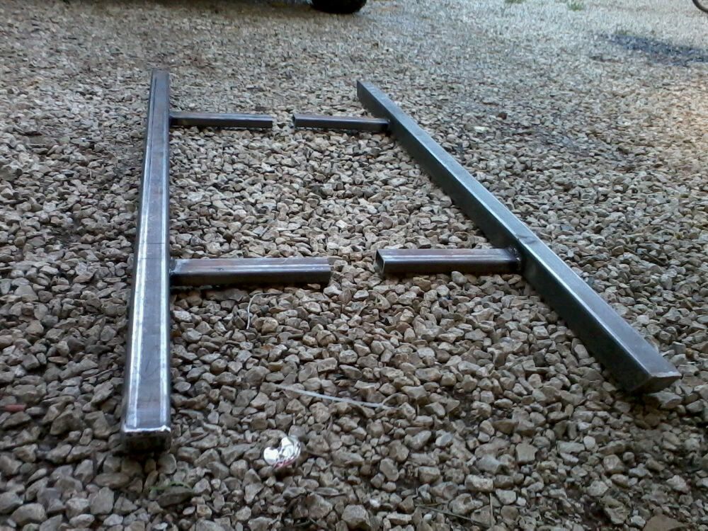

Slowly but steadily this build is inching along. Put the flux core mig to the side and asked a friend to use his Lincoln 225 stick welder. The main 2x2 rails for both sides have been capped and I welded 2 legs on so far. This weekend I'm going to weld the 3/16 mounts to the end of the legs, attach the angle iron, and work on the outer step. They are going to look like a low profile aj's super square rock slider.
I just ordered a JCR xj transfer case skid last night and I hope the rock rail legs don't interfere with the skid.

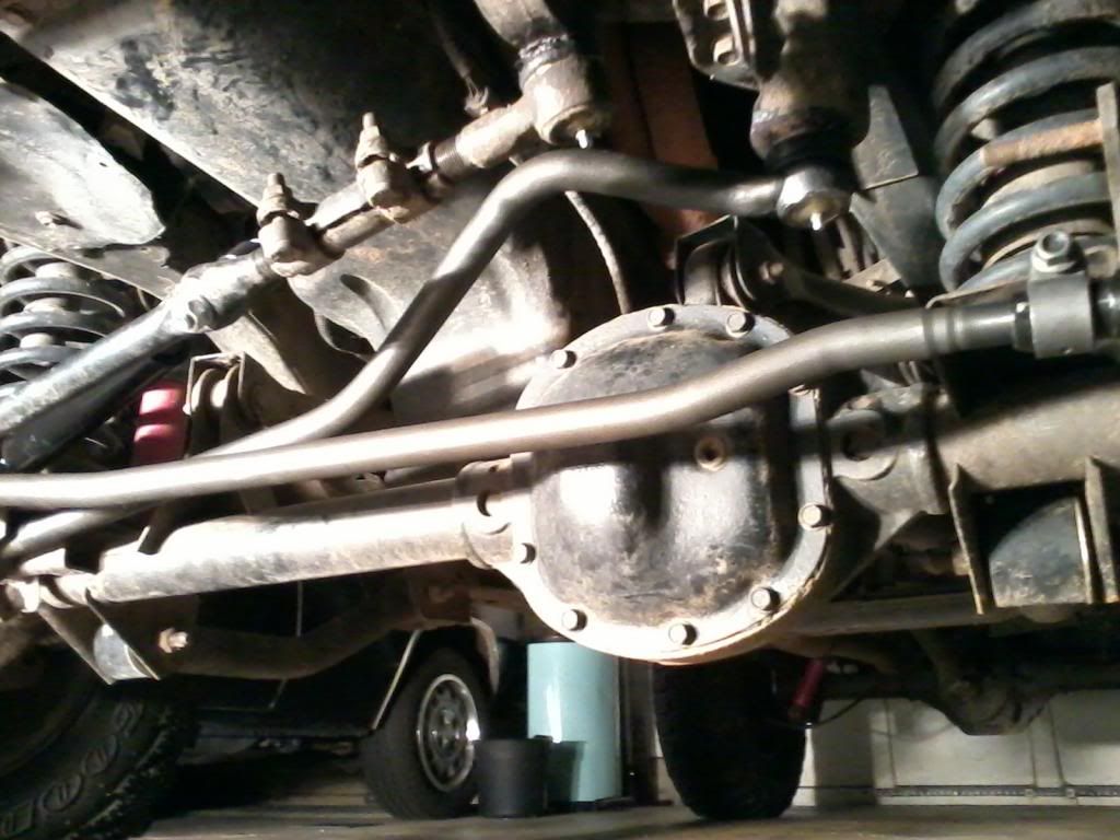

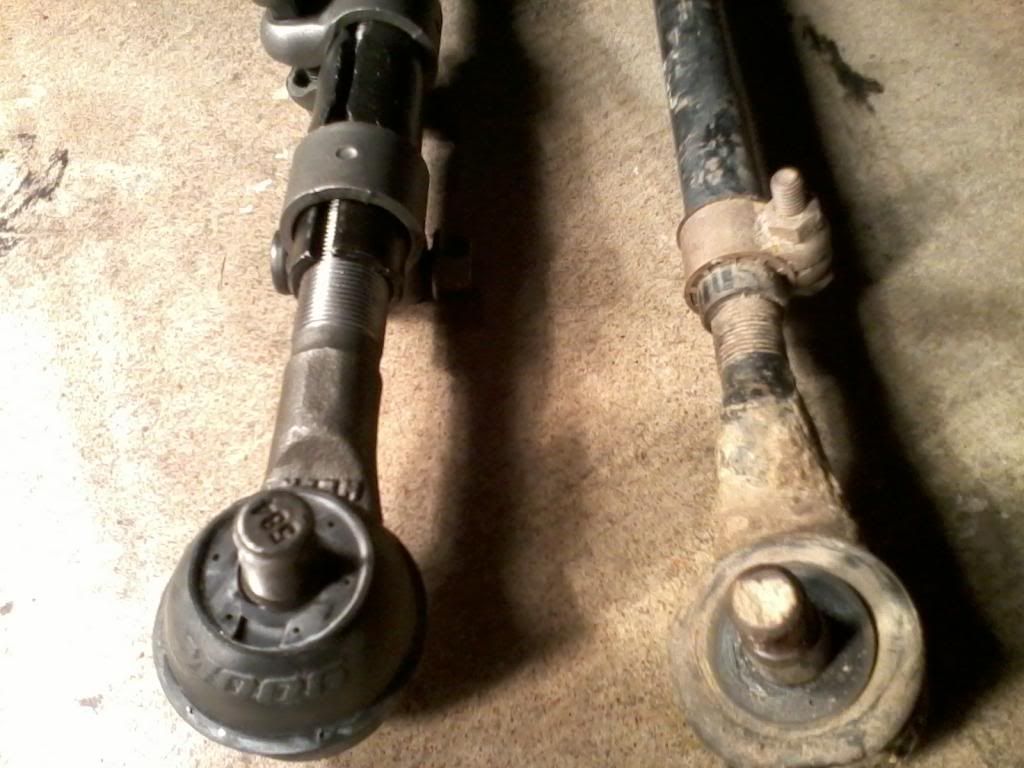

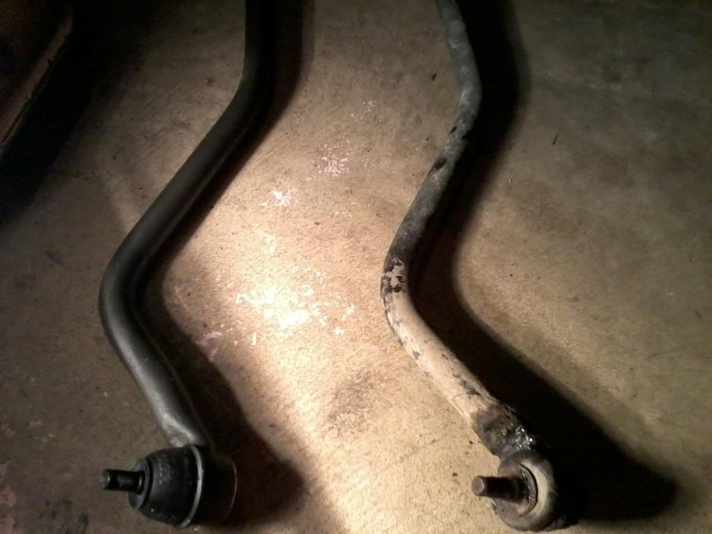

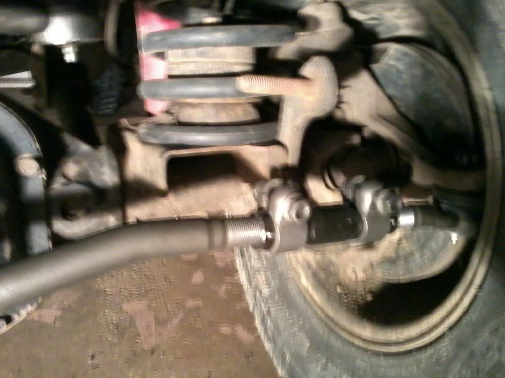

Since the last time I have wheeled the trackbar has been popping so I replaced it with a Moog unit. No more popping. While I was under there I went ahead and replaced the tie rod with a Moog v8 zj rod, sleeve, and tre. Also replaced the steering damper.
[IMG][/IMG]
[IMG][/IMG]
[IMG][/IMG]
[IMG][/IMG]

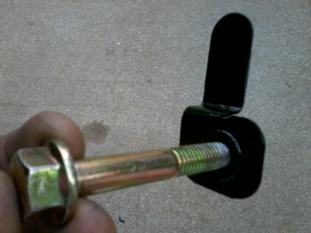

Track bar axle side bolt and nut stripped out. Picked up a new grade 8 bolt and nut, cut the old nut out of the bracket and mig welded in the new.

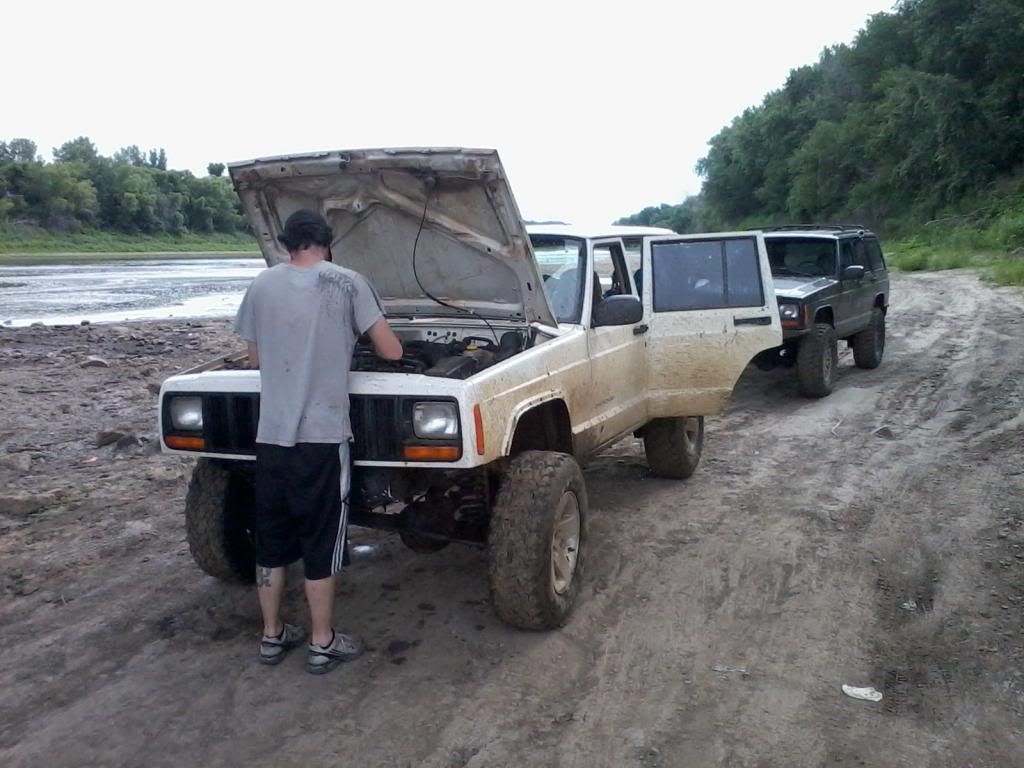

Been helping my friend get his xj ready for the Jeep Jamboree in Colorado next month. It likes to throw its serpentine belt when playing in the mud.
[IMG][/IMG]

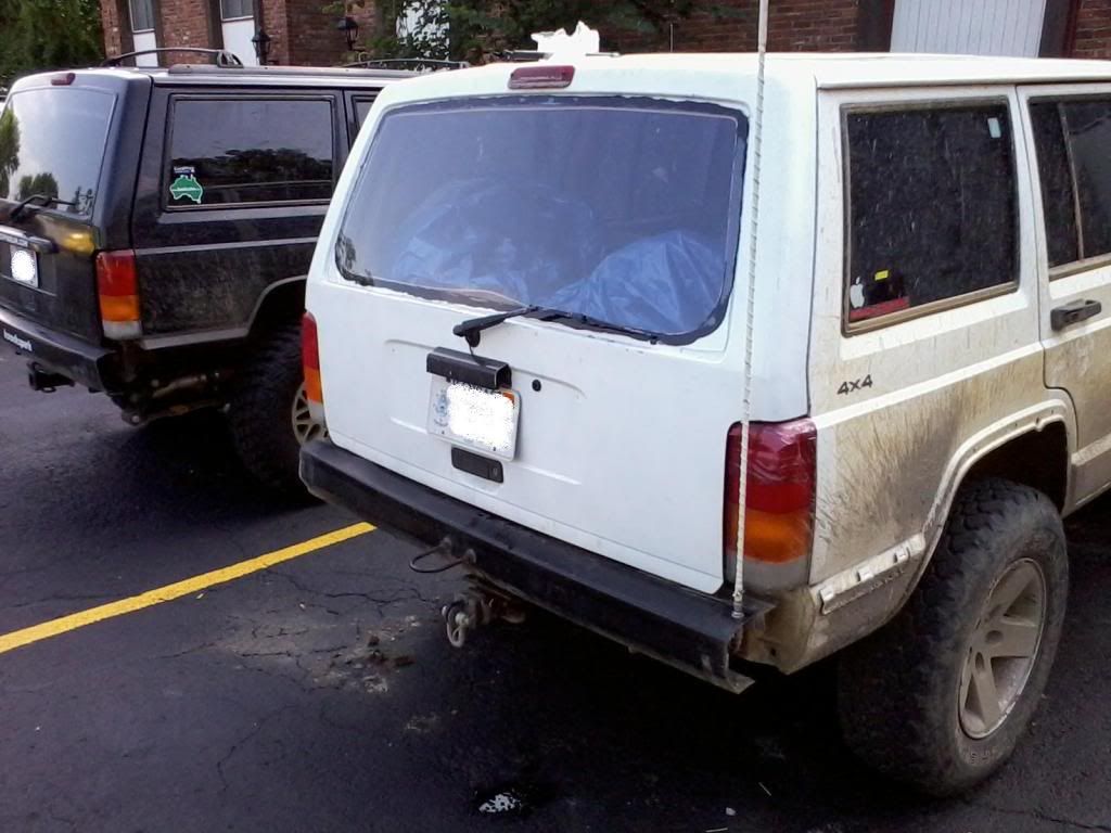

He backed into a tree a few wheeling trips ago and took out the hatch and glass. Found a clean one at pick n pull during half off day, glued in plexiglass, and threw it on.
[IMG][/IMG]

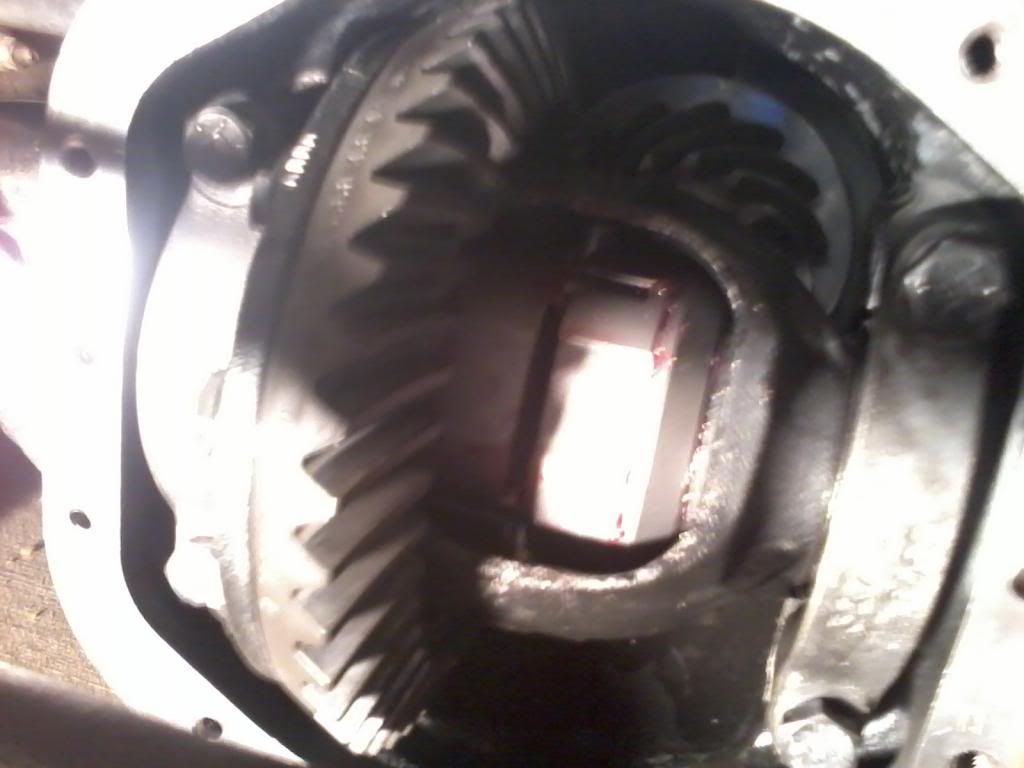

Bringing my build thread back to life yet again. Today's update includes the install of an Aussie locker in the front Dana 30 HP axle. The Cherokee is now Aussie locked front and rear and I'm very eager to try it out.
[IMG][/IMG]
Aussie installed with new cross shaft and cross shaft pin-
[IMG][/IMG]
Cross shaft pin seated-
[IMG][/IMG]

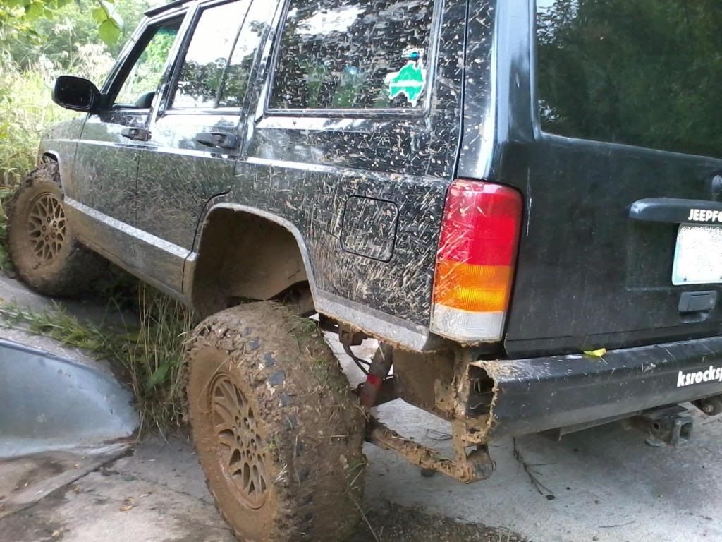

Went wheeling today with a few fellow jeepers and had a good time. No issues with the new front locker however under load going up a steep incline, in 4lo, I noticed something grinding in the drive train. I am thinking the noise is a worn out transfer case chain. Going to order an Alloy t-case chain, new shift pads, and a new filter.
Other than the transfer case chain, the only other item on my list is the leaf springs. I purchased new Crown HD leaf packs a year ago. Ran them with a RC 3in AAL for 10 months, then removed it when I went with the RC shackle relocation and RC extended shackle. Once I removed the AAL the leaf pack was flat, now over the course of a month or two the leaf packs are inverted. Contacting a leaf spring shop tomorrow about getting new leaf packs.
That's it for right now. The Cherokee just hit 175,000mi and still runs like a dream. Once I get the leafs and t-case chain the build will continue.

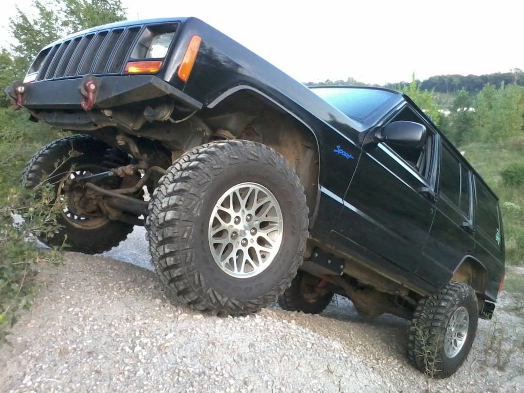

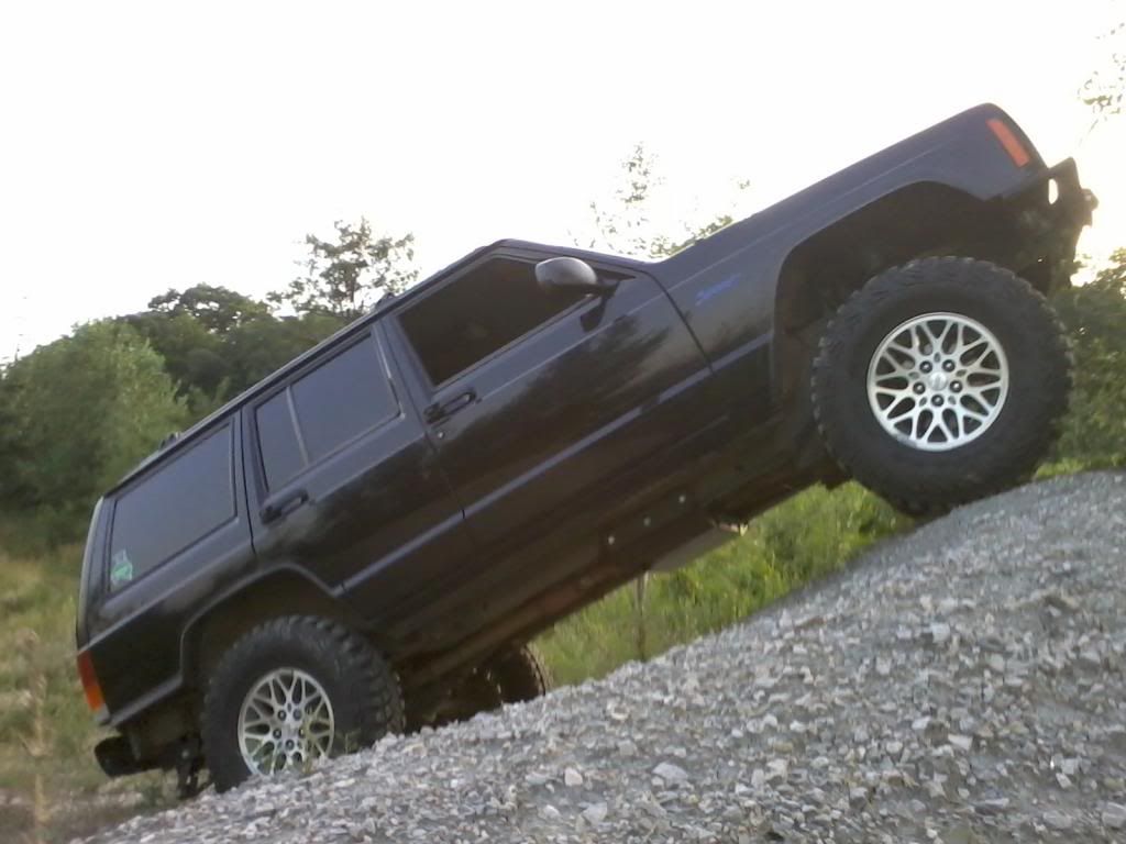

I went wheelin/muddin with two xj friends, one has a 6in lift and the other is stock, for now.
The stock cherokee is about to get my old AAL-
New leafs flex good-
Been talking my friends into buying Jeeps, little did they know I would be crawling their tires-
