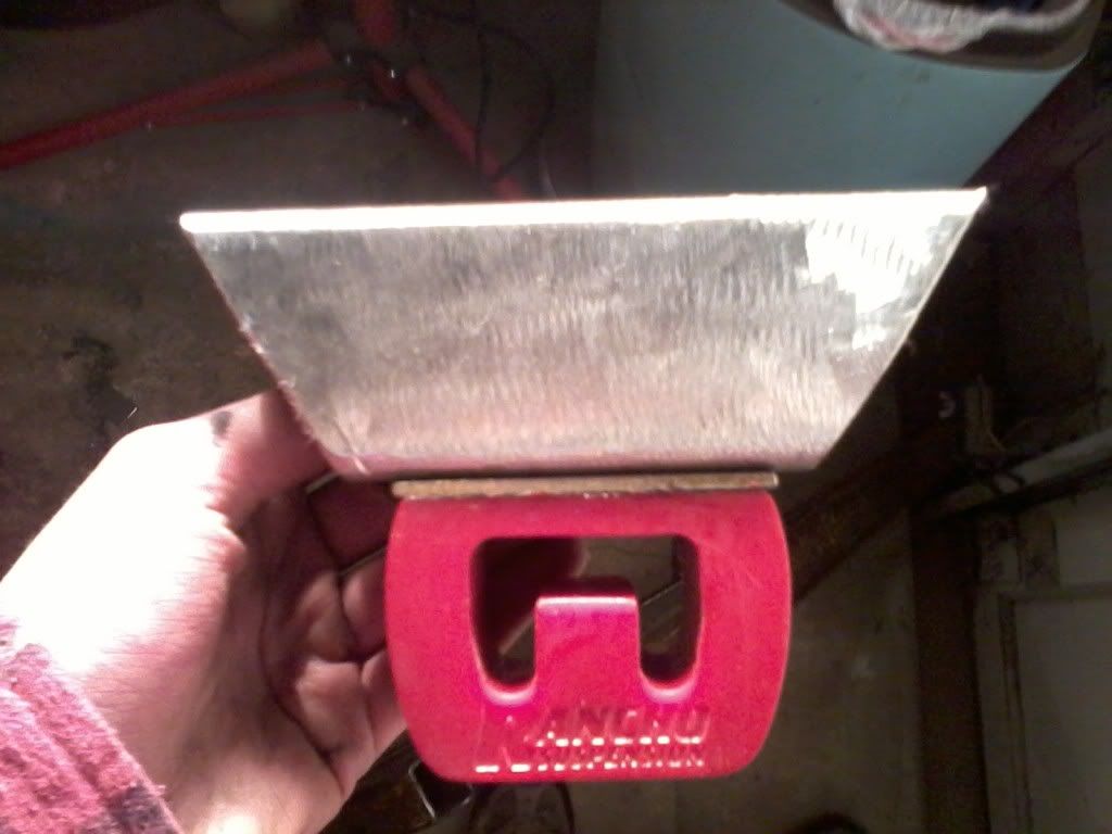

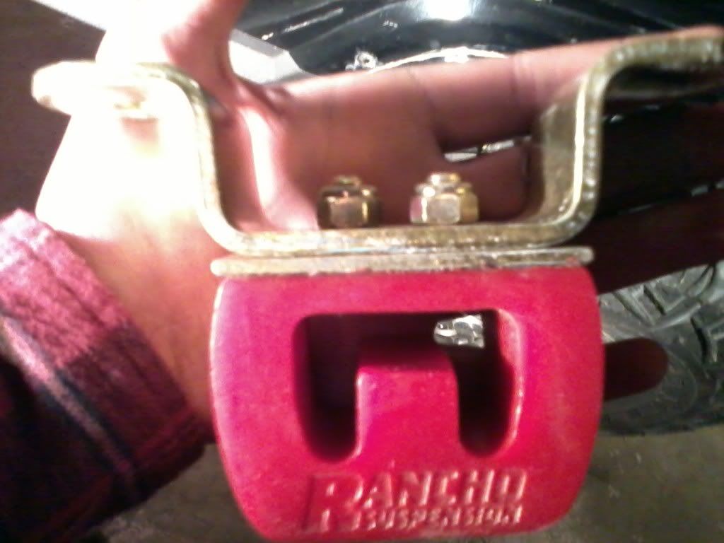

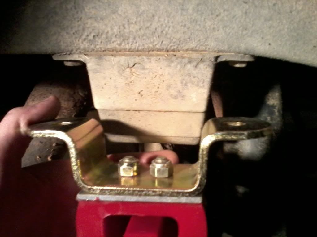

Heres the 2x2 1/8" tubing I picked up from 8pitcher. It was almost to cool to cut up.
Heres the Rancho bump stop(s) I also received from him.
The mounting holes are just a bit to narrow which isn't a surprise since they are for a cj, not an xj.
Removed the mount
Then cut a piece of 2x2, drilled 2 holes, then bolted the bump stop on
Waiting for my electric drill to recharge before I can drill holes to mount it to the unibody. Then paint the 2x2 and start the other side. These are going to be apx. 1.5" longer than stock. For the front bump stops I need to pull the coils, drill a 5/16" hole in the center of the coil perch/mount on the axle, then drill a 1/2" hole through my hockey pucks, and bolt them down with grade 8, 3/8" self tapping bolts. I picked up 3" long bolts for clear 2 hockey pucks and then leave 1in of threads exposed to screw into the coil mount.
