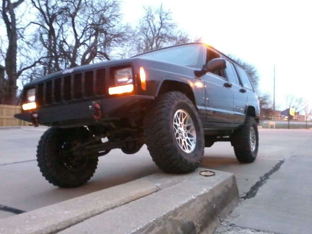

post #209 of 488 Old 02-20-2013, 05:30 PM Thread Starter
straightsixjeep
Location: ks
Posts: 2,083
Got some more work done on the Jeep.
Extended the turn stops so the tires dont rub the lower control arms and also a glimpse of the moog u-joints
The front fender inner seam cut my tire (siped it) so I made relief cuts, pounded it over, then undercoated it
Got my front fenders cut and undercoated. About to go back out and get the rears done.
straightsixjeep is offline
post #210 of 488 Old 02-20-2013, 05:49 PM
8pitcher
8pitcher's Avatar
Location: Wellsville
Posts: 4,854
And no mention of me thanks a lot man. Haha you do some fine fine work man.
8pitcher is offline
