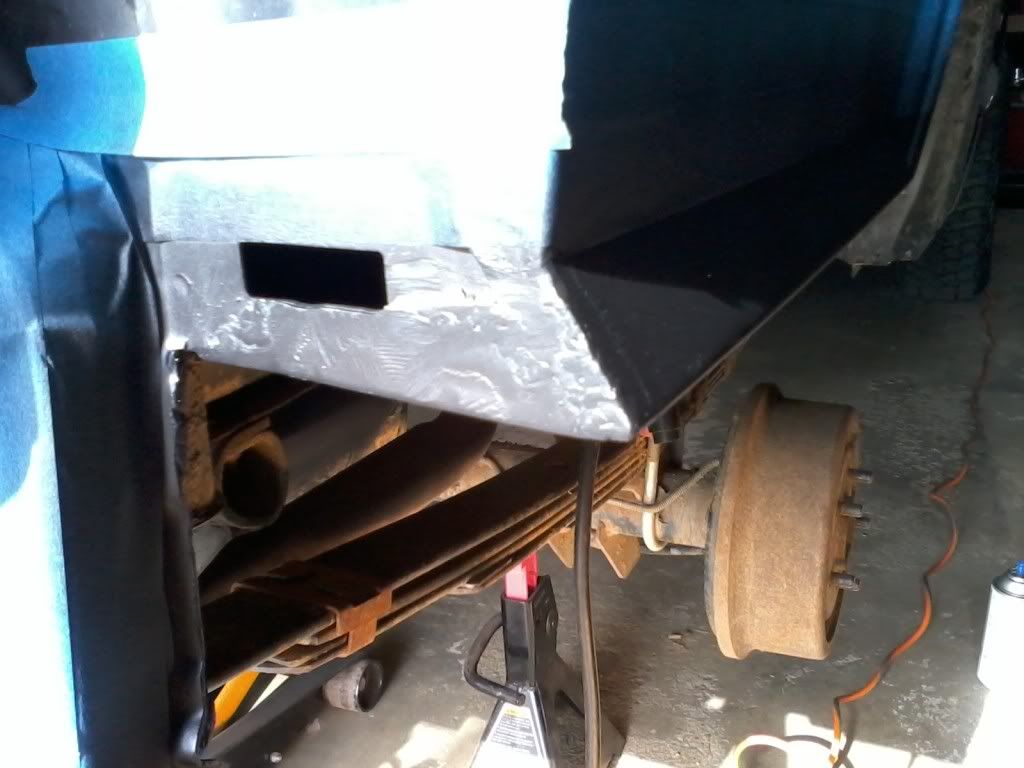

Are these cheap spring pads or something?
thenewguy79 is offline
post #153 of 488 Old 01-26-2013, 12:59 PM Thread Starter
straightsixjeep
Location: ks
Posts: 2,083
No, that is part is the leaf spring clamp. Typically you have 2-3 clamps per leaf pack. Once you put all the leafs together and you have the plastic friction pads between the leafs, insert the centering pin and tighten in. Now clamp one end of the leaf pack and put the bottom part of the clamp into place.
Then slide the top piece over those two arms, then hammer the arms down.
Then release the clamp and your leafs will be secured.
