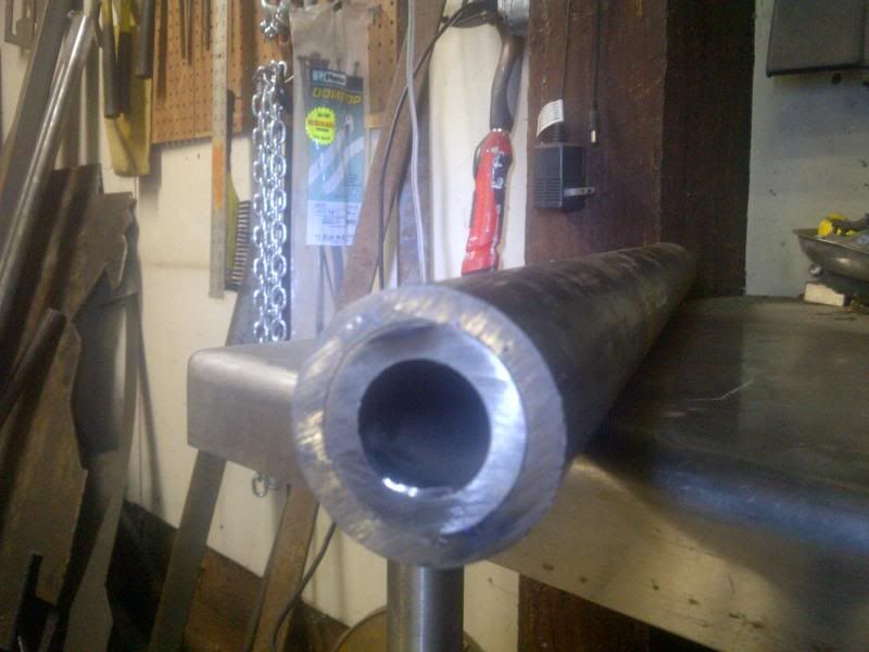

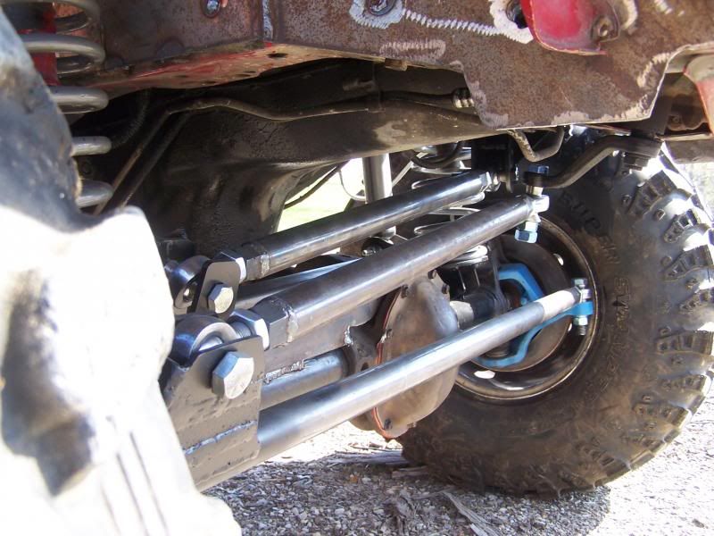

It isn't done, and there is still some tubing to bend. She drives though, and flexes, and has power going to all 4 tires.
The wheelbase has been stretched 8" to an overall 110"ish range.
^2 od" .250 wall, sleeved with 1.5" od .250 wall, equals 1/2" thick (for lower links)
