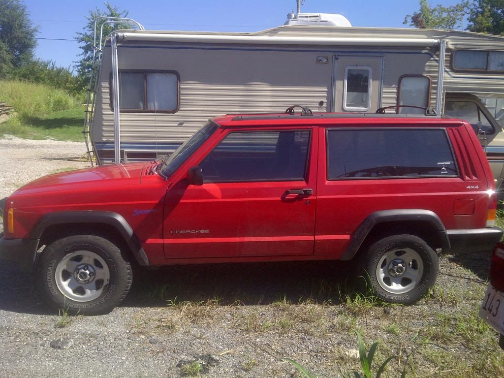

It started with me looking for a 97+ 2 door 5 speed. I ended up with a 98, 2 door aw4 in late September. In 3 weeks I rushed through a build to make it to a planned run. That was a terrible mistake and lots of money was wasted on parts. Plans changed very quickly.

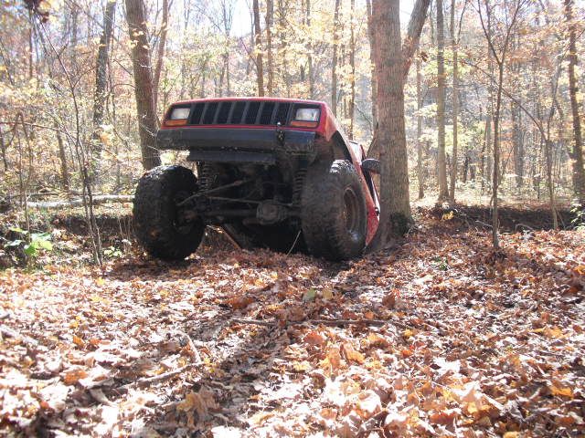

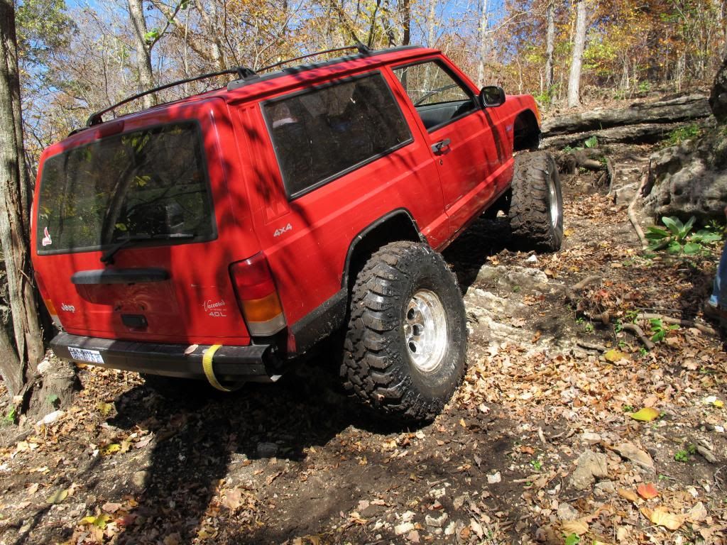

The quick build up was finished. I went wheeling. It performed great. I brought it home, and my mind immediately started racing about the direction I wanted to go with it.

36x13.50 Iroks and around 7" lift. 15x10s.

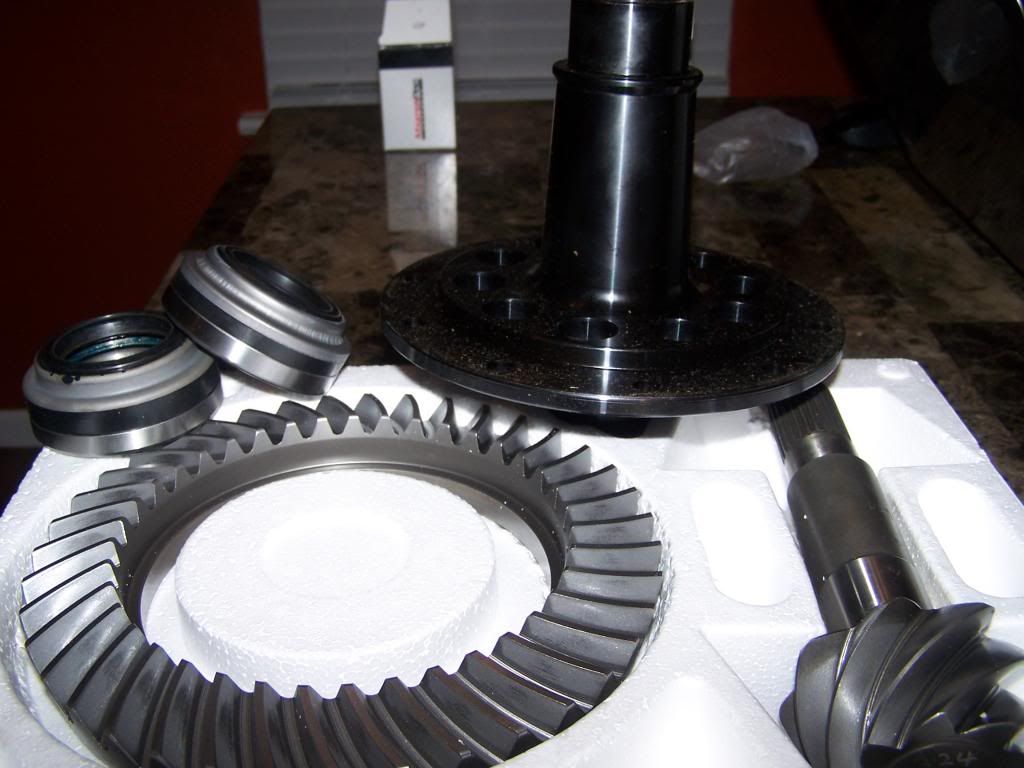

I bought a Chrysler 9.25 (pic below) and a HP Full width 44. I changed my mind on the 9.25 and went with a big bearing, 31 spline Ford 9".
I only acquired the housing and shafts though so I had to purchase everything else separate (center section, gears, yoke, carrier, so on)

So...I ended up with a HP 44 front from a 77 F150. First year for disk brakes, last year for the weld on wedges (before they became cast in 78).
...and a Ford 9" for the rear out of 1979 F150. 31 spline. All I had though for that was the housing and the shafts. I had no center section, therefore no gears, carrier, and so on. I had to buy all that separate.
When using axles that are 35 years old, you are so far from being able to simply throw them under the Jeep (usually). So bringing back the axles from the dead was the first plan of attack.
Removing old seals and bearings from 9" shaft.
All new u joints, seals, and ball joints in the 44. It was quite a task just tearing down the 44 to get to this point, due to the rust making every piece as one unit.

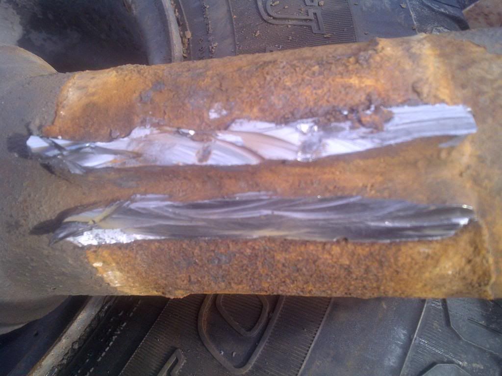

Here is an example of the weld on wedges before I cut them off.
Rough cut from the wedge removal, before grinding smooth.
More parts.

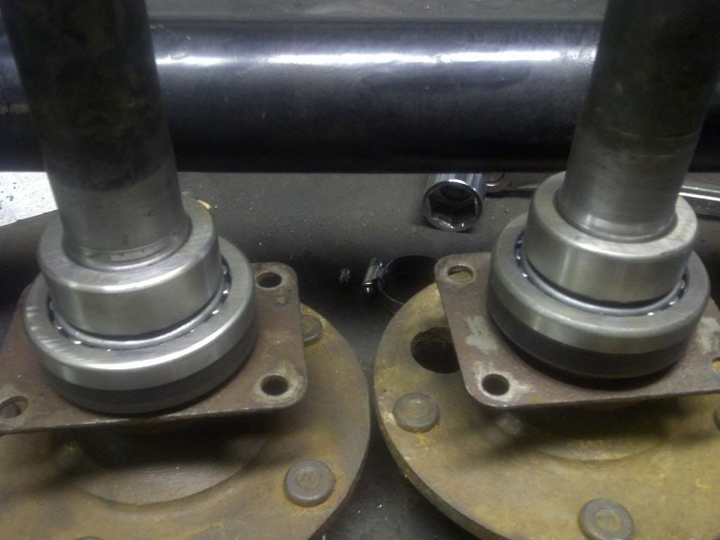

Fresh bearings/seals pressed onto each shaft of the 9"
Ring & pinion in the 9" installed, full spool, pinion guard.

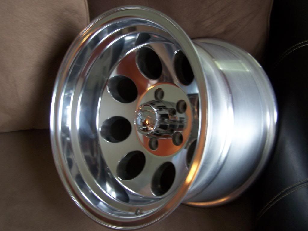

Originally Posted by alienoutlaw89 View Post
love the wheels
Thanks. I put 4 miles on them, and had to sell them.

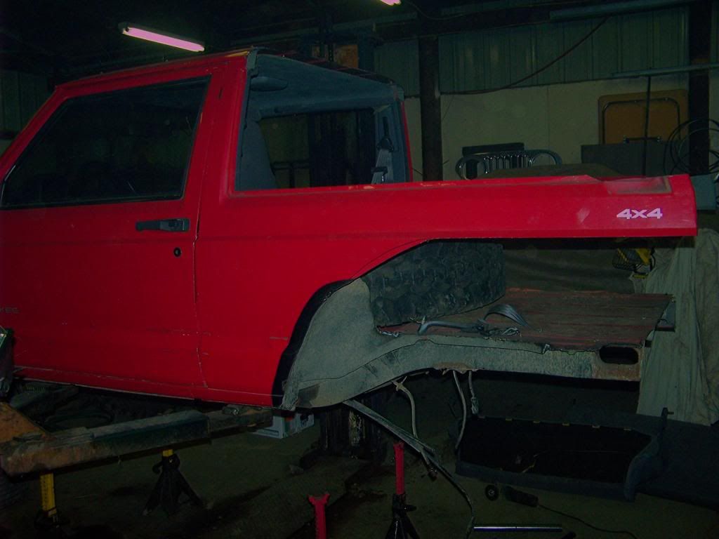

Poor Jeep is about to undergo some surgery.
My basement was starting to look like a garage, but it is time to go to the shop!

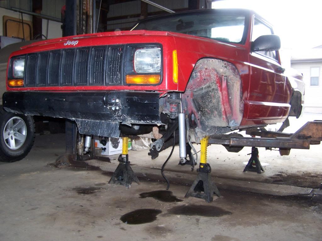

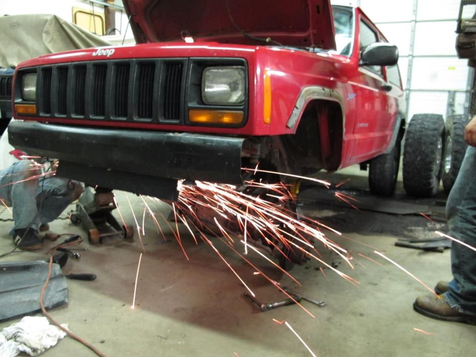

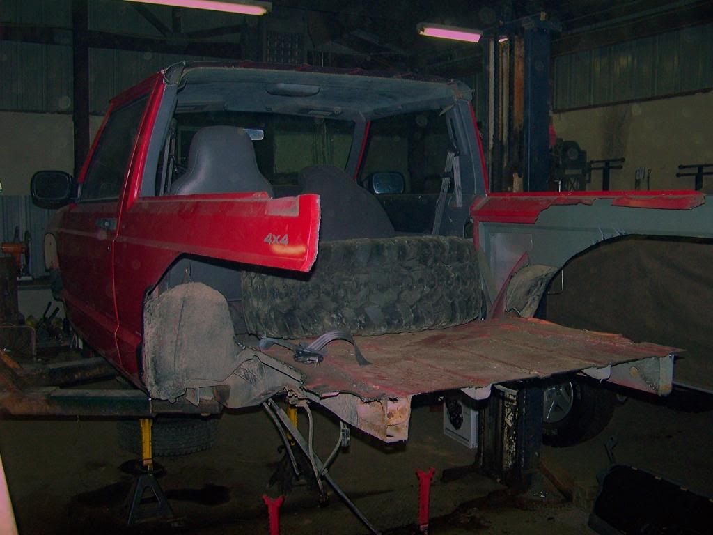

Tear down has begun.
I'd be on your right. I'm actually 6'1", my friend just so happens to be a squatch.

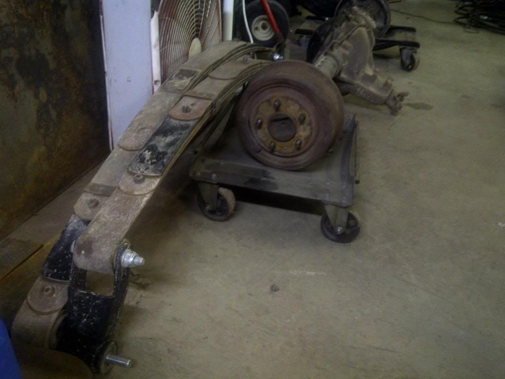

Leafs, gone forever. ...and rear axle and factory gas tank location.
It will be getting dove-tailed in. As said before, sheet metal process still not done, and the jeep will not have doors on unless winter wheeling, maybe not even then. lol
