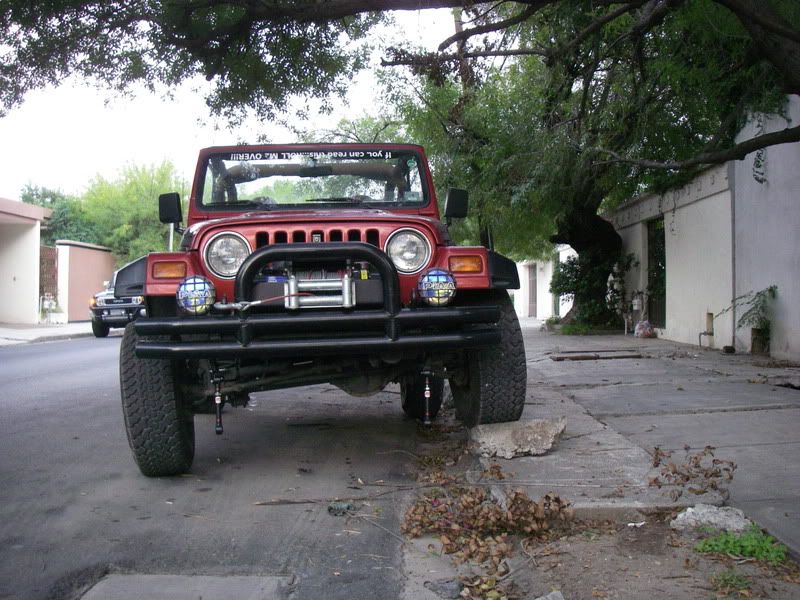

So far the tj has a 2 inch bb with 31x10.5" AT that i got at Pep boys, 6" bushwacker flares, a gibson catback, a K&N cold air intake, tube bumpers, a Sunrider soft top with sliders, smittybilt neoprene covers, PIAA 6" lights, Pro Comp wheels, and recently added a winch... I only got pics of the winch install so thats what you get so far... BUT next to come is a 2.5 OME ultimate kit by DPG which I'm waiting to arrive...

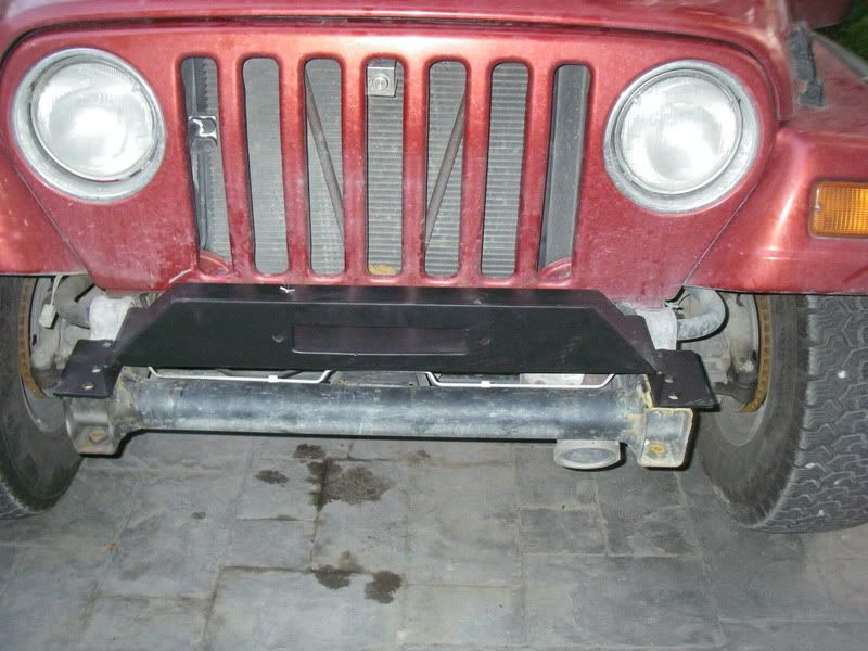

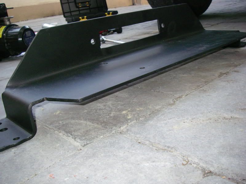

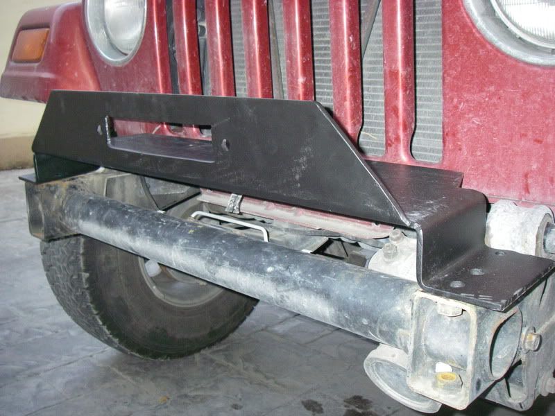

here some pics of the winch plate that I did, I have no pics of the building but I'll tell ya...
It started as a 1/4 38" x 12" steel plate for $28USD .... (I have the plan that I did so if somebody needs it I can upload it too) did some cuts (by hand with a saw bc the cutter broke that day), and sent it to a friend that bent it for me in his factory for free, it took him 2 weeks because the machine was using a diferent part that was going to be changed so they could bent it, taking that he wasnt charging for the favor and business goes first, i really couldnt jump on his a$$ to get it done sooner, but then he gave it to me and I couldnt be happier
took it to the workshop and began the drilling and cutting for the hole of the fairlead... by then, my friend saw my idea, and told me that he could have used the laser to cut it if I had told him which would have been nice,but still, I wanted to feel like i did it.

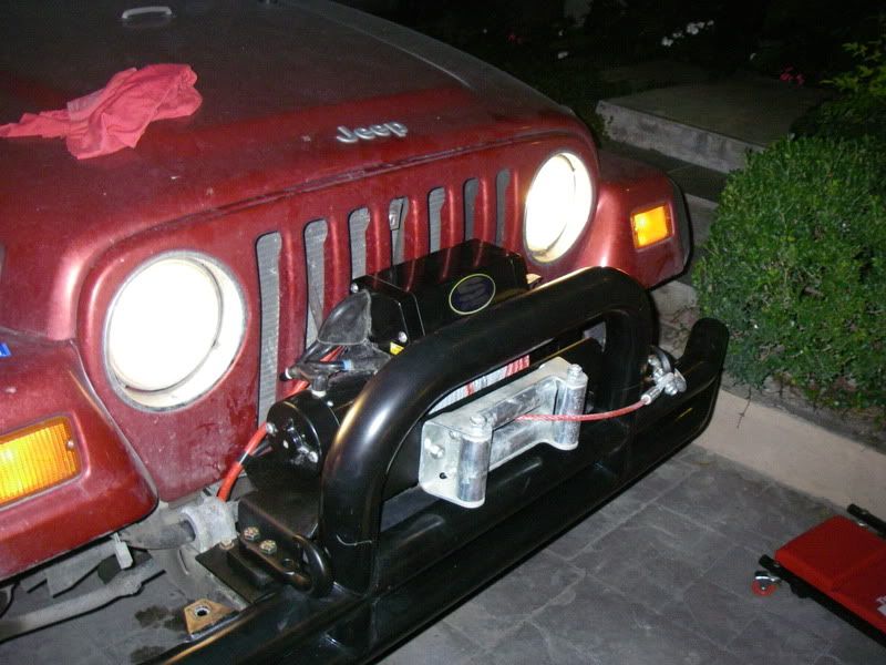

then, before painting, I mounted it on the jeep to test the winch and make shure no corrections where needed, and went off road, the next 2 weeks rained like never in my town, so I couldn't take it off 'cuz I used it to rescue some strangers car stuck in the water... so; after 2 weeks i took it off, got rid of all the rust that appeared bc of the rain, and then took it to the paint shop for some powder coating for $14usd ... this is the result
here you can actually notice that the hole its not perfectly squared, still the clearance its good....
if you plan to do your own winch plate... consider that the screws of the roller fairlead take some space, or you'll end up having to fill those holes you did for the winch base...
Also during the build of the plate, i realized that my front bumper SUCKS big time,,, yeah, it's really off center, and the lamp bases are at diferent distances from the center hoop.... also one side is slightly higher than the other one, having to add more metal fill for the tow hook.
I think next thing I fab its going to be a front and rear bumper, but next to be done to the tj its the suspension I already ordered...

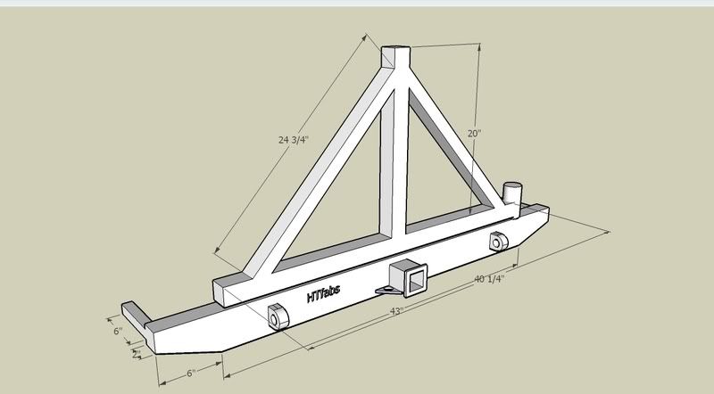

UPDATE!
here, I had to design it... here is the thing... what ya think?

Those are some nice looking Designs. What program are you using to design them?

its a silly program called Sketchups... its made by google and its incredibly easy to use... I mean a 5 yo kid can use it.... its very VERY useful,... and free!

Thought so, those designs look good, I'm looking forward to seeing them built

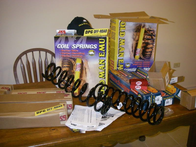

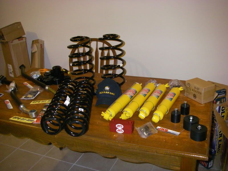

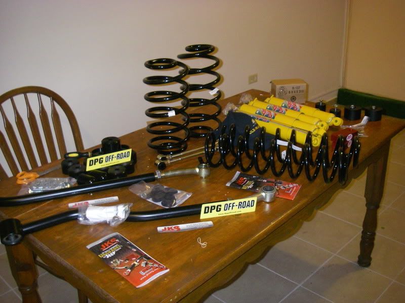

I've got the suspension system!
Here are some pics, i got it today, im very very exited, its just,... beautiful this is the ultimate kit from dpg off road, and... well its just nice nice nice... cant wait for the next weekend...
here ya go guys take a look at this things...
there you are!

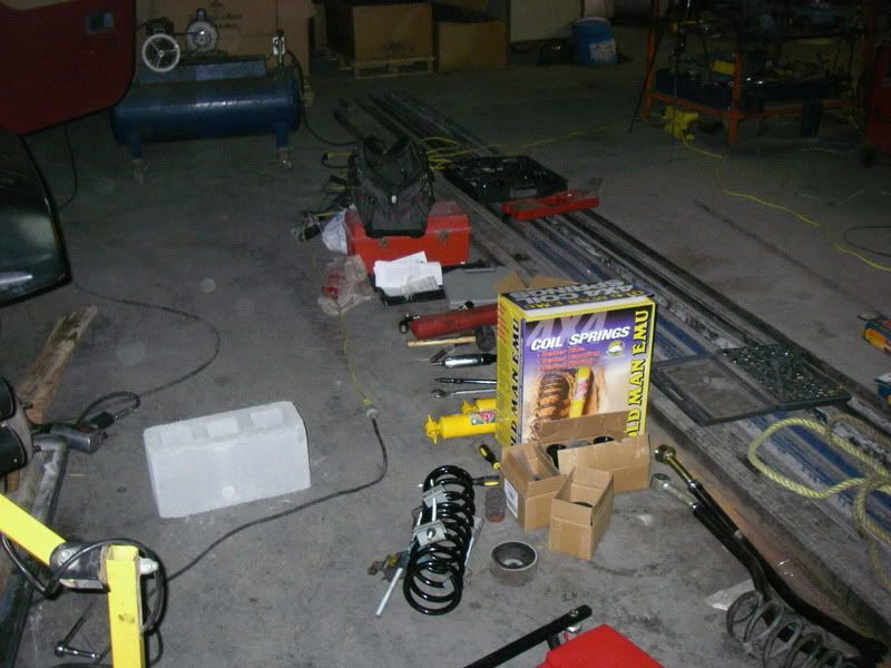

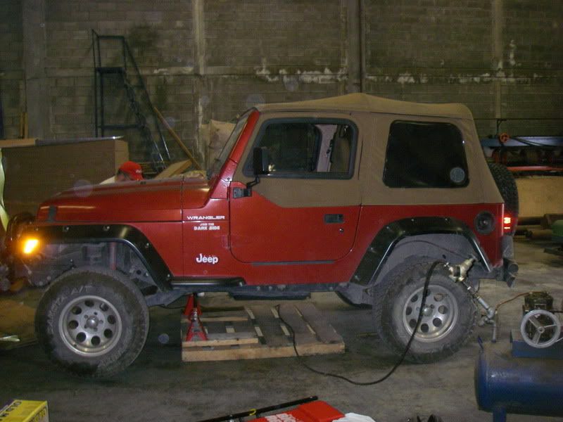

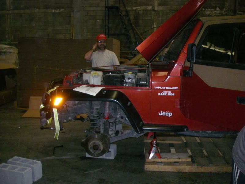

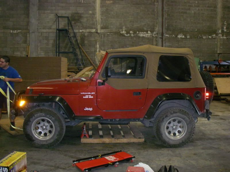

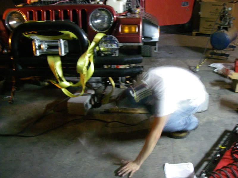

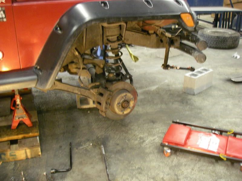

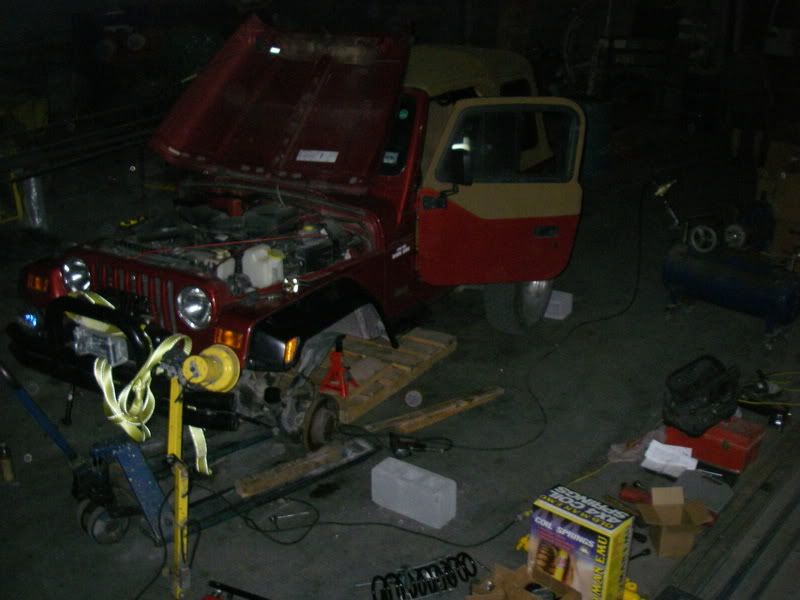

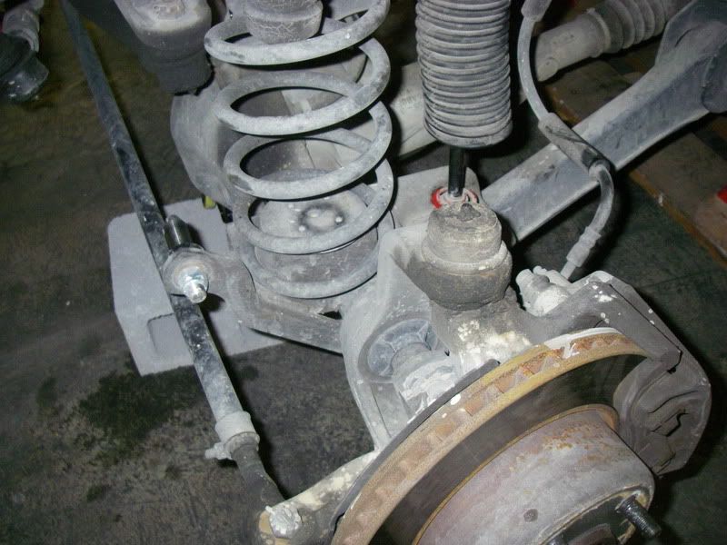

Suspension install began today, , i gotta say it was madnesss its really taking more time than i tought it would, and we are using an impact wrench so,....
still im having fun.... here pics of today's (yesterday) work, all I did was remove the OE suspension and prepare for the new one.

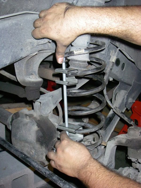

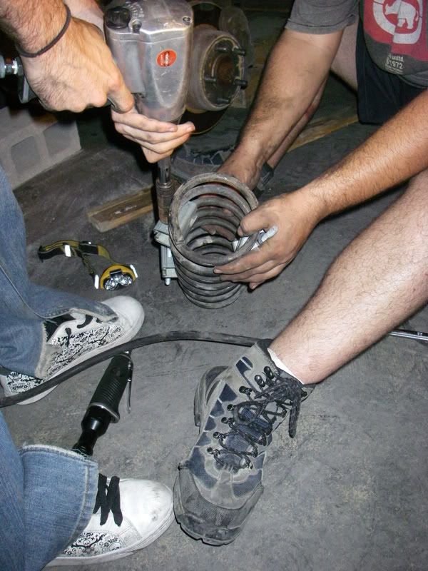

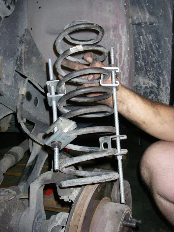

We where having so much trouble taking out the stock springs with 2" BB that we ended up making a spring compressor in the shop... you'll see what i mean
This is my friend, he studied a mechanic technical career so he knows something
Open your mouth and say AAAAHHHHH
This are the compressors that we created
And they worked

We found out that the new springs, since they weye thicker and stronger ( HD ) the compressor wasnt going to be able to do it without bending, you can see it in the pic, so we'll try to borrow a compressor today,
ok guys, its time to go to end this thing
