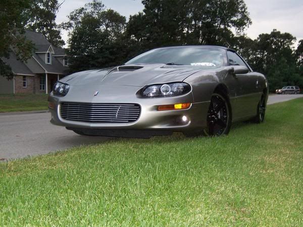

400 bucks, i bought it from my brother. he has a 2000 SS
he bought an ls2 crate engine and i took his old ls1
