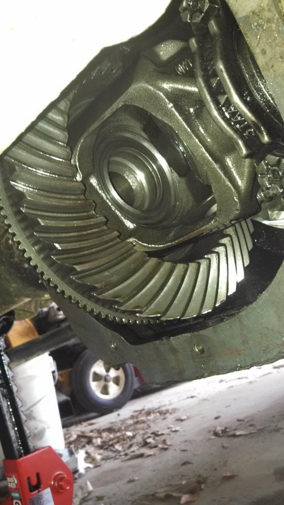

8.8 spider gears decided to go boom and take the carrier with. Im either just going to replace it with another open carrier or bump up to a limited slip. This carrier only had about 30k on it before it failed so I have to try and figure out if the limited slip is any stronger.

Here is some pictures of the rear end. Only one spider gear was flattened out and that side of the carrier was worn way in exposing the c clip. I got real lucky that the axle shaft didn't fall out on me.
Here is worn spider gear
Hard to tell but the worn carrier

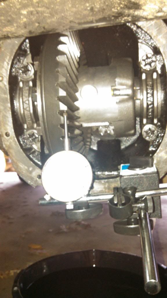

I ended up going with a ford racing posi unit with carbon discs for $215 shipped to my door. Got new timken bearings and put those on so I could put the carrier in and check backlash. With the same shims the backlash was at .009" which is on the lower end but still in spec for the 8.8. I forgot to get gear paint so I am going to pick up some of that and have a second set of eyes watch my dial indicator just to make sure I got it right and then I should be good to go.

You know how to set up gears??
Yep, between my jeep, my brothers jeep and my truck this is 7th rear axle I have done
