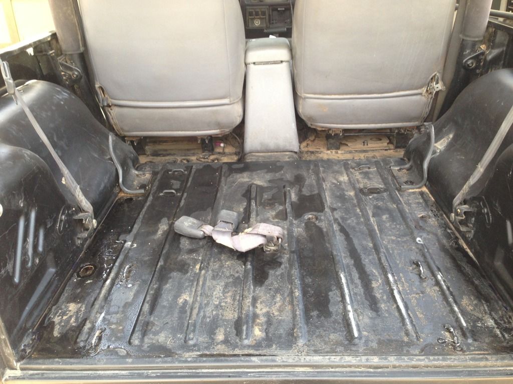

97 TJ Build Thread
The interior had all been done with black rattle can spray on bedliner. It didn't look great and was impossible to clean. I spent an entire weekend stripping it out. I soaked it in Jasco paint stripper, then Aircraft paint stripper when the Jasco didn't work. Even the aircraft stuff didn't do much, and I had to manually scrape it out with chisels and flap discs on an angle grinder. It was brutal.
