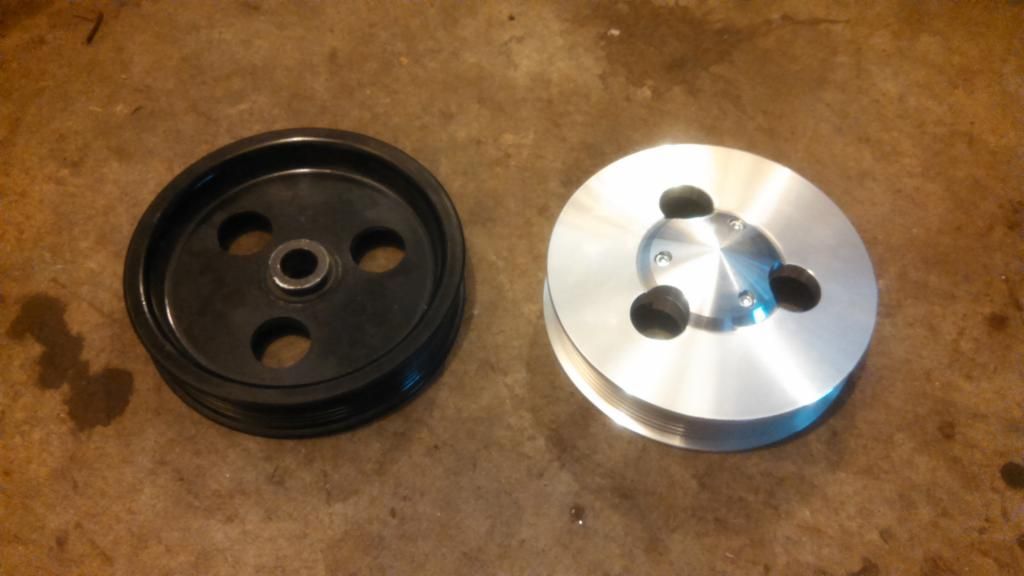

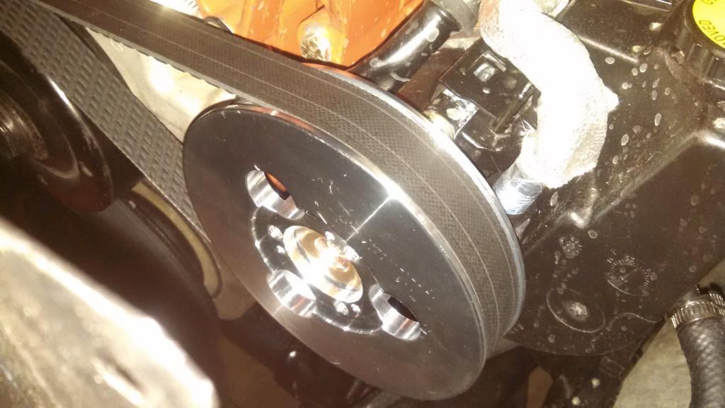

Well, I passed MD state inspection with no problems! Been driving it almost everyday. Still love it but had a few issues to work out. First was a bad PCV valve making a racket, new Mopar PCV fixed that but I still had some belt noise. I never really liked the plastic pulley on the power steering pump but couldn't find a good replacement. So I started researching and found that the 5.2 ZJ pulley is the same as a Dodge Viper in terms of inner bore diameter, .661" and outer diameter `6" and is also 7 ribs. I found that March Performance makes a billet pulley for the Viper and decided to try it out. It fits and looks great, no more wobbling plastic crap.

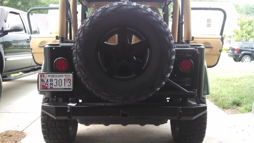

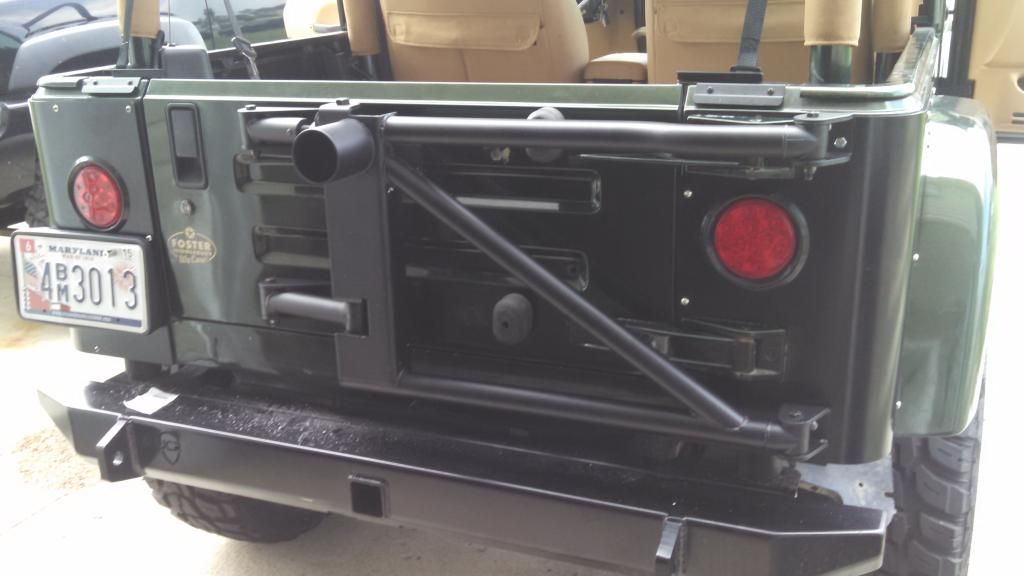

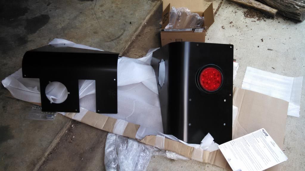

Next, it was time to address the spare on the tailgate, it was way too big for the stock carrier and I started to get a rattle. So I ordered the Bestop body mounted tire carrier. I also wanted to strengthen the attach points so I ordered some PSC trail corners with LED cutouts. Got it all installed but in the process found some really bad rust under the rear roll bar outboard fastener. I drilled the head off the Torx bolt and in a rush decided to try to punch the seized stud out- took some sheetmetal with it! Gonna run it as is for now but I have got to fix that soon. I love the look of the both products and no more rattle.
PSC Corners
Before
After!
