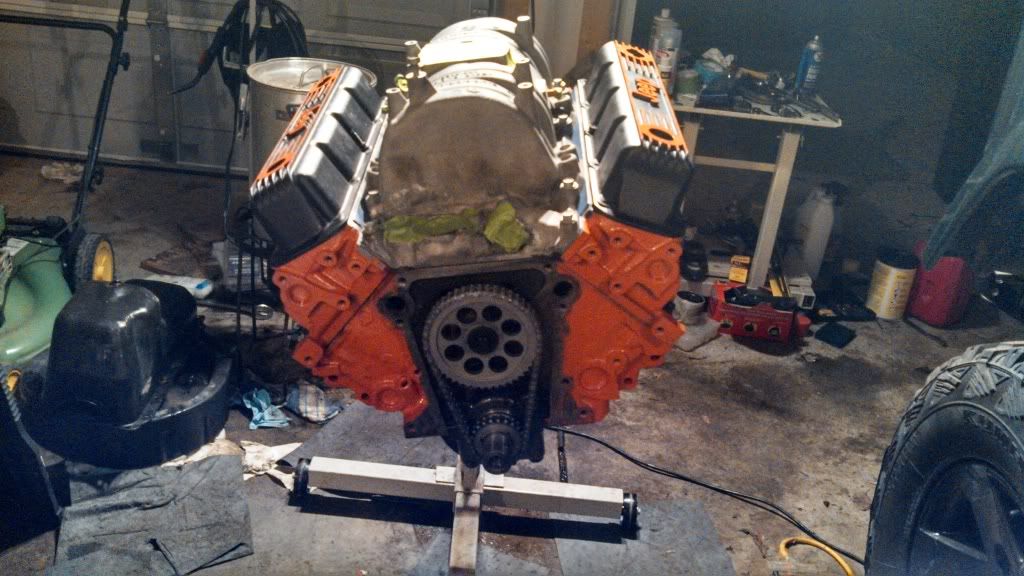

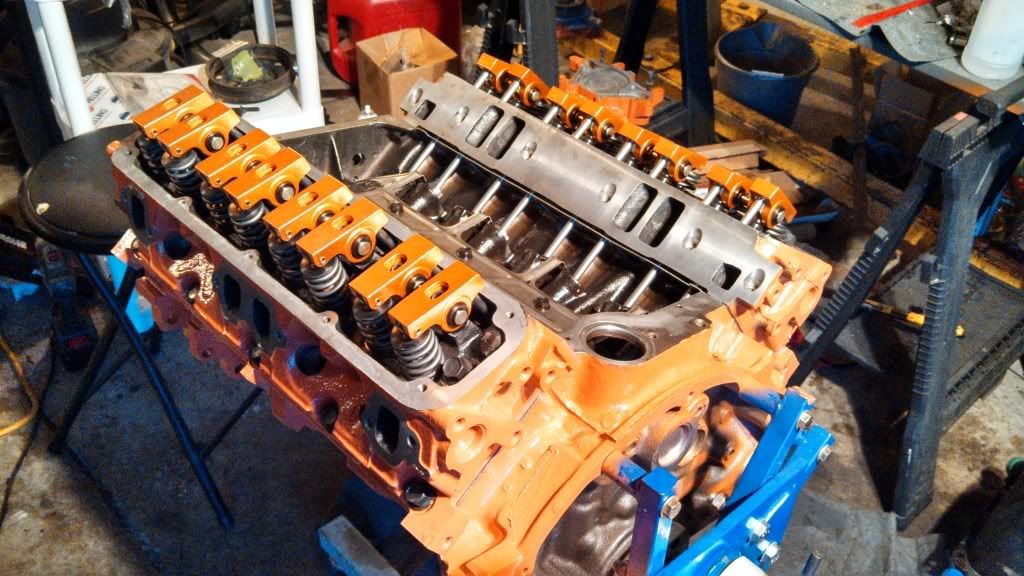

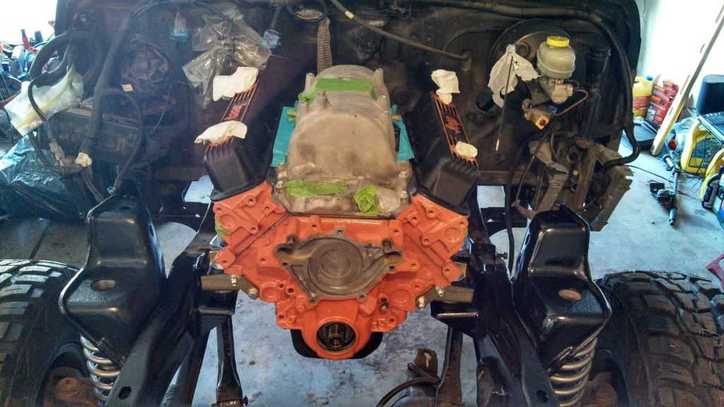

Updates! Engine work progress
Its been a while but I have been hoarding engine parts for a long time and started putting it all together! Had the block cleaned, cam bearings/freeze plugs installed, and bored .030" over to true up the cylinder walls. Brought it home and painted it hemi orange, hope it holds up. Got some new heads from odessa cylinder head, supposed to be a thicker, stronger casting. Slowly ordered rebuild stuff, new pistons/rings, bearings and gaskets. Started assembly this past weekend and it went well for my first engine build. Only problem was I broke a piston ring , and after calling summit and federal-mogul was told I would have to buy a whole new set and that they didn't sell individual rings or single piston sets! I found a cheaper set than my originals but with the same materials and size so that should be here soon. Anyways, once that is done, the heads can go on and I can start buttoning it up. Hope to get the motor mounts welded in this weekend. Then its back to hoarding parts like all engine accessories, flywheel, clutch kit, driveshafts and the list goes on. Long process but its going to be worth it.
Heres some pics as of today
IMG_20130421_182651_542_zpsaad3e8f9.jpg   IMG_20130421_182548_967_zps72964025.jpg   IMG_20130421_164244_553_zps3d3506c1.jpg   IMG_20130420_154605_796_zpsd87983c5.jpg   IMG_20130420_121506_479_zpsde88f3f7.jpg

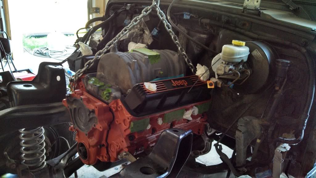

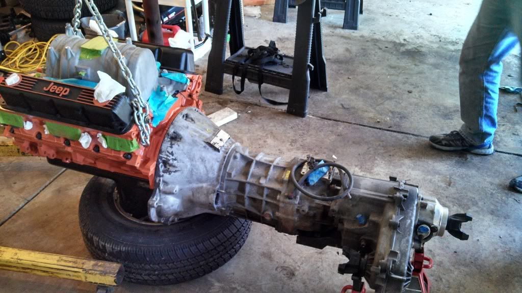

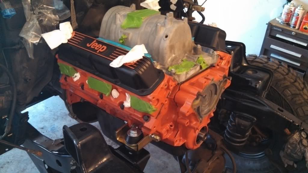

Motor is in!
Finally got the motor finished, minus a few bolt ons here and there.
Good enough to go ahead and mate the trans and get the mounts welded in. Originally I wanted to remove the alignment pin from the AA motor mounts and move them back a few inches to retain the stock trans mount location but, it didnt work out that way. The engine would have been riding hard on the firewall, so I decided to just move the mounts forward and modify the trans mount location on the skid.
Other than that everything looks good.Now to finish my wiring harness and then wrap up about a thousand other loose ends haha. I hope to be able to post a first start up video very soon.
