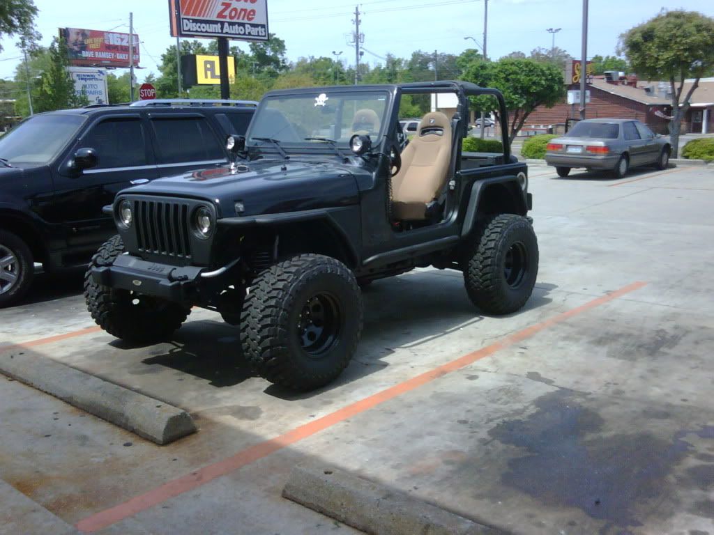

Exterior:
Smittybilt XRC 3" flare tube fenders front/rear
XRC rock rails
XRC rear bumper w/ swingout tire carrier
Factory front bumper shoertened/bedlined
front grill bedlined/punisher emblem painted radiator
sway bar painted to match suspension
HID's/black housing projectors/LED tailights/third brake light
shaved antenna/powered antenna mounted inside windshield
removable spotlights on hood/new soft top

97 Wrangler 4wd 2.5l 5 Speed TJ. Suspension:
2.5" in RC lift and shocks/1.25" JKS Body lift/JKS 1.25" motor mount lift/Adjustable Lower control arms/Poly control arm bushings in all others/JKS sway disconnects/JKS adj front Tie rod/Teraflex Steering Dampener/ HD TRE's/Energy suspension front Sway bar bushings/tummy-tucked factory trans skid plate
33"X12.5" Toyo open country M/T's on Cragar soft 8's with matching spare balanced with BB's.
Engine/Drivetrain:
2.5l 4cyl. 5 sp trans
Dana 35 rear/dana 30 front axles
rebuilt front/rear driveshafts
Air raid CAI
Radiator stripped to brass/painted black/punisher emblem
Painted pulleys/power steering pump bracket
New: plugs/coil/wires/water pump/serpentine belt/heater core/thermostat
Optima red top battery
Brakes: rebuilt rear drums/New front rotors/pads/calipers/JKS stainless lines
Flowmaster exhaust/removed cat

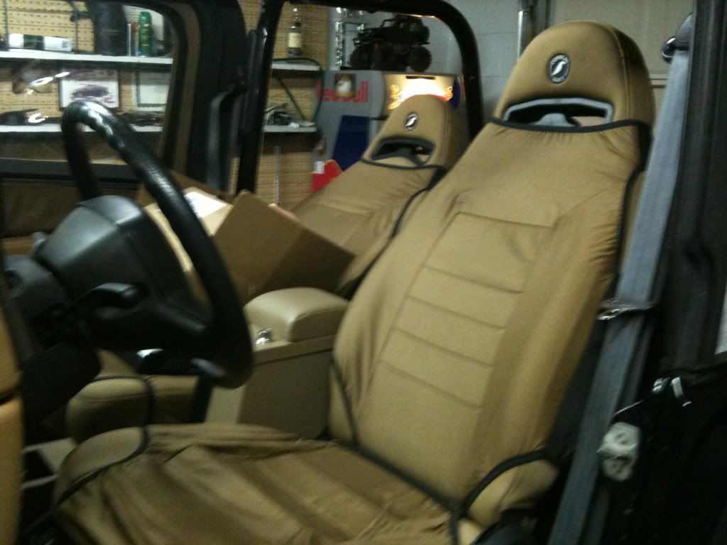

Interior:
Best top locking rear storage unit
factory grey dash replaced w/ spice everything
Tuffy spice locking glove box/full center console
corbeau neoprene Moab seats/sliders
Sony Marine cd player/ipod controller
MTX marine amp under seat/rear speaker pods/sound bar/alpine speakers everywhere
Red LED Lights in dash/bezel/hyper white overhead light
Entire interior has been lined with Monsta-liner/removed rear seat
Bedlined skull shift knob
Autometer a/f ratio/voltmeter A-pillar with red LED's

are those rims 15x10? i love the stance of your jeep

Thanks guys! yep, 15x10 w/ a 1" spacer.
