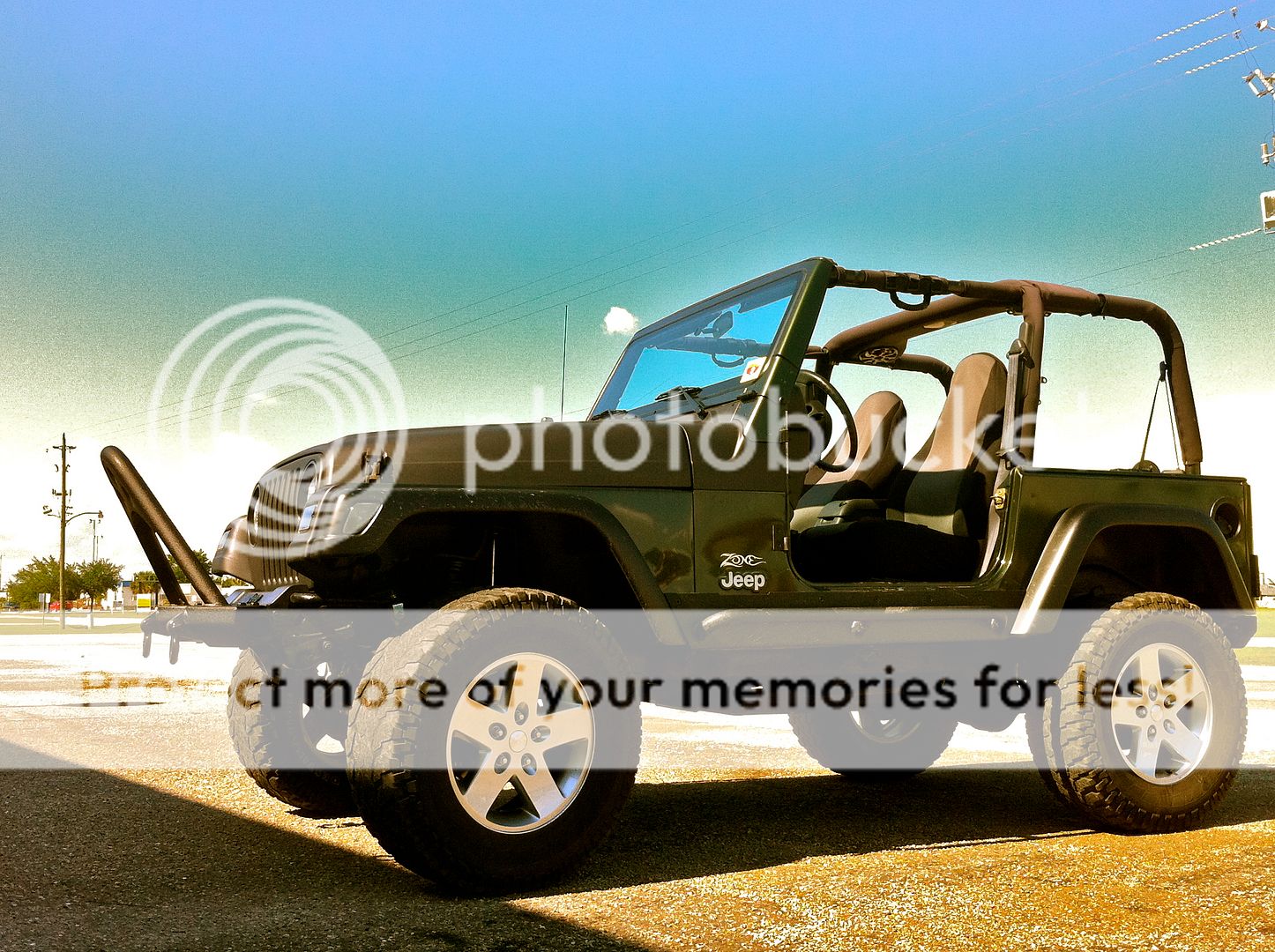

So I always wanted a Jeep Wrangler and recently had an opportunity to pickup a 1997 TJ for cheap. Being that it is an SE with 4cyl and auto trans dana 30 and 35 cheap is really all it was worth anyway:laugh: But now i had a platform to start with and with our first child just being born I will be selling my motorcycle which will help fund the build. Along with what I had sold of a collection of 1/5 scale RC cars, one of which paid for the Jeep. But still looking to do this build on a budget and so I won't be buying $900 bumpers. The Jeep is taking place of the motorcycle as a toy and I still have my F-150 daily driver so can afford to have it down(torn apart for days or weeks at a time).
What I purchased in October of 2010
What I sold to buy the Jeep

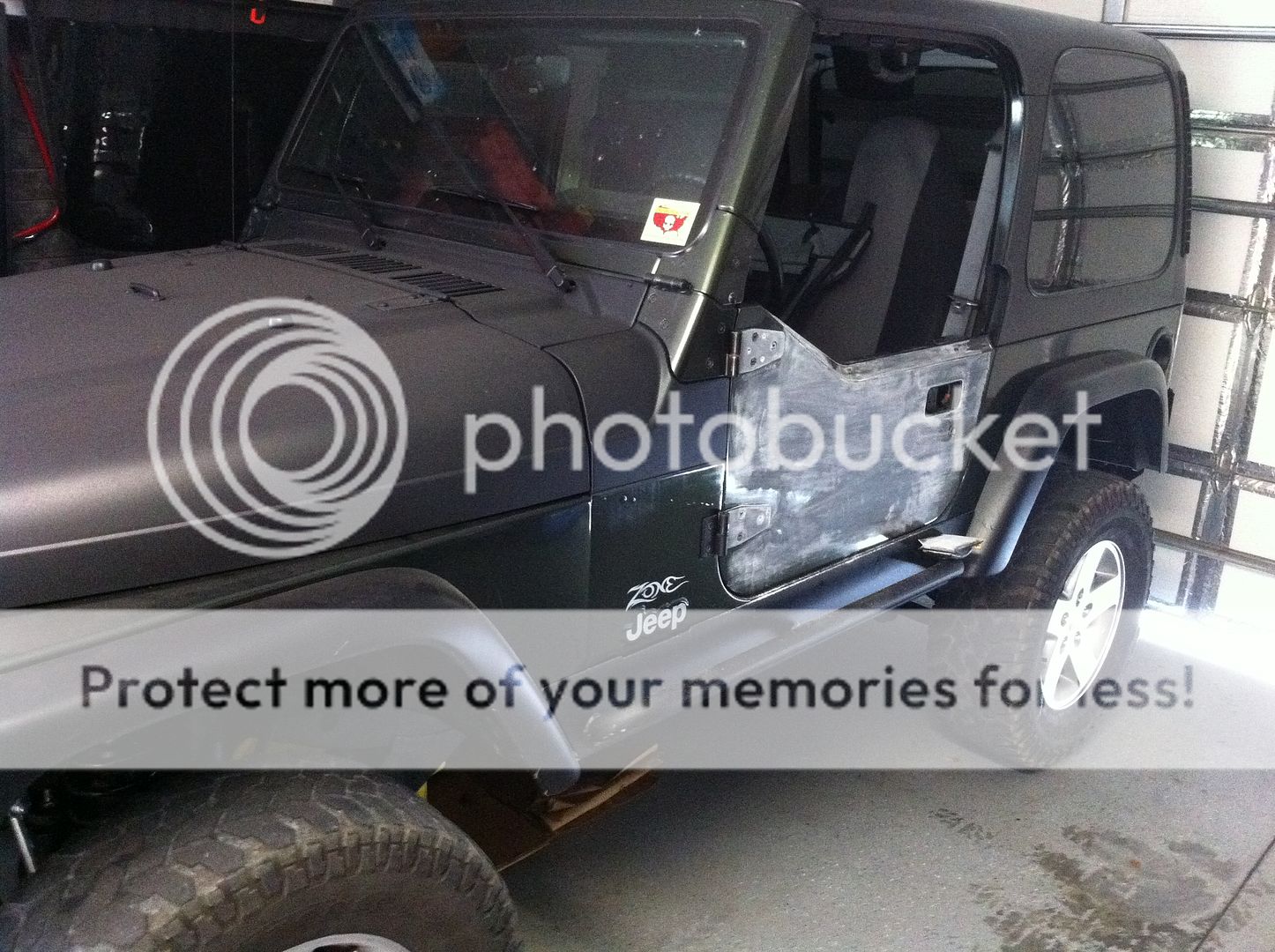

Took off the fenders to repaint and removing the stock steps. Also cut off front bumper jugs
With the carpet torn out the floors revealed some rust but not as bad as I would have thought with the condition of the top which would be my next purchase.

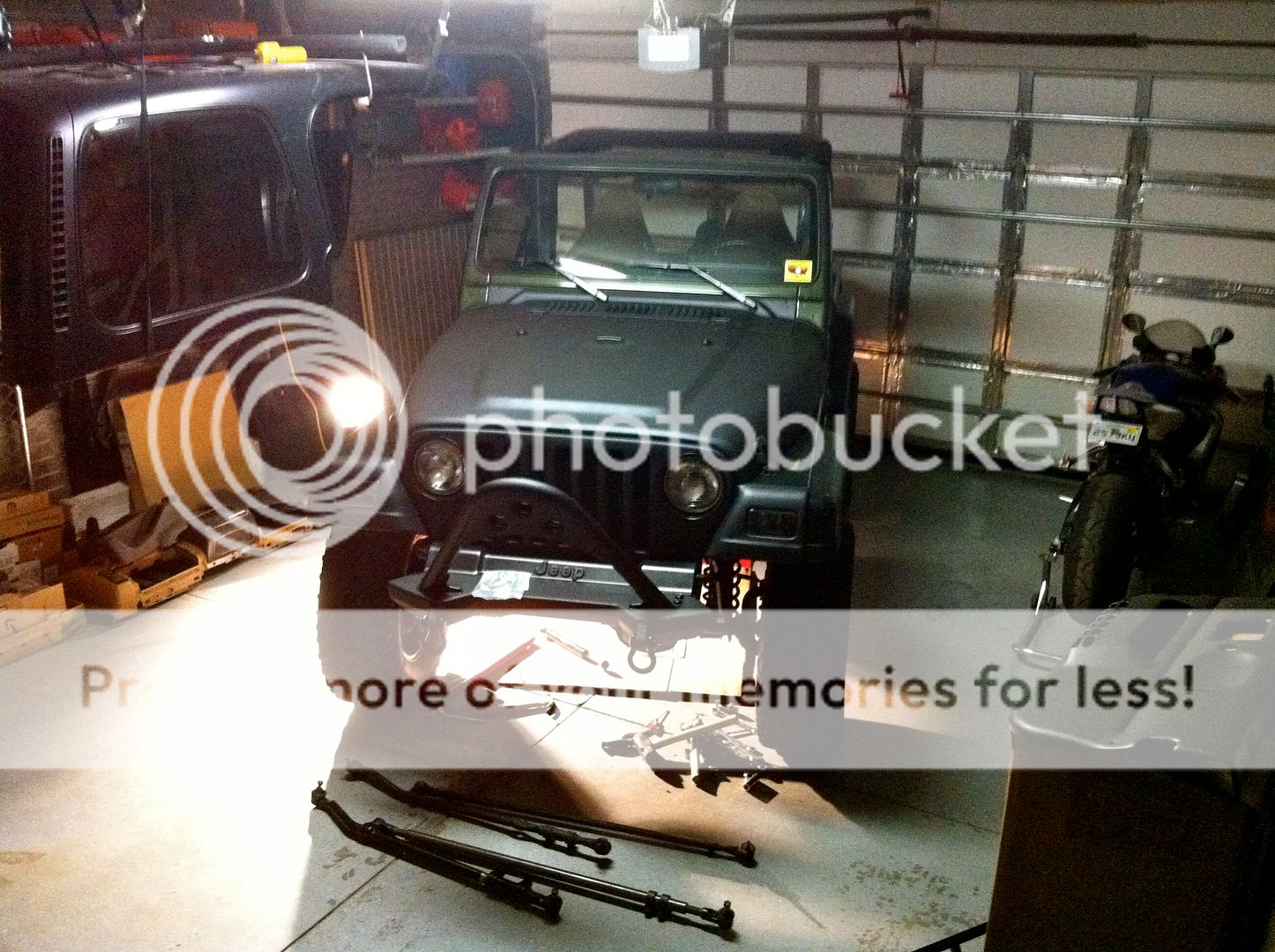

Well had alittle time to work on the Jeep this weekend and made some progress worth noting. I had a spend $100 get $50 off at Advance Auto so I bought some Sylvania Silver Star headlights basically for free. I heard alot of good and bad reviews but figuring the next time I drive the Jeep at night will be the second time ever I couldn't justify spending to much on lights:laugh:. Which is why I went with the cheap Northern Tool SPS fog lights as well, more for just in case than anything I will use often.(have to install them as well)
Then I started on the install of the smittybilt rear fenders. Was going well until I noticed they don't come all the way down in the front and leave some of the hole and the bottom bolt hole exposed. So looks like I will end up getting the corners to cover this up at some point.

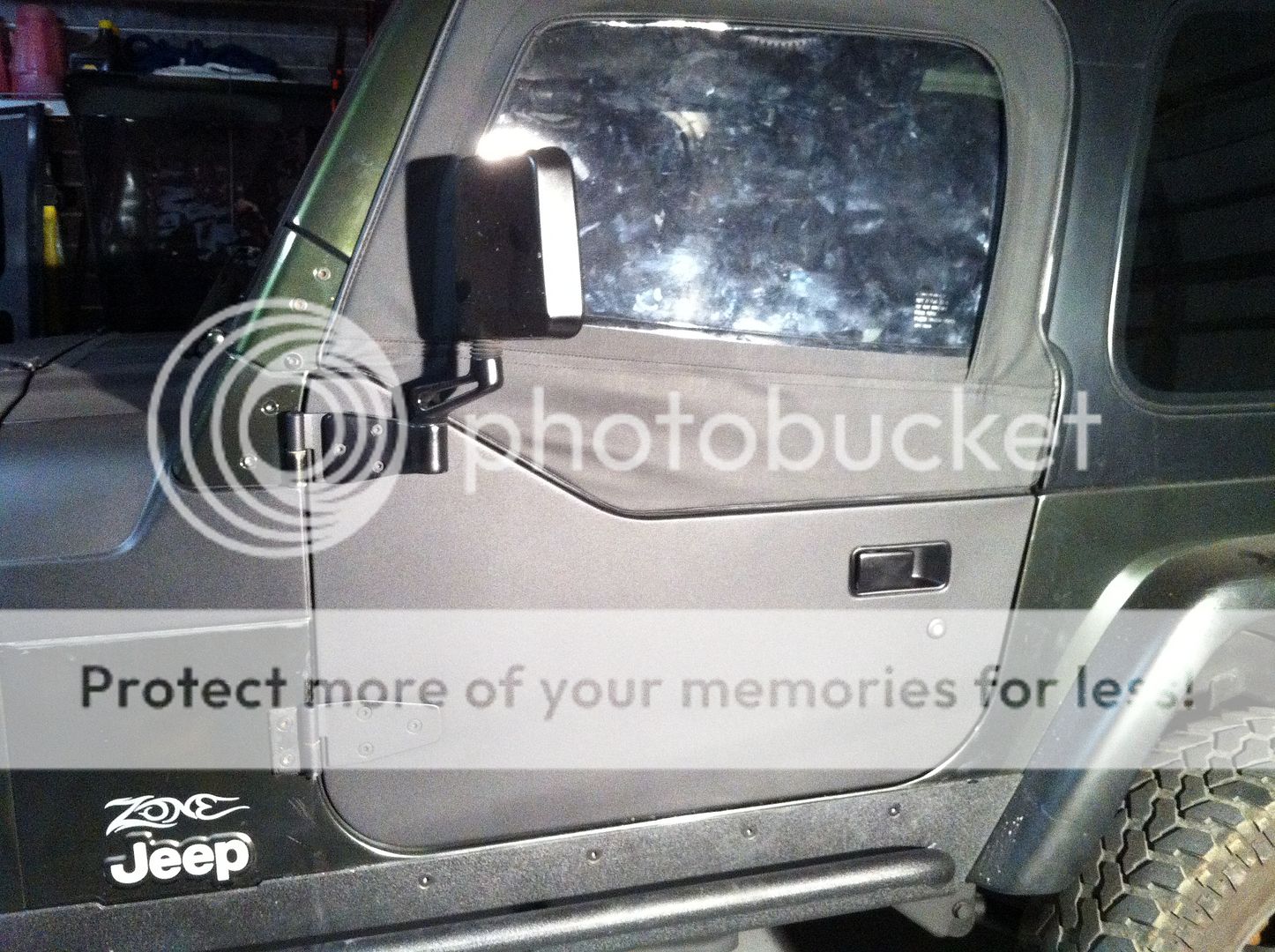

Well got the locks rekeyed and back in the doors, really easy and love being able to just have one key.

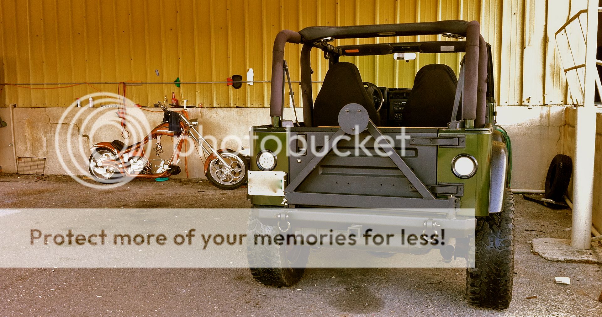

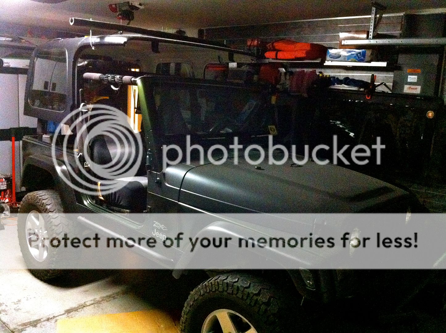

Got both the Smitty Bilt XRC seats in. Not a perfect fit but they work, just rub on the roll cage some.

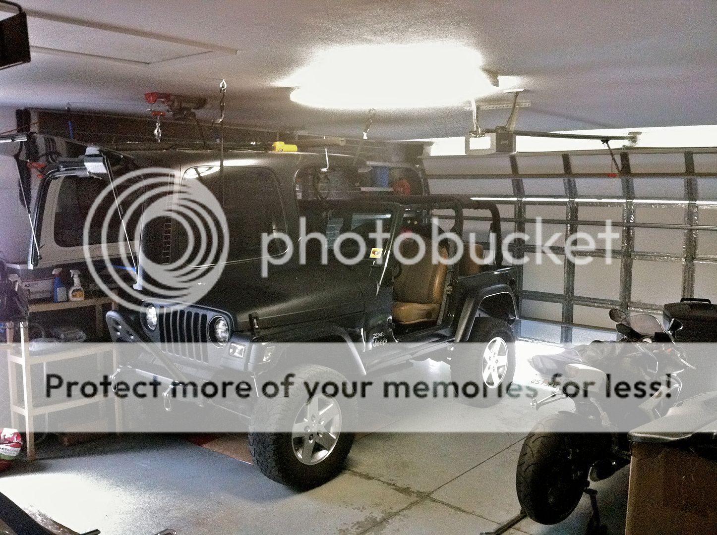

Garage is filling up with spare Jeep parts, time for some Craigslist selling

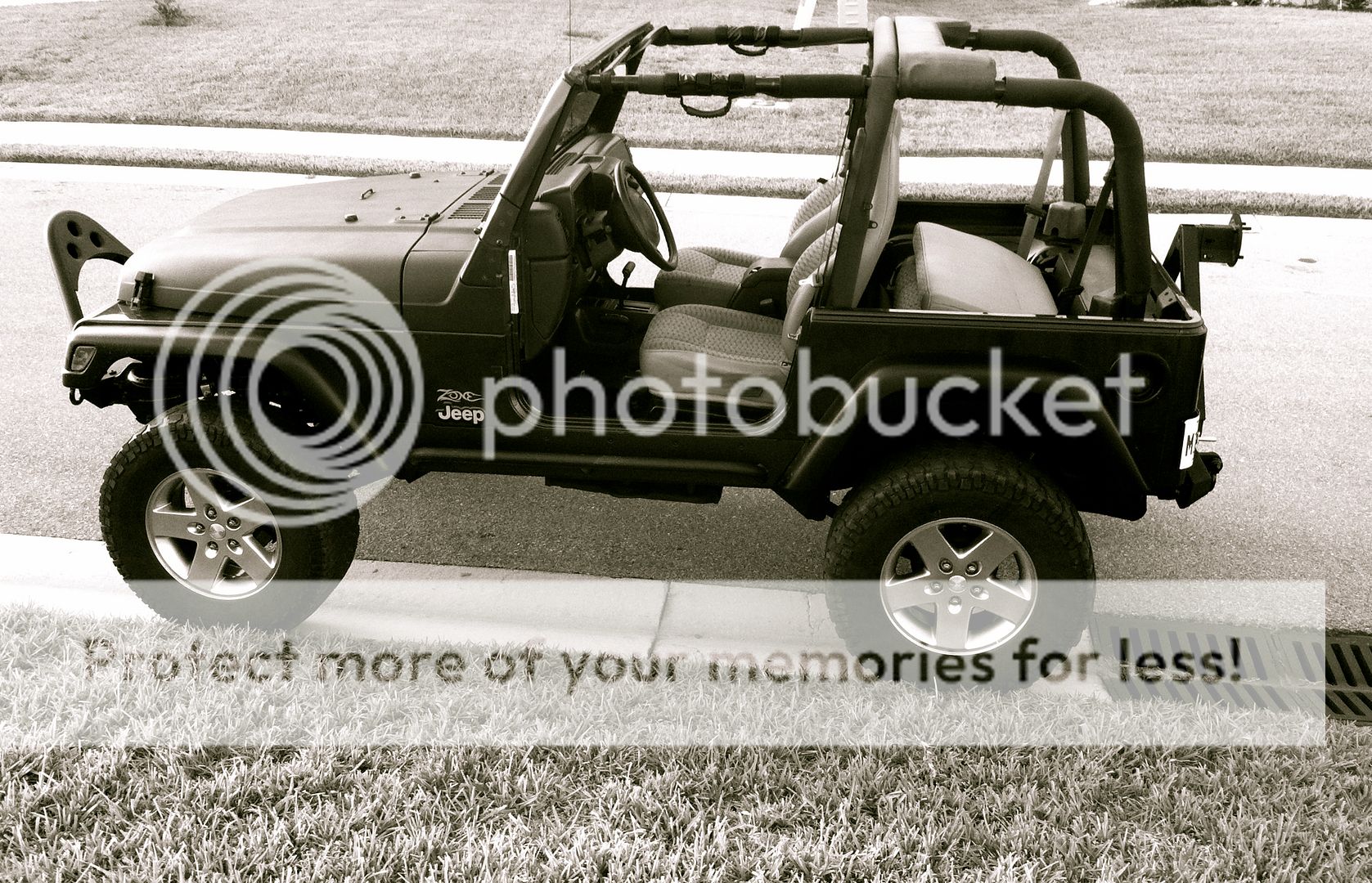

So much more to do, but little by little it keeps getting better.
