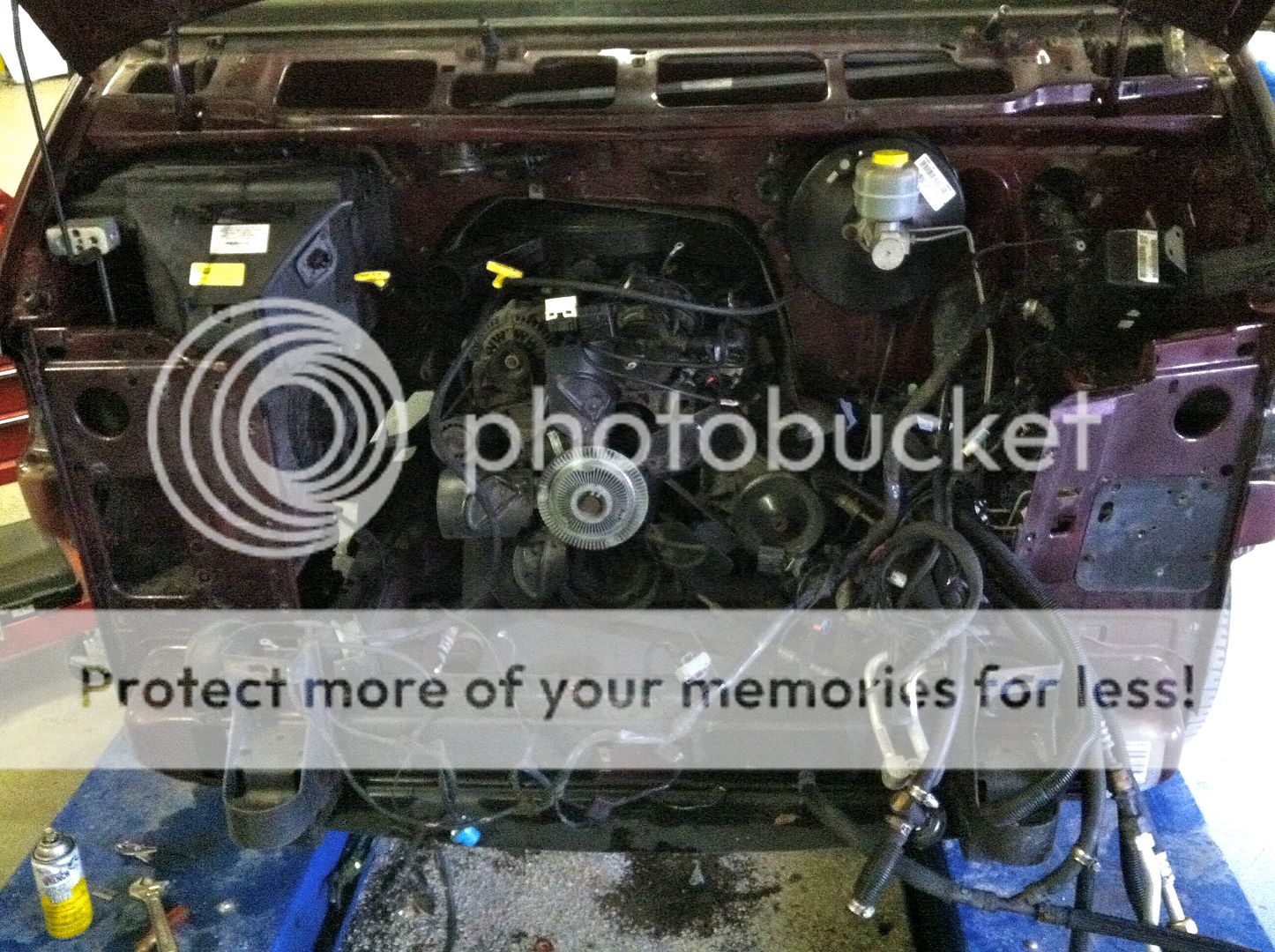

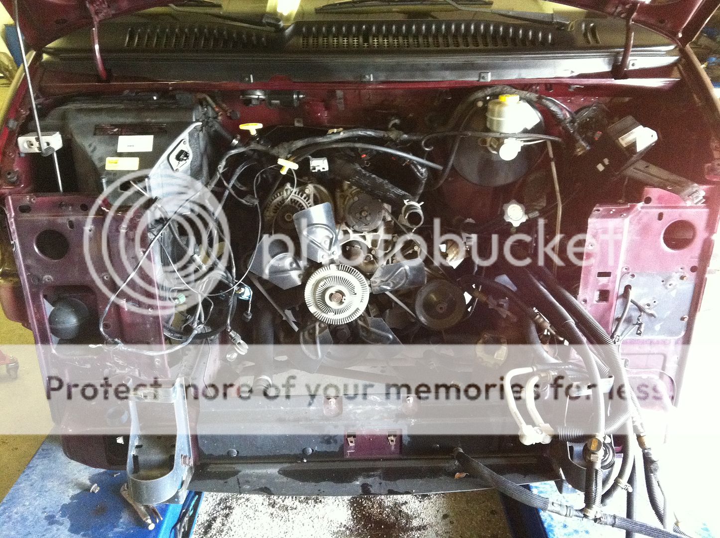

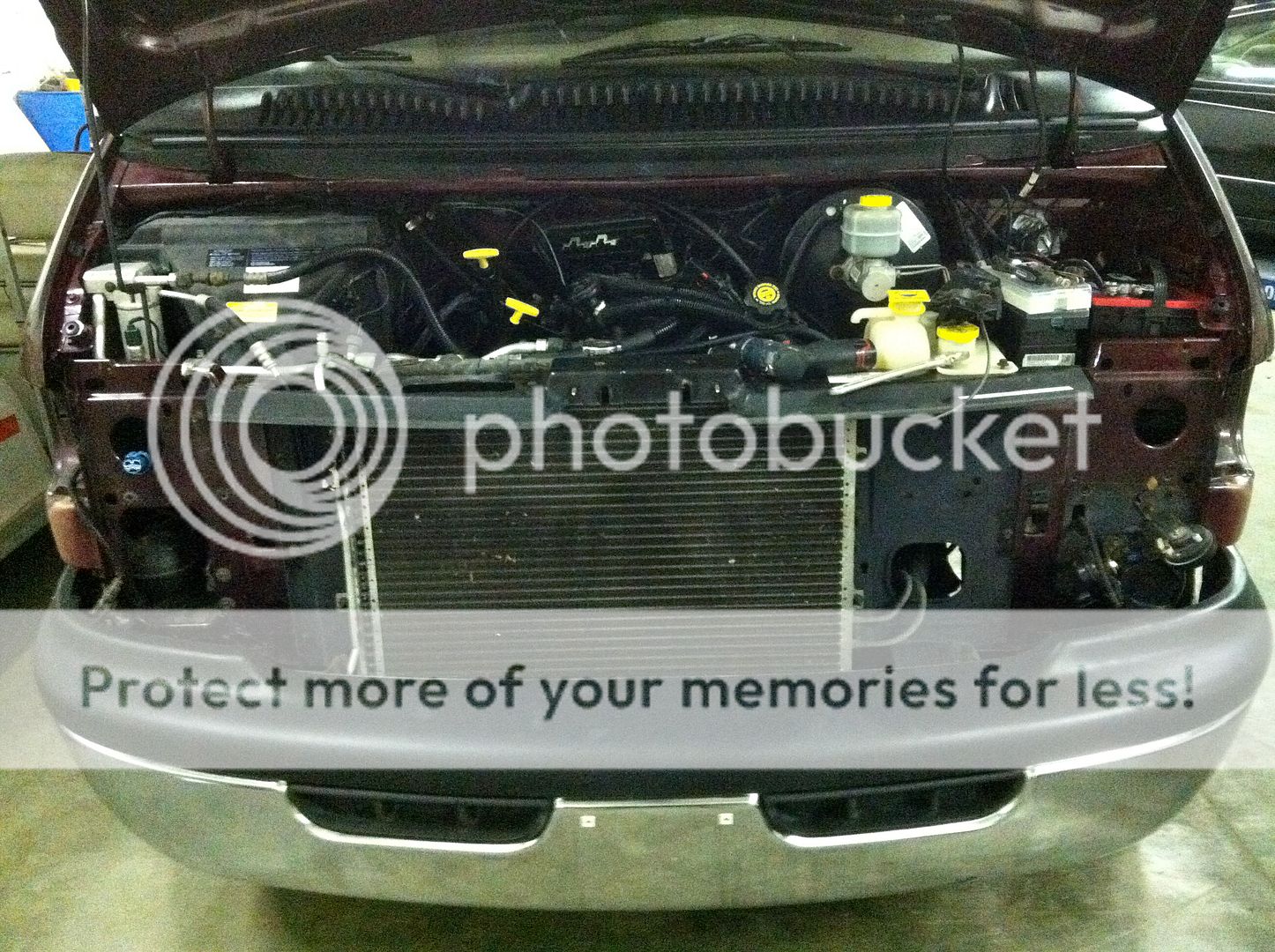

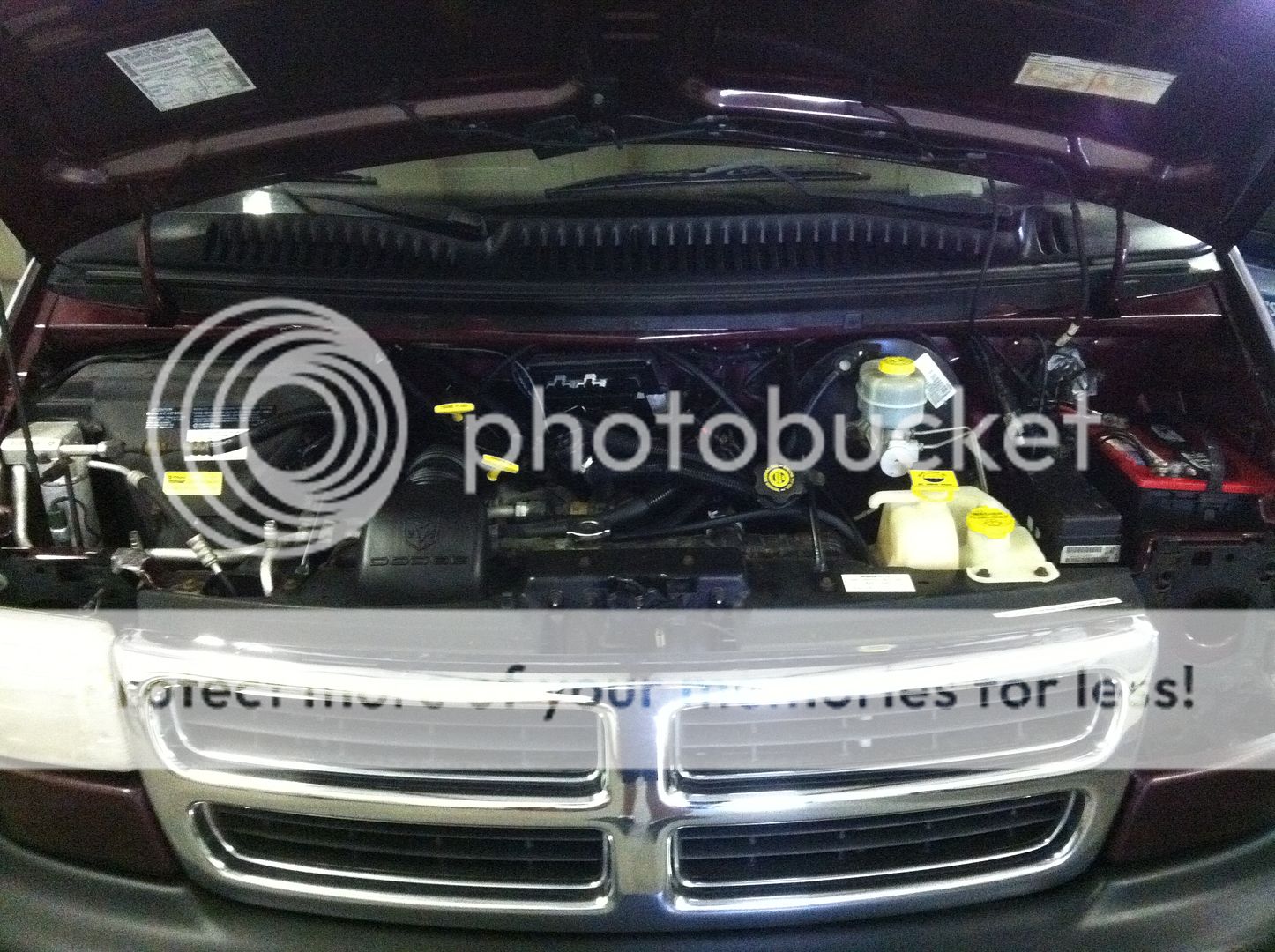

Well like the rest of this build the motor is coming out of the van slowly. After dismanteling the front some I raised it up in the air (benifit of working some where with lifts) and disconnected the trans, exhaust, starter, motor mounts, drained the radiator and removed hoses, steering pump lines etc. so it should be ready to come out on Monday.

Once again spent alittle time after work removing parts from the donor. It is ready at this point to come out. will drop the trans then pull the motor and send it on its way to the crusher by Friday.

Well it is out of the van and after alittle cleaning and typical tuneup items being done will be ready for it's new home. I plan on getting it in the jeep and running well then after awhile doing some modifications to add power if needed. Plan on new valve cover gaskets,plugs,wires,cap,rotor,water jacket kit, rear main seal etc.... just easy things to knock out while it is out on the stand. Also looking at headers from Summit Racing or painting these stockers up. Would also like to find Jeep valve covers for cheap just to keep it looking as stock as possible.
Also have the 44RE out and setting up someone to switch out the cone so it mates with the transfer case in the Jeep. would have been nice to find a 4x4 donor but they want to much for them. Also have looked into doing a 46RE that's 4x4 ready in it's place, just a more heavy-duty trans.
That's what I'm talking about
I have to say this would have not been a problem in my garage at home (other than the van wouldn't fit) but was very nice to have access to a lift. But nothing at this point you couldn't tackle on your own (I did have them evacuate the AC system for me) in the driveway.

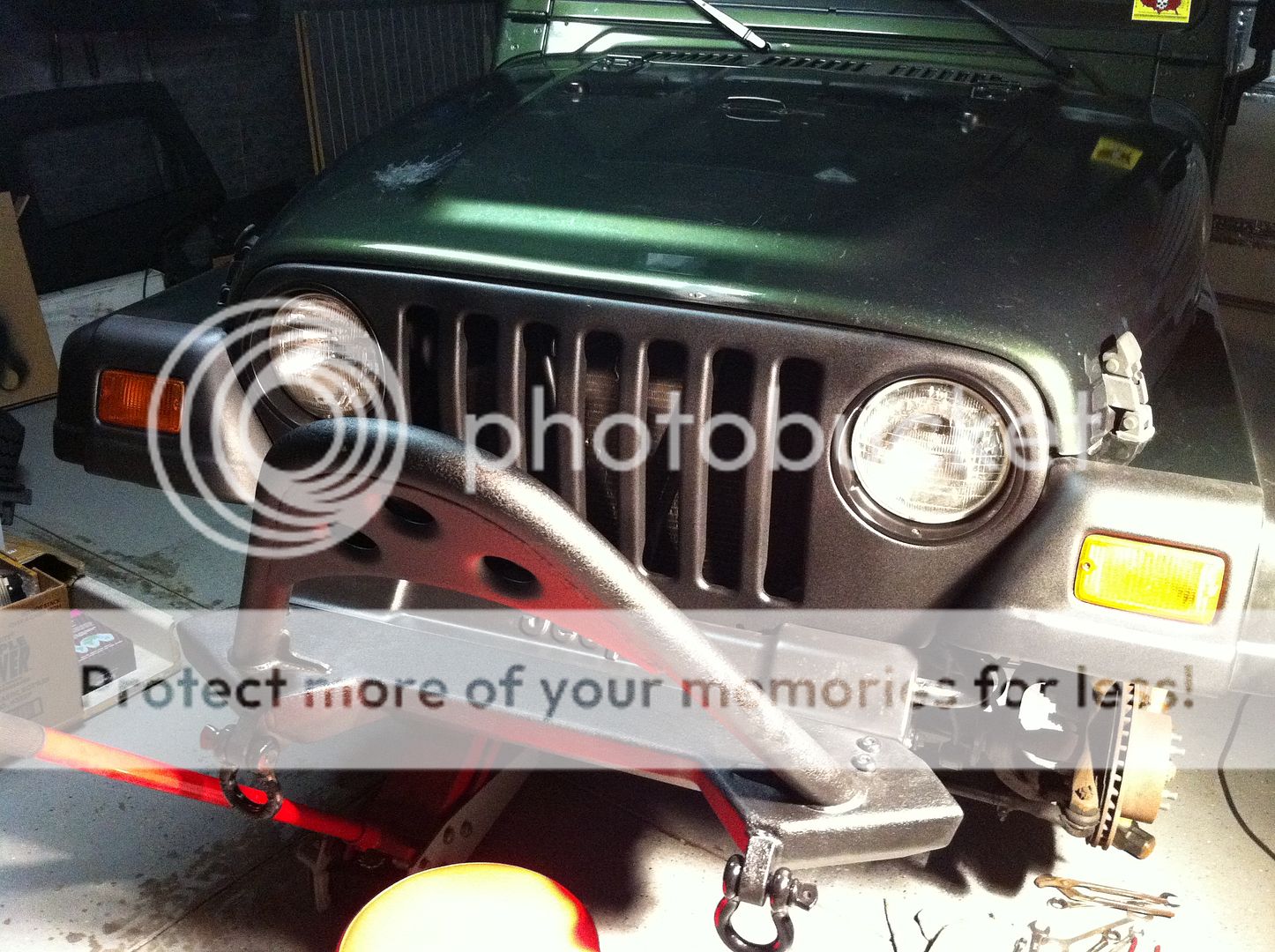

So here was the grill primed (sorry for crap iphone pics)
After first coat of Rust-oleum bed liner spray
Finished product, extremely happy with the out come and have already started on prepping the tailgate and rear corners to be painted with this stuff also.
Next I'll be putting my skills to the test as I plan on painting the rest of the Jeep body silver. As you can see the hood looks terrible and really there are issues all over the body. So a cheap paint job will help clean it up for sure. Also have just purchased all parts needed to redo brake system pads/rotors/calipers/drums etc.... I decided to hold off on the disco's and may opt for the Currie Anti-rock setup instead.

Great build thread!! I'm really wanting to paint my grill. What were your prep steps? did you sand to bare metal or do you just sand it a bit to scuff it up and then paint? Sorry if this has been asked,Im a noobie. Jake
I sanded it by hand and only enough to scuff up the clear coat. Then primed the surface let dry and sprayed on the bed liner.
