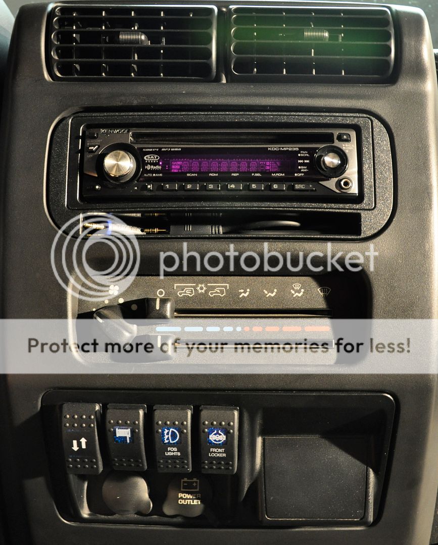

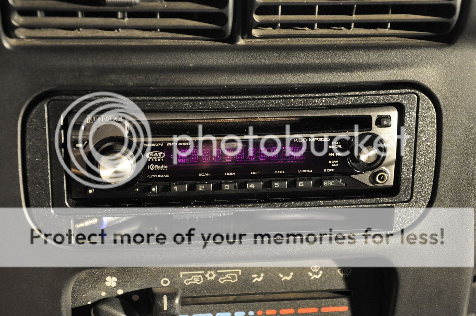

Well I'm up at the crack of dawn this morning and figured I'd mess with the radio situation in the Jeep. I like the stock radio but really want to be able to plug in my Iphone to listen to music. So I picked up a cheap (free) used Kenwood that should fit the bill. Also come to find out I have an amplified Bazooka tube sitting in the corner of the garage so may as well use it since I don't have the center console sub. Hoping the radio mounting kit comes today along with the locker, seal and riddler diff cover through UPS. It's going to be a busy Jeep weekend in the garage. I'll get some pictures up of the progress

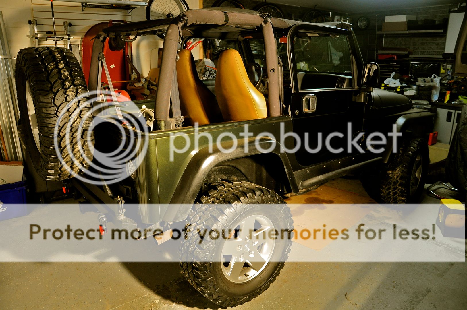

Well not a huge success of a weekend working on the jeep, but managed to get a few small things done. Radio installed, sounds great and more important I can plug the iphone into it.

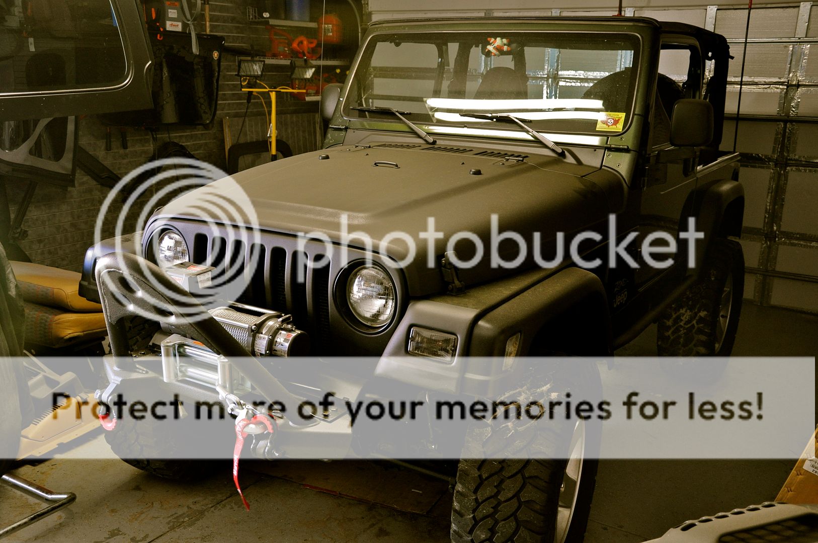

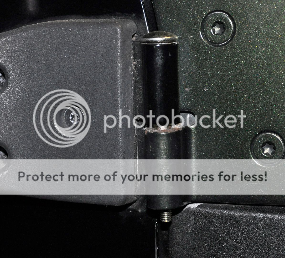

So I got my new door pins and put the full doors on and have some issues. They have these gaps so ordered the delrin plastic inserts. Hoping that is going to straighten them up because at the moment I have to pickup on one door and push down on the other.

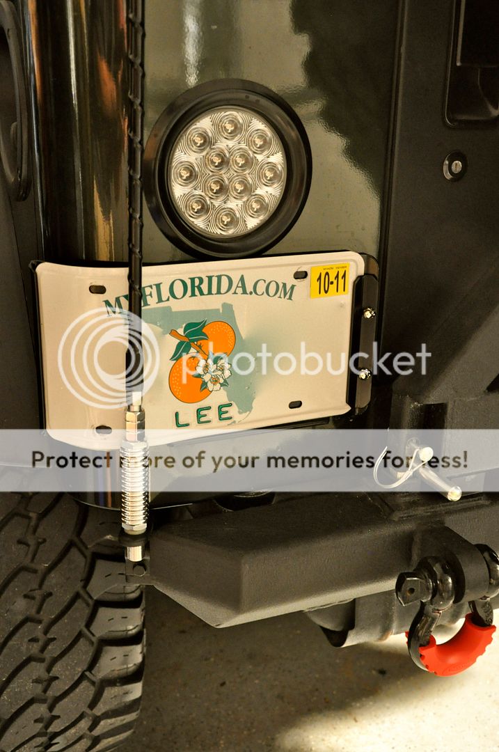

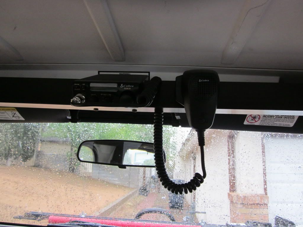

Also finalized my CB antenna mount and hope it works out ok because it looks great. Still working out how to mount the Radio overhead, thinking smittybilt gear overhead console.

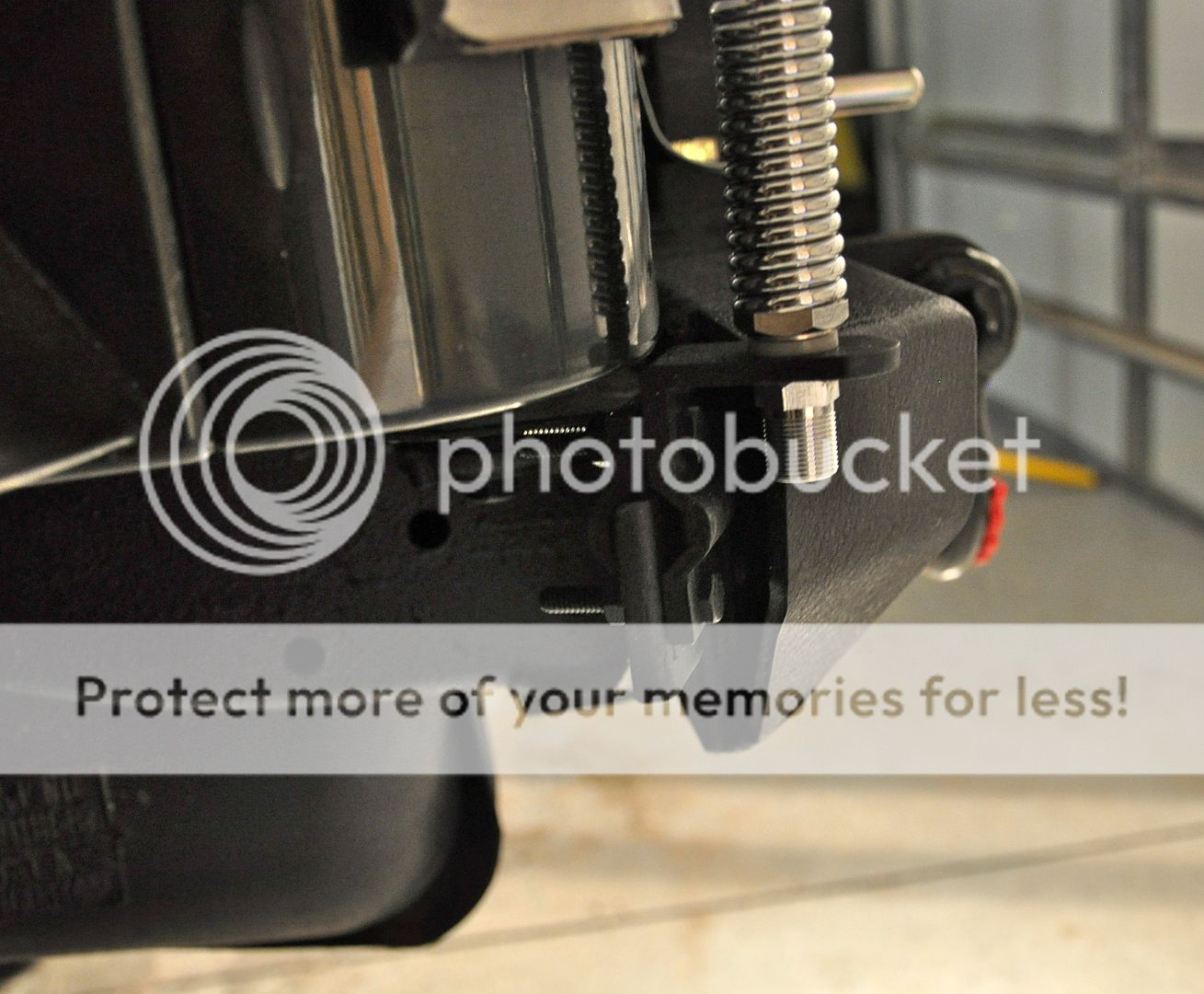

Also figured out I could flip the spare tire mount and drill out the threaded holes so the mount isn't so high. Looks much better and allows me to see what's behind me in the rearview some what.
Also added some red accents as I plan on the jeep being completely painted with the bed liner and having a few red pieces here and there. Maybe some new wheels

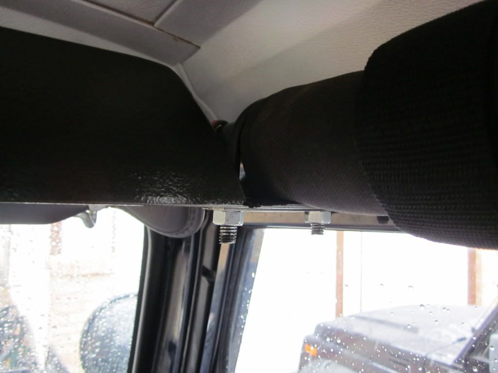

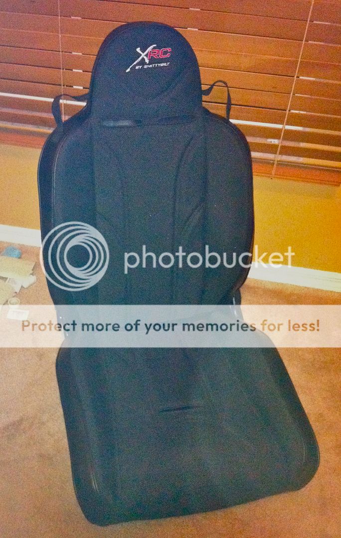

Also ordered Smittybilt seat adapters, crossing my fingers they have worked out the issues with them. Have rear smittybilt 3" fenders coming, and plan on ordering the front flats with 3" flare.

Looks way nice with the spare tire lower now!

Sarah, I have to agree looks much better/normal

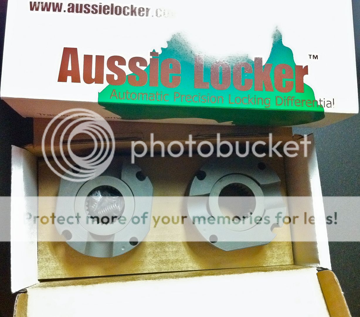

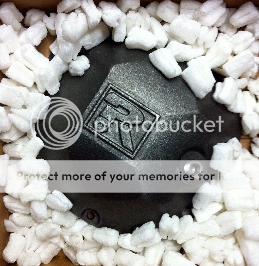

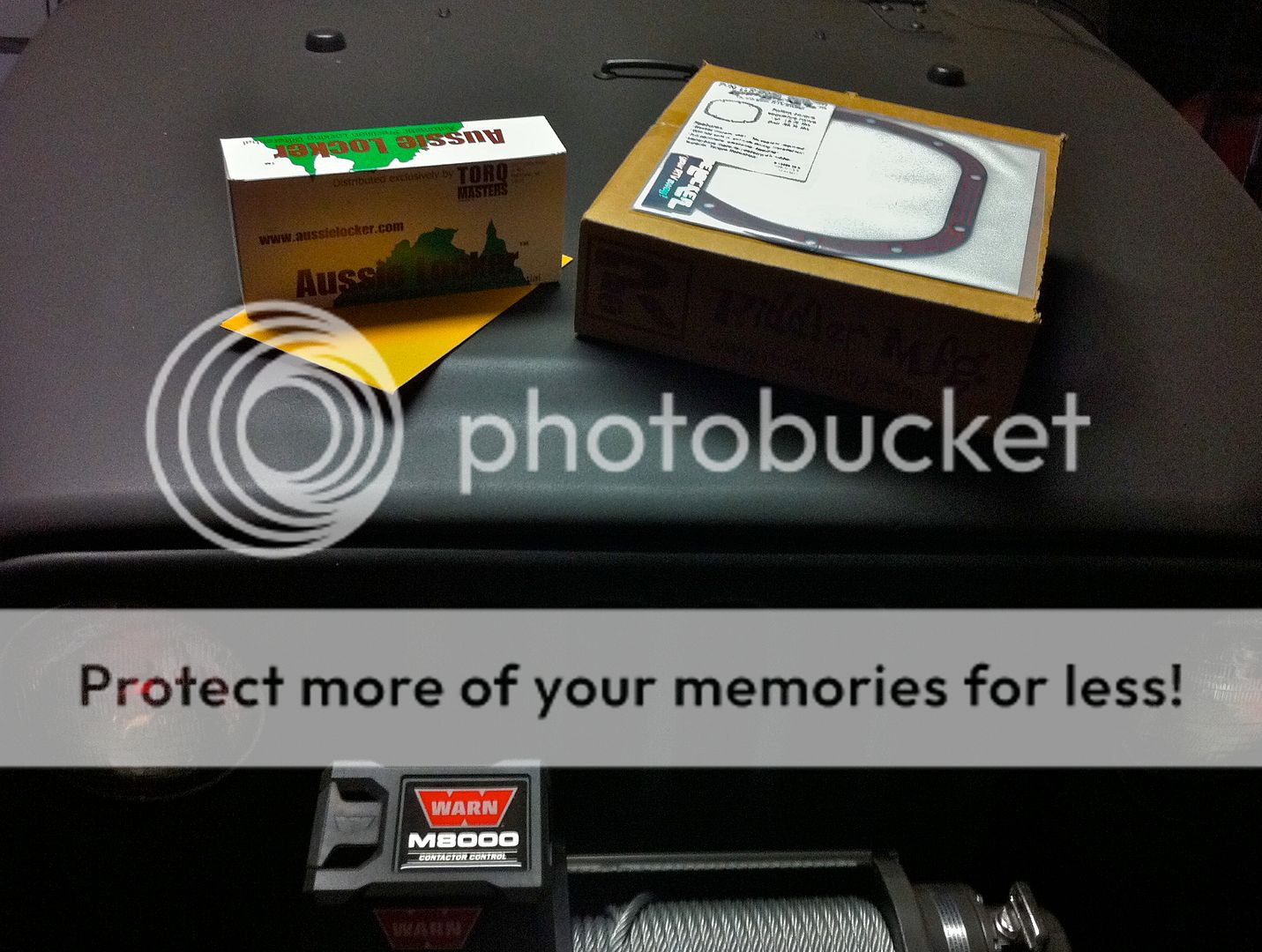

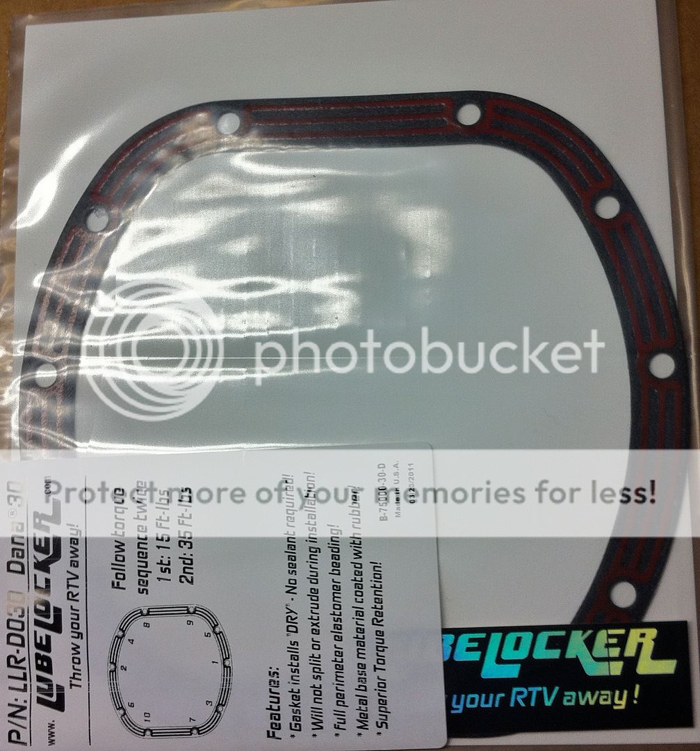

Back on course, so I had a package at the door today and it was filled with some goodies for the front diff.
Not sure How I want to paint this yet.
seats I have waiting on adapters coming.
Sad really how many parts I have around the house to go on the jeep, but alittle here alittle there. I did figure out the hard doors and now they close and open nicely no binding or rubbing.
