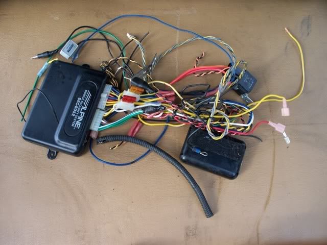

So far I've fixed one of the two tail lights. I need to do the other one and make sure both are reliable though, so I've got the Dremel and a wire brush ready and I'm going to get bigger screws because the mounting holes are stripped.
Yesterday I removed the Alpine alarm system. I don't think it worked anyway, and it was just a lot of wires and taken up space. Here's a picture of the rat's nest that came out of it

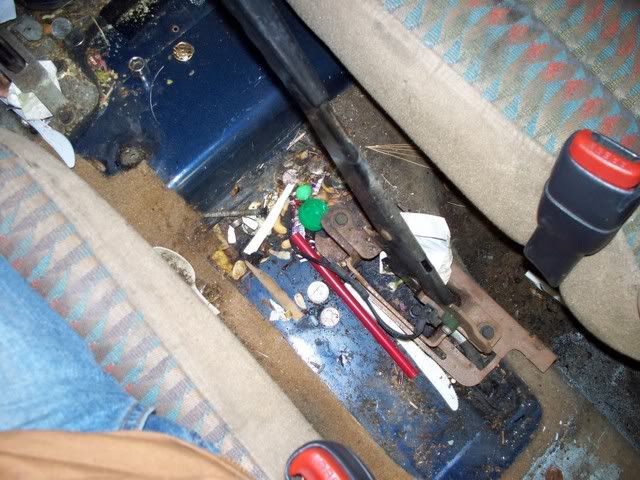

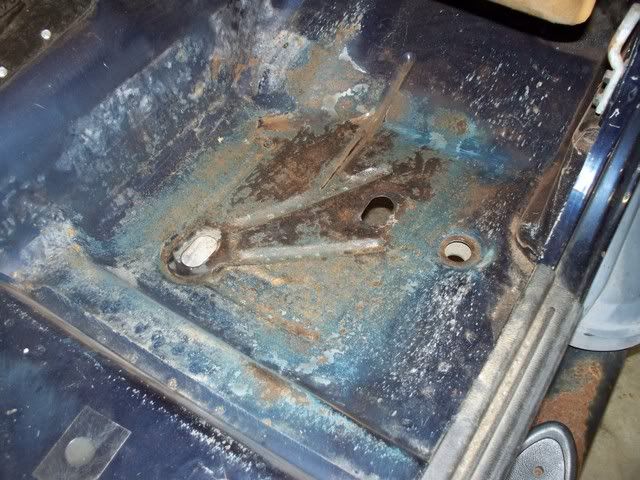

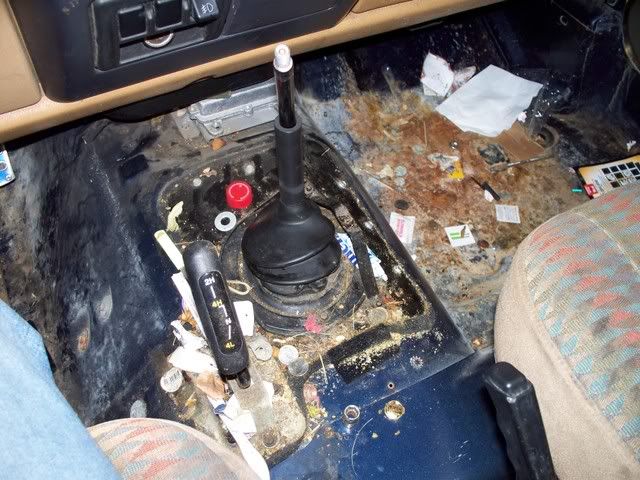

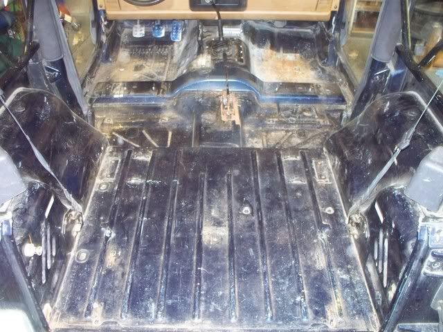

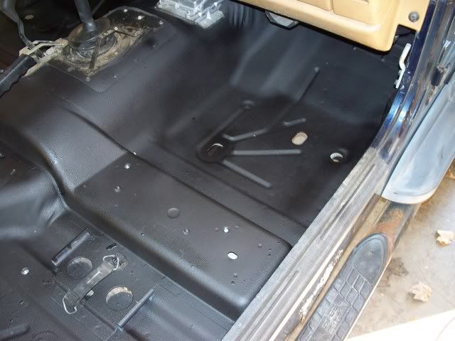

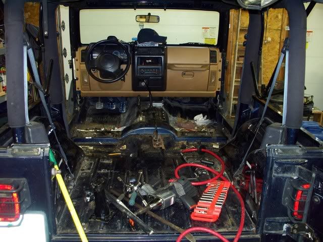

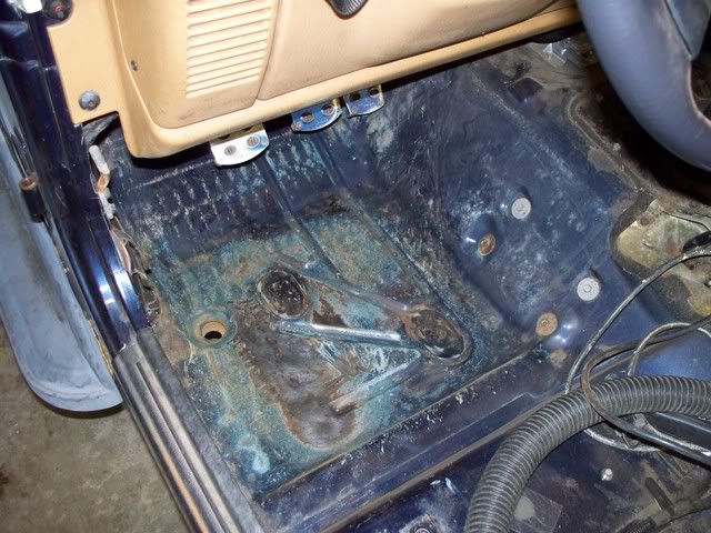

Rubberized the interior today. Made a world of difference. Here are the before and afters.
Before:
This thing was so nasty underneath the console and in general.
After it was swept, but before rubberizer:
After:
Total cost:
About $33 for 4 cans of 3M Rubberized Undercoating and 1 roll of painters tape.

Please let us all know how that 3M stuff works, how did you prep the surface and is it staying on well?
How does it compare to Herculiner and Duplicolor?
2008 Sahara Auto 2 Door 20,450 miles JKUR Coils and shocks, Magnaflow, Superchip, Banks CAI, Winch, OBA and 4:88's
Jon08JK is offline   Reply With Quote
Old 10-21-2008, 09:43 AM   #27
joet7287
Location: Conway, NH
Posts: 105
I have a friend who rubberized his interior a while back, it's working out great. Conveniently I have another friend who Herculined his interior and he wishes he had used the rubberizer instead.
To prep I removed all of the rust, I spent a few hours with a corded drill with a wire wheel insert as well as an angle grinder. After that I wiped everything down with a damp cloth and then with a dry cloth to make sure there was nothing on the surface. After that I sprayed away. The rubberizer will stick to pretty much any surface.
Cheaper and better. I like that.
