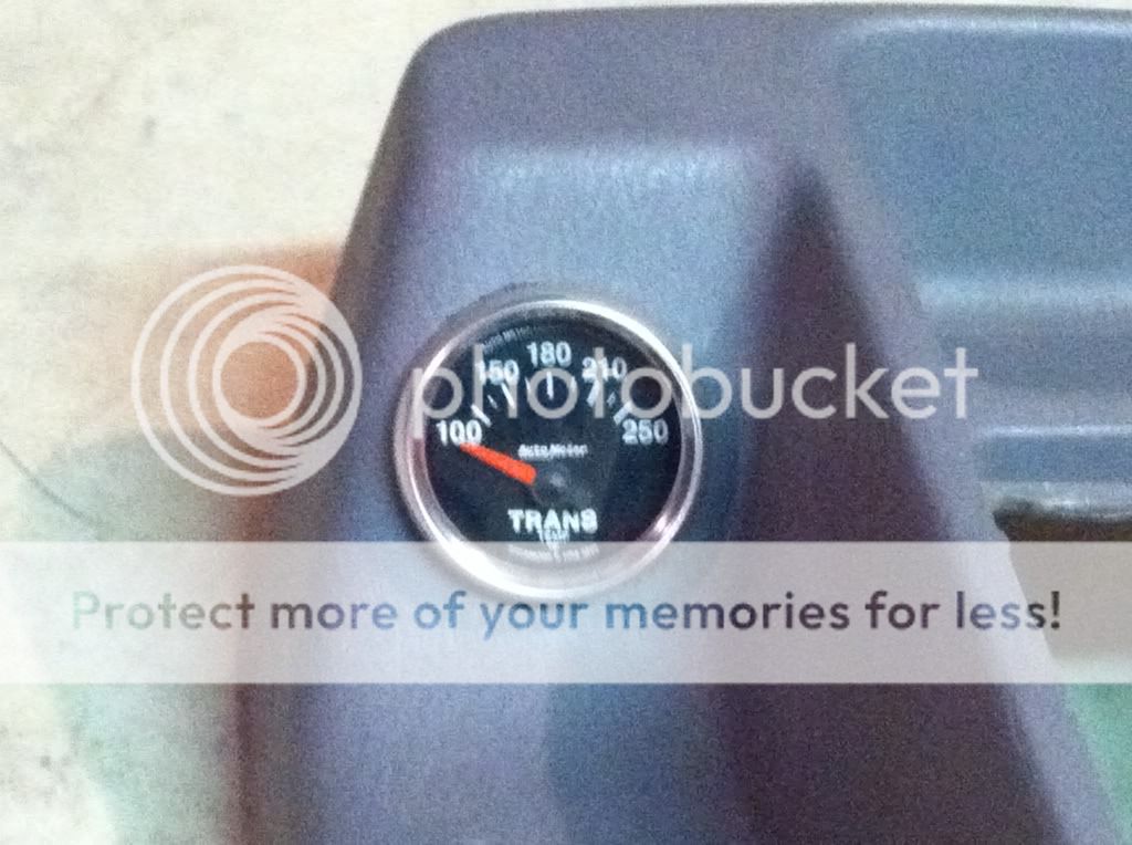

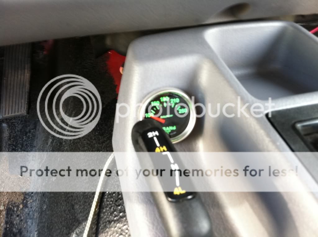

made a hole and mounted my Auto Meter trans temp gauge in the center console:
lit up:
I will try to get it wired up and the sensor installed in the trans line tomorrow

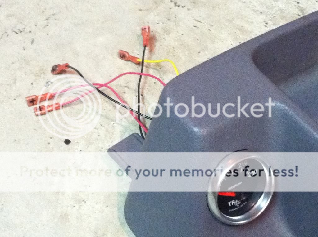

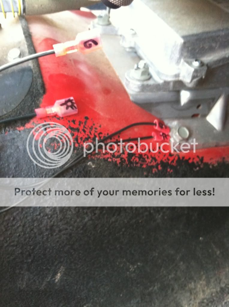

I made little wiring pigtails from the gauge to a couple inches out of the console so that I can easily unplug them incase I need to remove the console out. This will be much easier than trying to reach around underneath the console while its in the jeep. I took the idea from another write up I saw. I also marked the disconnects with a sharpie to tell which wire is which.

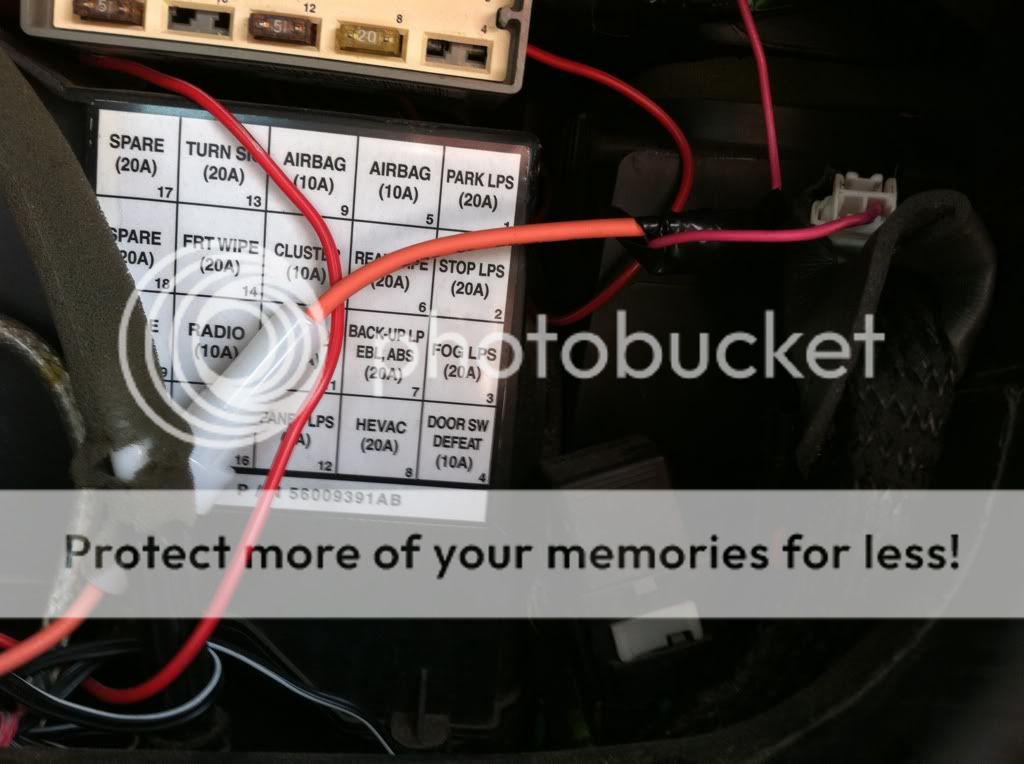

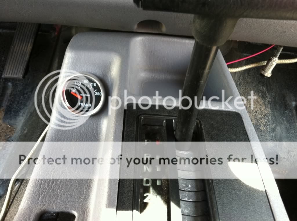

Today I ran all the wires except for the temp sensor because I need to get a couple more brass compression fittings to install that in the line.
I connected the light power to the light wiring that lights up the shifter so it dims with it also:
the 2 grounds are just grounded to a bolt right in front of the center console under the dash:
The power to the gauge is tapped into a a wire that is only hot when the ignition is turned to ON:
Center console back in:
