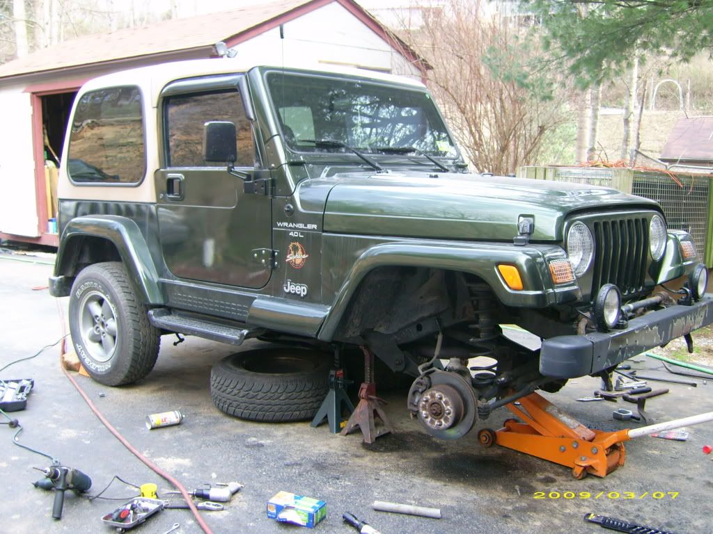

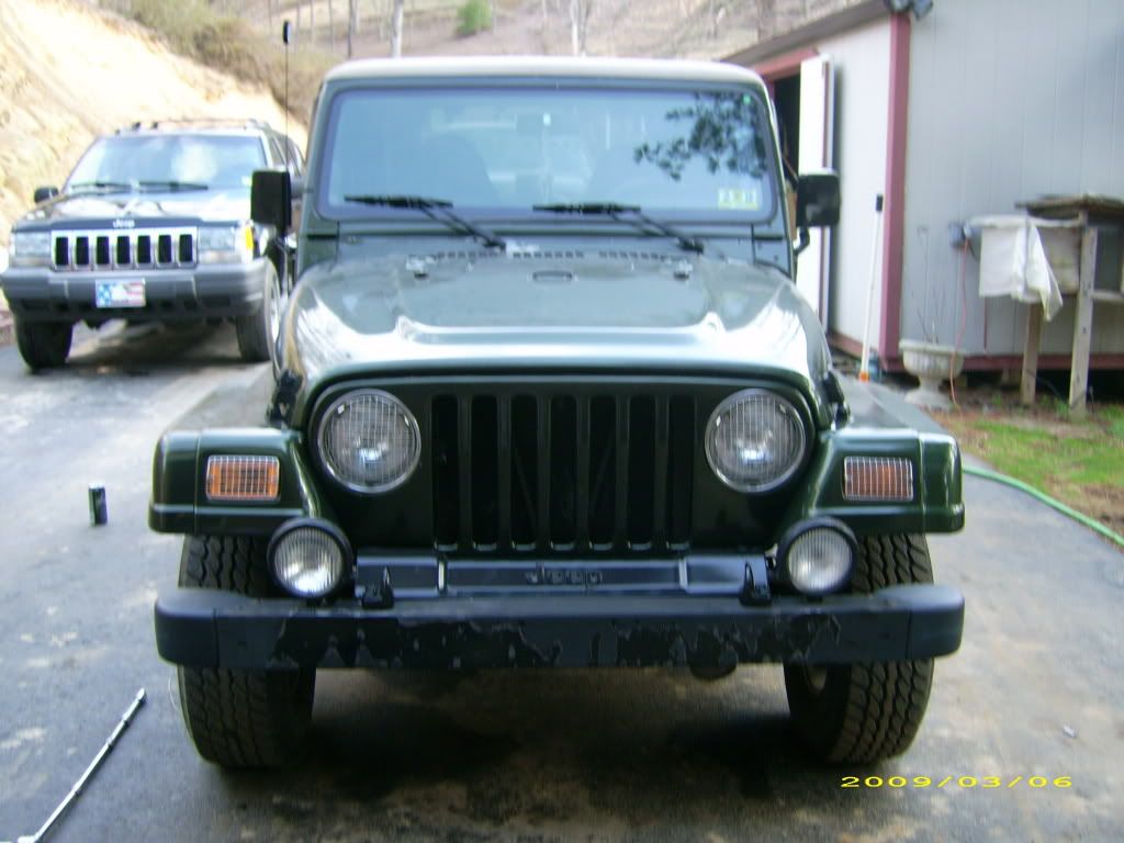

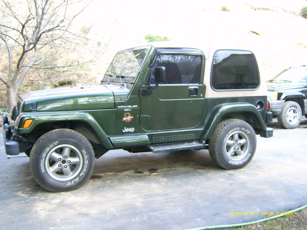

I just started my first automotive build of any kind. It is a 1997 Sahara edition TJ. It was purchased new in 97 by my ole' ladies father to be used as a work vehicle (transportation too and from the mines). He gave the jeep to her when she was 15 and it was her DD for ~ 9 years. I just recently purchased a new car for her to drive: so we had this Jeep sitting around in good shape. The Jeep has ~ 92,000 miles, but has been well maintained. It has always been well cared for, and only seen Mopar oil and filters. The only time it has spent off-road is here recently; since it is no longer a DD.
Here are some pics of what I am starting with.

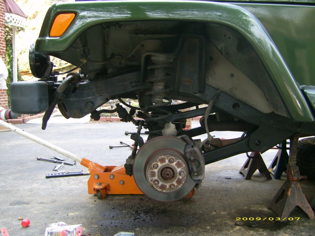

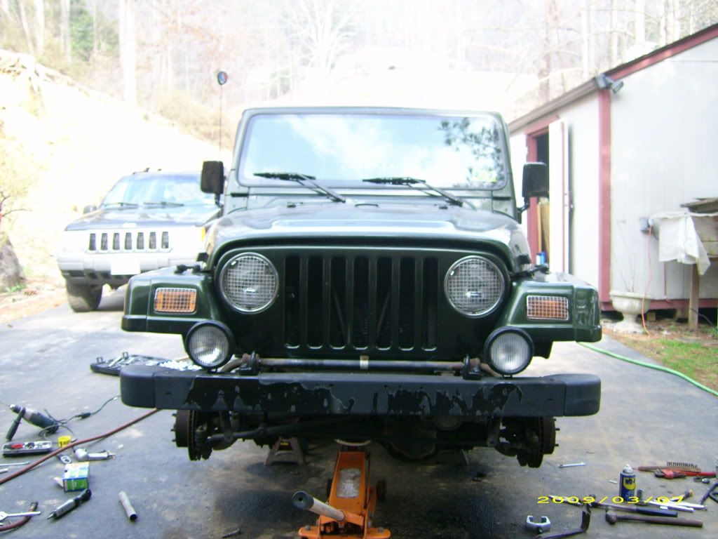

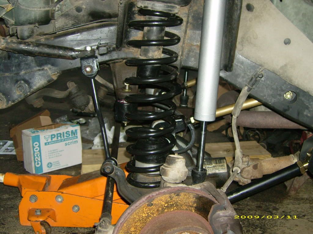

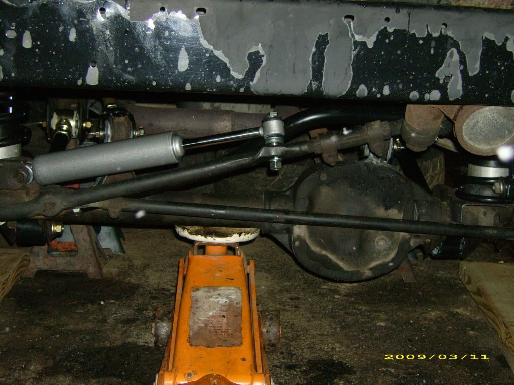

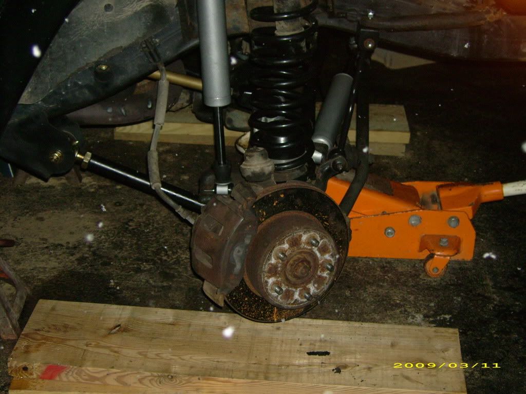

The first day I got a fair amount accomplished. The Jeep wasn't near as rusty as what I had expected, but the old hardware was still somewhat a pain to remove. Had to cut the nut off the tops of the shocks, but everything else came off "OK".
I had to cut the bolt too the drivers side UCA also.
I managed to get the shocks out, sway bar links (front and rear) and front track bar out by about mid-day.
Here are some pics of the progress.

I got the old control arms out and the new in. Installed the new springs, bumps, and shocks. I have my front end back together except of the swaybar links. I should about be ready to torque everything down, tire up, and get a rough align. I will get some more pics tonight or tomorrow.

Got snowed out this evening!
Front end is together, just have to button it up.

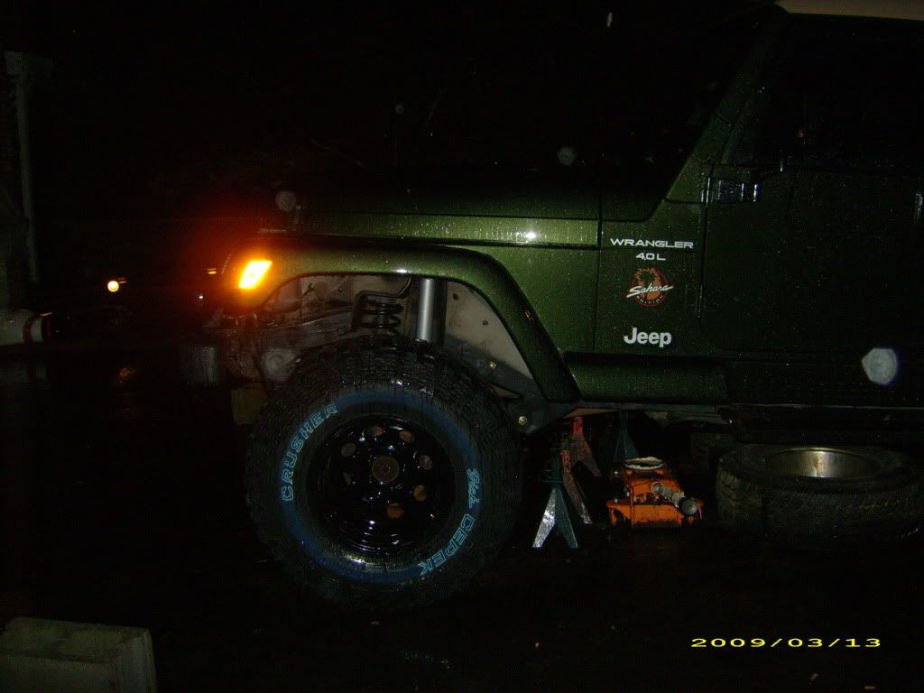

Posts: 230

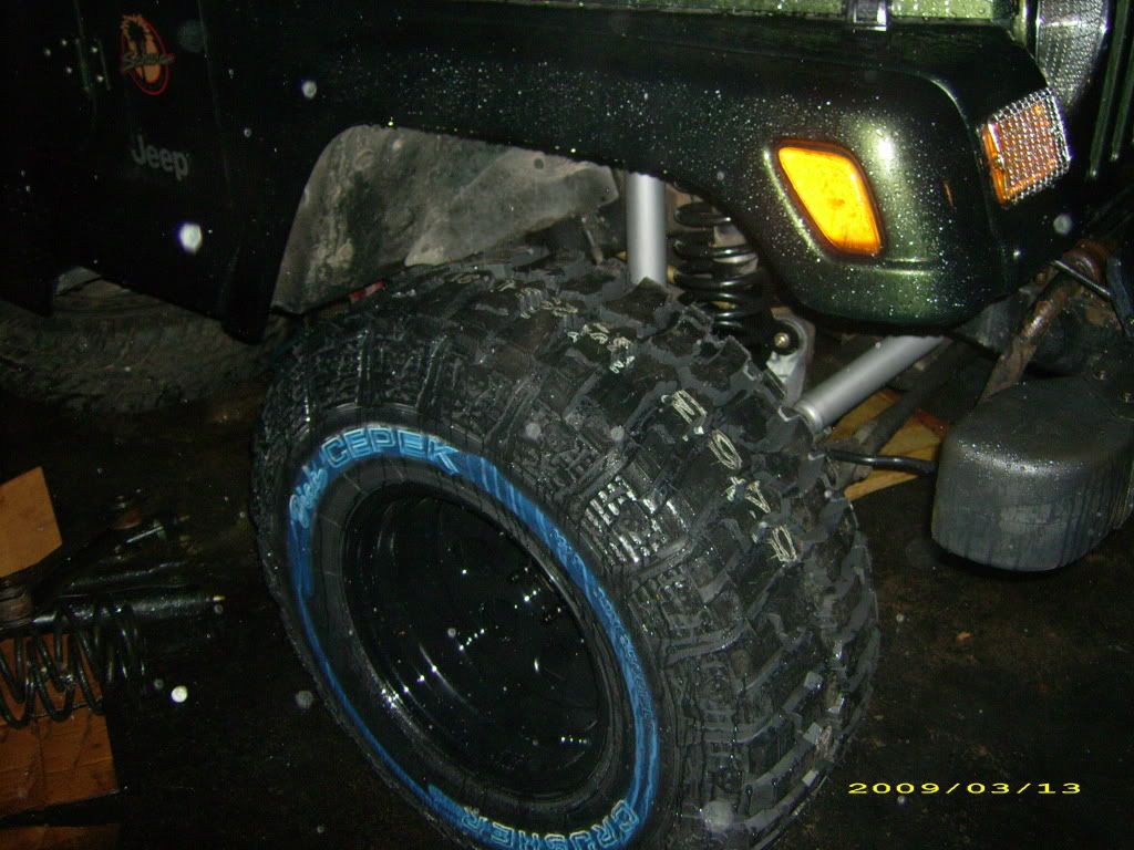

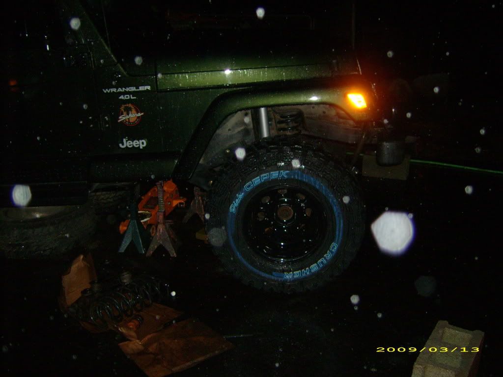

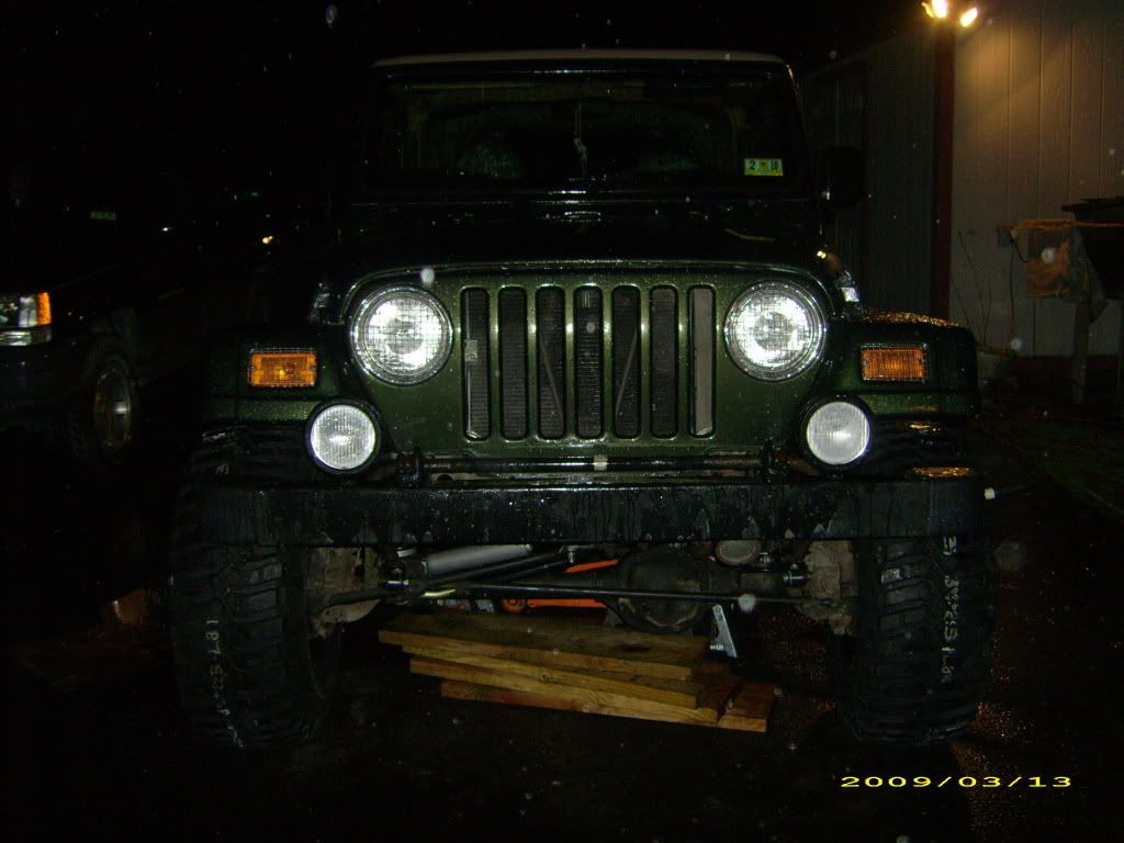

Spent all evening after work in the rain
Got my axle back under center, and tightened everything but the top sway bar link bolts.
The Jeep now looks like it is trying to do a wheel stand
Tomorrow I will set the Toe and re-center the steering wheel; then start on the back.
