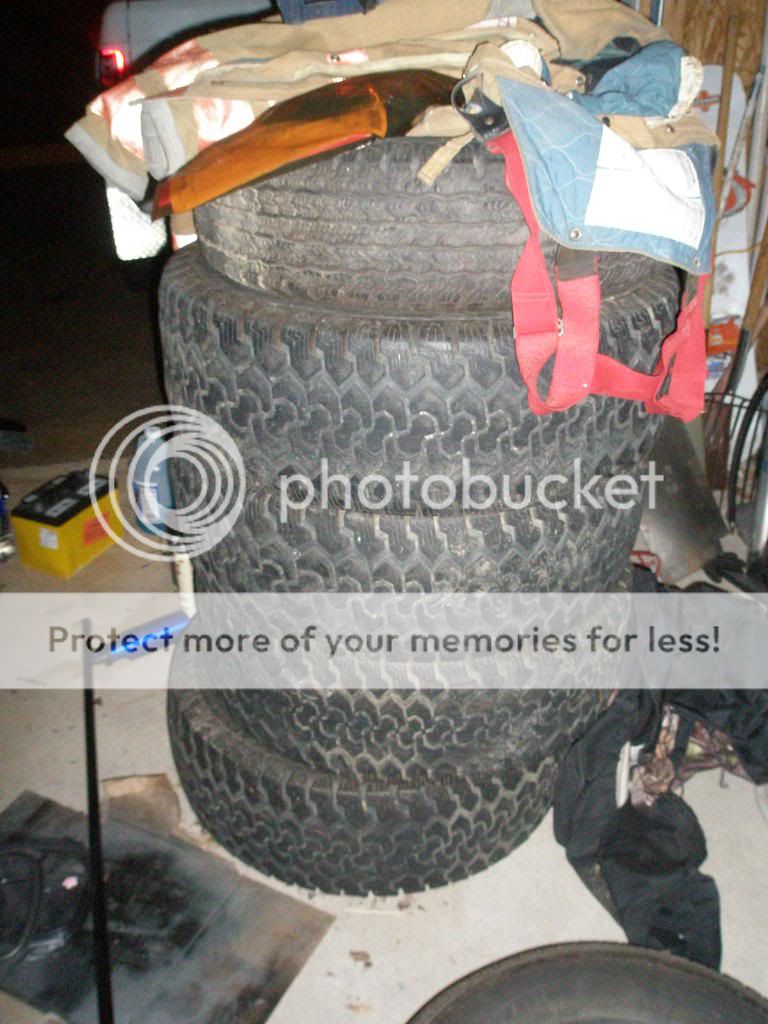

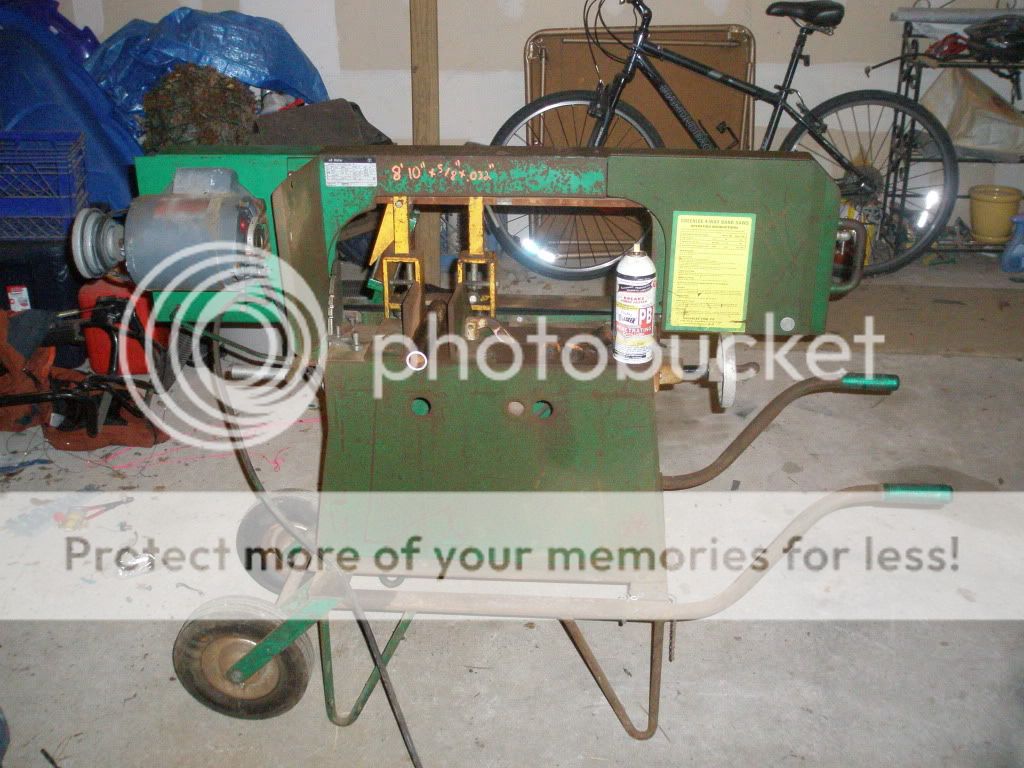

Well i haven't up dated me build thed for some time now so hear is whats new. I made a set of rock sliders, got a band-saw, got a set of 33" tires that will be going on soon, and just started a brush bar that i plan on tying in to tube fenders.

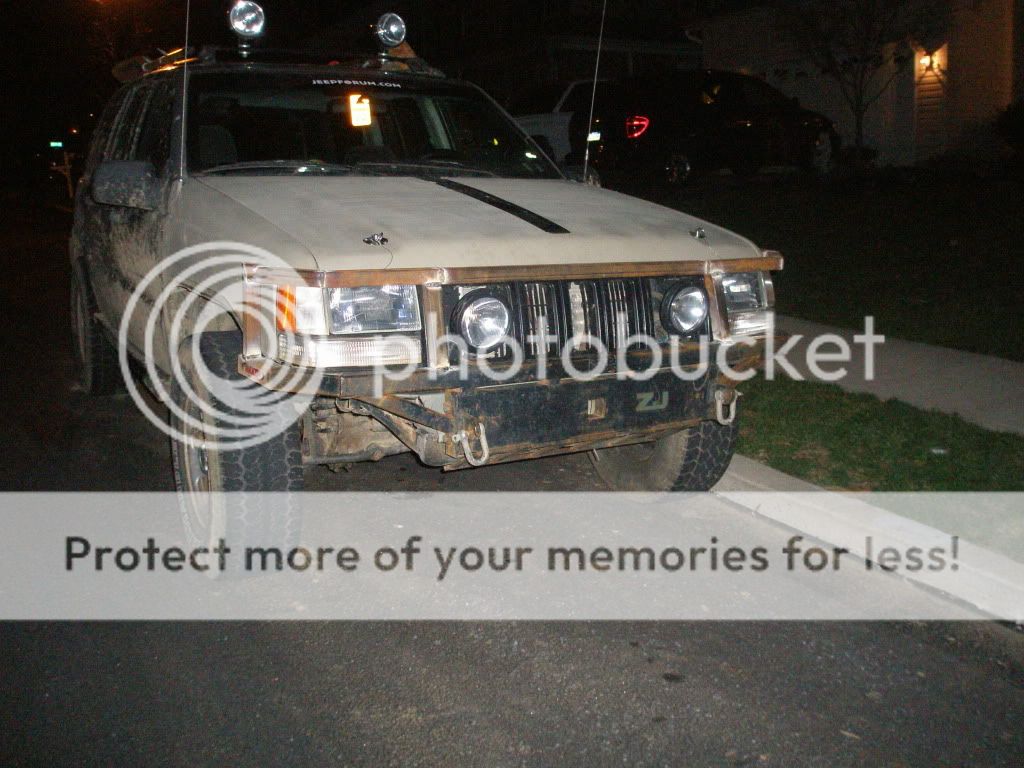

Today I some more progress on the front end. I think it is looking good what do you guys think.
