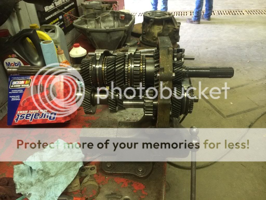

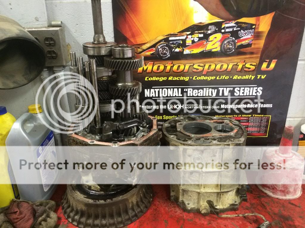

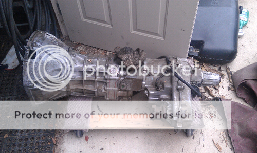

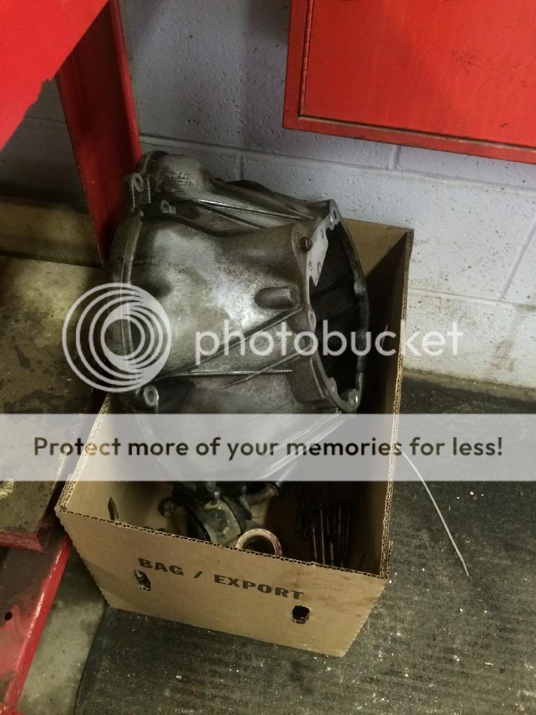

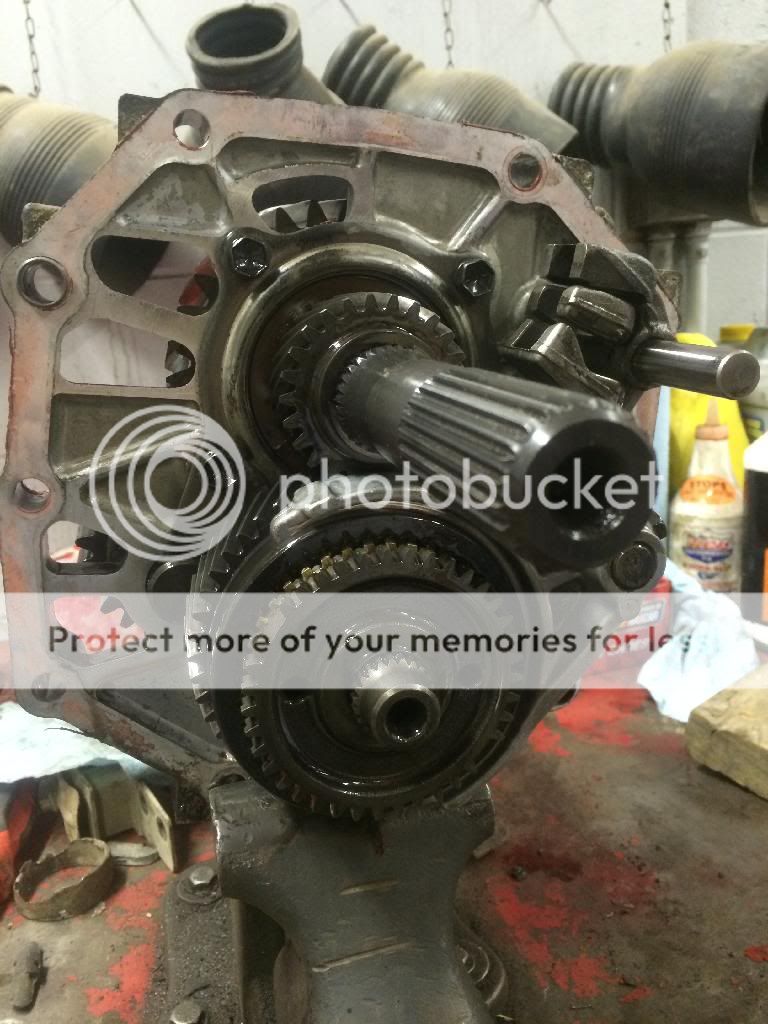

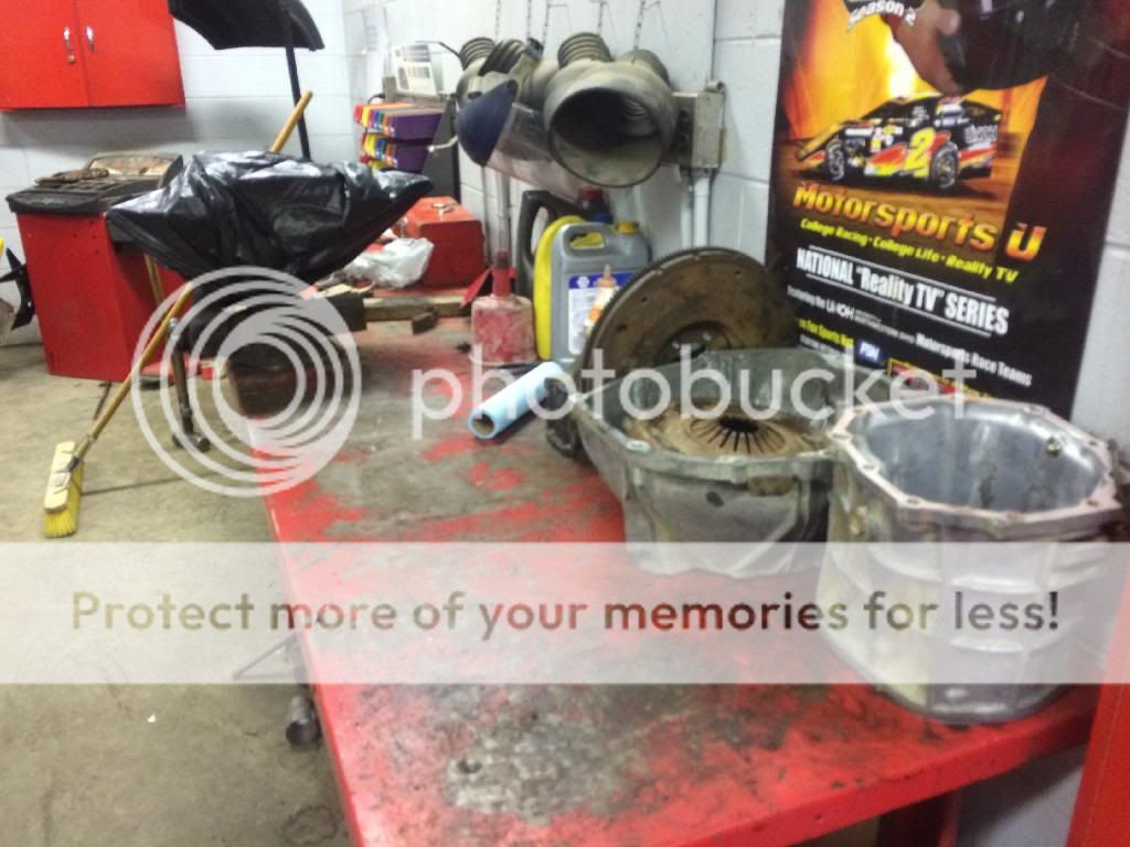

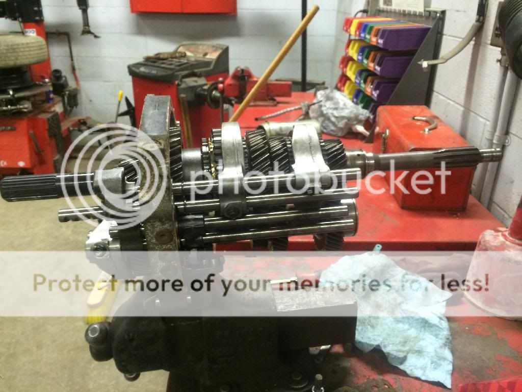

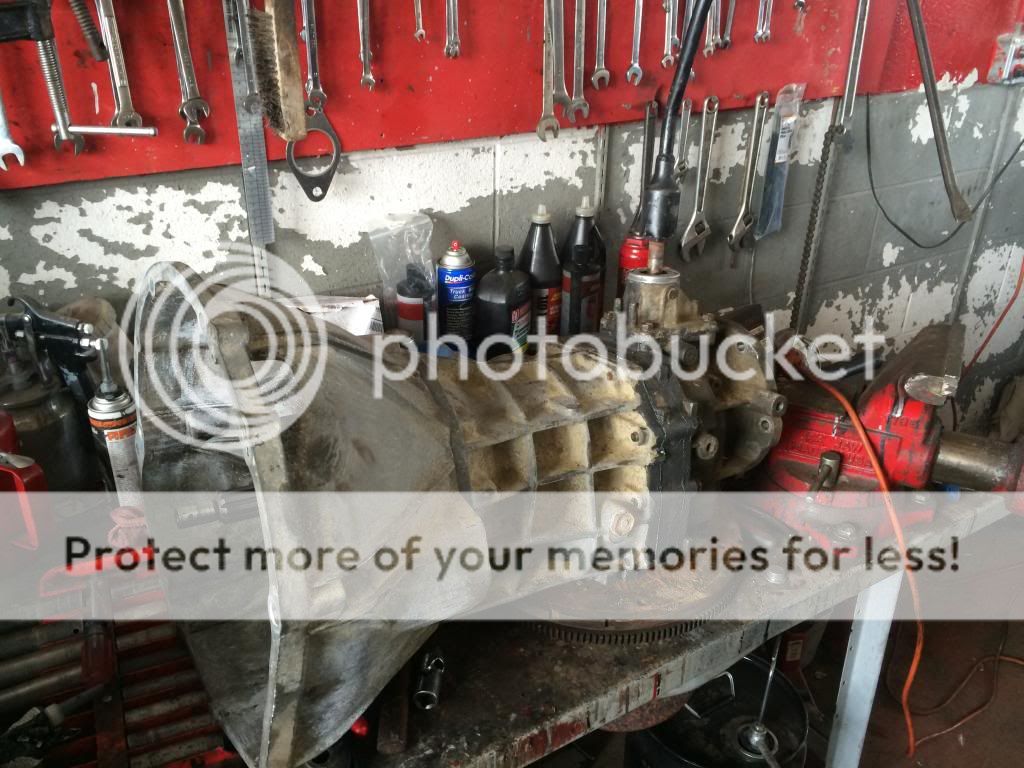

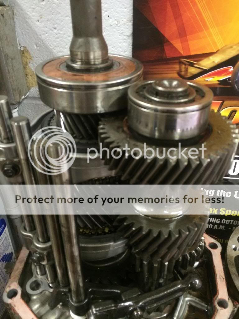

Parked it for over a month, was actually debating on selling it... Yeah, it came to that... Then i slapped myself around a little bit and came to the realization that i cant sell my baby. Figured working on it would cheer me up. Needed to address the tranny issue. All gears were a struggle to get into since december 2013. Spent about a month searching for a good deal on an ax-15. Finally found one. It needed "rebuilt" but i figured so did mine, so id rather have this one thats already out and take my time rebuilding it so everything was right. Took the drain plug out, and i wasnt suprised when i found metal particles in the oil. Tore off the bellhousing, and the front case. Inspected everything. Wait a second? All these gears are in great shape? What could it be? Further inspection showed that it was the input shaft bearing. Sweet! 80$ bearing and some fluid, and ive got myself a damn near new teanny to put in. False. Bearing came in the mail, wrong bearing... Got one for an ax-5. Quick phone call, and the correct bearing was overnighted to me. Then became the next issue. The new ax-15 came from a cherokee. This means the rear case where the transfer case bolted needed to be swapped with the rear case from my yj's ax-15. Ill be doing this tomorrow, so wish me luck. Heres some pic from the process. I definitley recomend that if you need your trans rebuilt, to so it yourself. This thing was a cake walk so far( probably just jynx'd myself )
Where it began:
Next the bellhousing is off:
Now the front case:
Close up of the gears:
Rear case removed:

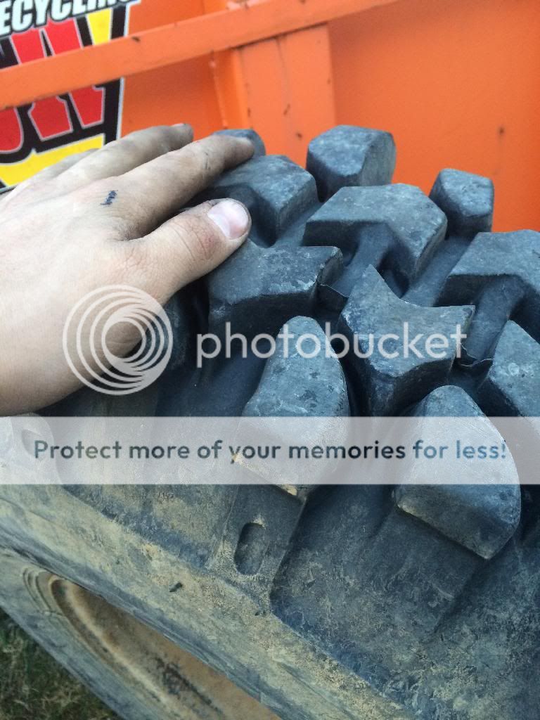

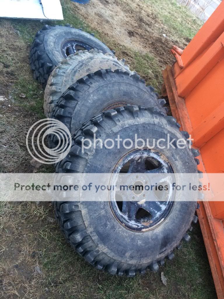

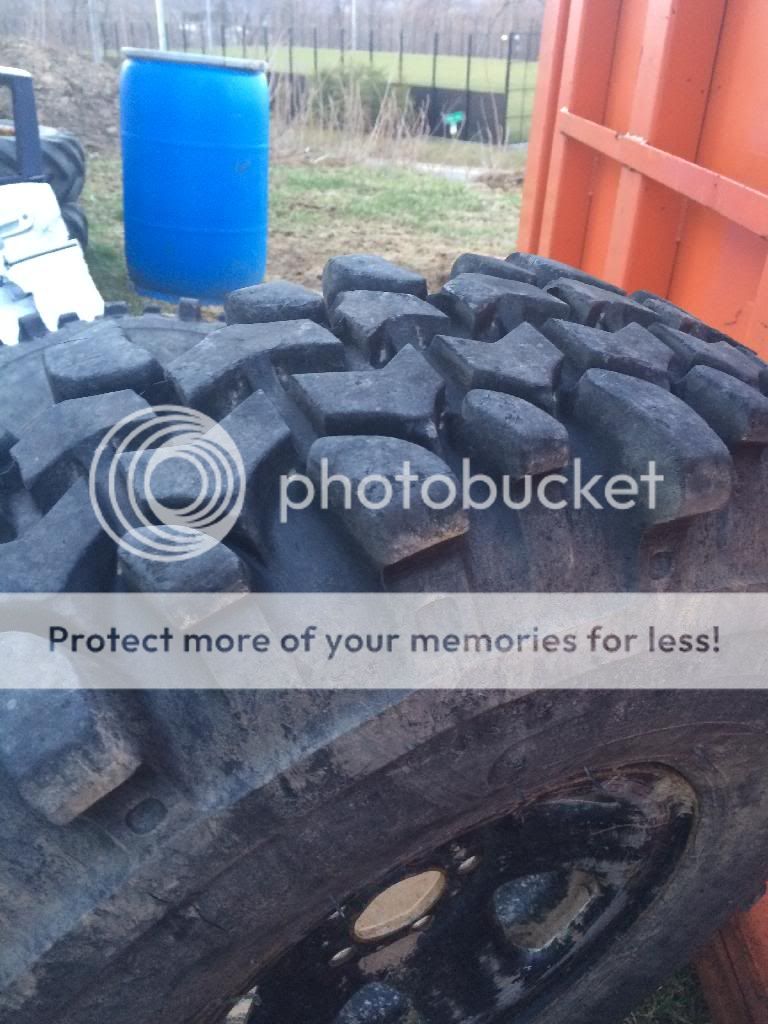

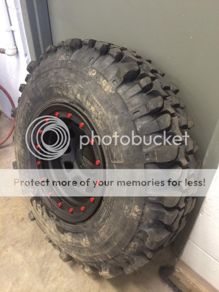

About 2 weeks ago, i got 4 almost new and 3 over half tread 34x10.50x15 super swampers on a set of bent up stock steel wheels. Searched and searched for a set of used steel wheels with 3.75 bs like my others. Guy in my local jeep club (jeepinwv.com) had a set of 5, identical to my other wheels. Those will be great once i get them mounted up.
Pretty nice tires for the low price of FREE, dontcha think??

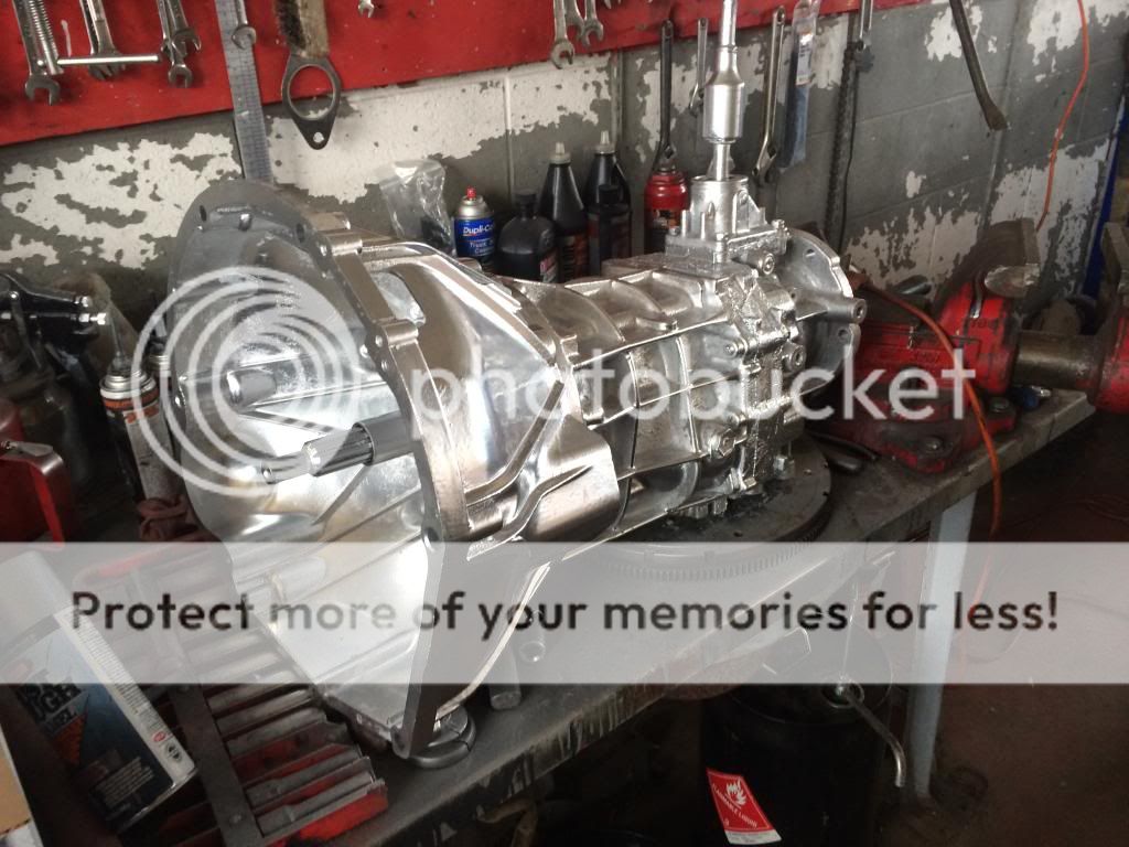

Alright guys. Been driving it quite a bit. Transmission is put back together, cleaned up, painted, reinstalled, new u-joints in the front shaft, swampers got mounted on the new wheels, and thrown on the jeep.

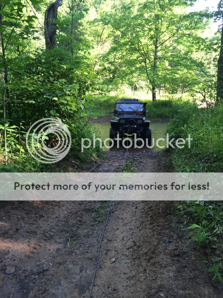

Wheeled it a little today. Got stuck on a log in an old creek bed and had to use the winch for an easy self recovery
