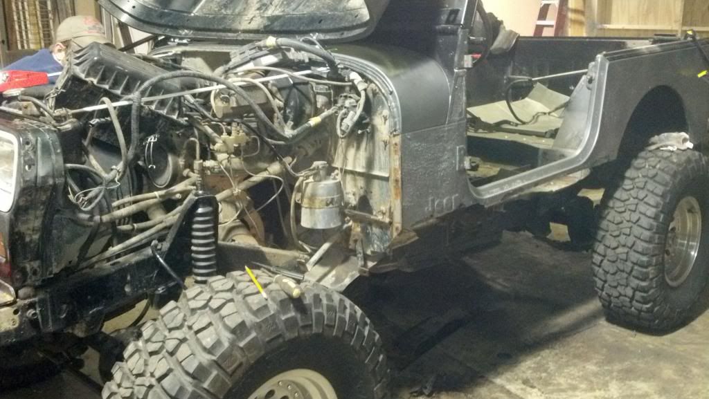

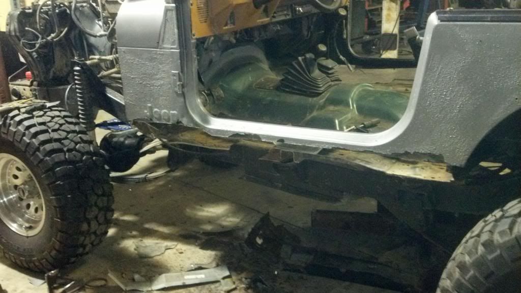

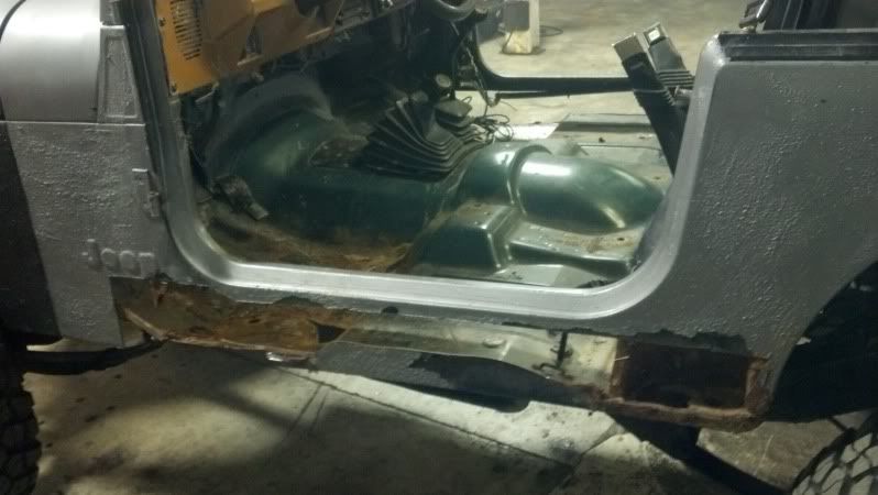

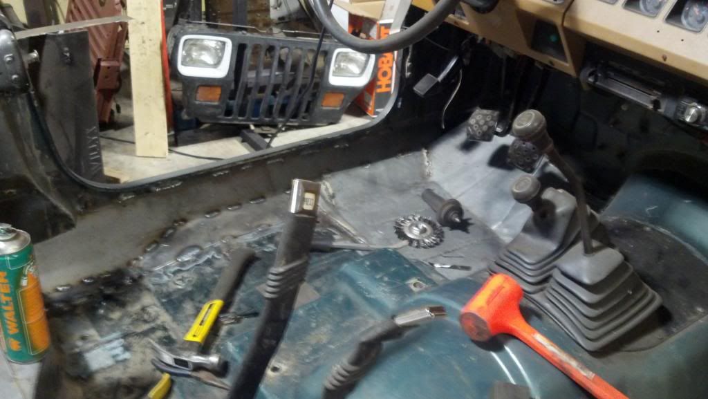

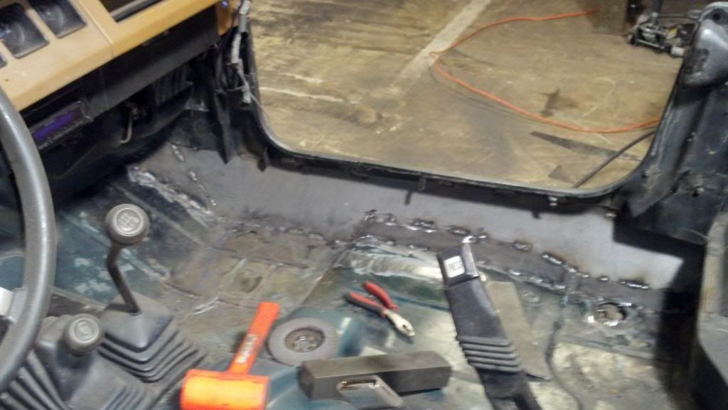

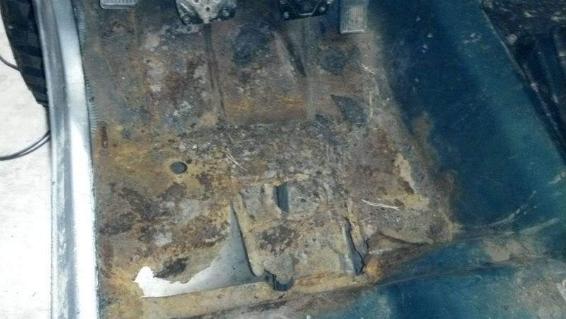

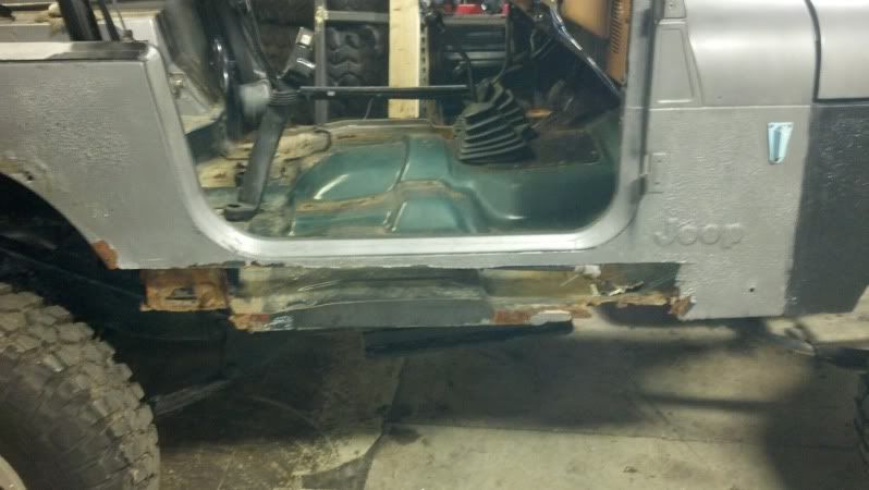

I started this build last week of Feb,Specs on the rig as it sat when I got it.95 YJ 4 angry squirrels,33 inch KM2's and a healthy does of rust on the tub,frame is in great shape.
Got it all torn down tonight,need to get the floors welded up and start on the boatsides

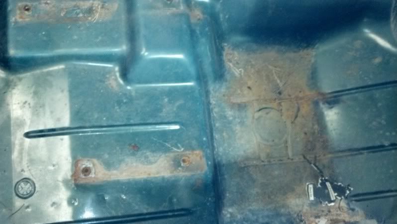

passenger floor
drivers floor

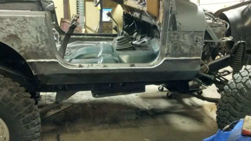

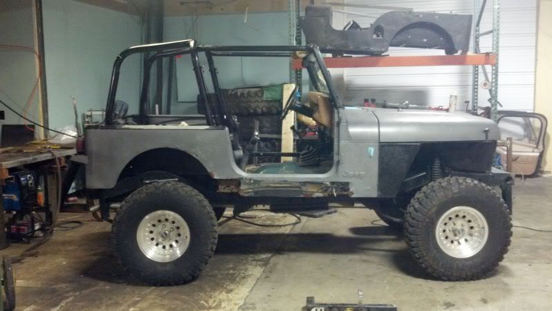

all prepped for the boatsides
Machinist is offline

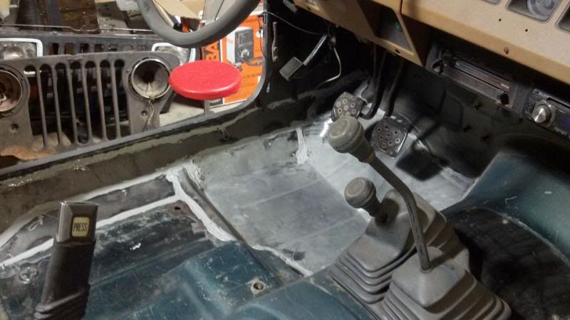

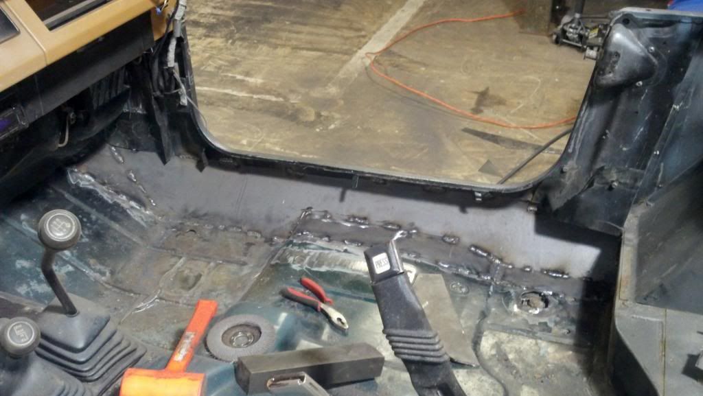

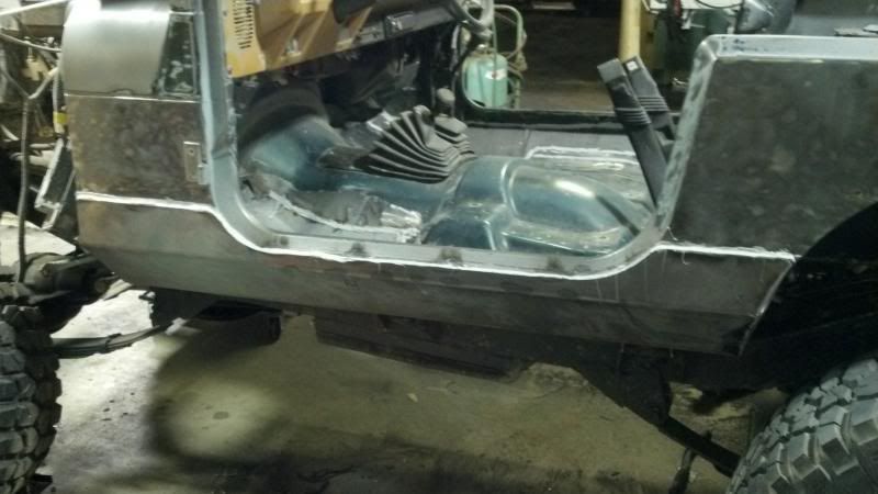

New floors,All welded in except for the seat belt mounts.
post #4 of 48 Old 04-03-2013, 08:00 PM Thread Starter
Machinist
Location: Fulton,NY
Posts: 696

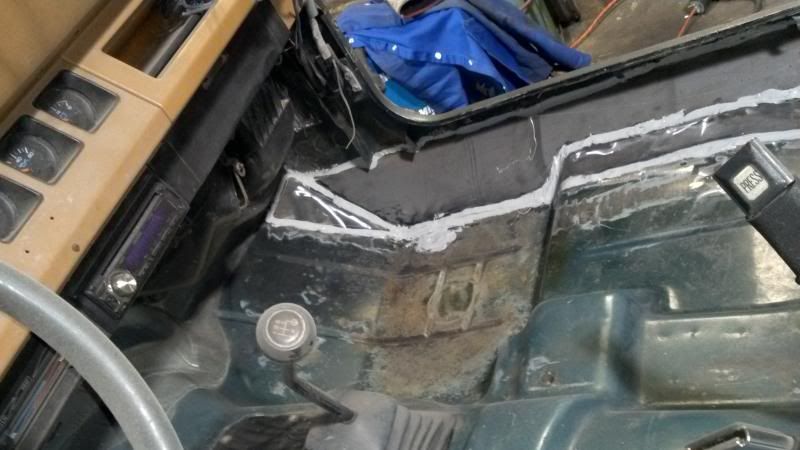

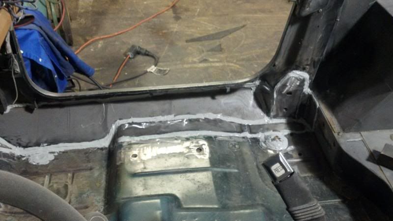

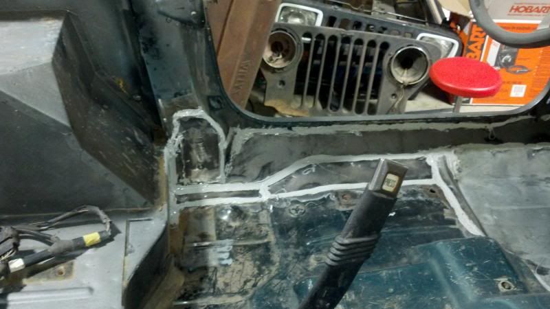

Floors and boatsides are completely done and seam sealed in.

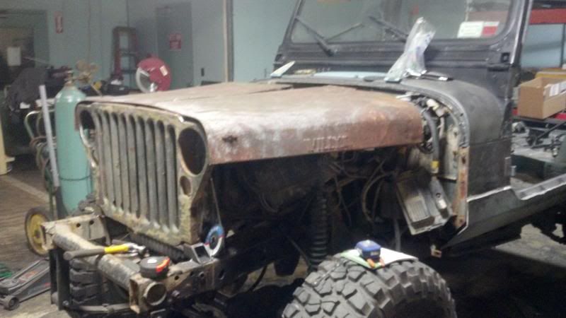

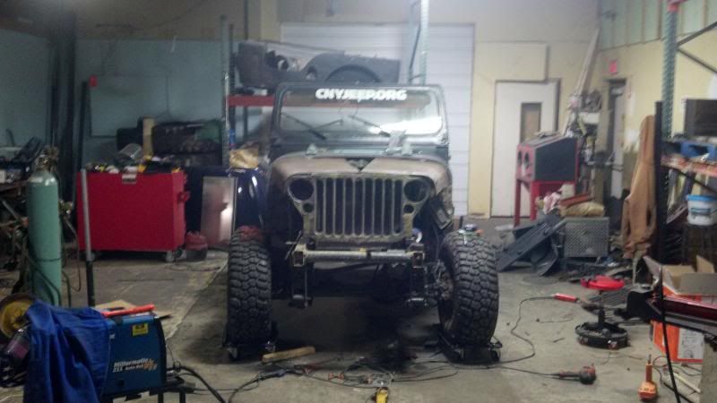

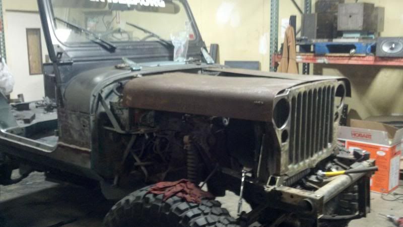

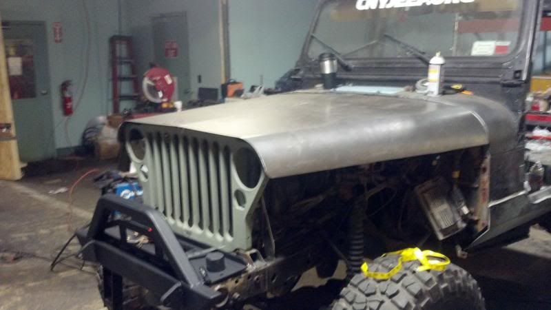

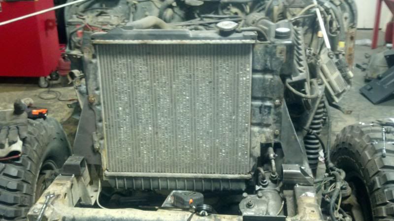

I had to do a stand alone radiator support for the next step
MB grill!!! I will be making a hood that is basically a longer Willys hood to finish it off.

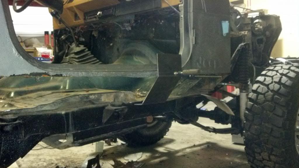

Got the right crusher all mounted

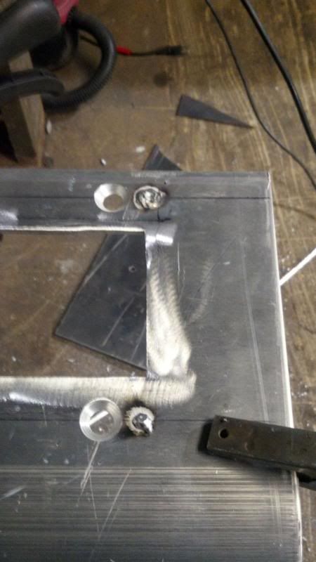

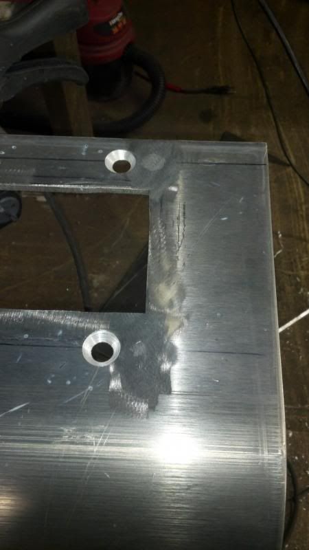

I drilled and cut the left crusher corner and screwed up on 2 holes.I used my spool gun for the first time and welded them up
all fixed

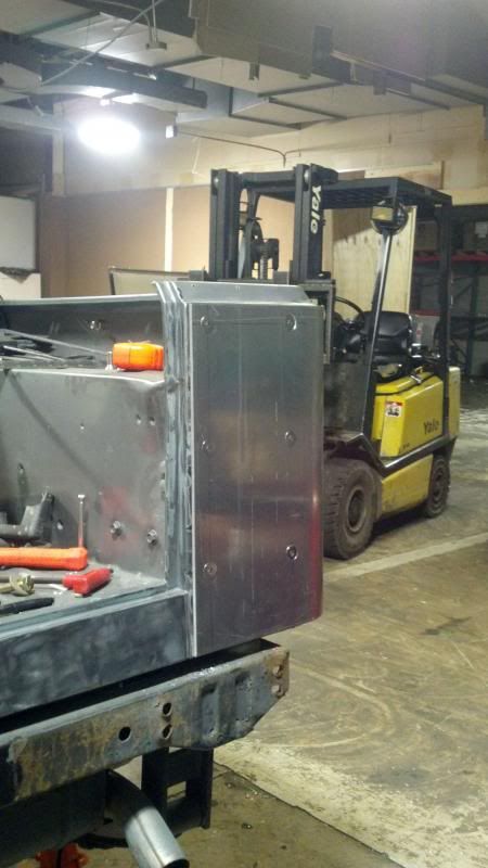

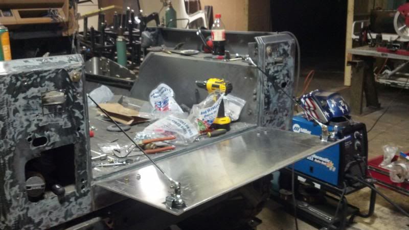

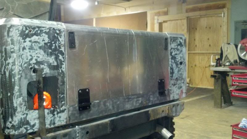

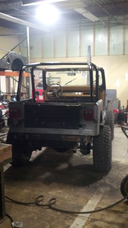

And I also got the Aluminum tailgate on and the latches on,I need to make the latch stops tomorrow then onto bumpers,I took all week off to do a few things around the house but I also will be spending alot of time on the jeep
post #8 of 48 Old 04-03-2013, 08:04 PM Thread Starter
Machinist
Location: Fulton,NY
Posts: 696
Got the tailgate hinges and latches all finished.

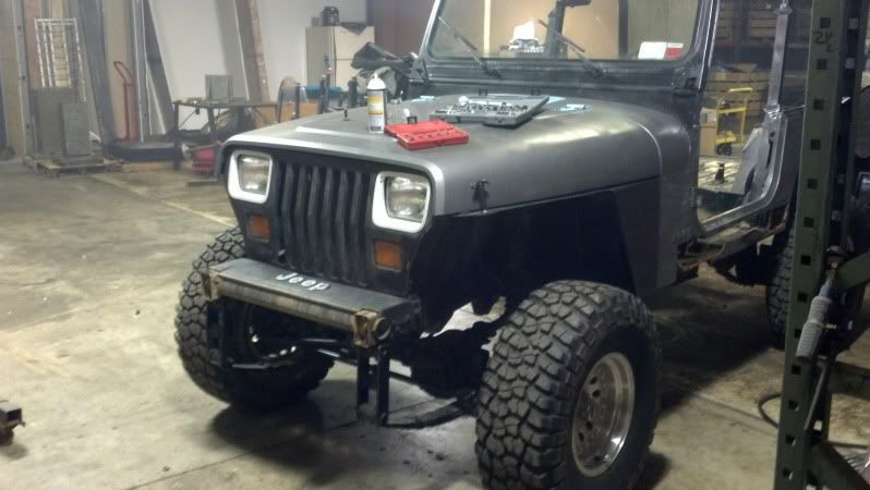

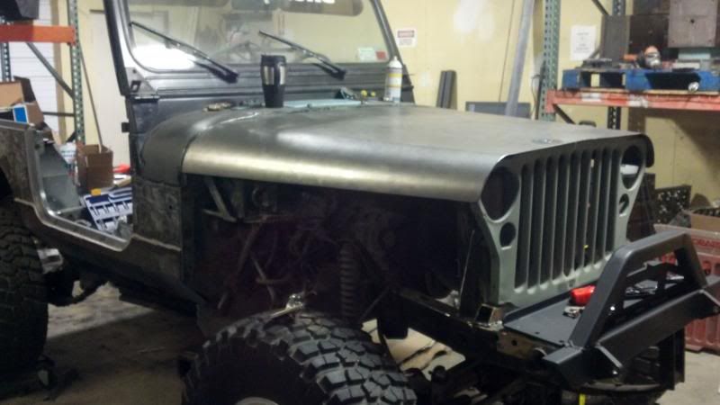

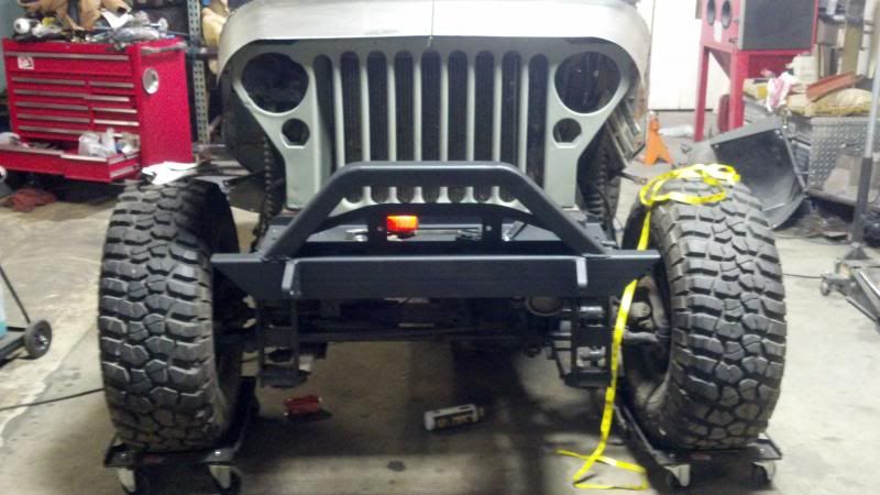

hood skins finished,Welding the supports on tomorrow
Front and rear bumpers are also done.I dont have a pic of the rear bumper but here is the front

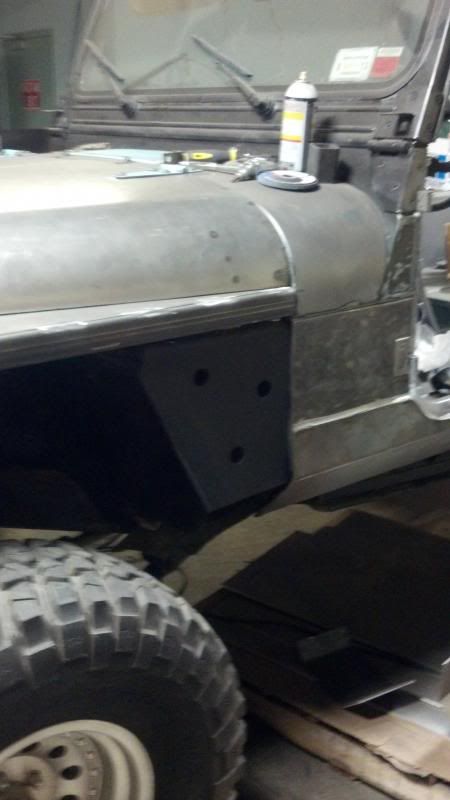

I have to mount my lights and build my tube fenders,I am going to build square tube fenders to keep that old style look.I am hoping to have it all done this week and then out to a friends for paint

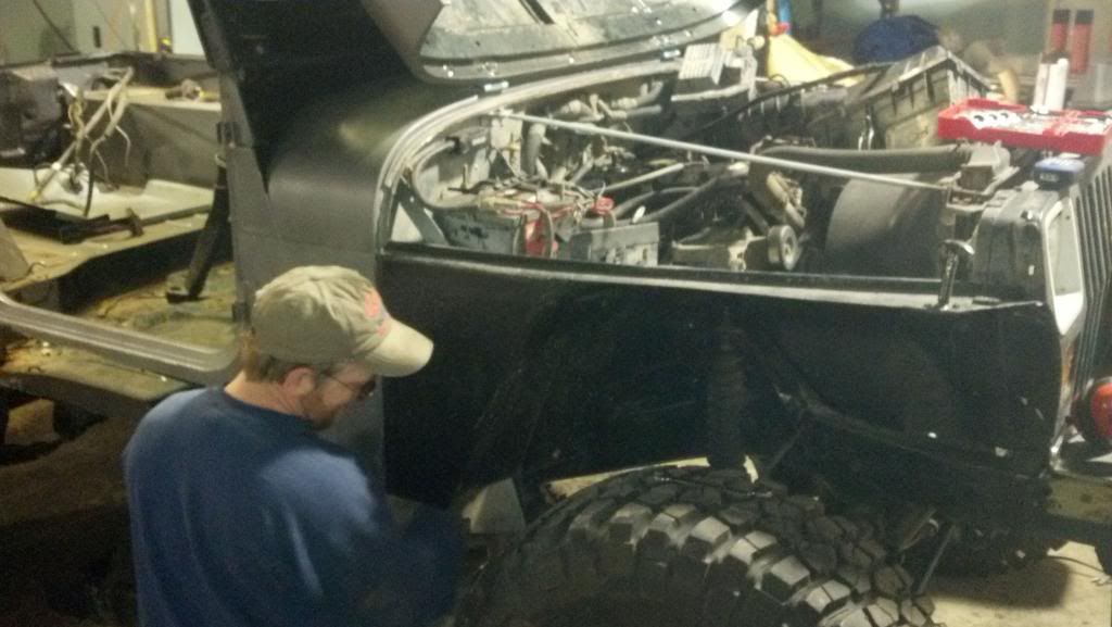

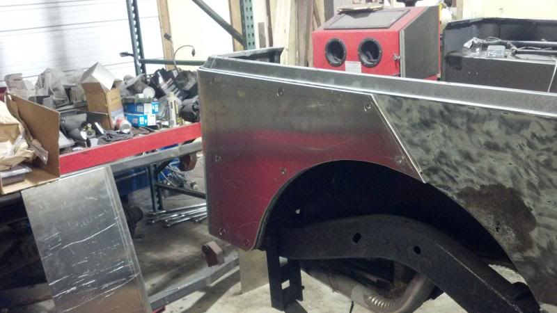

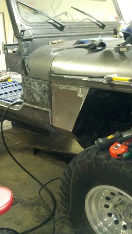

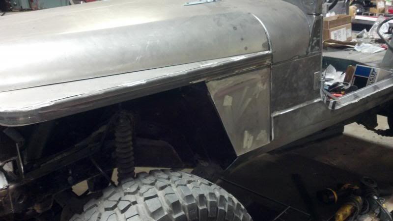

Got the fenders done today
post #14 of 48 Old 04-07-2013, 11:38 AM Thread Starter
Machinist
Location: Fulton,NY
Posts: 696

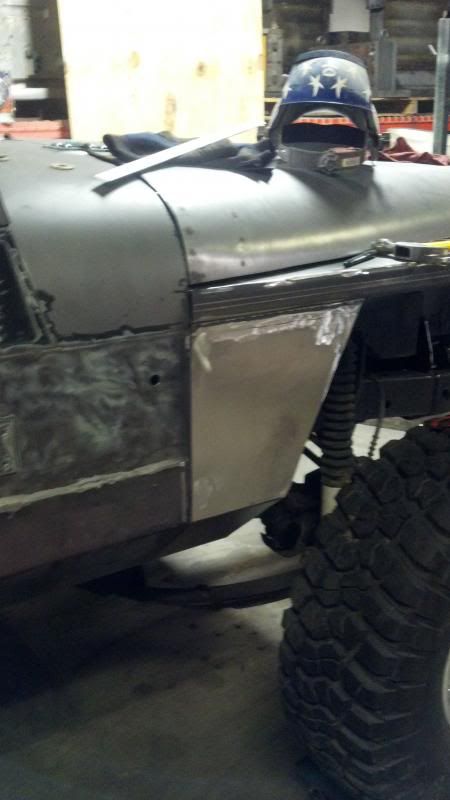

Got the fenders all finished,she is ready for paint!!!I had to finish welding the boatsides on the fenders today.
Before
After
The only thing I may do is do a little work on where the fender boatside meets the tub boatside,The tub is thicker material.It doesn't look bad so I don't know.
