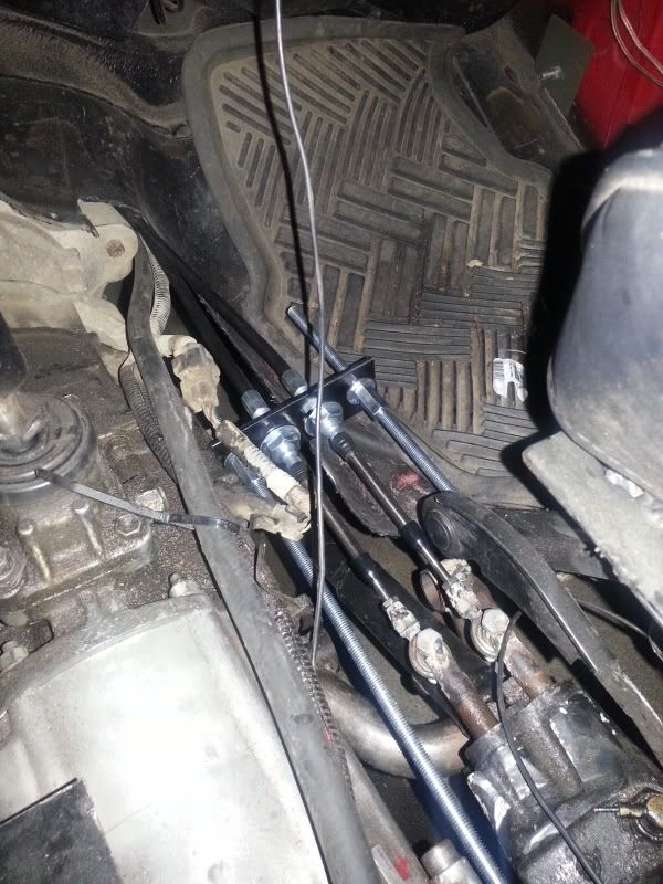

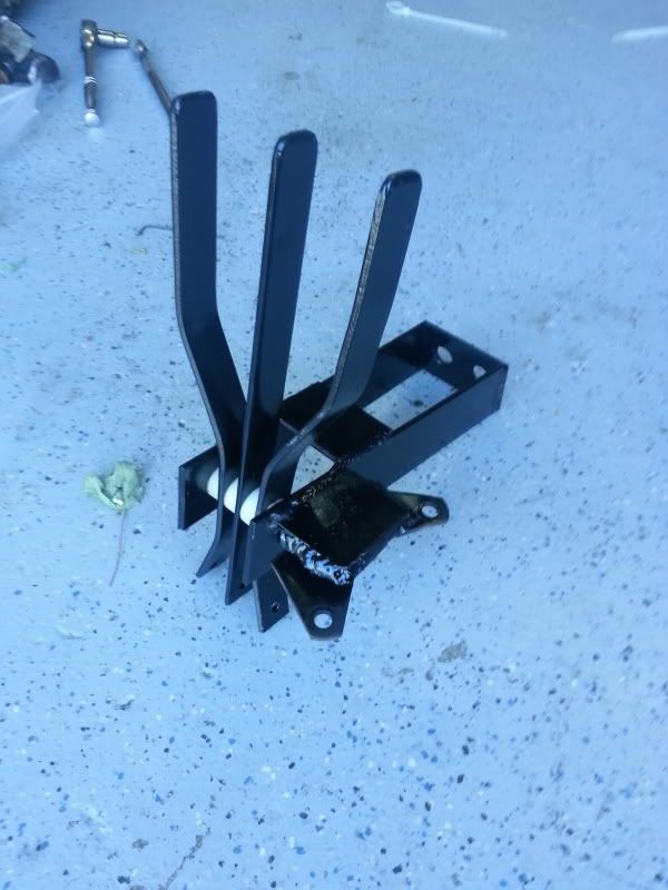

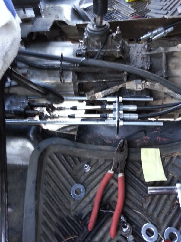

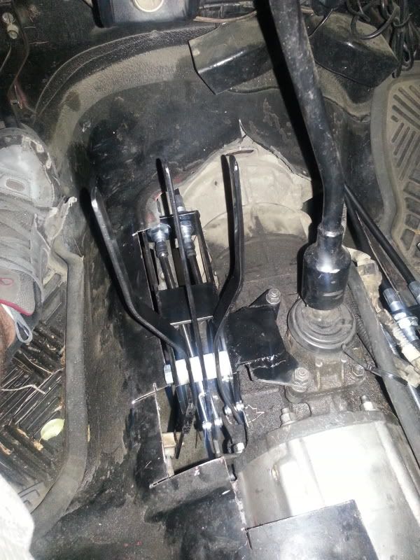

Made cable shifters. Got the cables from napa, total cost was around $110

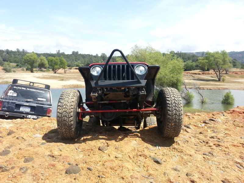

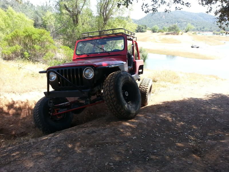

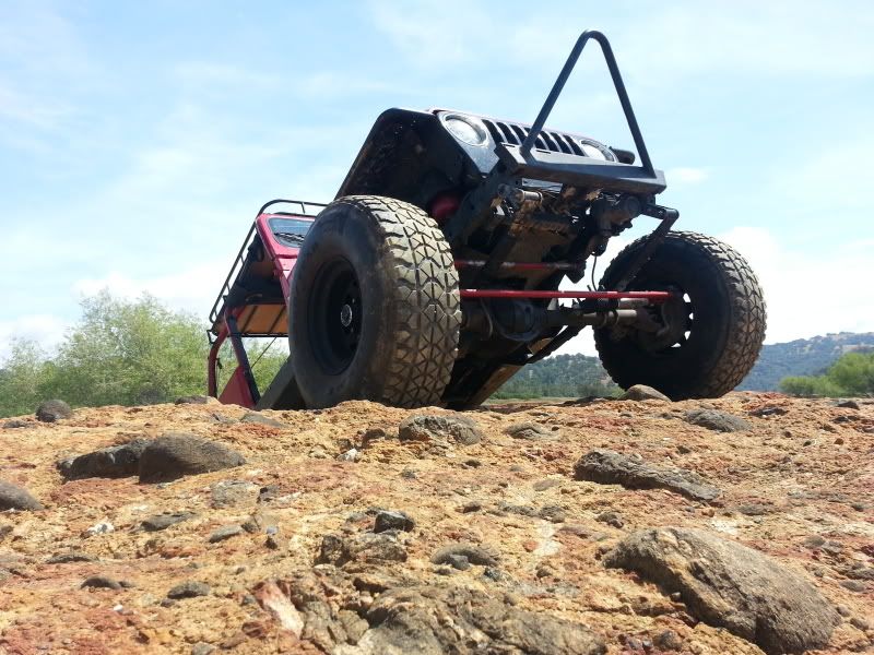

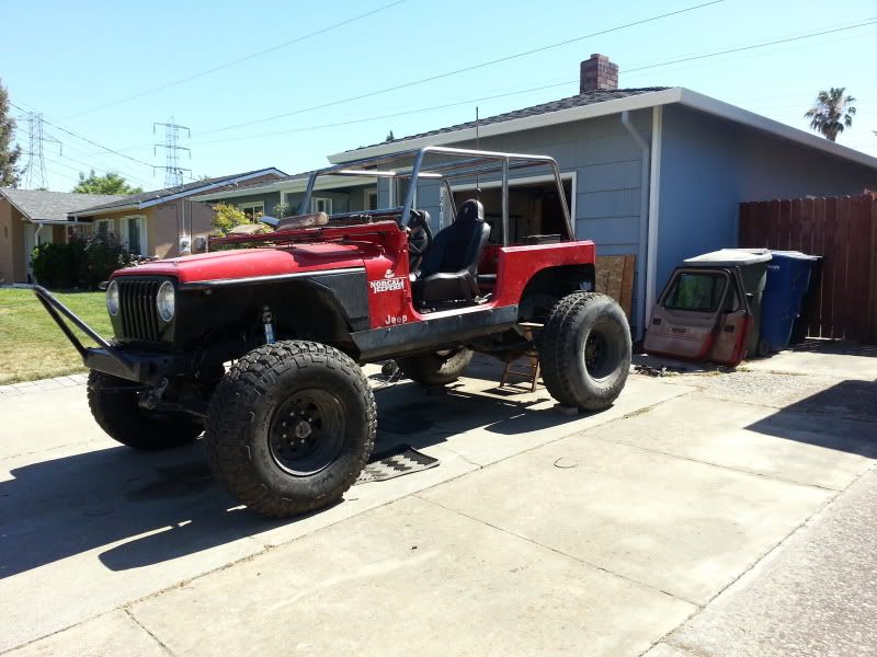

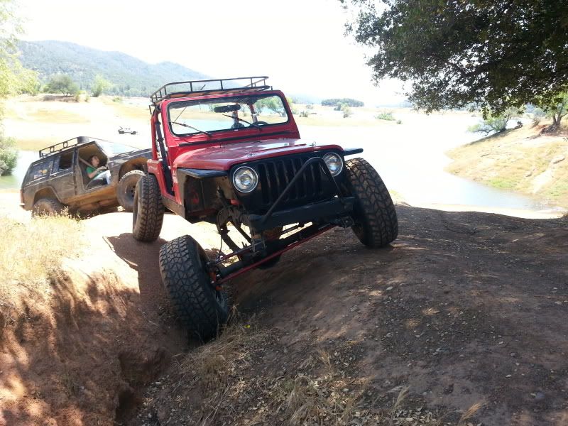

Some pics from today. Sorry all poser shots because i was alone haha.
And I would say I have some pretty good suspension travel.

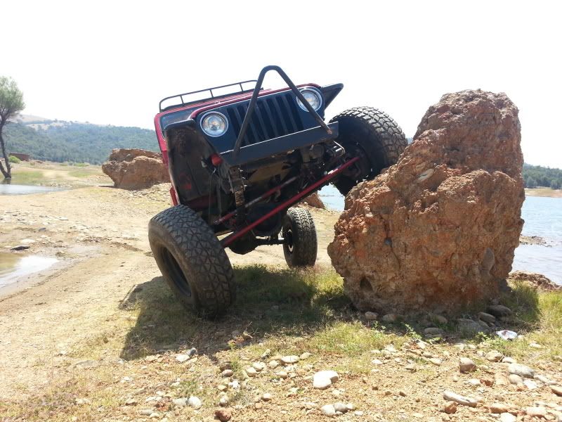

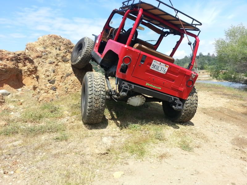

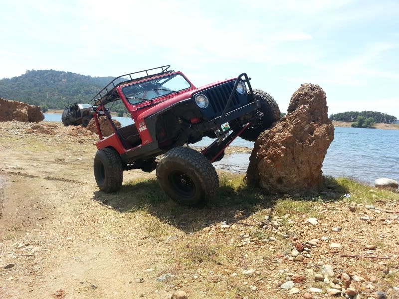

Ghetto rti ramp. Went up right about 4ft off ground. Front shocks are limiting uptravel i need to adress that.

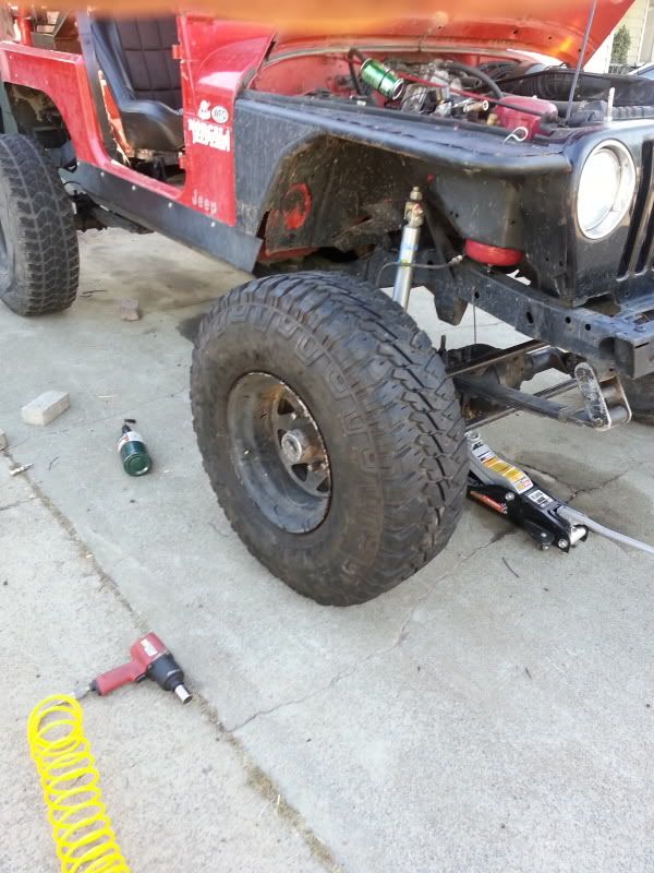

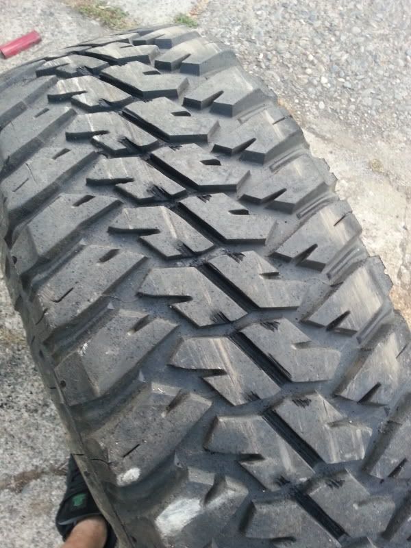

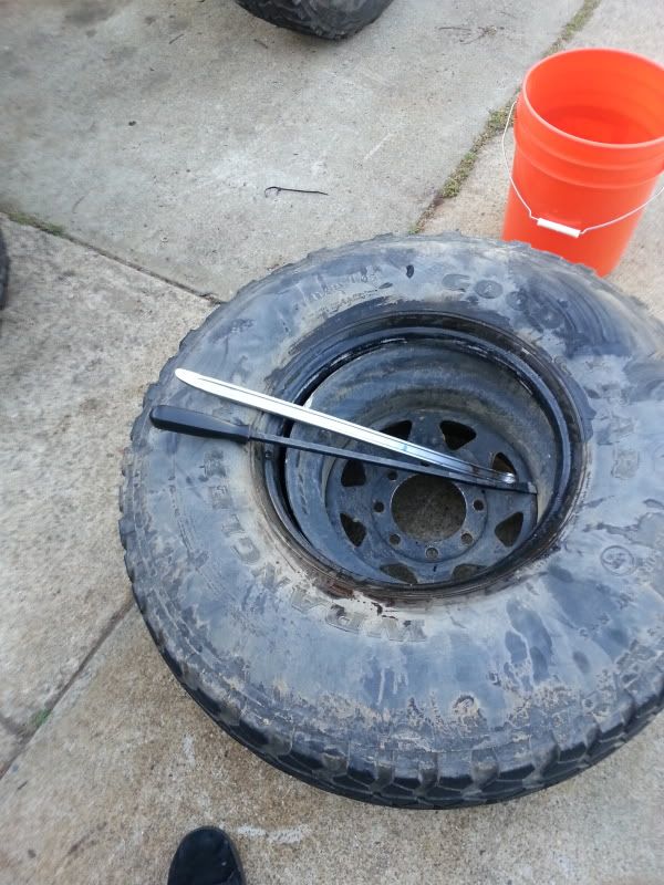

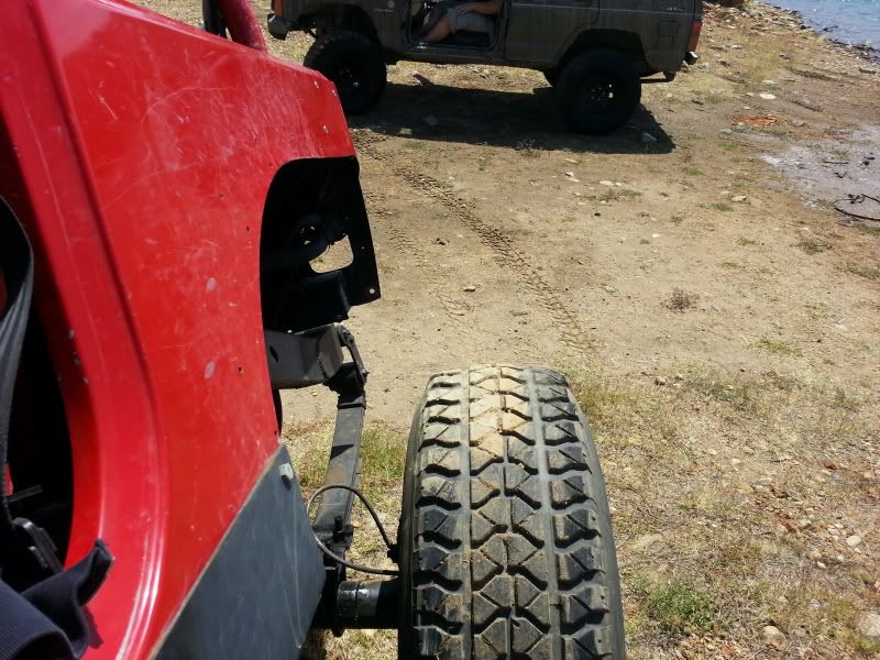

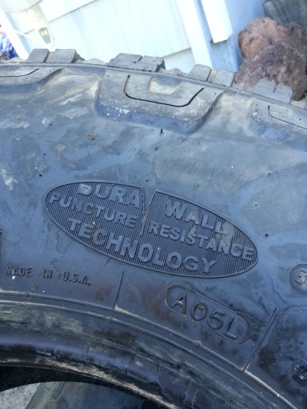

So I picked up 2 Goodyear MTRs to run.
Swapped them to the fronts today. Man was that fun doing by hand. They came on wheels so i had to dismount them, then dismount mine, then remount them.

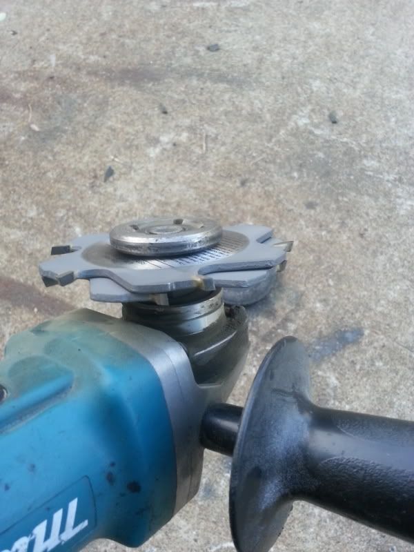

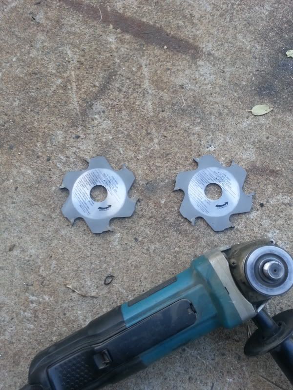

Oh and i found this trick on pirate with 2 carbide tipped bits stacked on a grinder. I grooved the wear bars out of the tires and it took me 15mins for both.

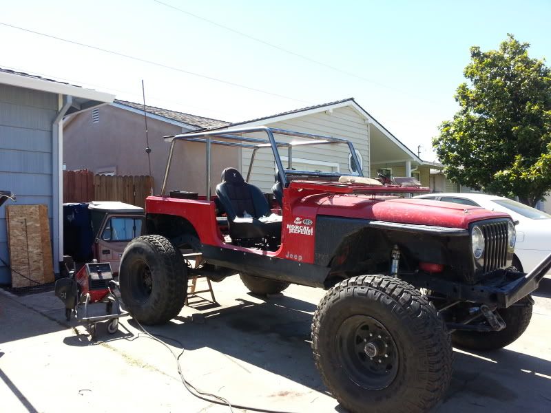

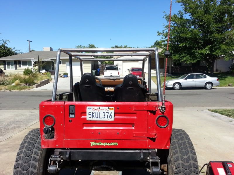

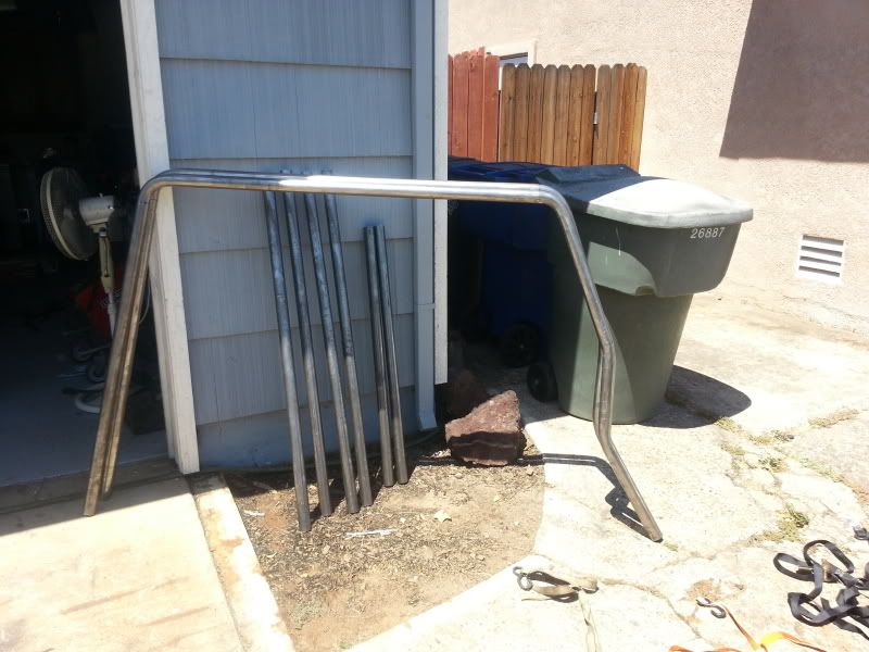

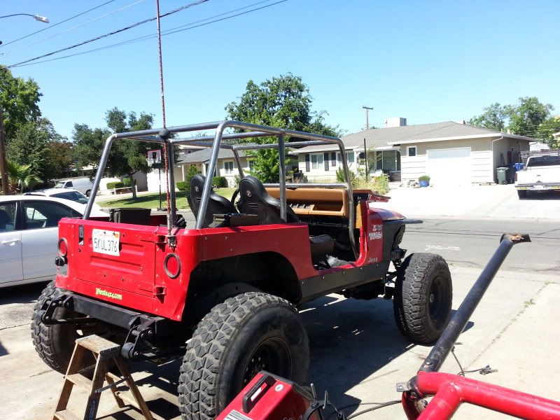

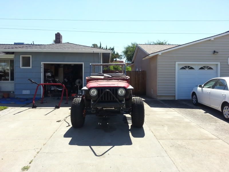

Ok. So another couple hours in and its together. Just tacked up i am going to pull it and weld it after i take a break.
Coping the tube wasnt too bad, i used a paper towel roll and that helped a ton. Next it needs some bars up top, door bars/seat mounts, and some gussets.
So glad i got rid of the factory crap and didnt try to build off of it.

So is it a kit? It looks like a great foundation. Can't wait to see what you do with it.
squishy is offline
post #134 of 409 Old 06-14-2013, 06:42 AM Thread Starter
Norcal_chris
Norcal_chris's Avatar
Location: Sacramento
Posts: 1,071

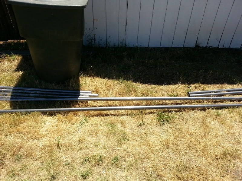

No kit. Started out as 50ft of tube and ended up as this. I just took the two main bars to my dads shop and bent em up.
