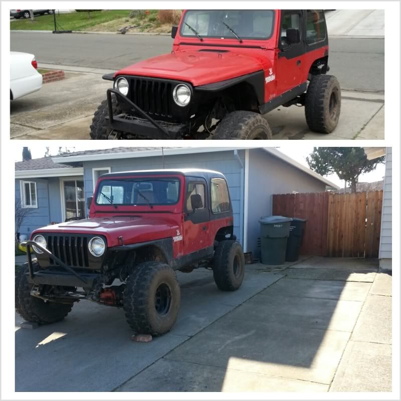

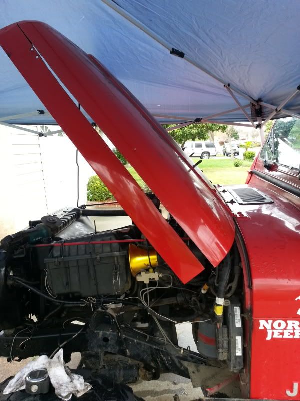

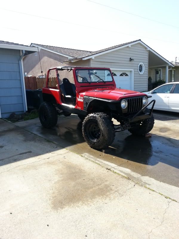

I cut 3.5in off my hood and moved my fenders up. I also dropped my grill down 3/4 of an inch.
Ruined a perfectly good jeep.
OCT '13 & OCT '14 YJOTM 2014 YJOTY
Norcal_chris is offline
post #97 of 417 Old 03-20-2013, 09:02 PM Thread Starter
Norcal_chris
Norcal_chris's Avatar
Location: Sacramento
Posts: 1,076
Oh and here is a cute little thing I made to show difference between old and new. You can also tell in this pic that the grill was dropped down and slightly forward.

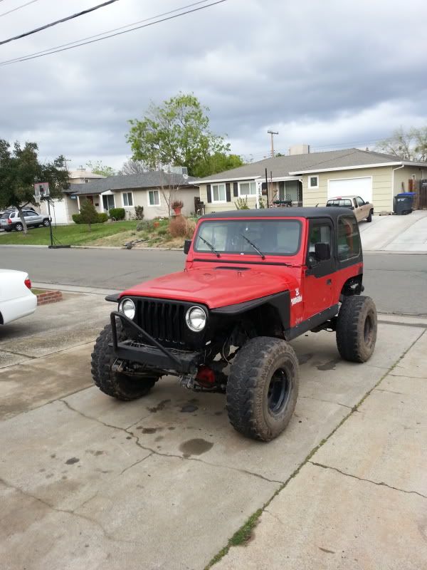

Oh and Its been nice latley and since I am going wheelin tommorow, Top and doors came off.

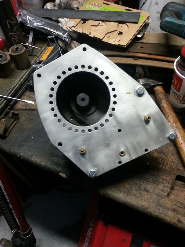

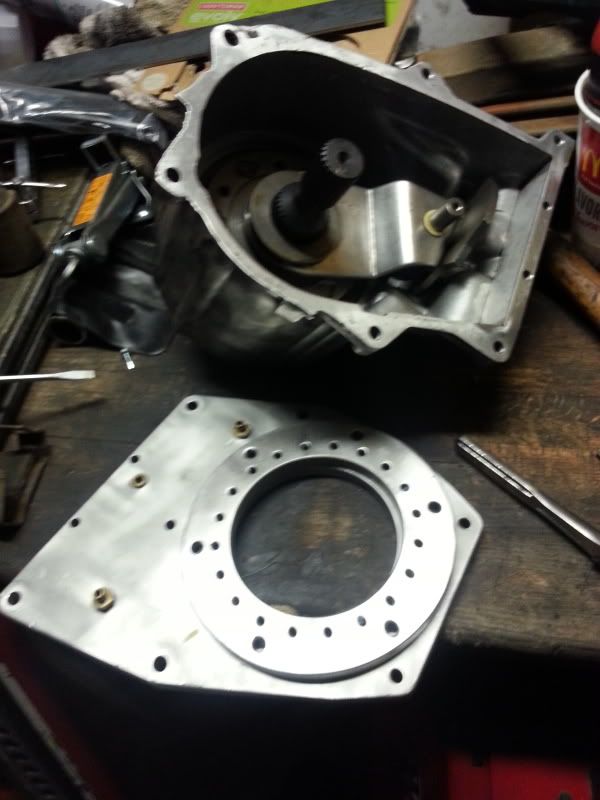

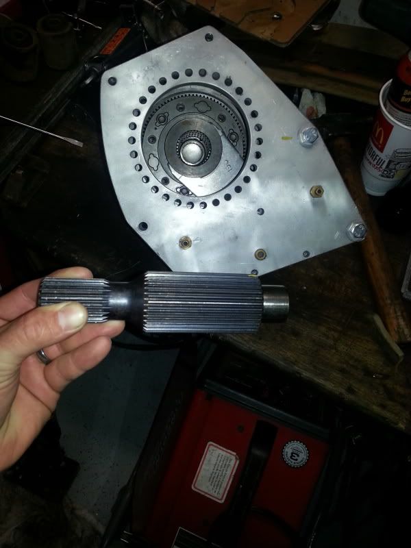

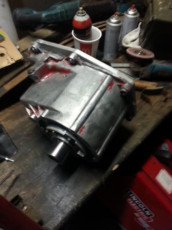

Well. I was going to make the adapter plate, and buy the shaft from Duffy. Then i was going to have to find a 231 to hack up. I found this deal and for the price i couldnt pass it up!

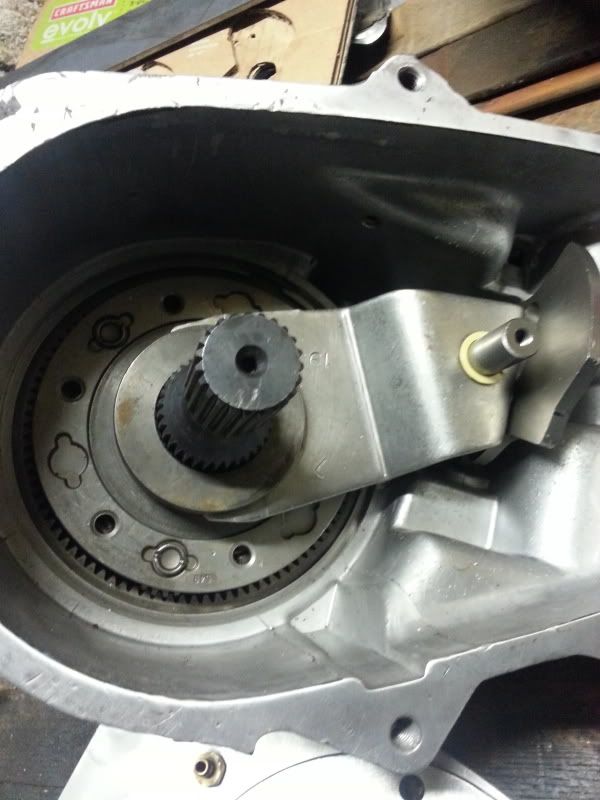

Its a np231 Crawl box doubler. I am sticking a dana300 on the back of it and replacing my Teralow with it. Will give me 2.72-1 or 7-1 ratios. As well as 2wd low, Front Digs, and a stronger case.
