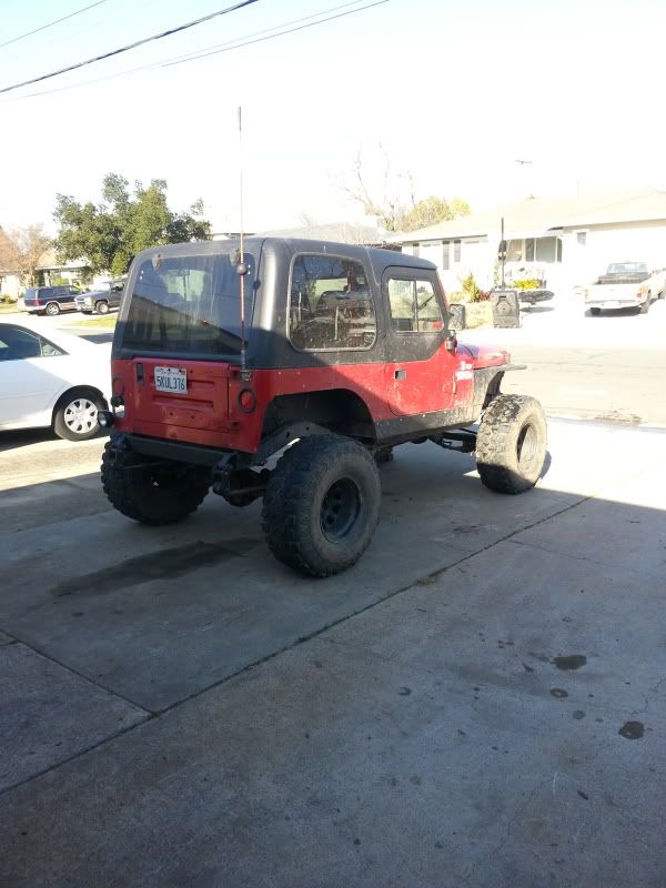

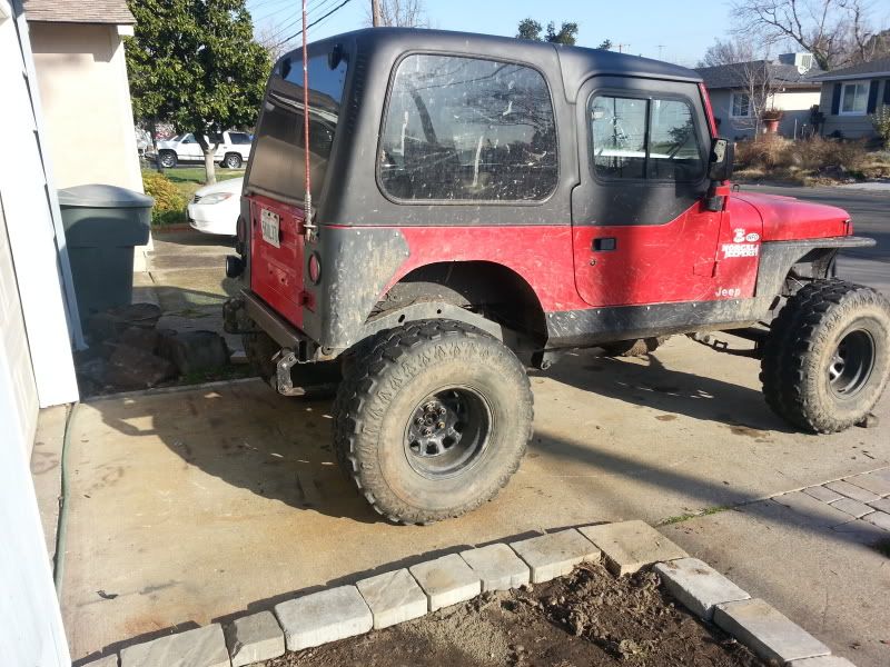

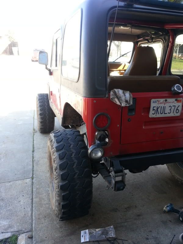

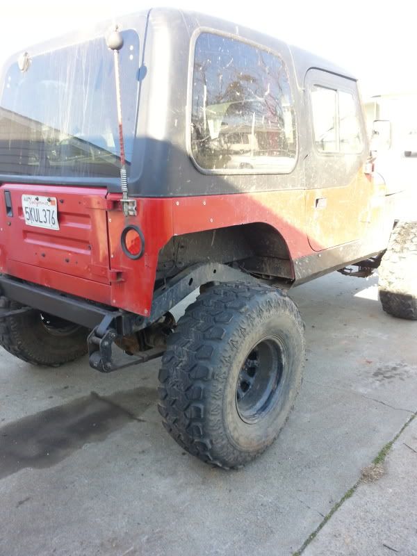

Xj rear springs are in. Axle is wayyyyyy back. Tires are almost flush with back of tub.
thinking im gonna shorten the rear shackle an inch or so to bring it down a little, but the spare tire and hilift are not on there so that may bring it level as is.
I tryed to keep as much as i could in the back to make it looks less agressive to appease johnny law. We will see how that goes.

Looks good! I have this planed for my jeep as well. Only thing that doesn't look so good is the shackle angle, I think you would be way more happy if the shackle angle was more like 30*. It should ride Nd flex better that way...

I actually have that in the plans. I am moving my front mount up closer to the frame and back a touch to make the shackle angle a little more angled. It rides nice now, but the added angle will be nice to firm it up back there. More angle=stiffer rate.

From my experience, anything from 20-35* will ride better then a 90 or 45...
