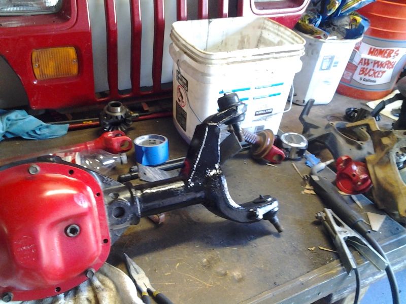

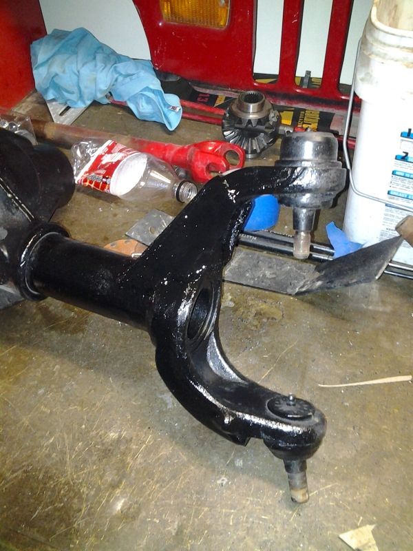

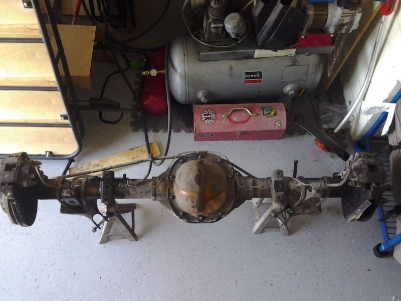

Dan hooked me up with a non disco d30 housing with 4.10 gears. So the plan is to find a 4.10 geared 8.8 to swap in and run till i can afford and build up what i want to shove under it, while still being able to wheel hard.
Decided since it was on the bench to make up some Inner C gussets. The stock Cs look stupidly small and ready to bend. So whipped these up.

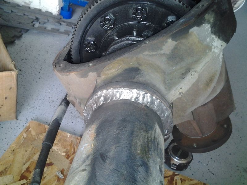

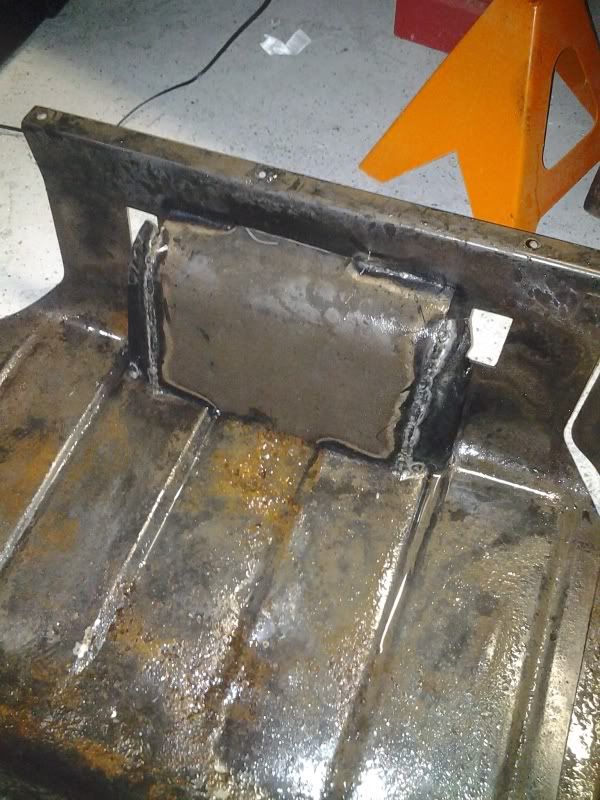

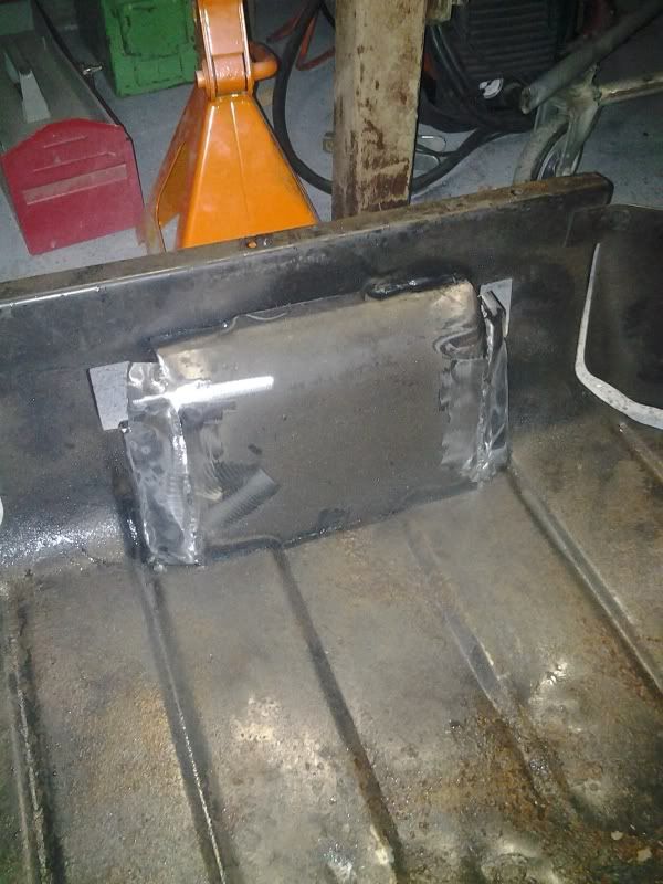

Went with Mike to Pick and pull. 20%off sale. Got this 8.8 for 177bucks out the door. 4.10s disc brakes, cant beat that.
Fired up the stick welder. Ran through about 10 sticks of 6018 on some scrap before I remembered what the hell I was doing.
My dad gave me a few sticks of ni99 from the shop so I used that. Didnt turn out too bad.

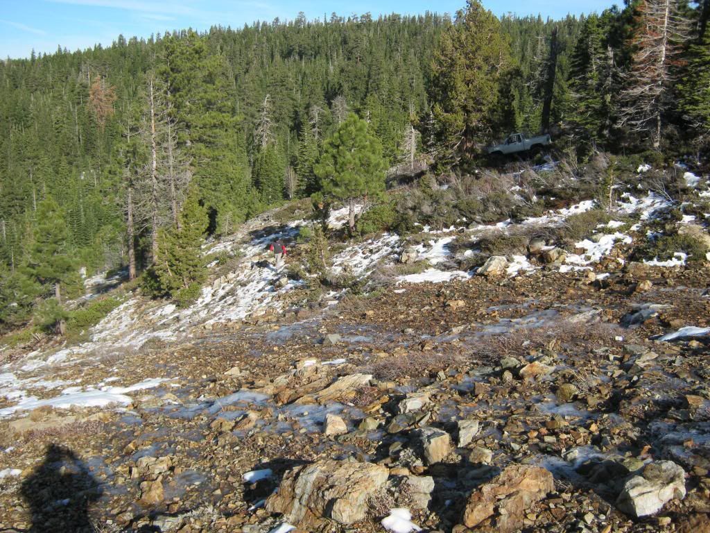

Made a run to signal peak/fordyce
Got about halfway through signal peak and somehow got wayyyyyyyy off trail. Had to Aetna buggy up some sketchy as hell icy dirt hillclimb and sidehill on a mountainside with runoff. So we turned back around and decided to hit fordyce for the rest of our time. Made it almost all the way to the first water crossing and then turned around because we ran out of time.
Only big obsticle was Driveline hill, and I was able to take the right side line with some throttle and made it up. Was happy about that. All in all was a fun time. Cant wait to get my 8.8 in and head back up.

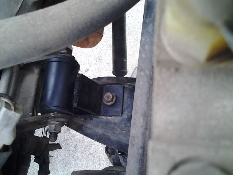

Made some new motor mounts. Poly bushings and about 1 3/8 lift over stock. Now that these are done i am going to redo the tranny mount and raise it till i can get a flat skid. need to clearance out a support under the bottom for the tcase, and then shouldhave plenty of room.

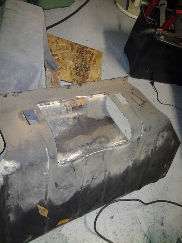

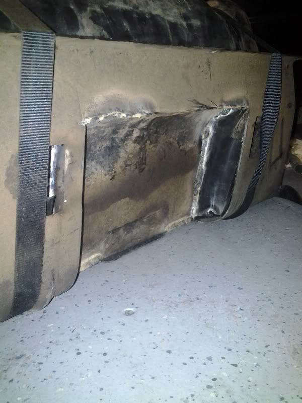

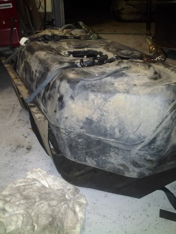

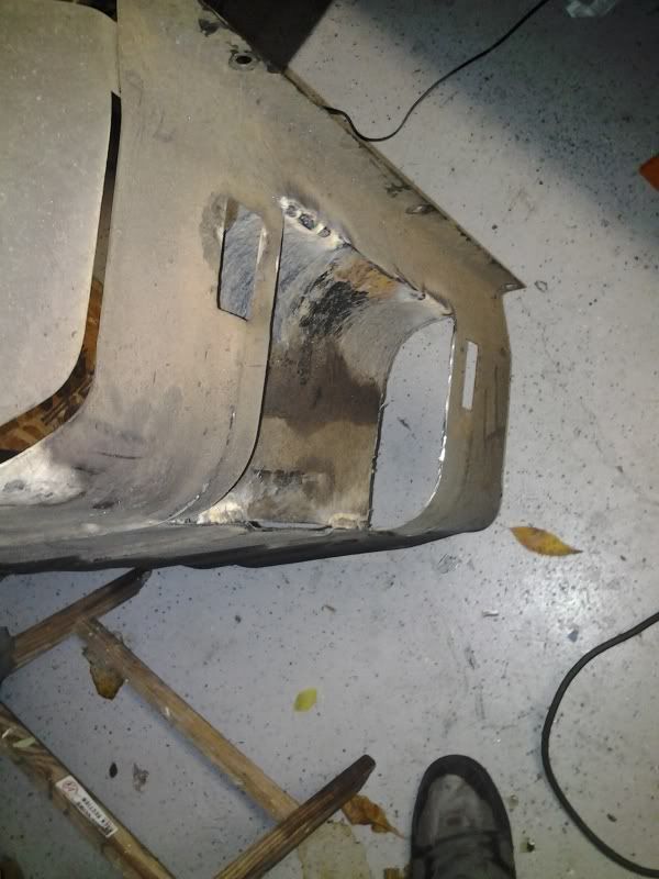

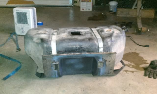

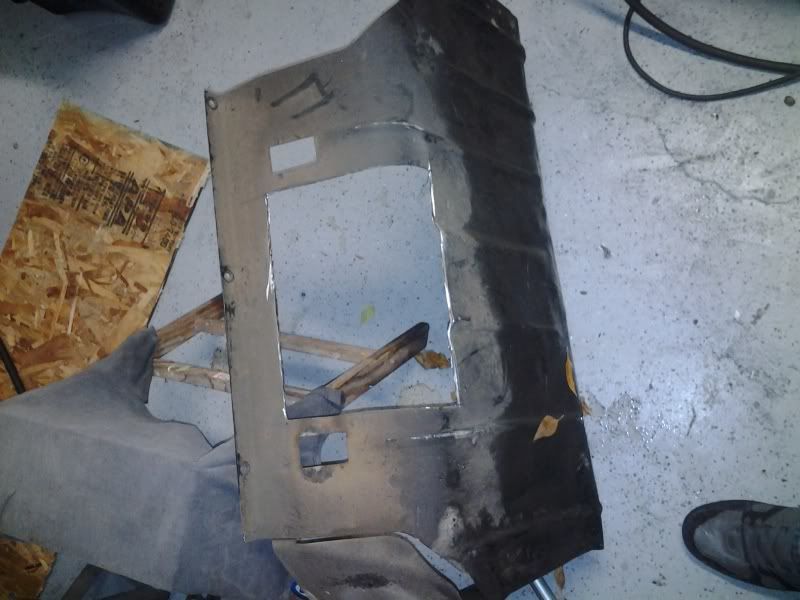

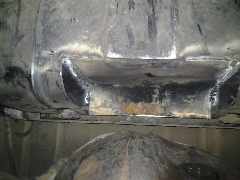

Developed a leak in my gastank. Fixed it, and then it leaked from somewere else. I picked up a new one and pulled the old one tonight. It looks like someone smeared a big tub of bondo all over it to patch a leak :haha:
I decided since i had the tank and skid out to do a nice little mod. Cut up my stock skid and did some fliparoo action. added a little to the sides to keep the tank happy and then got out the rachet straps and the torch and heated the tank up and racheted down. Let it cool, pulled it out and did it a few more times untill a nice dimple had pressed into the tank and let it sit back flush.
I should be able to stretch the rear about 4in now with the 8.8 without an issue.
Just got the tank in. Clearance shot with the d35. the 8.8 takes up a little more room, but I have a ton of space there.

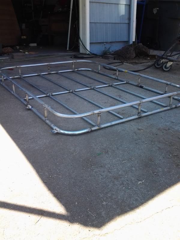

Originally Posted by Norcal_chris View Post
Built a roof rack. Its light enough i can leave it on and use it to keep the sun off me. probably only weighs 30-40lbs.
Very nice, what kind of tube did you used??......
It is made with 3/4 and 1/2 emt conduit. it was a pain getting all the galvanized coating off the ends that needed to be welded but the material is super cheap.
Great, I'll have to try this. Did you used a MIG welder?, 115V or 230V?..
Used a 115v lincoln sp135t. fairly low setting because the stuff is pretty thin. I am more than happy with it though. i need to make some mounts for it so i can run it with my hardtop on.
