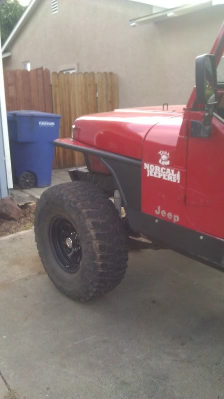

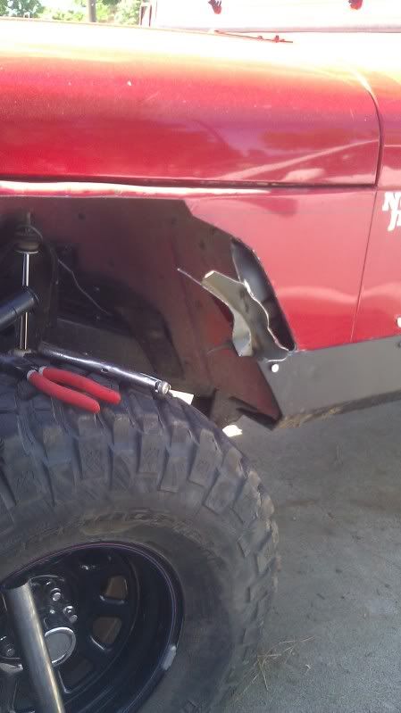

Tree branch made me some hi line fenders.... at least on the pass side. I actually got out of that spot.
Little baby jeep did great

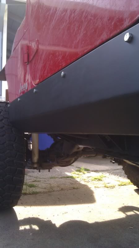

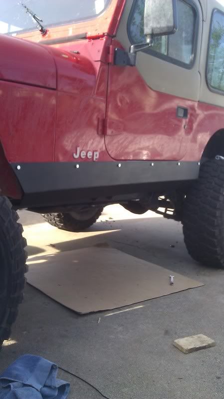

Picked up two prices of 3/16 steel. 13X62
Making some mini boatside rocker guards.
Still need to do some cutting and then weld/sand. Got one side done
what a day.
Im so tired and only got one side down. I may be rolling with one for a while unless i sack up and just power through it.

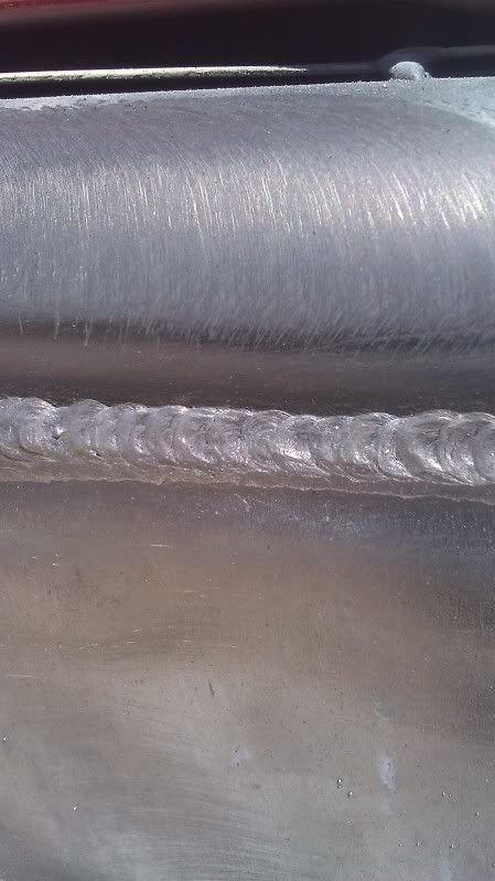

let me tell you it was a pain welding these up. I did it in about 12 passes per edge so 24 total. I did get a chance to get some good practice in though..
Here is the results and final pics!
Best i could do with flux core action
Bleh that took forever
And here we go all sanded nice and smooth
And the final look!

Got the other side almost done. Got some paint on the first one and have it mounted for good.
Sure beats paying 499 for these that i copied the idea from

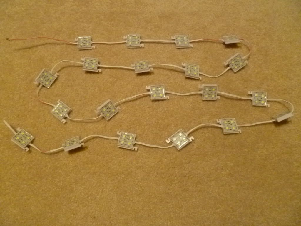

The lights came from Dealextreme. 26bucks shipped for 20 of these LED bricks.
They came with 3m tape on the backside and 2 little tabs to use screws.
http://www.dealextreme.com/p/waterpr...p-dc-12v-91953

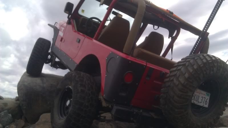

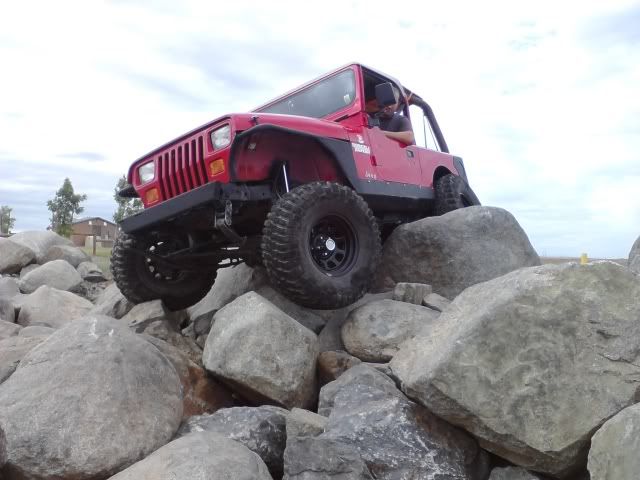

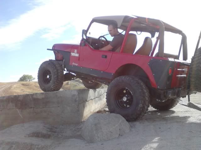

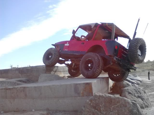

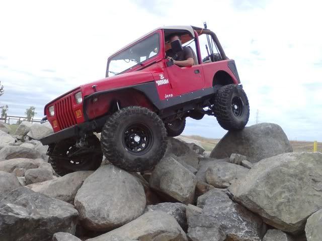

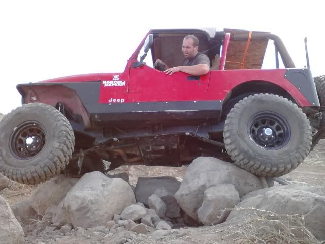

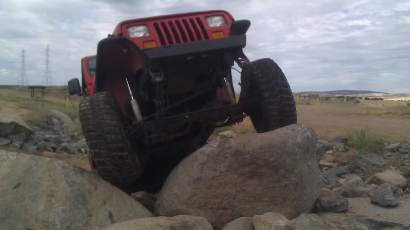

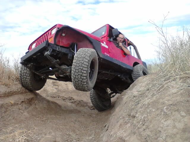

went wheelin yesterday.
Rocker guards, proving their worth. :thumb:

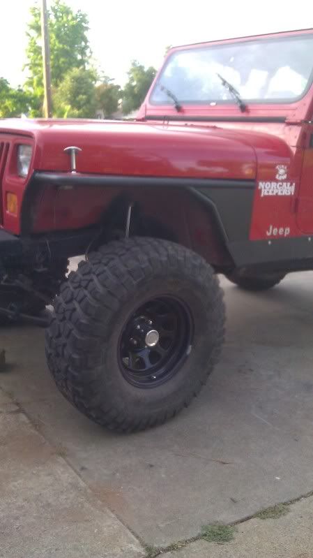

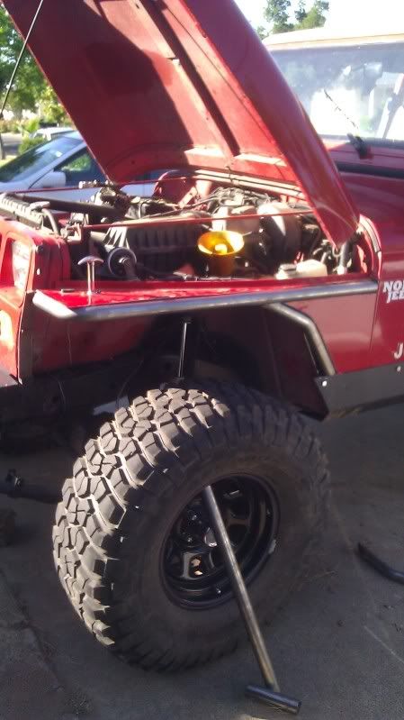

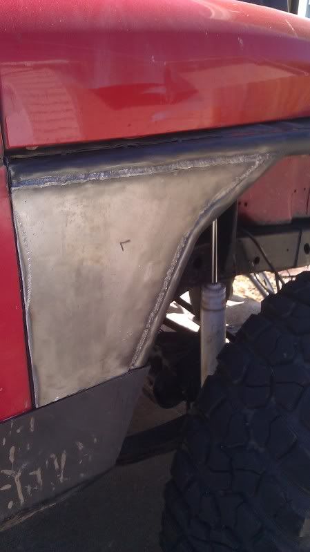

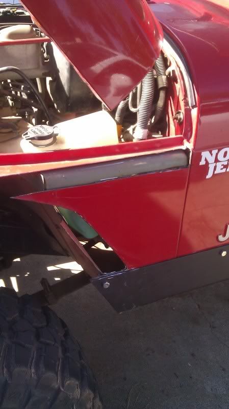

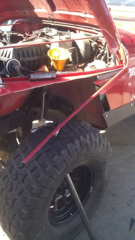

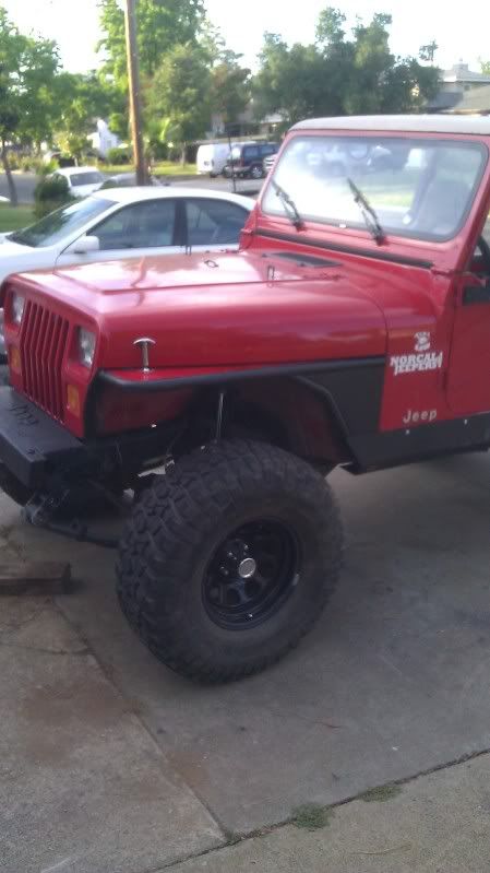

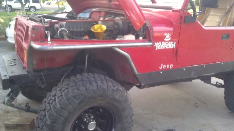

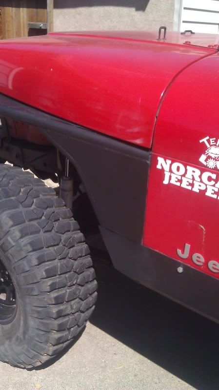

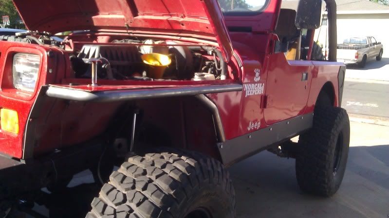

Made some tube fenders today. Pretty simple but still took a while to get the cuts done. They are not finished. The side and the top will be skinned with 3/16 and welded and blended in to look like a solid peice.
I wanted to keep the inner fender so i did them this way.

Another giant lapse in updating..

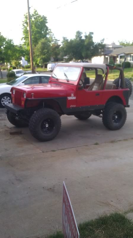

got the side plates welded in. Had a bad headache so only got that far just sitting inside on the couch now veggin out.

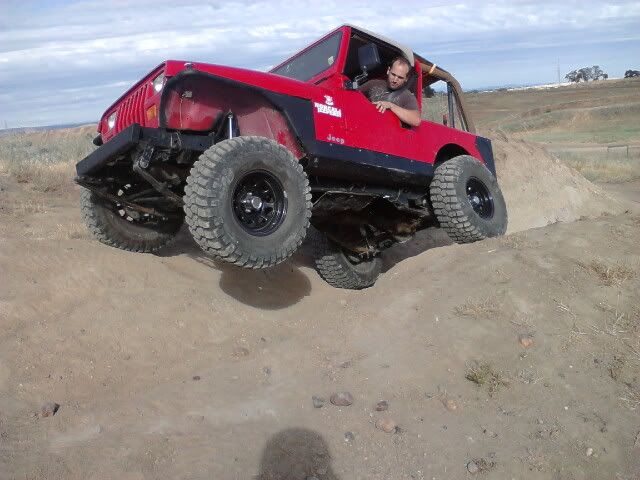

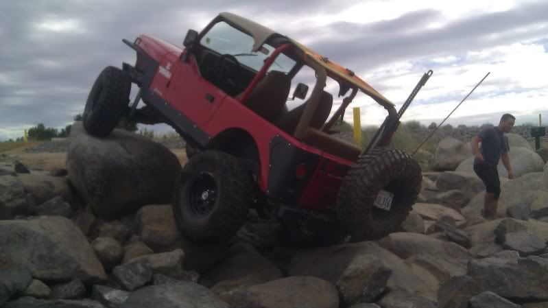

Made it through the mini rubicon and over the giant rocks i never attempted in my blazer.
Made it over a few other crazy lines.
Made it up the steep part of the alamo that my blazer made once, BARLEY and the other time broke my driveshaft.... Needless to say i walked up it.
Jeep is doing excellent.

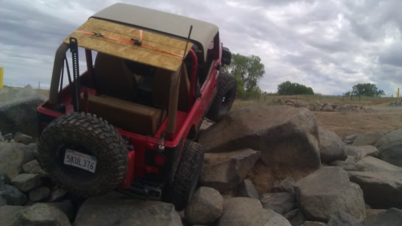

Built a roof rack. Its light enough i can leave it on and use it to keep the sun off me. probably only weighs 30-40lbs.
