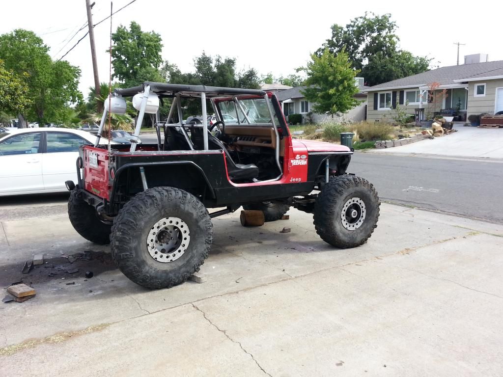

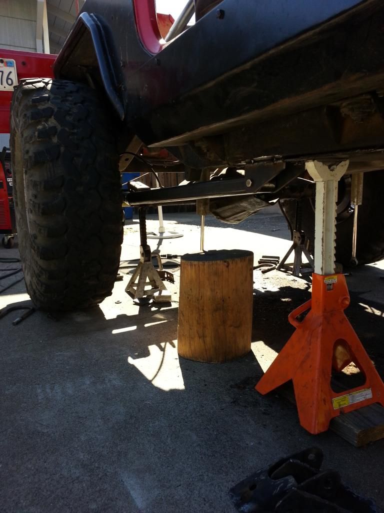

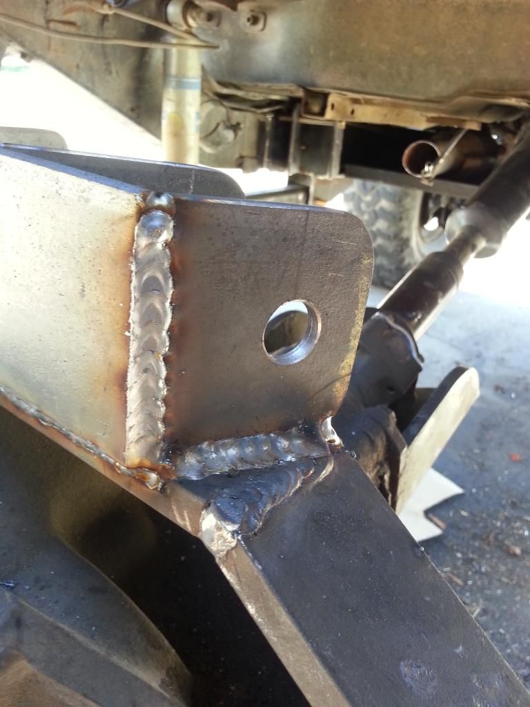

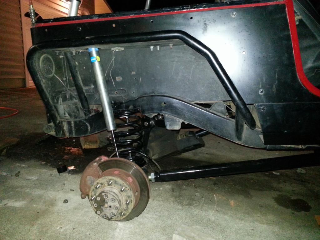

Well Didnt want to build an antiwrap bar..... soooo.
Upper Links x y z
Frame End 37.00 17.50 27.00 in
Axle End 0.00 2.00 27.00 in
Lower Links x y z
Frame End 38.00 19.50 23.00 in
Axle End 3.00 25.00 19.00 in
Top hole
Static Anti-Squat 57 %
Roll Center Height 26 in
Roll Axis Angle 1 degrees (Roll Oversteer)
Instant Center X-Axis 166 in
Instant Center Z-Axis 34 in
middle hole
Static Anti-Squat 76 %
Roll Center Height 27 in
Instant Center X-Axis 103 in
Instant Center Z-Axis 28 in
bottom hole
Static Anti-Squat 96 %
Instant Center X-Axis 75 in
Instant Center Z-Axis 25 in
Ruined a perfectly good jeep.

Jeep looks great Chris! I have been meaning to catch up on your thread since the 4 link. What are your thoughts on it vs the leafs?
Is that Timatoe's rig in the 5th pic from the bottom?
Randonexplosion is offline
post #234 of 416 Old 08-07-2014, 06:19 PM Thread Starter
Norcal_chris
Norcal_chris's Avatar
Location: Sacramento
Posts: 1,075
Yeah. Tims on the far right, and MR B on the far left.
Links are worth it in every way. I spent many hours on the 4 link calculator making sure it was all right. Changing a little here and there to see what else would be effected, and how it reacted.
Basically you can come up to a 3ft ledge, crawl the front tires over it, and then just hammer down and it just climbs right up it. I did that a few times too
Rides awesome on-road. No flex-steer, no jarring bumps. The biggest thing I noticed was no loss of torque on taking off and shifting. I always felt before the springs flex and absorb the torque when i started off. Now it just goes.

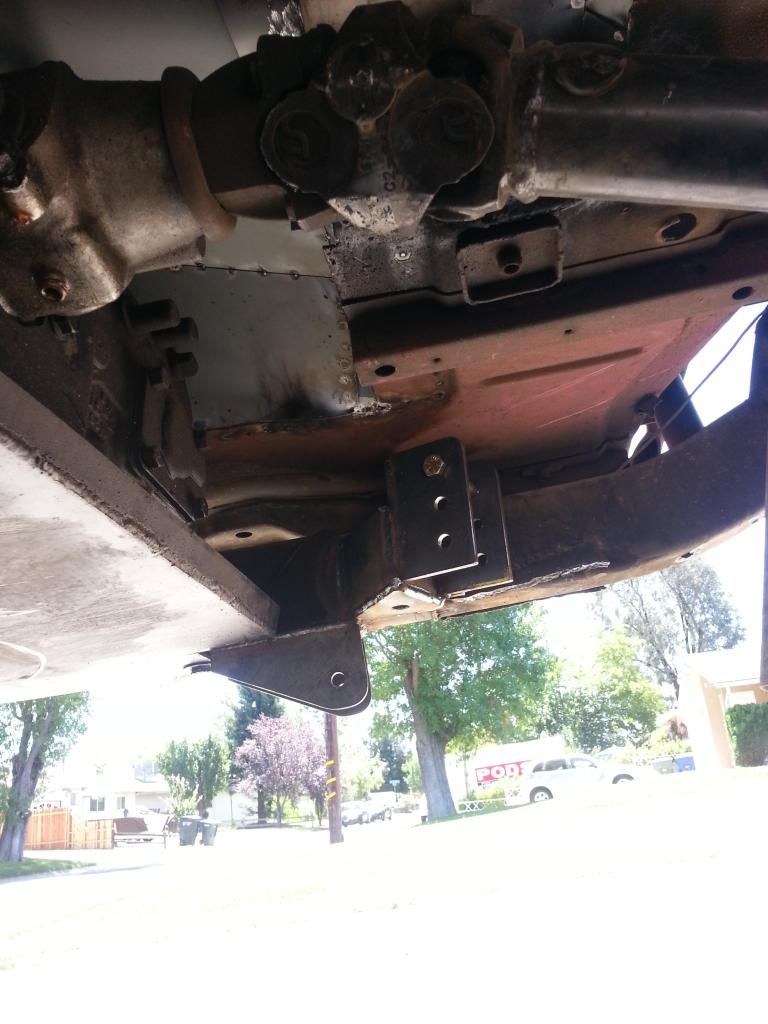

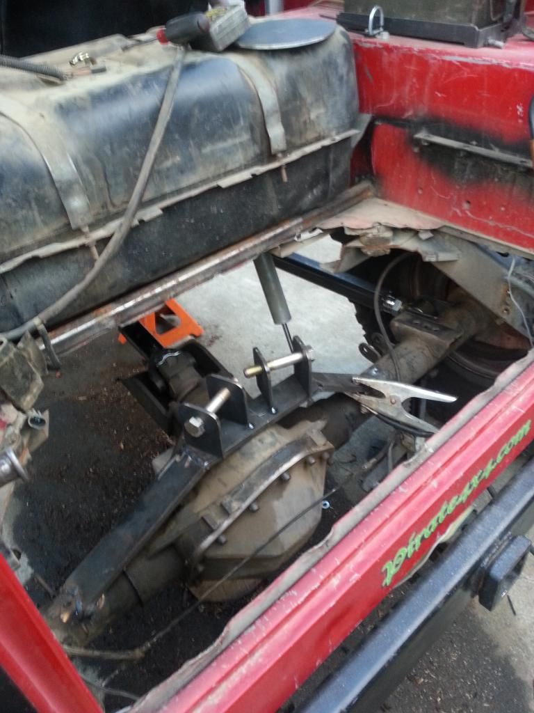

Sooo......
Upper Link x y z
Frame End 41.00 -10.00 26.00 in
Axle End 0.00 -8.00 26.00 in
Lower Links x y z
Frame End 39.00 16.00 21.00 in
Axle End -2.00 21.50 19.00 in
Pannhard Bar x y z
Frame End -5.00 -14.50 26.00 in
Axle End -5.00 20.00 26.00 in
Geometry Summary:
Anti-Squat 55.12 %
Roll Axis Angle 0.29 degrees ( - roll understeer, + roll oversteer)
Roll Center Height 26.03 in
Instant Center X-Axis 141.50 in
Instant Center Z-Axis 26.00 in
