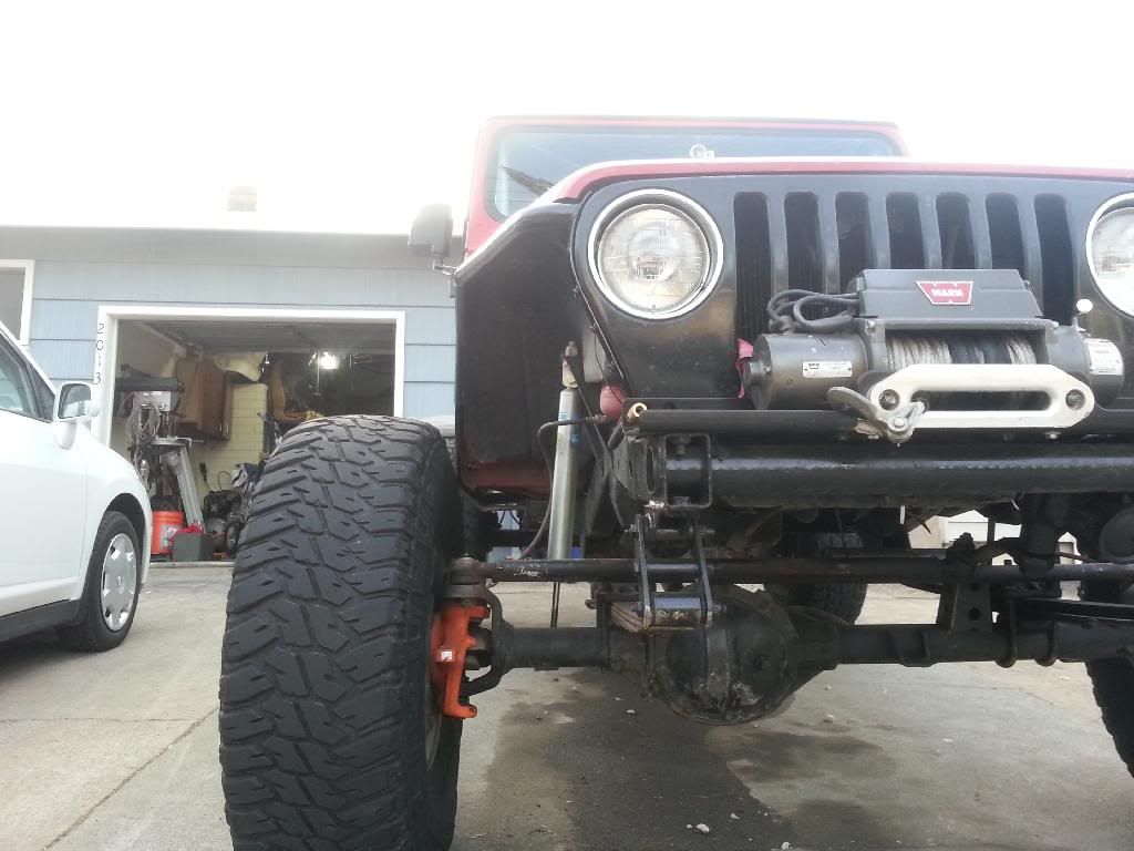

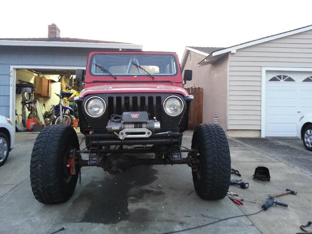

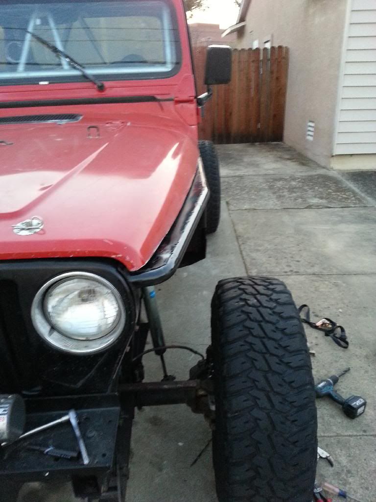

Got rid of the "Wing" fenders I had. When i had 33s they slightly covered the tires, after the tj grill swap I never really re attached them non ghetto. So i decided to cut them down into a half fender basically. And I sturdily attached them.

Why not go full case?

I don't wanna spend that kind of money on this axle. Be it the locker, install kit, gear setup. Wouldnt want to stay with current ratio so that's another cost.
I'm going with cheap as possible while I wait for a d60
