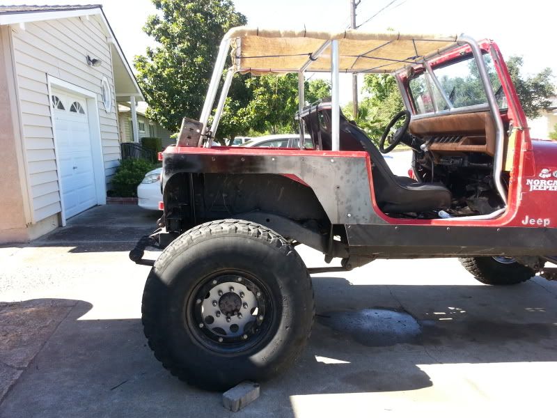

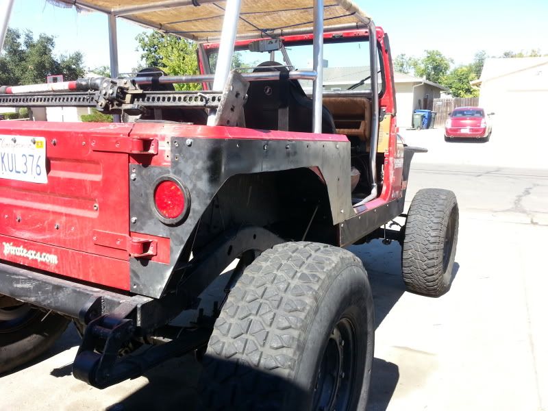

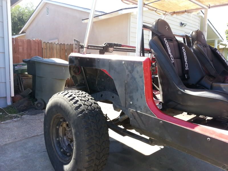

Was bored today so I made some rear corner armor. Tomorrow I am going to the shop to bend up some tube. It is going to follow the outside edge of the armor. The tube will follow the bends towards the front of the fender to match my front fenders.

Rear tube fenders done Minus a little filler peice on the front, and pulling em and painting em.

Nice job what kind of bender you got?

The rear bend was done with a 5clr die on a older hydrolic hossfield bender. Other bends were done with a snazzy 2.5 clr ercolina mandrel bender

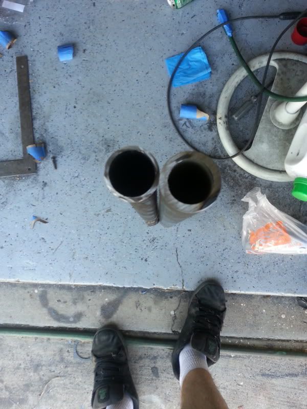

Posts: 1,076

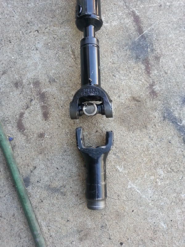

Fixed my front driveshaft. Going to see if i can salvage my old skid and bend it back and give it some more reinforcement.

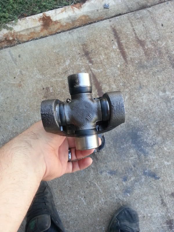

Its mobile again!
1350 beef. No more 1310 crap.

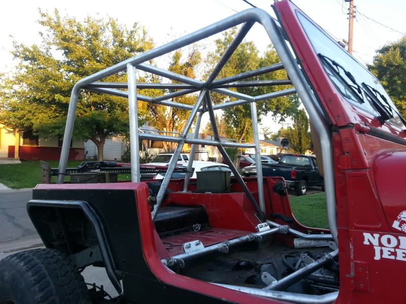

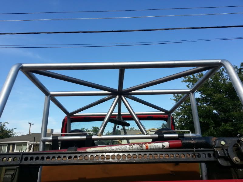

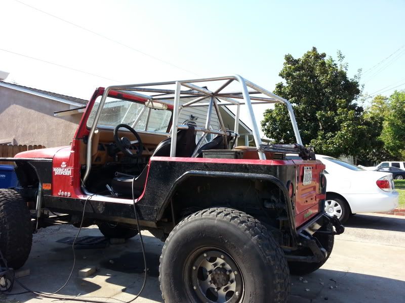

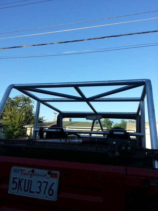

Did some cage work. Not bad for 2hours work.
Was kinda mad when i started test fitting tube. Was planning on big Xs over both but I just didnt have a comfortable amount of headroom in the front. I put my seats down as low as I wanted, but It wasnt low enough i guess. My cage is also a little lower to fit in a hardtop. So I settled on a Giant X. from outside Apillar to inside b pillar to outside C pillar. Gives most headroom and im going to tie into that center node at the B pillar anyways. So it works out.

Got a couple more hours to do some tubework.
The bars from top of b pillar to harness bar will have another tube from were it ends to the bottom of b pillar. . Just didnt have time.

Cage is all welded up. I just need to take a wire wheel to it and get the spatter off.

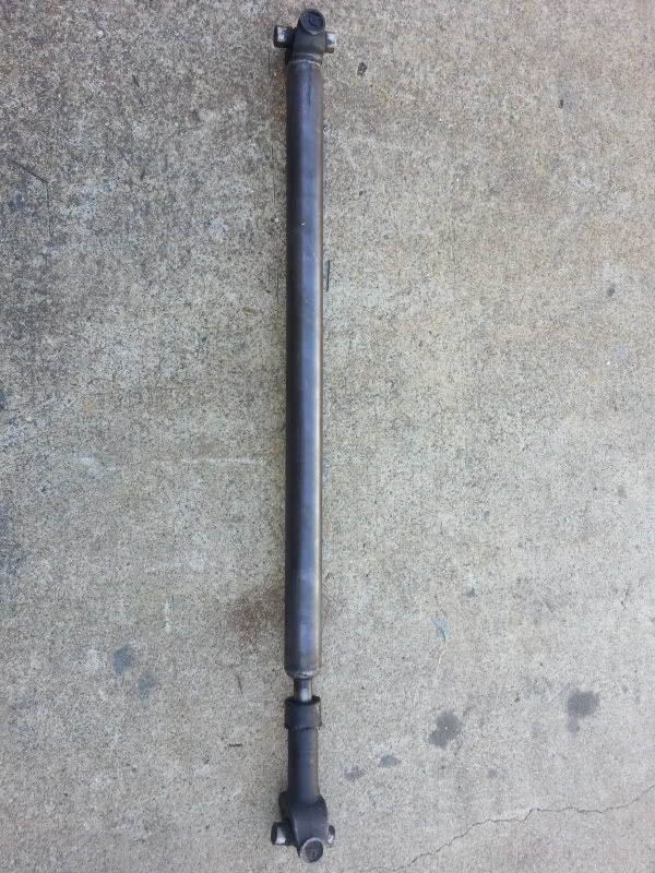

Remade front driveshaft.
If this bends or twists I will quit.
