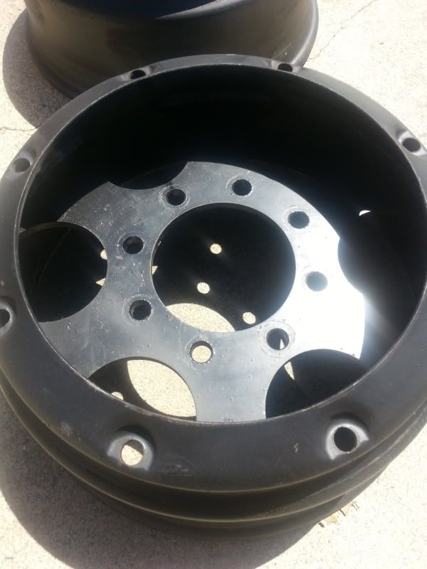

picking up a set of 4 recentered h1 beadlocks with pvc inserts
Getting em for $200. Stupid cheap! Im going to try and get the tires switched and mounted wednesday so I can go wheelin thursday
Beadlocks are home.
They look to be professionally recentered as the center looks water jetted out and the welds look almost robotic. Maybe TWFs.

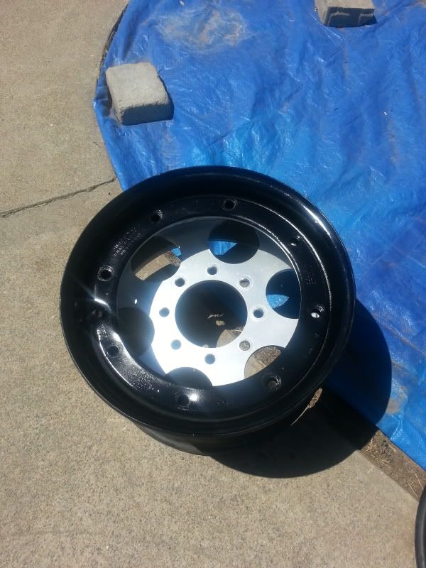

I am missing one bolt so i have to run up to Ace and get it. But they are done!
Cant wait to wheel these

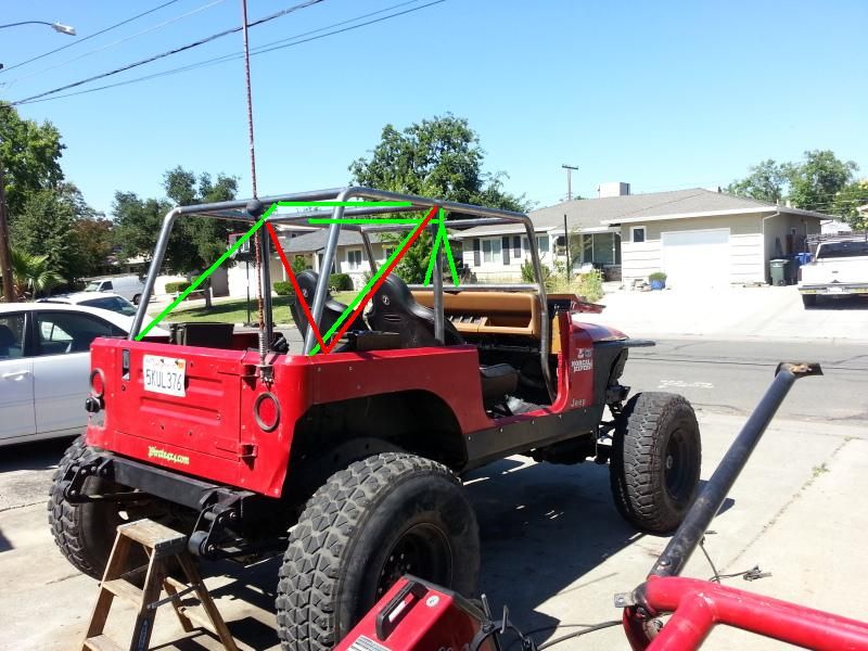

Are you going to add any triangulation to that cage? An X behind the seats or an angle from drivers B pillar to pass A pillar then something over the back area. Or maybe some door bars from A to B and gusset your corners. Would make that a really strong cage.

Yeah I have 50ft of tube for triangulation.
I am going to run a windshield bar and probably run a V from that to the b pillars as well, then another V from the b pillar to the c pillar.**Most likely also running a bar from B pillar top to bottom of c pillar diagonally.* Might tie into the c pillar top, but the rear seat is so close to the b pillar i dont see much strenght being needed all the way back.*
Something like this
[URL=http://s142.photobucket.com/user/sargin311/media/cagessss_zpsaeb82d39.jpg.html][/URL

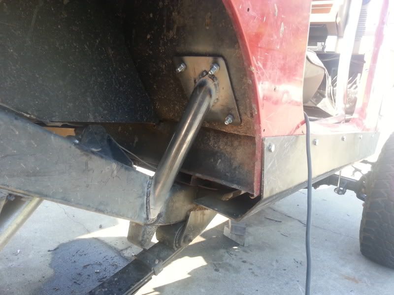

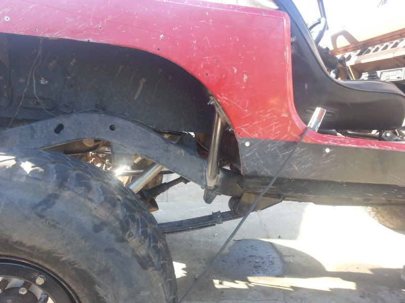

Just got done putting a few hours in and got the seat mounts done! I just need to figure out what to do with the b pillar and then i can stick the harnesses in.

B pillar tie ins done
