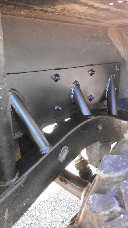

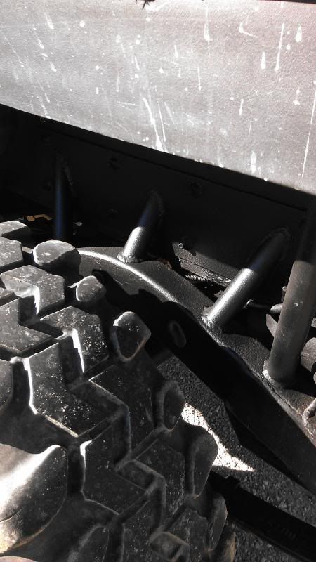

In this one you can also see my home made u bolt skids, my custom shock mount bar. I have more pics of those better somewhere. Plus my bodaciously cheap exhaust. 2" pipe i had, a $25 thrush muffler and a $4 turn down.

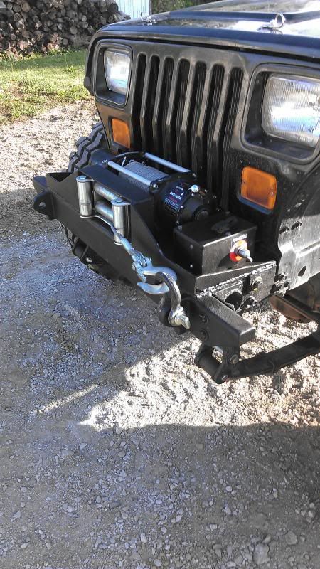

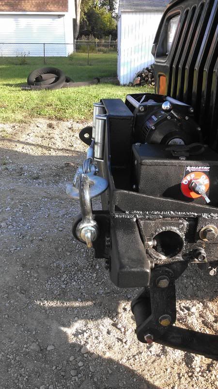

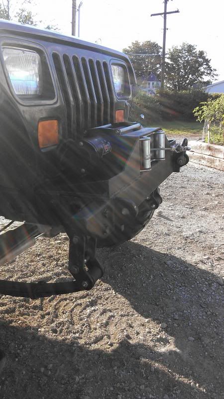

Well, it's been a while. All is well with the jeep. I found a smoking deal on a winch. XRC8 smittybuilt. It was $125 Used. The guy said it would only go one direction and thought it was the realy. Turned out one of the wires was in the wrong spot. So i got it working.
I built a winch plate and added it to the bumer that i had built previously. I also did not like the stock relay box and wanted a way to make power not always be applied to the winch. I built my own box for the realy and a 500cont/1000amp max switch. I also placed it down to the side. I like the low profile of it too. I also recessed the winch fairlead as far back on the front as i could to keep it as much out of harms way as possible. Fianlly i upgraded all of the winch wires to 4ga. It is a bit more stout. Only have a couple of pics right now. I need to oil and spool the line a few more times to get it trained better and need to get stuck to test it properly.

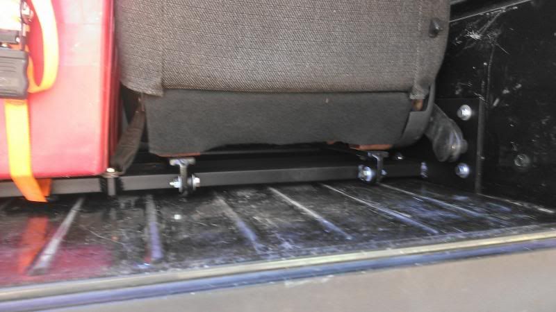

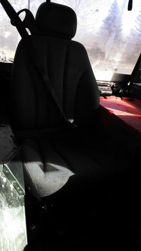

Latest project code named: Project over kill rear seat install, or Project turret mount m60. Not sure yet. lol!
Anyway the idea thinking ahead to a "real" roll cage and tieing the front seats into it made me think of this. How would i tie the rear seat for my son to the cage too? well rear it does not have to be tied to the cage as long as it's tied into the fram it would be virtually the same.
I picked up another cavalier seat from the take a part. I just wanted one good seat in the back with neck and head support. The factory rear bench seat totally blows for anyone having to set in it anyway. Also i wanted more storage for gear and junk when on the trails.
This is what ensued.... lol
The red tote fits in good but eventually i will have a tool box mounted there. Not sure if i am gonna make that or buy it yet. Also I am 6'2" and i can fit back there now pretty darn good. I could put in some hours in that seat for sure if i had too...
