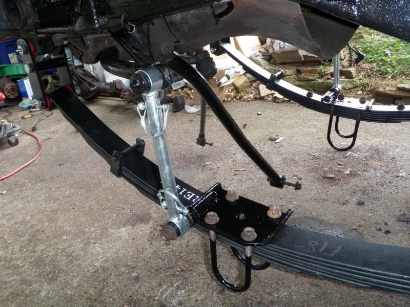

Rubicon 1.5 springs , rugged ridge shackles with greasable fittings

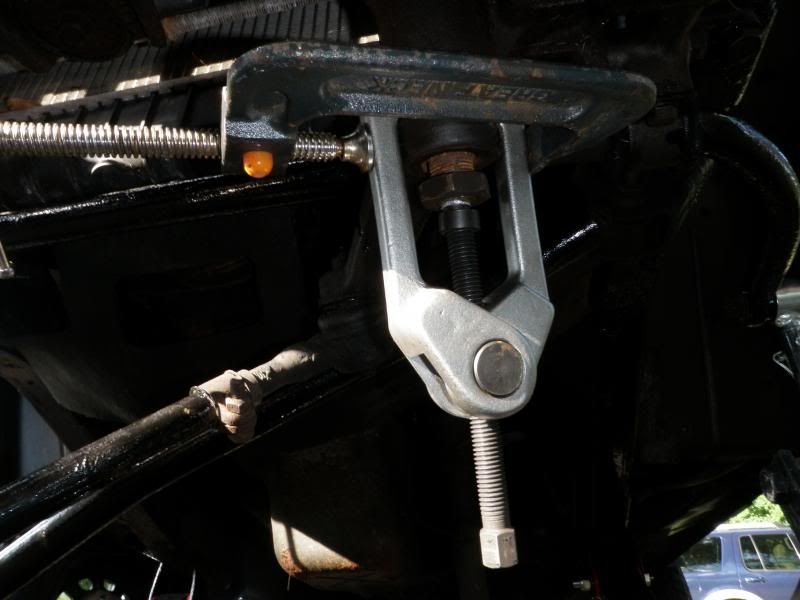

Came up wit a solution for the Broken pitman arm puller

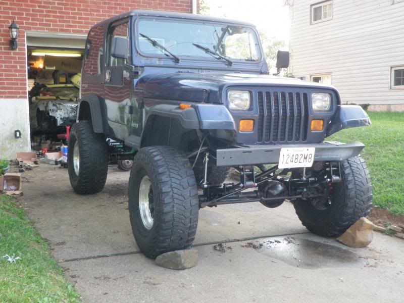

Bolted in !
The driveway is slopped so it looks even funnier in person

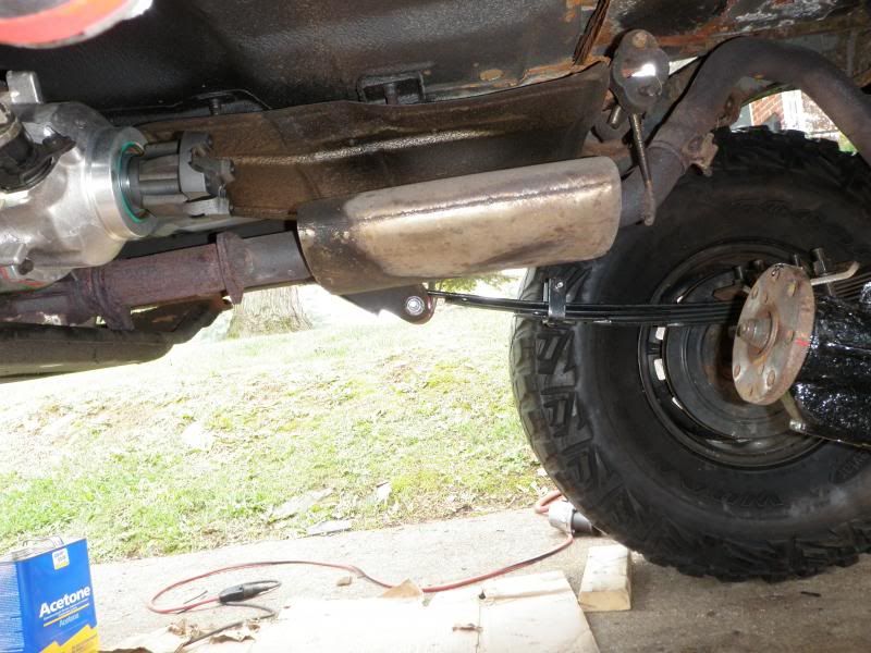

Got it lined up , need to set the angle before welding in the perches

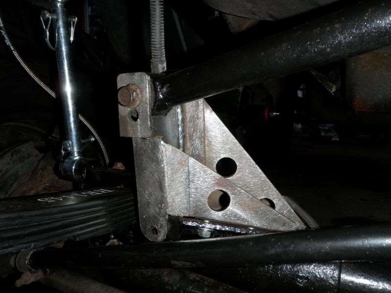

Back to the front and finish up the trackbar bracket with some modification . I forget the brand but they said i will only work with their trackbar ... No,No,No, not in my house
Needless to say , I took that extra piece i cut off and welded it to the cut edge and to the back plate perpendicular . I figured it to be sufficient .

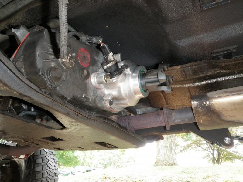

Put in the SYE so I can finish setting the angle

Since I have done the initial build I have accomplished a lot more . I fished up the brake lines , installed shocks and welded shock brackets . Welded in the rear perches and ordered a Tom Woods CV driveshaft to connect to the advance adapters SYE . I since the also removed my Craigslist hard doors , which is the fall project, and took off the hard top .

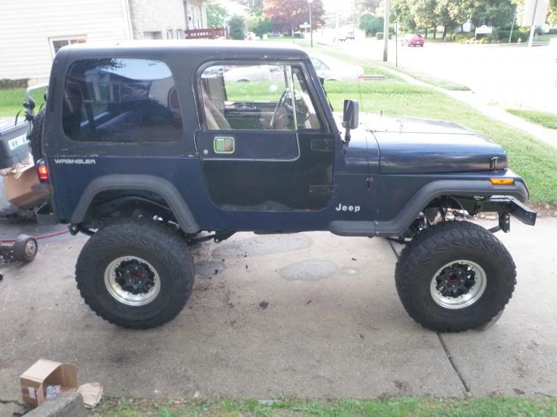

Been a while since I posted , Here is whats new . I added and new to me stinger front bumper , Piaa hinge mounted foglights and TJ flares . Sorry for the ****ty pic I'll take some better ones later .
