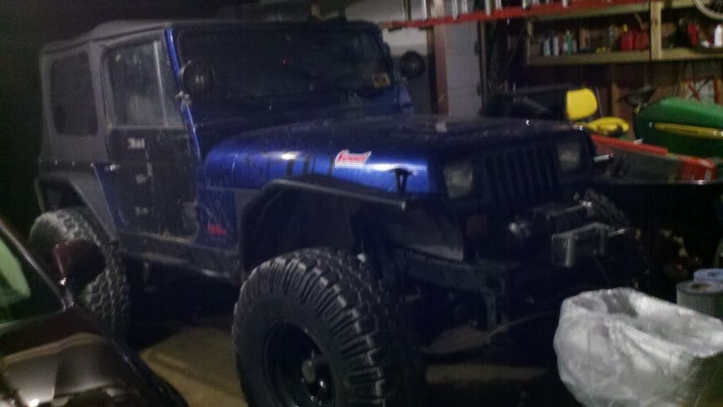

So im starting this thread a little late but i figure better late than never, i bought my 1994 wrangler last 2 years ago around new years and i knew nothing about jeeps, i got a 4 cyl, which to my disappointment didn't do very well on the highway. So after a few blown transmissions and an engine or two my dad and i decided to undertake a complete "do over" of the wrangler

well this sucks lol, everything was going almost too well, i even got my plexiglass back window finished... pulled it out of the garage and tried to put it in park and the shift lever moved but it didnt change gears. i got under it and the electronic control module thing for the trans is all stripped on the inside where it selects the gear, and the rod that goes through the trans just spins freely... so its back on the trailer and going to the place that rebuilt the trans. they warrantied the trans so hopefully it wont cost me anything.

not quite... the trans shop i took it to i guess ended cutting up my skid plate and my exhaust system sooo i gotta make a new transmission crossmember, went to farm and fleet and bought some metal tonight, then gotta re set up the exhaust...
Talked with the shop today, it was just a pin in the trans that had fallen out. He has also pointed out a few mistakes I made and has been working on it in his down time. Really a great group of guys. To anyone in the chicagoish area that needs trans work its multistate transmissions ask for al. Im really excited, should be picking it back up today or tomorrow
